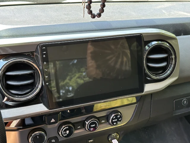

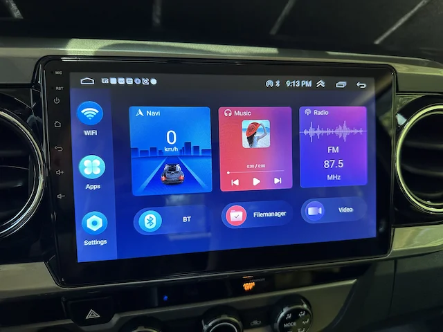

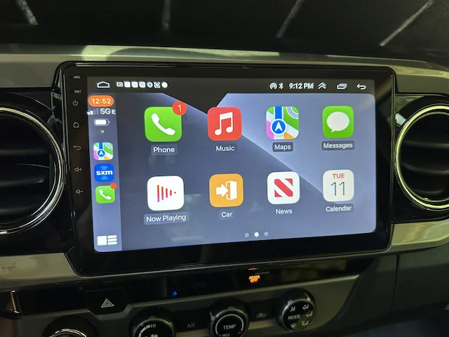

Not a LX or LC, but I installed one in my Son's Tacoma and I was impressed... install was easy, configuration was straightforward and price was a right via AliExpress.. everything works without cutting or slicing any wires... I am looking at one for my LC... Pictures of the tacoma are below...

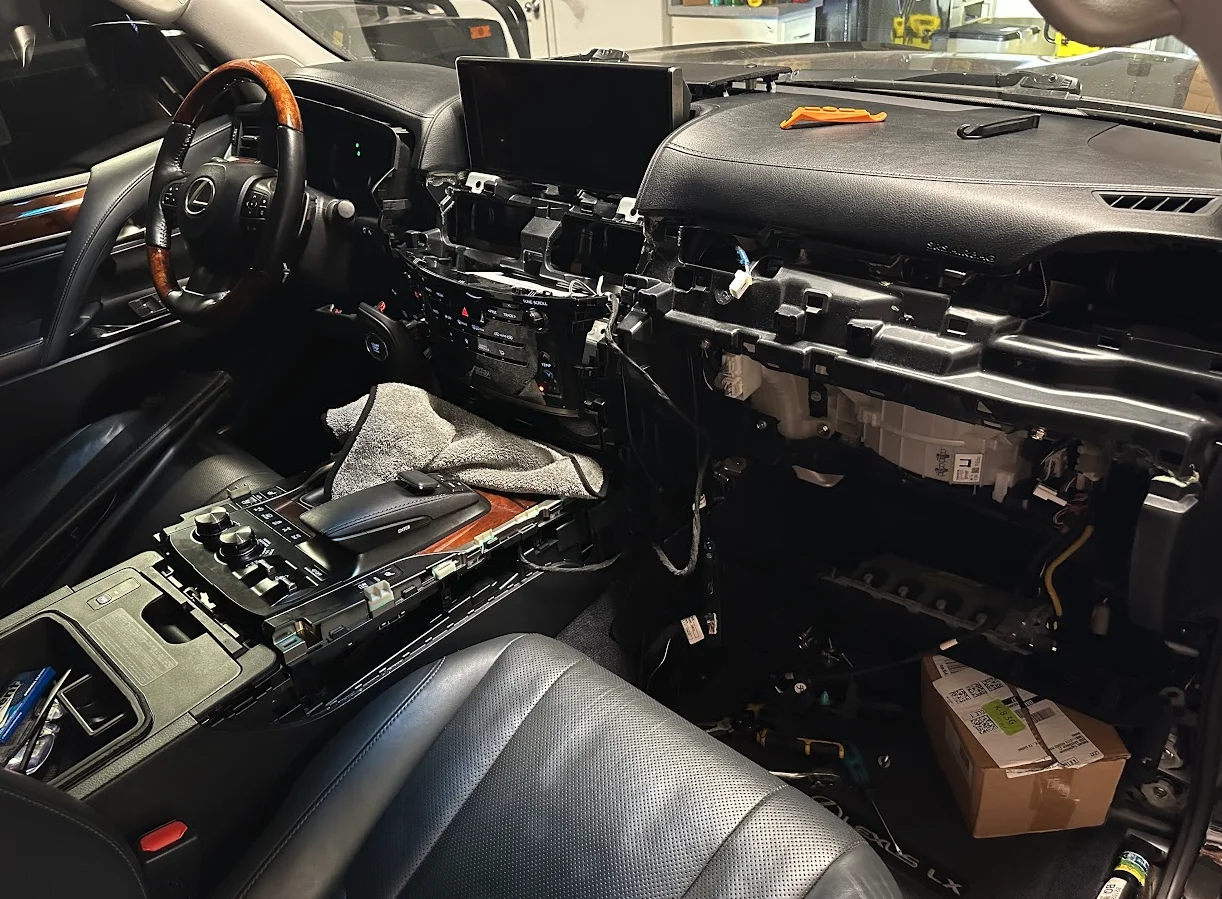

I'm almost done installing my $289 amazon find carplay retrofit kit on my 2017 LX570. Very little documentation, no real usable instructions, and no support. Fingers crossed it works out :-) If it does or if it doesn't I will post a full install video and review later today.

Man I really hope this works out for you lol. Selfishly because I might follow your lead but also because that looks like a LOT of work to find out it doesn't work. 🤞

Fingers crossed, it is looking good so far. I'm filming every step I can so it helps out everyone else in the community, even all the steps I made mistakes on and had to go back and figure out.

I agree, but I found a lot of you tube videos on how to configure the unit and taking the dash apart for the Tacoma.. very minimal documentation was provided..

Nice job, this was much more complicated that the tacoma version...and you have better documentation... well done..!
