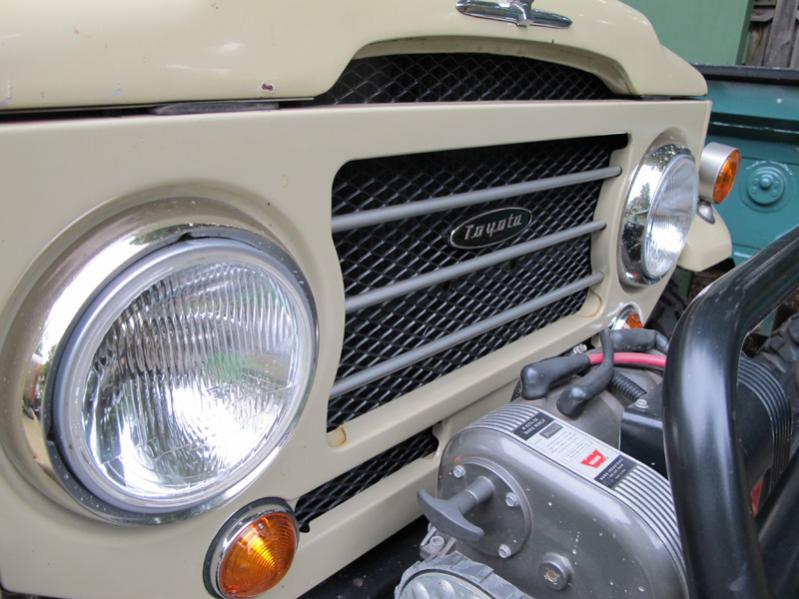

So is the front bib from a 25, or did you adapt? If adapted, can you share pics of that little project and how you are mounting the bars?
Color, I would match the other trim.
Please do take some pics of how you attached the rods to the adapted 40 bib.
Also, what about the trim rings for the headlights, what did you do there?
Here's a few pics of the bars adapted to a later model bib. The bars are hollow with nuts welded into the ends to receive retaining screws. There are black rubber bushings that separate the bars and screws from the bib.
Check out this link to Land Cruiser Junky's thread on the headlight trim rings here. You can buy the trim rings here.
i am really loving the old school look on the grill and headlight wraps.

Thanks for the help on the trim rings and the mounting of the 25 bars. Just wanted to confirm that you have to get the retaining ring too. Correct?

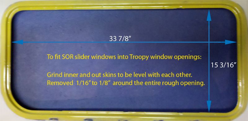

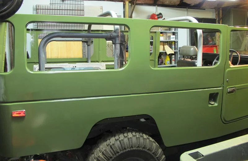

Got the hardtop sides on and figured out how to mount SOR slider windows in a troopy top. They don't fit out of the box, but after a little grinding to enlarge the window openings 1/8" in some spots, they pop right in. Will be nice to have good windows in this thing.

Can you post up dimensions of the sliding windows? Really the dimensions in the hardtop sides is what I'm looking for.
Thinking sliding windows in my build would be a very useful addition.
Thanks!

After grinding the troopy rough window openings 1/16" to 1/8" wider, the final measurements to fit the SOR sliders in are:
33 7/8" wide X 15 3/16".
This is a tight fit but they do drop in. You could remove a little more material and have the windows fit well, but I wanted them as tight as possible.
I believe the early model 40 hard top window openings with the solid pane of glass have the exact same recessed stamping as the troopy hard top. The difference seems to be the way the inner and outer skins are welded together. On the troopy, the inner and out skins do not match up as well as the 40 skins and have some overlap. Probably a production line difference. It's this overlap that needs to be ground down so the skins are exactly even.
After unsuccessfully searching for stock troopy window replacement parts, it great to now have a good solution.
The only issue I see with grinding the openings is that the layers of sheet metal may easily delaminate where in some areas if it ground too much. Might be good to tack weld the edge to prevent this.
Good thinking and thanks. I'll do something with the layers before final install of the windows.
Thanks so much for the info....I'll be ordering a pair for my 44 build!
