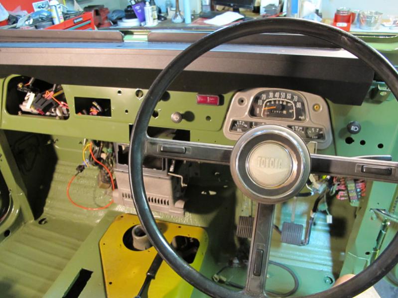

More progress this weekend: Engine harness installed, oem harness in, clutch master installed, connected and working, brake booster with FZJ80 master on, air cleaner on, new fenders on, oil cooler on.
Starting the engine and paint prep are next! Split hood and 25 bib waiting patiently.

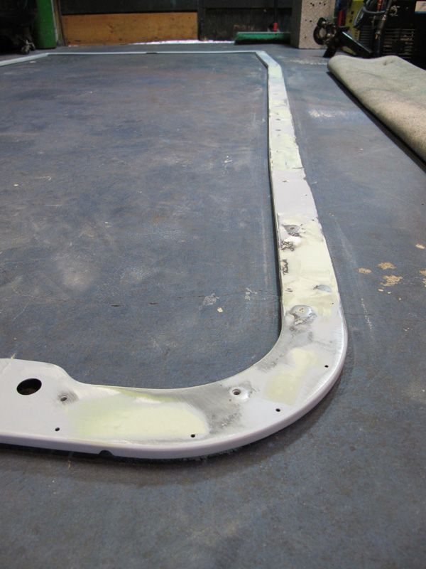

Need to find a late model windshield frame as this one is toast.
Up at Wally's last week for a few days of body work and paint. Huge thanks to Wally and Nick for jamming 40 hours into three days.
We rolled the troopy out out of the shop and into daylight for the first time in a couple years. Wally's shop looks huge now! Color 6H9 in a dulled/satin finish mixed 2:1 with flattener.

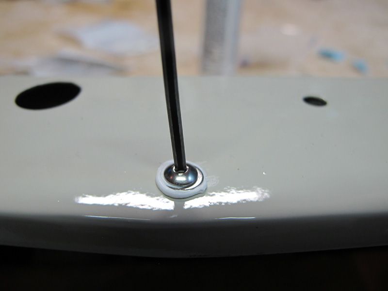

Decided to try something different than rivets for the hard top and found some SS hardware from Fastenall. The caulk is for sealing any pin holes or irregularities in the top where water could get through. The rain gutter side has nuts and washers. Hope this works!
