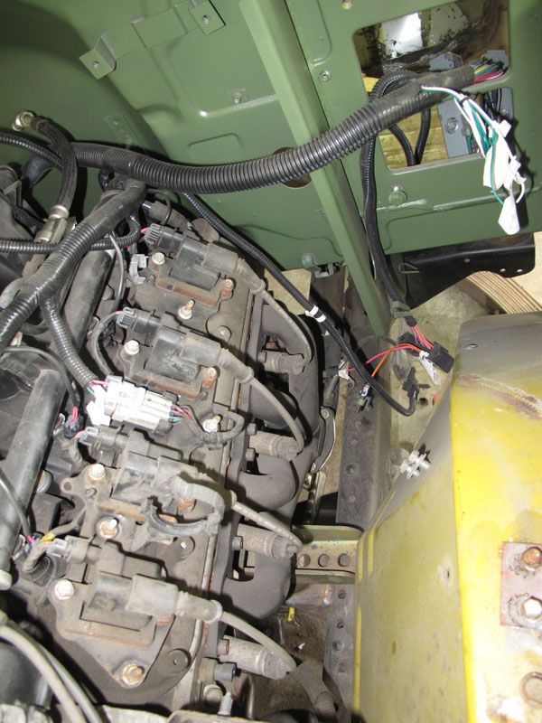

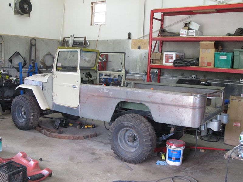

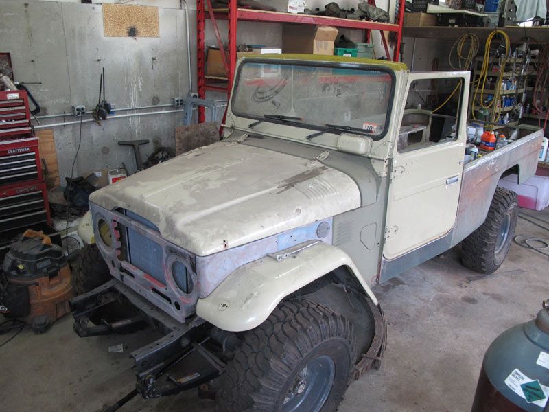

Two years ago the head popped on the 2H. After much debate, off to Wally's it went for a transplant and in went an '03 6.0L Vortec mated up to the H55. Somehow, it turned into a frame off rebuild, but I'm sure none of you know anything about that :doh:.
Good progress on the 47 up at Wally's lately. Tub and firewall seam sealed & undercoated in body color (6h9) Raptor Liner, gas tank in, 1/8 quarters & wheel well tops, OME, test fitted panels. Reassembly is fun. Miles of bodywork to go...

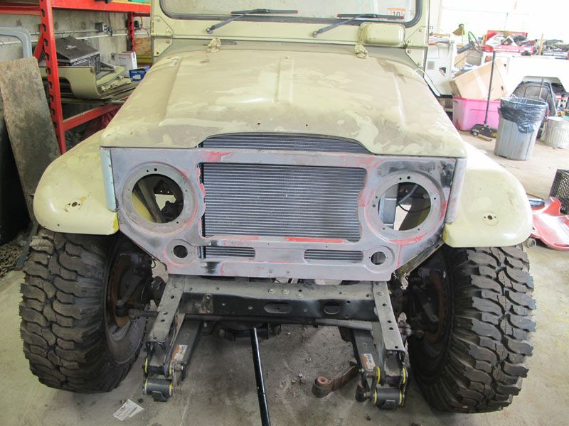

Talk to us about the radiator. Custom job? How's it mounted? Is it a stock size for an SBC? I see it's a crossflow, nice.

You just did :hillbilly:. Yeah, this was a long drawn-out debate over many a beer and strong opinions. Once the 2H head blew the research began. In short, it came down to parts availability, cost, and power. This will be a DD and will haul family, trailers, and a 40.
It's a Summit Racing cross flow model made by Griffin. Custom feet on the front cross member and tension rods down the sides. I'll take more detailed pics of how it's mounted.
