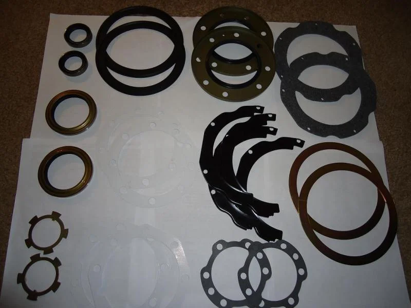

The only extra parts you may need to swap sides are the C-clips if you separate your birfs from the axle shafts. IIRC the old ones shouldn't be reused but some people do, sometimes they break when removing the birfield joint from the axle shafts. The "kit" that CDan and Beno put together includes all the standard replaceable seals and gaskets, etc. Once you dig into everything you might possibly need other parts like wheel bearings, trunnion bearings or even spindles or spindle bushings. Depends on how it was serviced before, if it was neglected, abused, etc. How many miles on your rig?

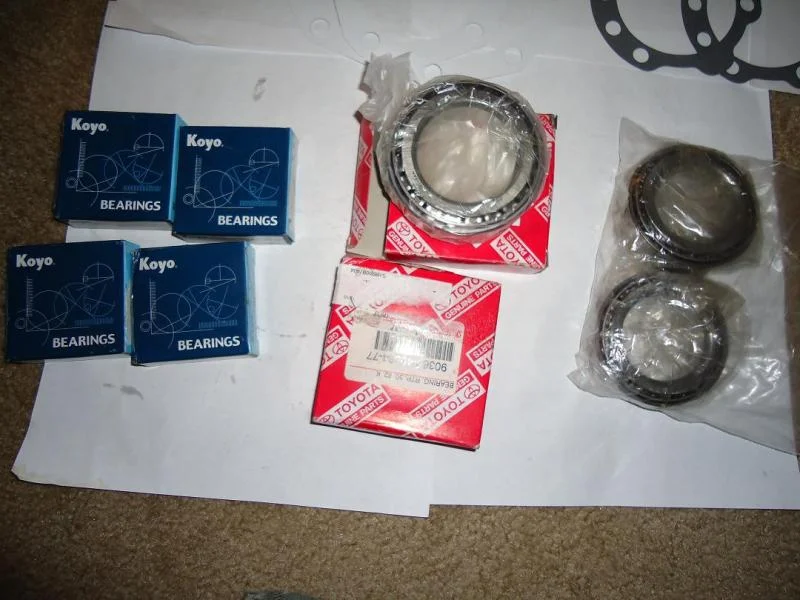

225xxx miles, I got the kit from ACC Toyota and all the bearings, I figured I will switch birfs side to side while I am in there. I have everything I need I believe right now, just got to get the moly grease, stuffs hard to find. Heres some pics of what I have believe its everything I need. Ill get the c clips ordered and if theres anything else can some one point it out. The truck has been well maintained but I have no record of axle service for it so I have no idea whats in there. Thanks

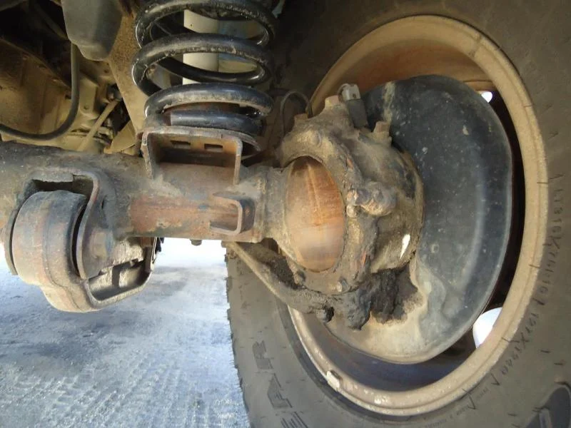

julstirn: that knuckle looks sooo dry it would be interesting to see some photos of the inside of your knuckles and birfield joints and bearings before you clean them up ie: to see how much if any grease is still stuck to anything. Get some photos of the inside of the birfield cups also if you take them apart. Thanks

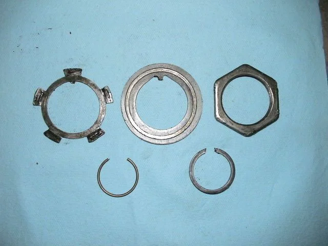

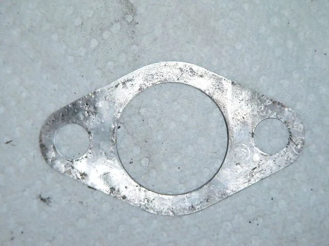

What Beno says. IMHO it's better to have the small parts on hand in case you need them and the FSM indicates that the inner and outer snap/c-rings and the lock washers are non-reusable parts. Here are a couple of photos showing the condition of some of the small parts from my rig's front axle when I dug into it for the first time. Top photo shows one of the shims that fit between the steering knuckle and the top trunnion cap, full of mini-dents. Bottom photo shows a lock washer that had been used many times, thrust washer with a wear groove that's not supposed to be there, dinged up spindle nut with damaged threads, the inner c-ring (thinner one) and the outer c-ring. From reading other posts, some Mudders have broken the inner c-clip when separating or reinstalling the birfields from/to the axle shafts. FWIW.
