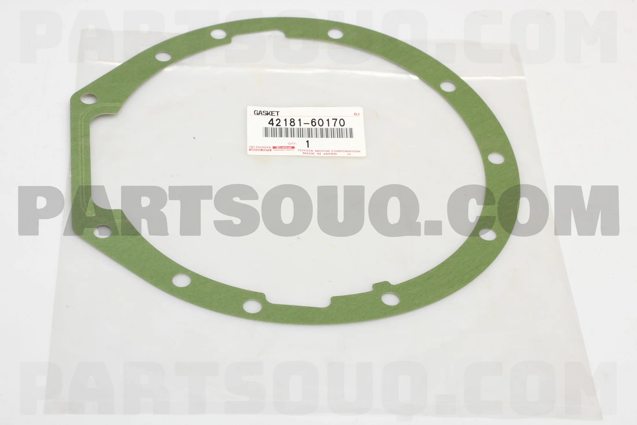

Gasket differences:
Locking
Non-locking, possibly flipped from the gasket above
