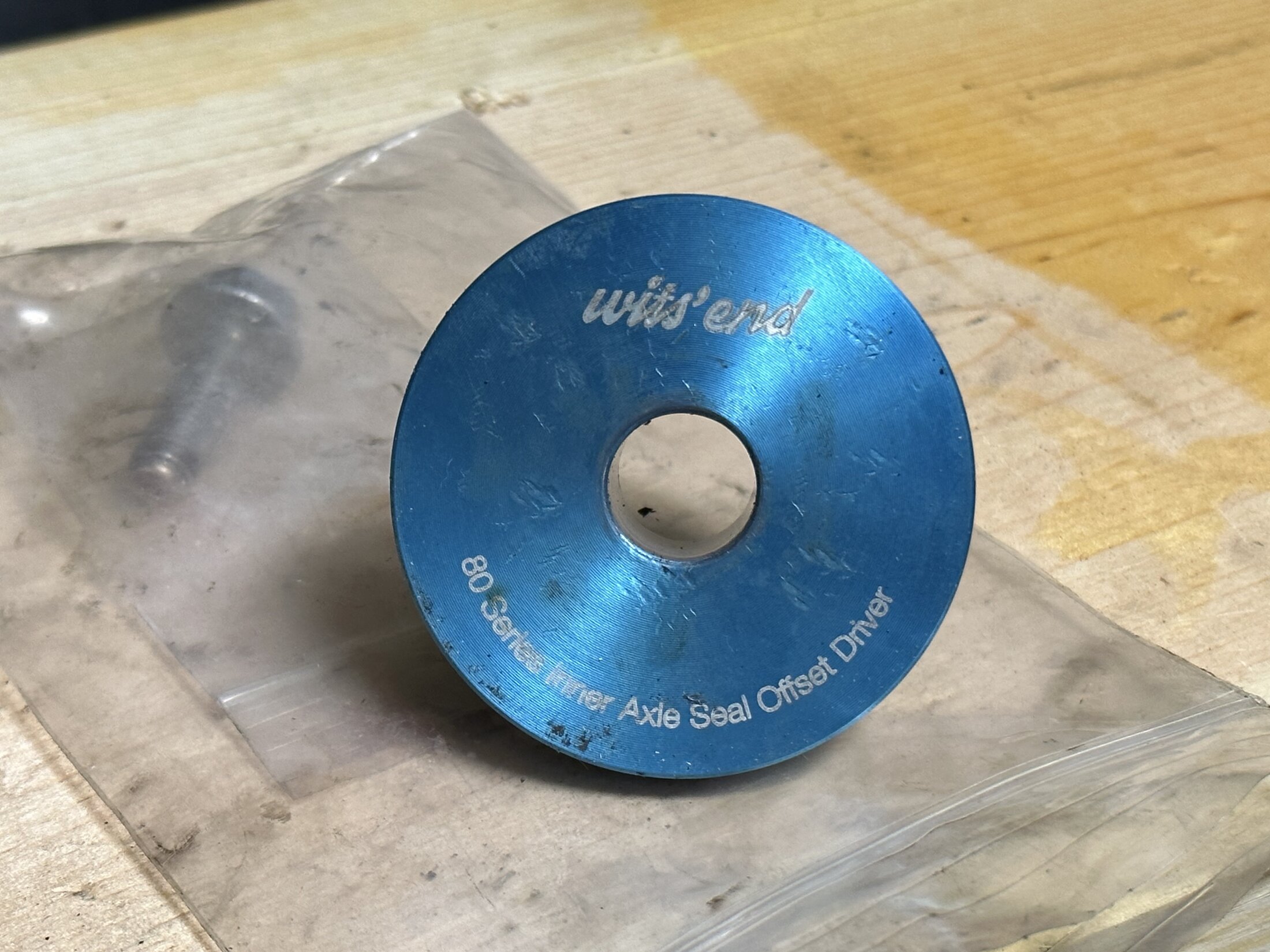

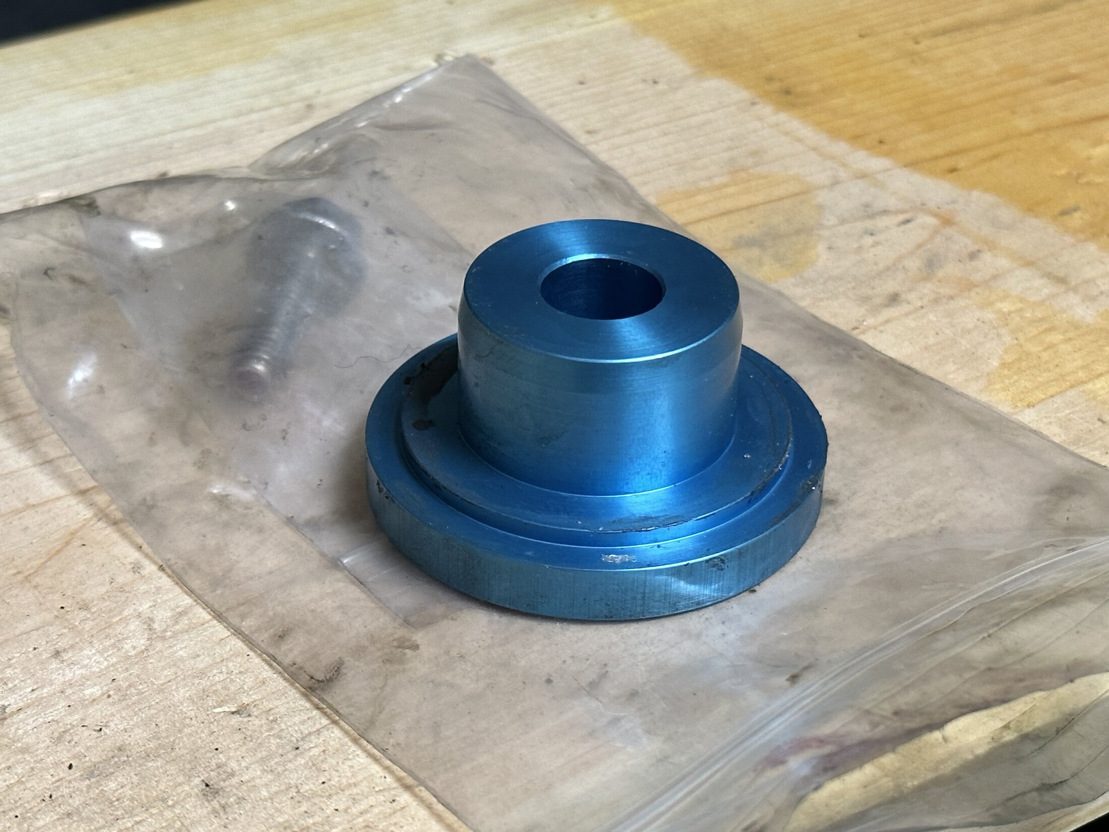

Anyone have an alternative to the wits end offset axle seal driver?
seems like wits end has gone MIA with my money
We use a standard seal driver with a washer that matches the seal OD (50mm) under the bolt of the seal driver. Pretty sure it was a hack Tools R Us shared with me many moons ago. RIP dude!

Selling my offset driver. Used once for my rebuild, and since no longer have the truck. I'm tempted to turn it into an honor-system "traveling seal driver," but maybe you guys can just keep selling it for a few bucks when you're done.
Was going to post in classifieds, but thought this was better. Looking for $25 shipped US. First come first serve by order of message received.
