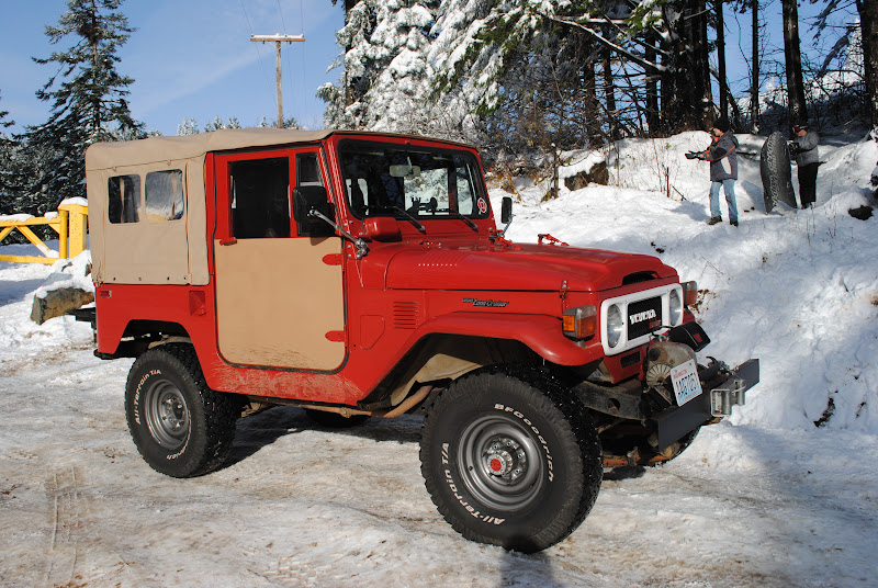

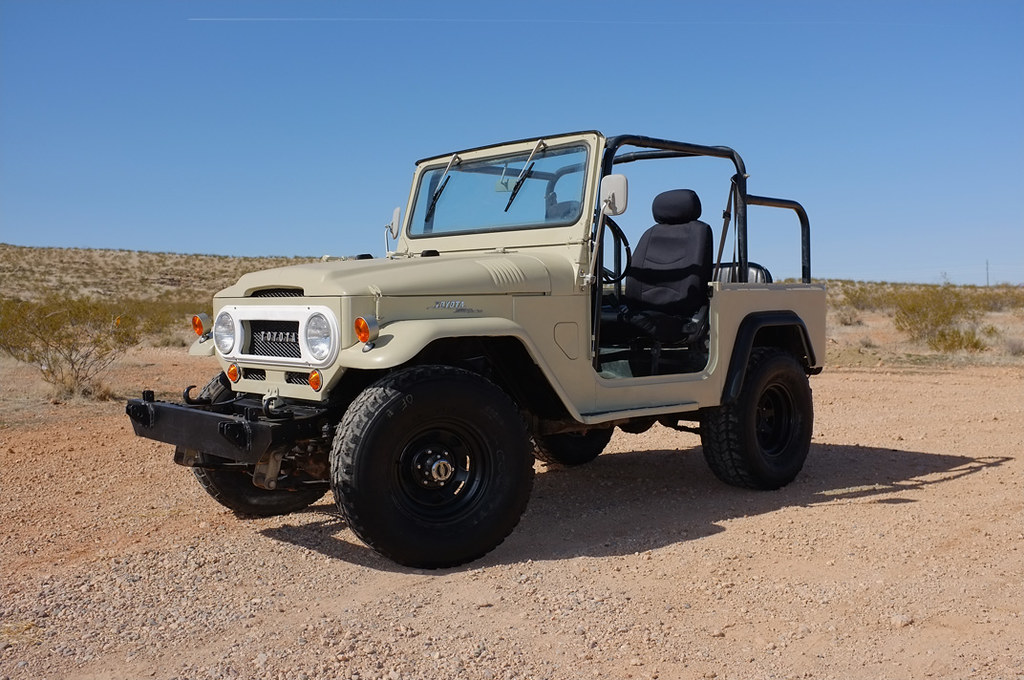

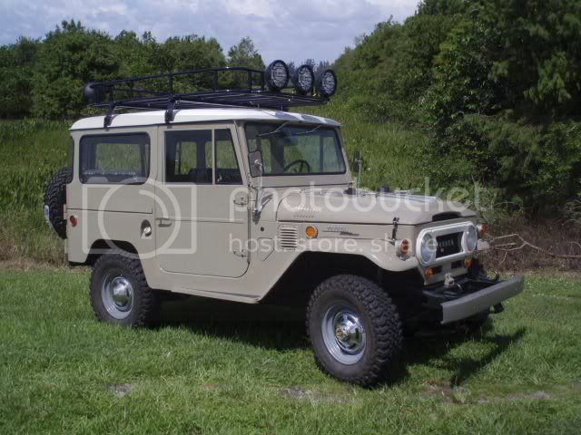

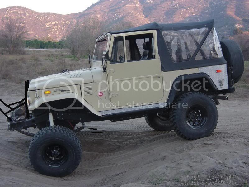

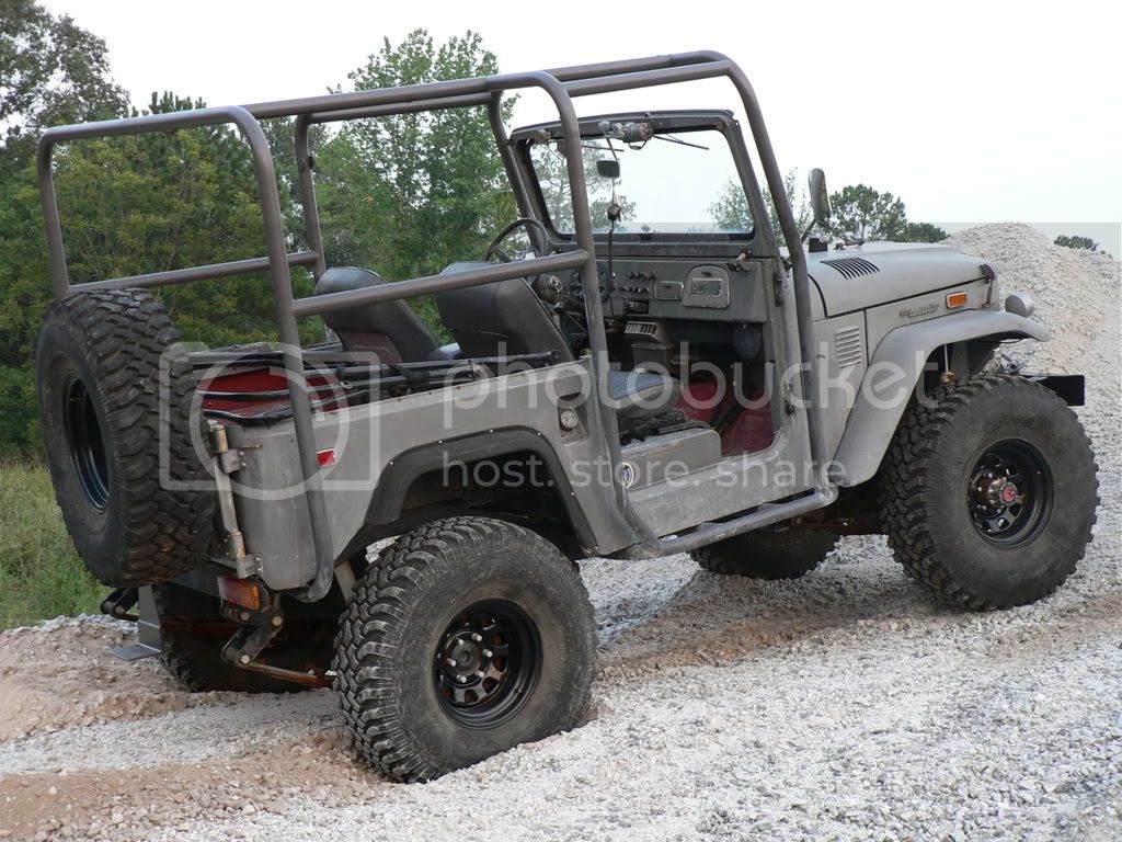

I don't have any painting advice, but here's some inspirational pictures of khaki colored cruisers...

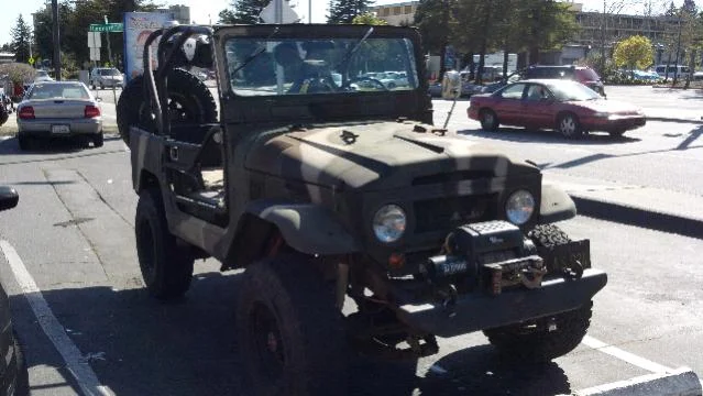

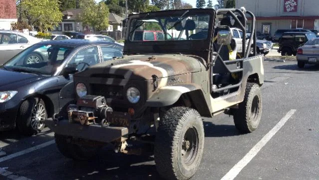

This is my rattle can job 8 cans of camo paint at auto parts store . Not a great job but easy to do and touch up. About an hour and a half to paint and less than 75 bucks.

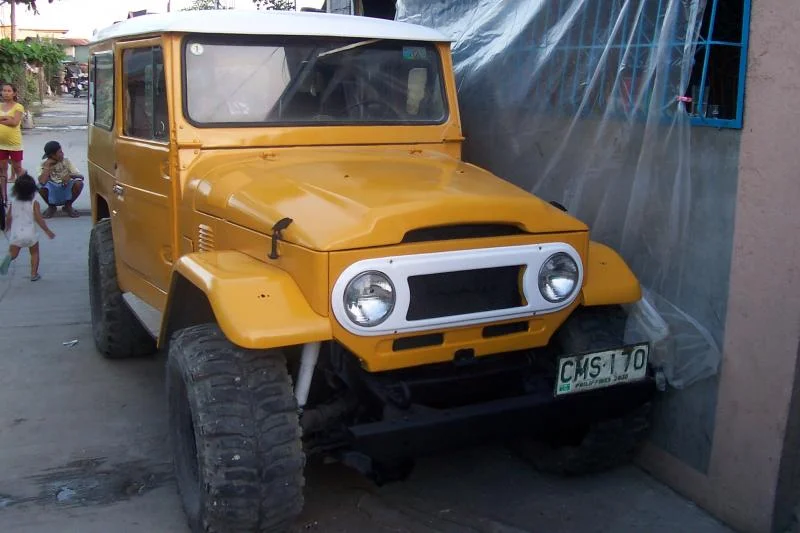

I did a rattle can job on my rig in 2010 and the color is Cat yellow. Not my favorite but as I said before, here in the Philipppines one has to apply for a permit and pay a fee to change vehicle color. Later I plan to change the color and shoot it with a HVLP gun and tough quality paint. Easy to touch up scratches is one plus. But as CjGoode pointed out as well as others, the painting took me 22 cans haa haa and 11 cans of primer but there was no compressors or paint guns available at that time other than having a body shop do it and because I am an American the price sometimes doubles. Sooooo Rattle can Heaven worked for now. These pics was during the reassembly. I did however find one of those Rattle Can Paint Triggers at Ace Hardware here and Wow what a difference. Paint came from Ace as well.
