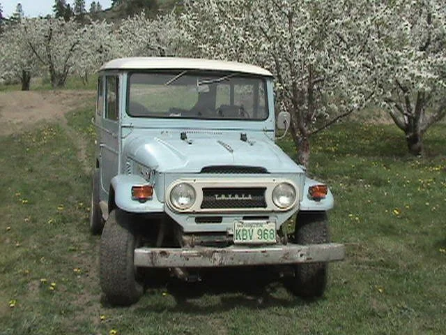

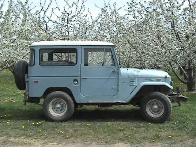

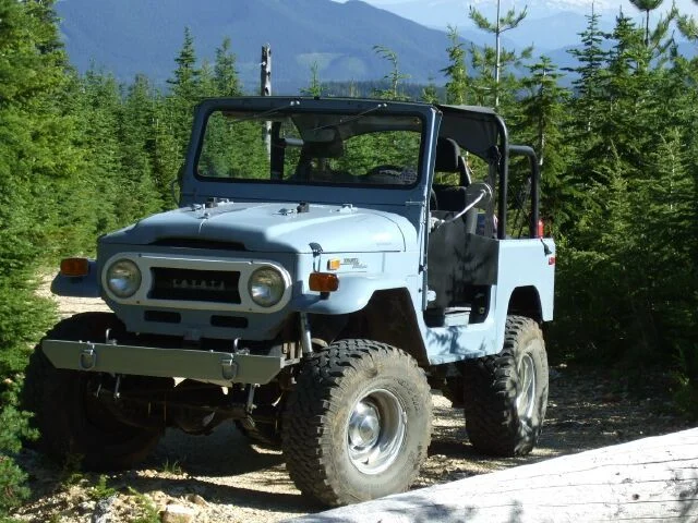

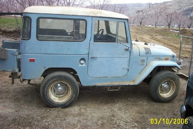

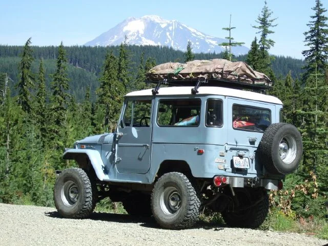

Okay, here’s my ROTW. I was really hoping to have a little bit more done on my rig by now, but I guess that is kind of how it goes. My Land Cruiser story goes back quite a ways. The convoluted story starts with my Dad’s buddy from high school. My Dad’s buddy’s dad (did you follow that?) bought a 72 fj40 (6/71 production date) sometime in early 1972. They named it Rickshaw 1. They owned a local mechanic shop in central WA and did some work to the engine to get a little more power (i.e. get rid of the vsv, different dizzy etc.). They had it for about a year and then sold it to my grandfather. He lived up in the mountains, so my grandfather used it for a hunting rig and a winter driving rig. The funny thing is, my grandmother used to work at the local ski resort, so she ended up driving it back and forth to work in the winters. There are stories of her passing snow plows on the way to the ski area. They always just called it “The Toyota” since it was the only Toyota my family owned.
The following picture is sometime in late 1974. My grandfather is the one kneeling down in front. His brother, who is now 95, and could probably still drive the thing, is standing to his right. His nephew is directly behind him and a friend is holding on to the elk they shot. My grandpa’s older brother is the only one in that picture that is still alive. And like I said, he could probably still drive the Land Cruiser. He is in awesome shape for a 95 year old.

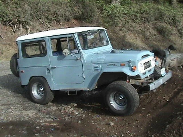

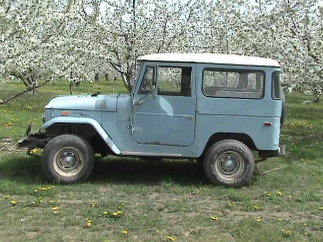

Here’s a couple more old pics. The first one was taken in the fall of 73. That is my mom holding my older sister. The next picture was probably 76 or 77 at elk camp.

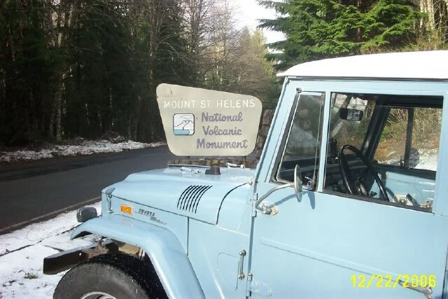

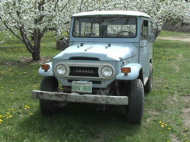

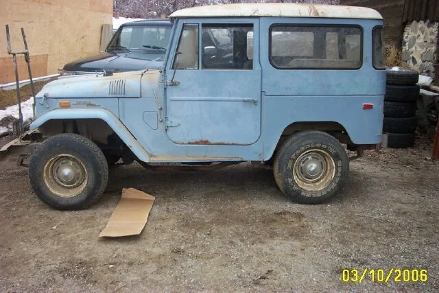

So, that brings me to December of 2005. I made my first trip up to see what I was up against. This is a good time to mention that I now live about 5 hours drive time from my parents’ house. I hadn’t seen the rig in awhile, and I hadn’t really LOOKED at the rig in quite some time. It was a mess. Years of dirt, cherry seeds, pine needles, leaves, etc., were stuck in every crack and crevice. The seats were rotted with carpet, foam and whatever else pushed in to provide some relief to the bare springs. The rest of the interior was in about the same shape. But, the body wasn’t that bad. There was some rust through in the rear quarter panels, but other than that, rust was pretty minimal. In all, I was itching to get to work on this thing! The most amazing thing is that the odometer only showed 19521 miles. And no, it hadn’t flipped. But, those 19521 miles equate to about 19000 total trips. Most of them were ¼ - ½ mile in length.

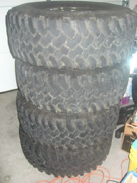

So, since I was so excited to get to work on this thing, I bought a set of tires and wheels off of craigslist. That’s when I learned about wheel backspacing. They didn’t work, but I could still use the tires. I also learned to curb my enthusiasm a little bit and do some research first. Anyway, at this point my son was really excited about helping and went with me to get the new tires.

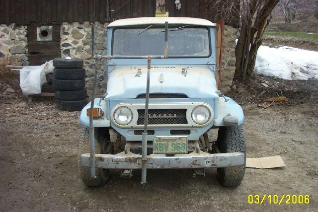

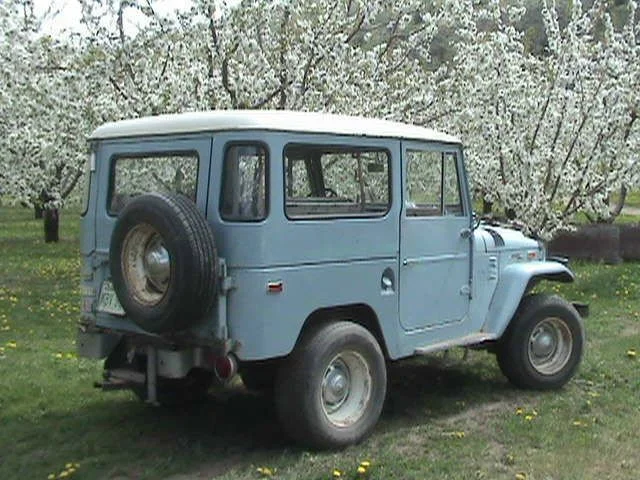

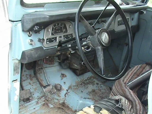

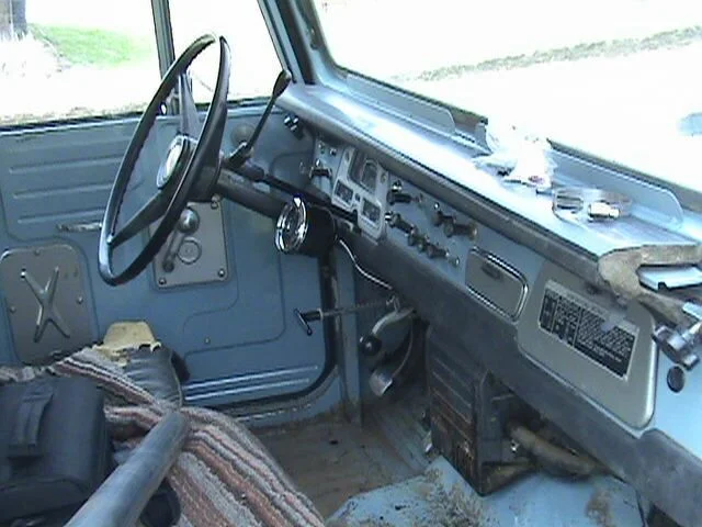

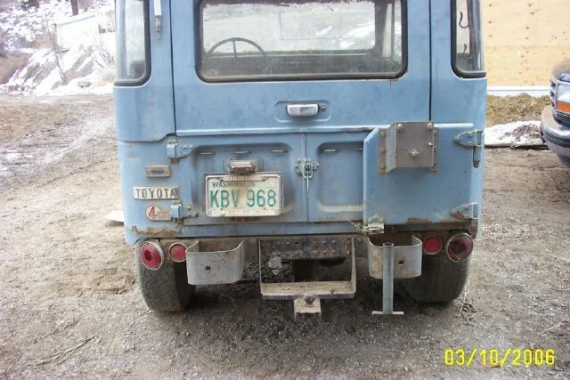

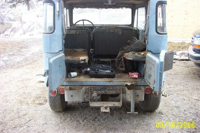

It wasn’t pretty when I first started working on it. You can see from the pictures, it was a little beat up and dirty. But, thanks to Ih8mud, I get to see what some people have to start with, and I feel really lucky. The paint was pretty oxidized, but a little Meguiar’s paint restorer, and it cleaned it right up.

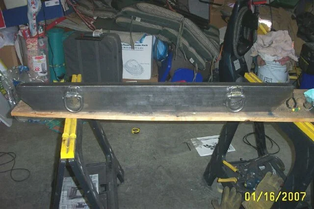

Next up was a new exhaust. The old exhaust was wired to the exhaust manifold. I took it into a muffler shop to get it fixed and found out that the bolts from the exhaust manifold were stripped out. So, I ordered up Spector’s 2 piece header. I went this route since they were the only one’s that would guarantee it would fit with the column shift. Another 5 hour trip and trip to the muffler shop and I had a decent sounding exhaust.
By May, I had made 5 trips and things were starting to come together. I also realized I had a nasty vacuum leak in my brake booster. A little research on mud and a quick trip to the salvage yard and I had a booster and M/C from a 92 mini truck. Swapped it out and no more vacuum leaks. I few more pics of this time frame. You can see the roll bar I bought from Metal Tech sitting on the seat. I hadn’t installed it yet.

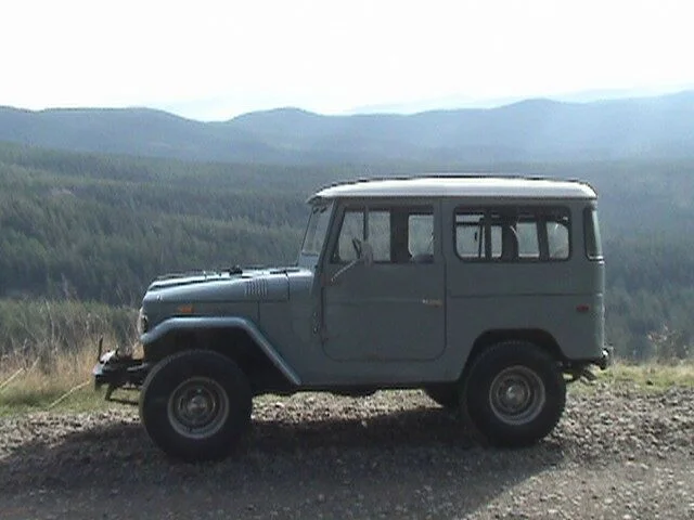

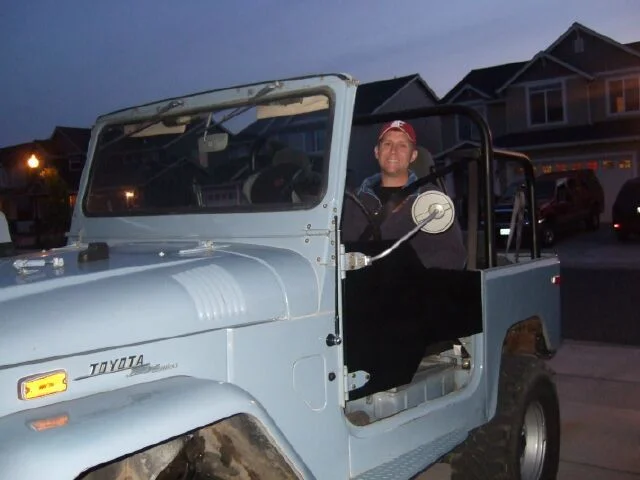

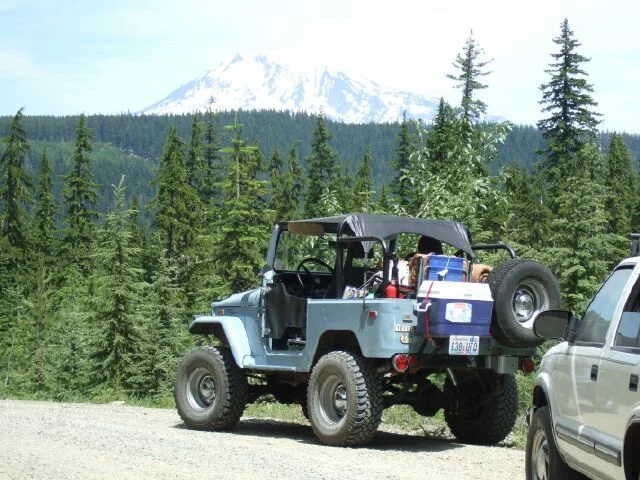

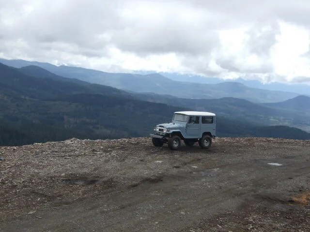

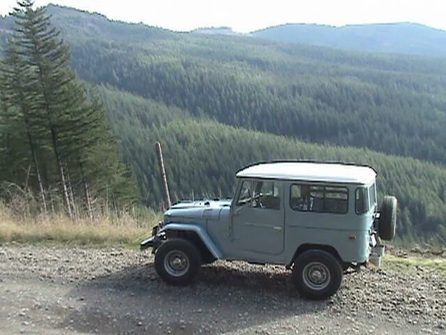

So, at this point, I was confident enough to take it up into the hills. It was just a quick trip up with my dog, but it was great. I loved every minute of it.

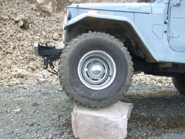

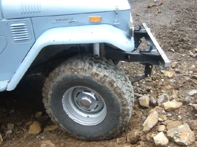

And, checking out the stock flex. Okay, so it didn’t really flex… But the 31x10.50 tires only slightly rubbed in the rear when tucking into the wheel well.

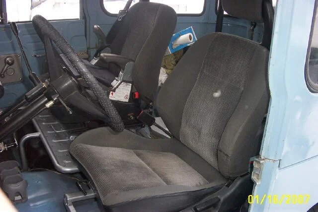

It was time for some mods. My wife was off work on maternity leave with our new daughter, so I took advantage of some shop time. I built a new bumper shamelessly stealing Jeff Zepp’s design from his website. I also added some bucket seats from a 93 Civic. Finally, I added a radio for those long cruises up to the mountains.

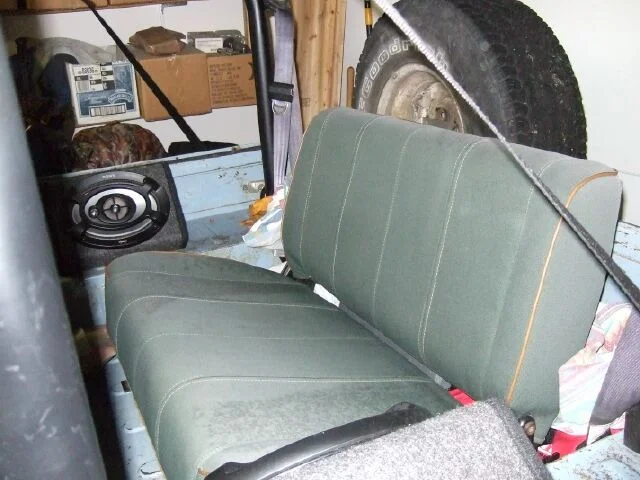

TLCA# 16112
Posts: 1,065

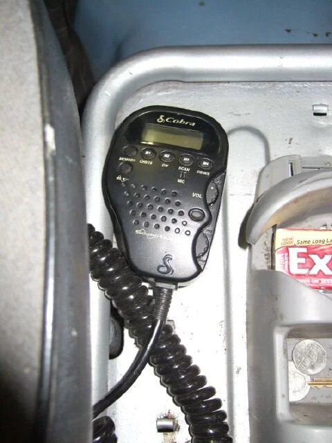

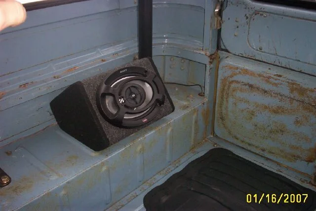

And the radio with 6x9s in back.

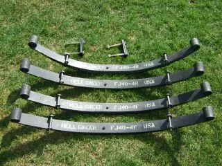

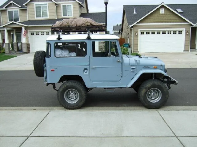

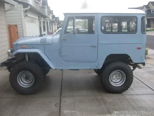

Now it is time for a lift kit. After some research, I decided to go with a 4” lift from Hell Creek Suspensions. I also bought some 33x12.50 Mud Terrains from a buddy at work. The first picture shows my stance pre-lift with 31s.
__________________
'71 fj40 capri blue - carb rebuilt and ported by 65swb45, vacuum advance w/ pertronix, SOR 2 piece header, Hell Creek 4" lift w/ homemade shackles sitting on BFG MT 33s, front disk conversion, H42 4 speed (wish it was an H41), Metal Tech rollbar (need to make it a family cage), Aussie locker in the rear, skull shifter knob , Heep bench seat in back. Lots of other mods...
ROTW
FF LC FREAK is offline   Reply With Quote
Old 10-08-07, 03:19 AM   #19 (permalink)
IH8MUD FREAKin' Addict
FF LC FREAK's Avatar
Join Date: Feb 2006
Location: Vancouver, WA
TLCA# 16112
Posts: 1,065
And now, after the lift:

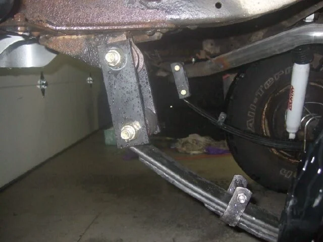

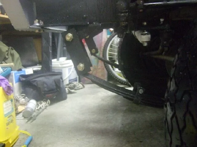

If you look closely, the shackle angle sucked. Refer to this thread for more info - http://forum.ih8mud.com/showthread.php?t=145610&highlight=shackle
Here are a couple more pics of the shackle angle front and rear:

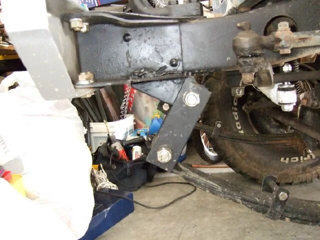

After some flexing and other options, I ended up just cutting off the front shackle hangers and moving them backwards. It greatly improved the shackle angle and ride. The new Bilstein shocks helped also.

Backing up a little, before I moved the shackle hangers, you can see how bad the shackle angle was when flexing. “Stuffing it” resulted in a vertical shackle.
