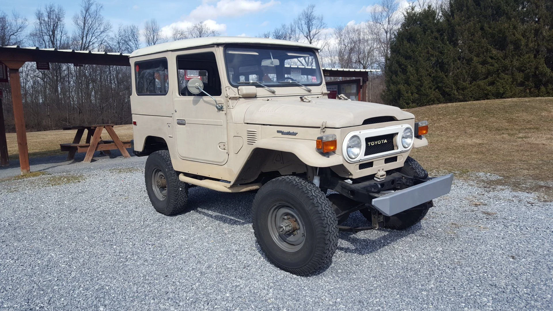

I'm looking at doing my suspension on a 1971 40 and am wondering price and kits and advice thanks guys.
Some pictures of it right now

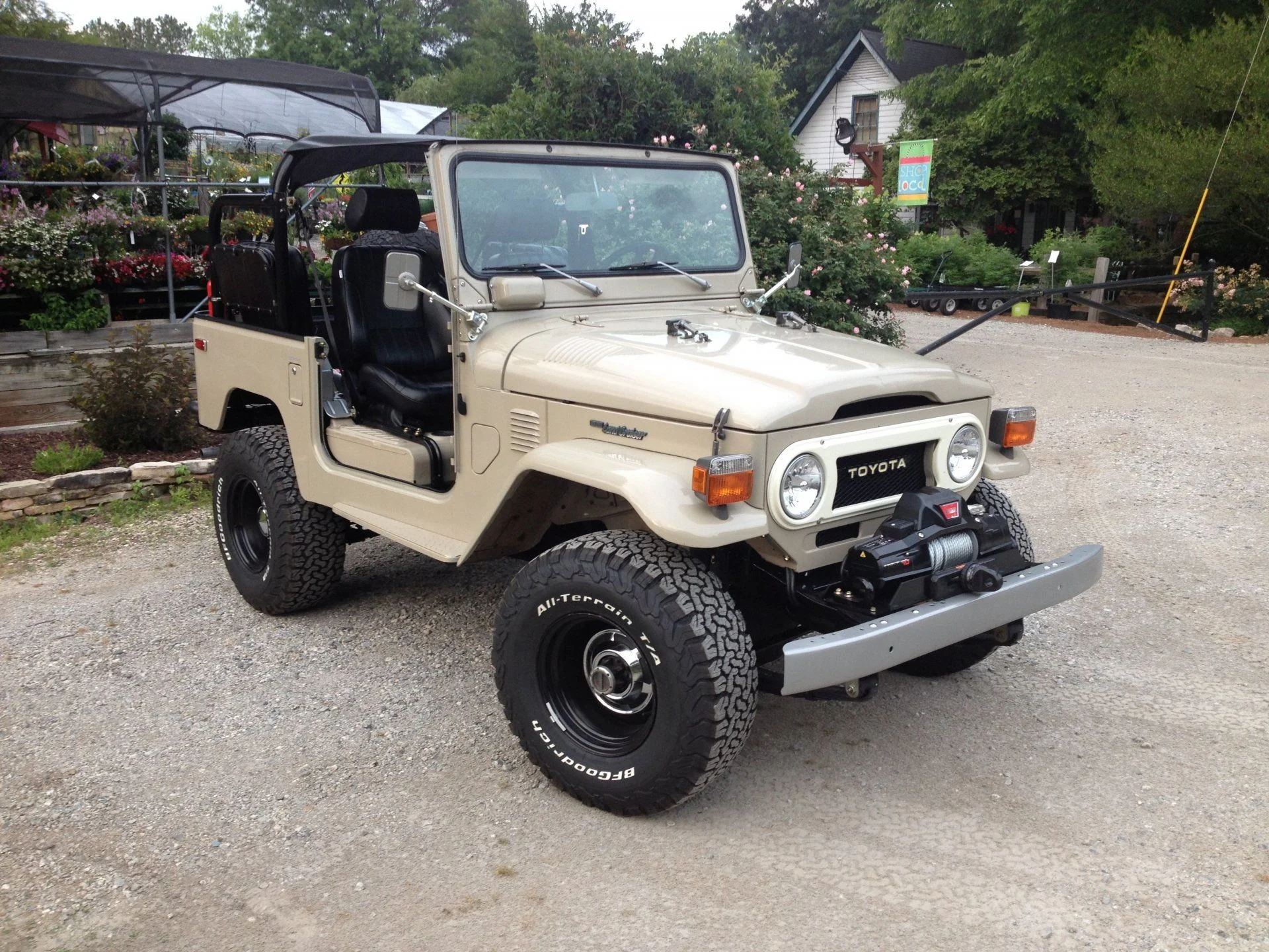

OME 2.5" recently installed (nitrocharger sport shocks -not bilsteins). For reference, those are 31" tires (shackles were back ordered when I put the springs on so I still have to add those which should add another half in or so in the back). I think 33's would fit
Before
After
hOOter
OME 2.5" will have sufficient clearance for 33-12.5's if you run flares on the rear, front is not an issue.

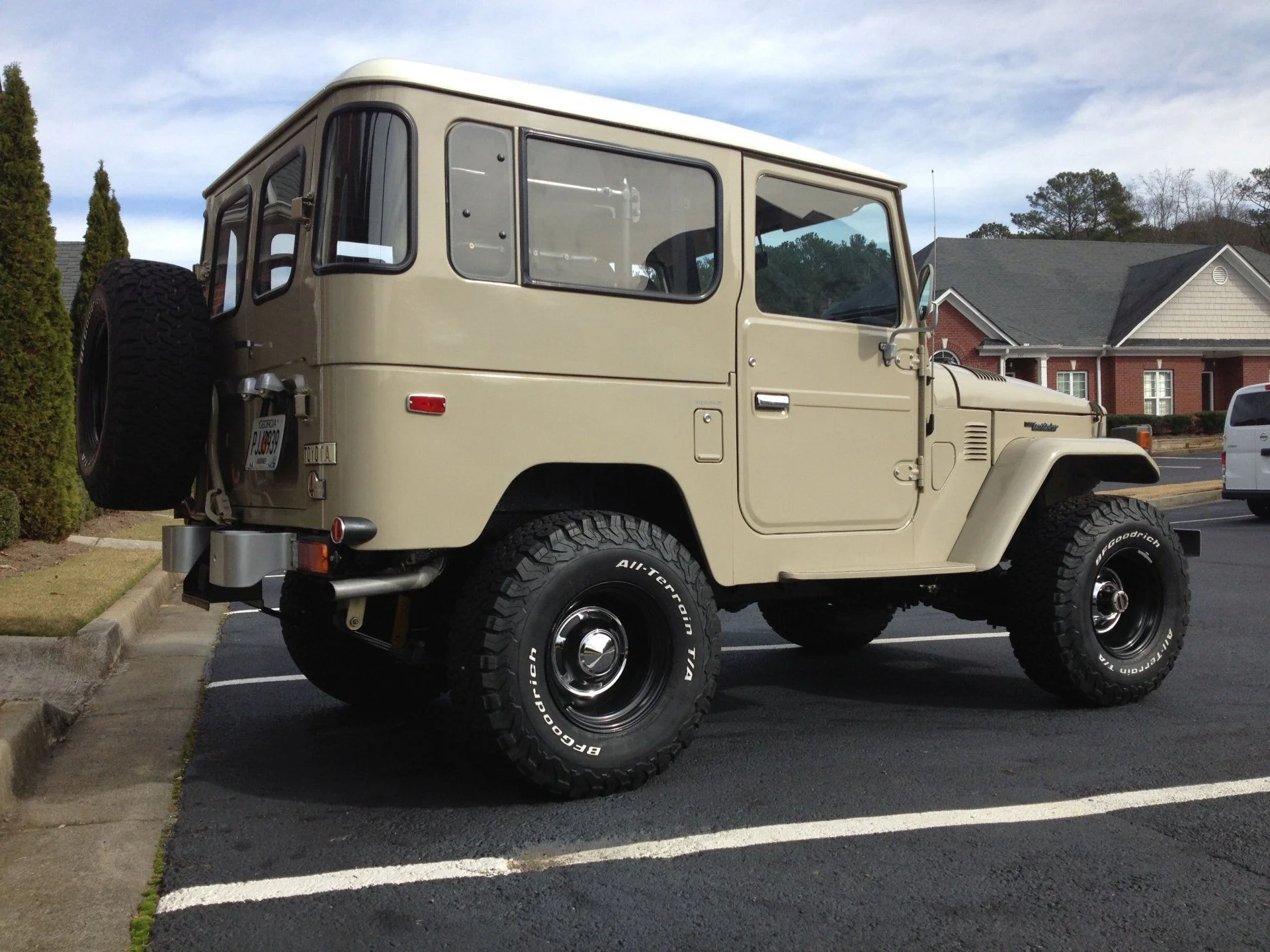

OME 2.5" with 32X11.50R15
Note, my OEM rims have been modified and are 9" wide.

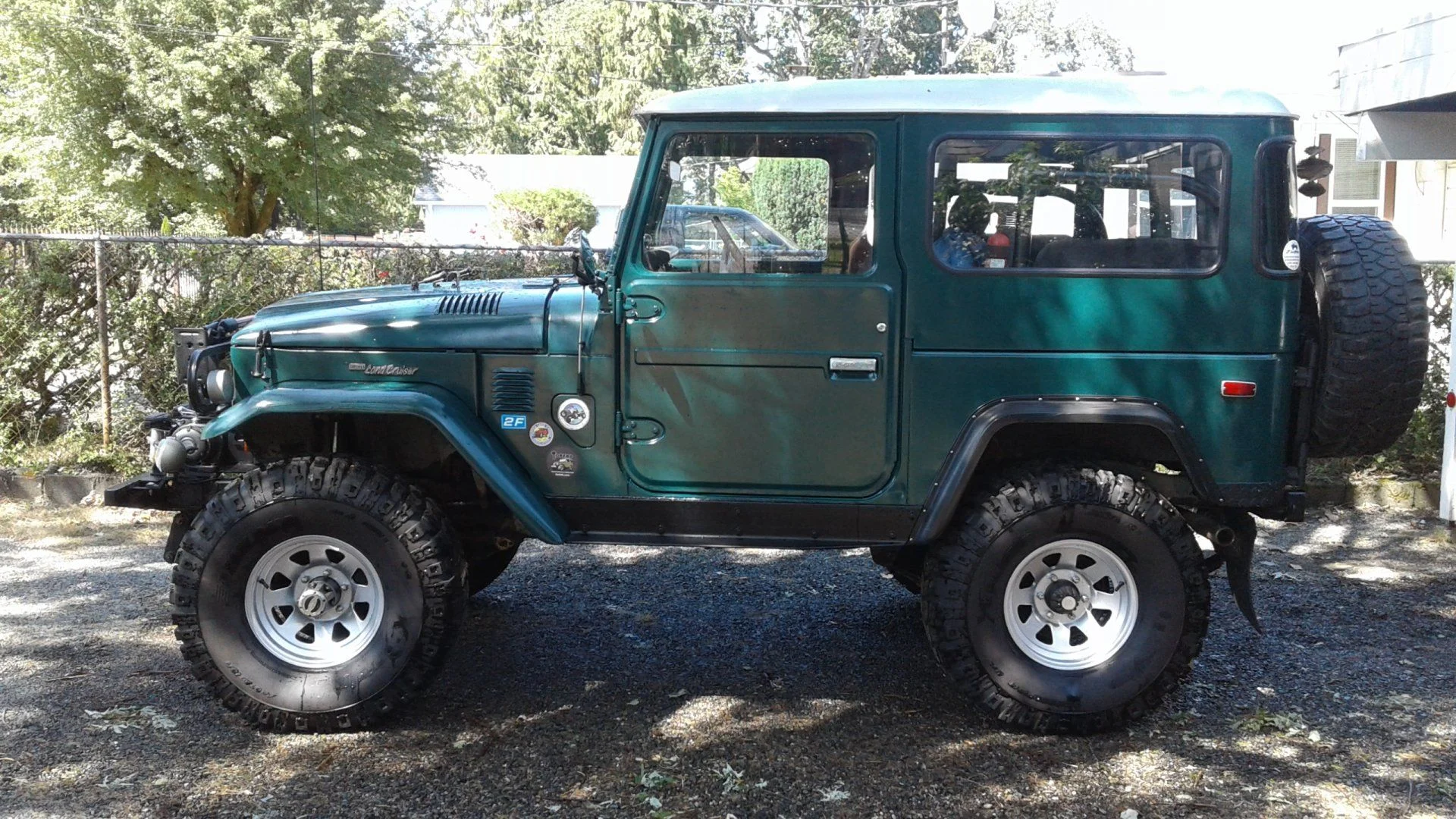

HFS 4 inch lift, longer shackles and 35's. Nice road ride, flexes well and after 12 years it's only sagged an inch. :cool:
