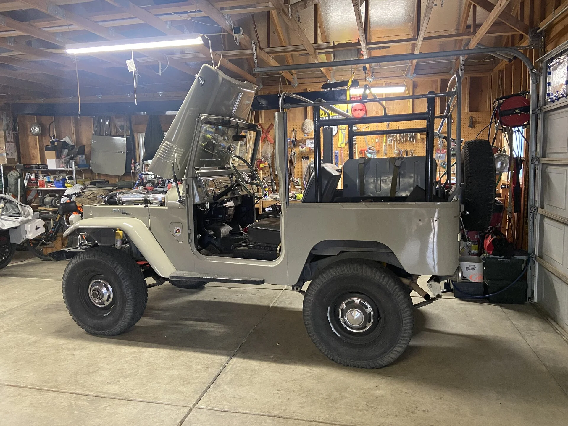

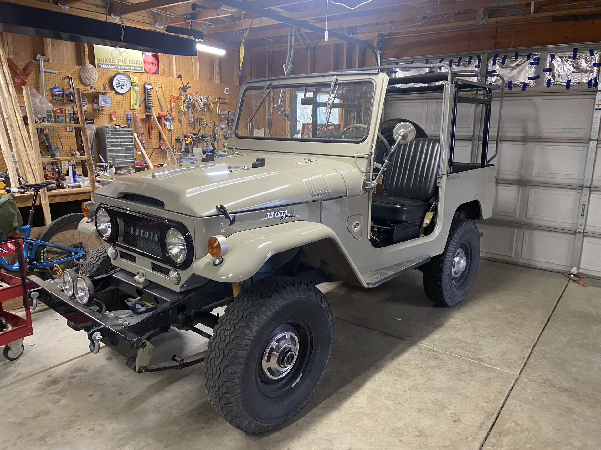

We've had this Landcruiser for about 20 years. Modified it with 4 wheel discs (Poser mod), H42 4 speed with 3 speed transfer case, rebuilt F.5 engine, DUI distributor, Howell fuel injection, Paki soft top (top needs replacement), 33x9.5x15 BFG's on Toyota steelies, Nason's Dune Beige 416 paint (in about 2009), SOR seat cushions and covers, Man a Fre 4" lift with OME shocks, new shackles... bunch of stuff I can't remember.

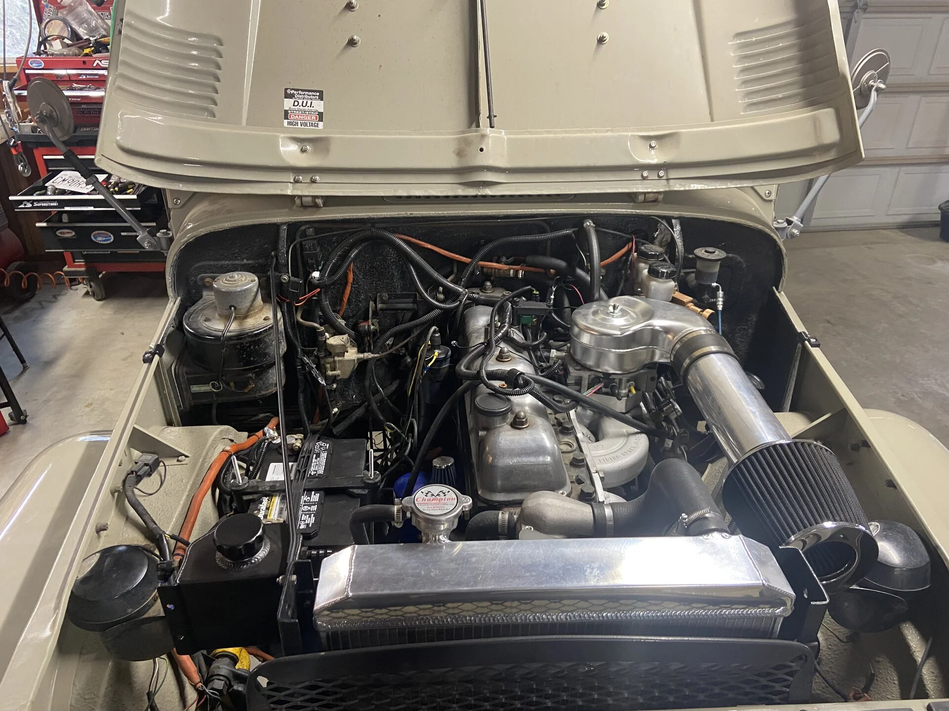

Anyways, was running it at idle trying to figure out an issue with the fuel injection when the engine seized. By seized I mean just stopped. No weird noises, no bellowing smoke, nothing. I thought maybe the distributor wasn't seated and not turning the oil pump so I checked and it was seated. My efforts to turn it over have failed, not even a slight turn. Thinking something internal let loose, which is odd because it was rebuilt by a shop in Bakersfield about 13 years ago, has a good 25,000 miles on it without ever a problem.
So, I'm at a crossroads. We plan to move in about a year (retirement), are downsizing and I had planned on selling it anyways. I really don't want to take on a big project nor do I want to tie up a bunch more cash into it. Was thinking of a 5.3L conversion but even with that I'm looking at a pretty big investment.

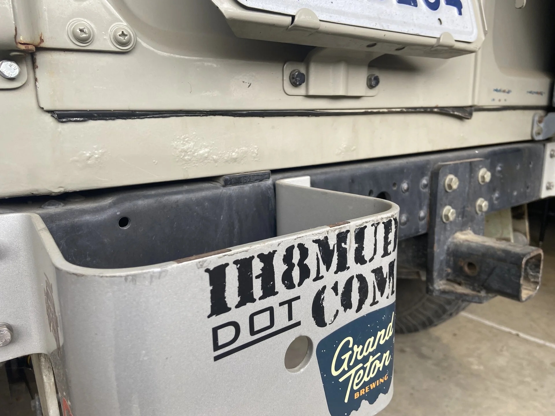

Not sure what a non-running FJ40 goes for these days (have been looking for a replacement 2F but they are getting hard to find). Any advice on pricing it as is would be appreciated. I figure if someone is looking for a project that involved an engine swap this would be a great starting point. Most of the heavy lifting is done. As for rust, there's just a little in the rear sill, picture shows it under the paint.

Wow, such a sad day. Pull the plugs and squirt a few cc of marvels mystery oil in each cylinder and let it soak for a week. The big breaker bar on the crank pully nut - BFH impact on the handle if needed. If that doesn't work, then she likely really stuck.
Oh yeah, it's really stuck. Tried all of the above.

I would try using the either the external oil line or the line going to the rockers maybe both and pumping in a can or two of Kroil, $40. Maybe a simple cheap electric fuel pump would do the trick, a few minutes at a time if it goes in to easy. Maybe rig up a pressure vessel if it goes in too hard. The goal would be get the Kroil to gearings and let it soak.
You can pull the plugs and dist, prime the oil pump. Put it in 3rd or 4th gear and rock it back a fourth to try and free it up. Allowing the engine to rotate backwards might unlock it.
Been rocking the hell out of it as suggested. I'll start on getting the engine out this weekend. Appreciate the advice from everyone.
Most likely a spun main bearing, pull the pan! If the crank survived, new bearings and your down the road again!
I've always appreciated the optimism from the folks on MUD. I've got a long history with this vehicle so I'll work on pulling the engine/transmission/transfer case and see what's going on. I've got a small leak in the transmission and the clutch slave cylinder is leaking so it'll give me a chance to clean things up. I have basically changed the oil and put gas in it the last 15 or so years so it could use a refresh. If the engine is toast then I'll look at alternatives. Staying original is a ship that sailed years ago so that isn't a factor. The F.5 in it is the third engine it has had. The original F was toast when I bought it, the replacement F (a rebuilt fork lift engine) lasted a couple years and departed this life from a failed oil pump and the F.5, well... TBD.
