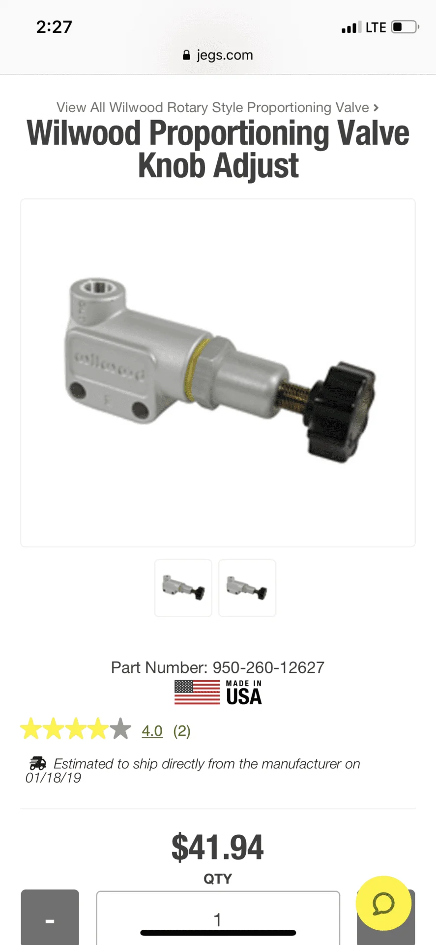

I seen your post of the prop valve and was wondering what was the brass adapters you had screwed into the prop valve. did it take the inverted flare type or did you have to reflare a new type of flare on the old brake lines in order to fit properly?
I'll get all the brackets cut off and rebuild the brakes but will have to get someone to weld in the perches. Thanks for your help.
As a data point, I’m running 80 series discs front & rear, with a non-ABS 80 master & no proportioning valve and I have yet to lock up the rears.
@pandasfj i’d run the city racer proportioning valve to eliminate the extra fitting.
It would be a cleaner install and one less thing to deal with/bugger up. @gt7058a take note yo!

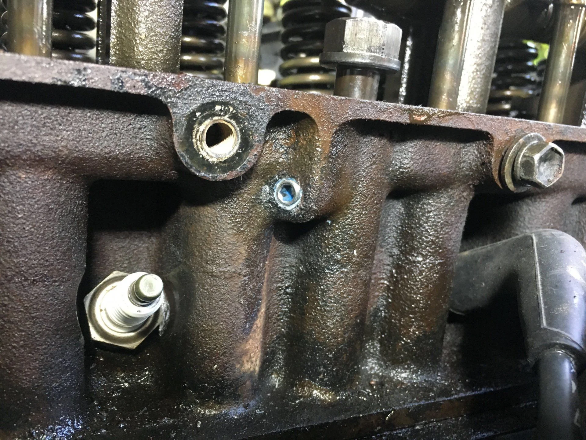

Oil Galley plug done a couple weekends ago with a crew from the Seattle Cruiserheads. Feels good to know that oil won’t start spewing out at an inopportune time.
Photo shameless stollen from @gt7058a as his photo came out much better.

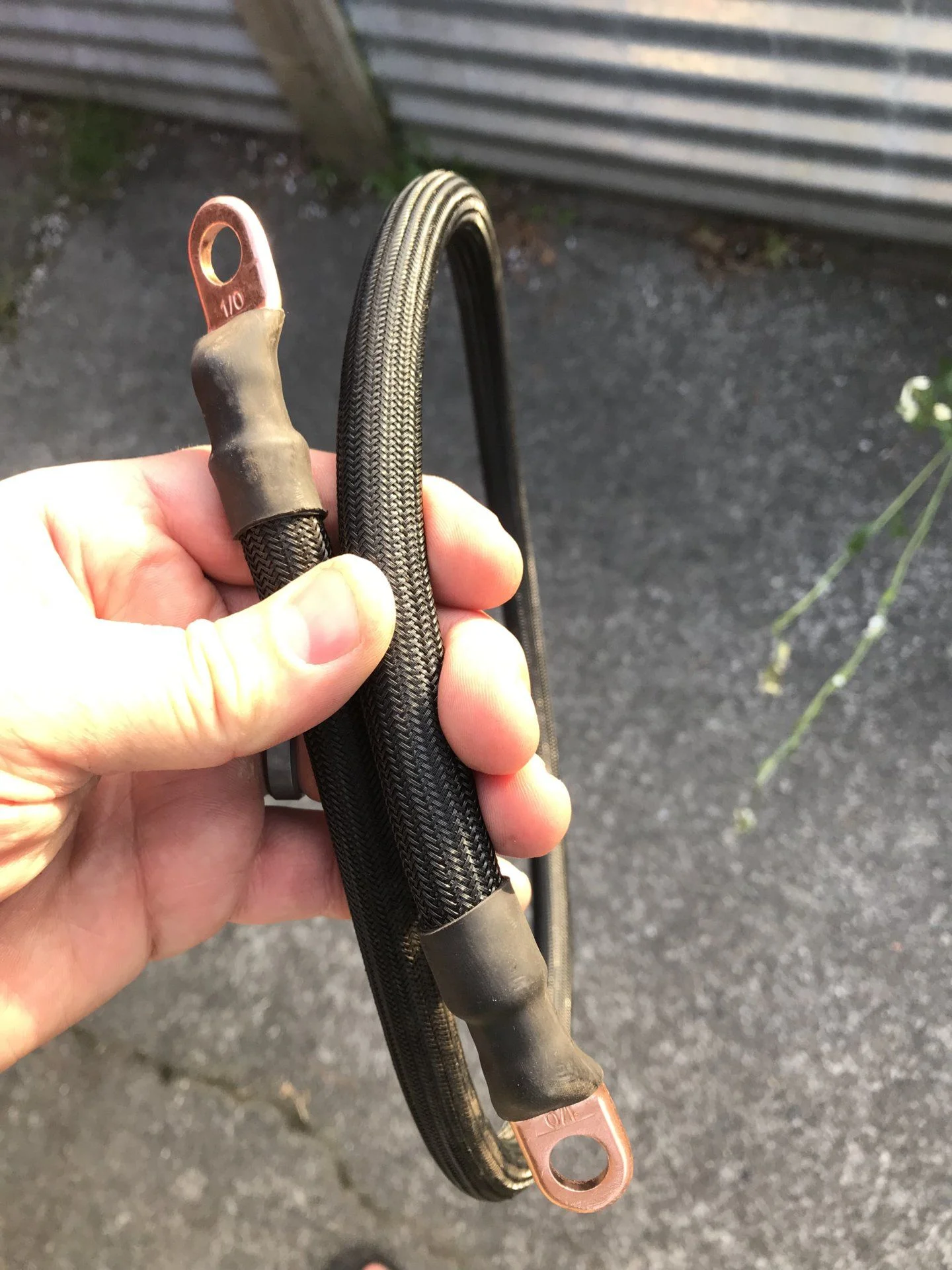

We also spent the day cranking out new battery /ground cables.
That battery/ground cable is legit. How'd you make it?

Hydraulic crimper, lugs, 1/0 welding cable, protective sheathing, and marine adhesive heat shrink was all from amazon. PM and I can send you links to everything.
Your pretty local to me, so if you want to borrow the crimper your welcome to it. I have another friend in Ballard who has one as well.
Thanks - that's super helpful. Will PM you.

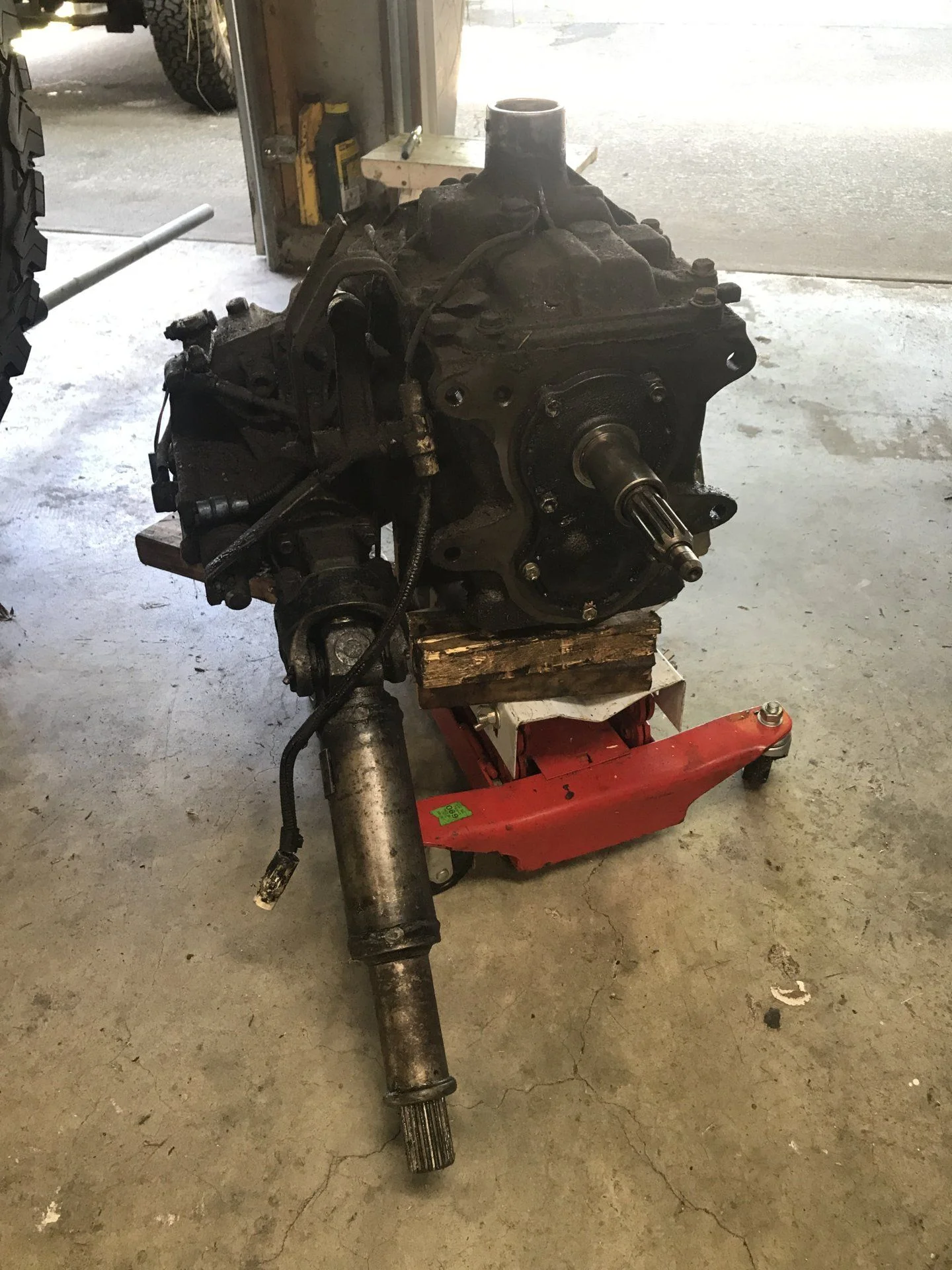

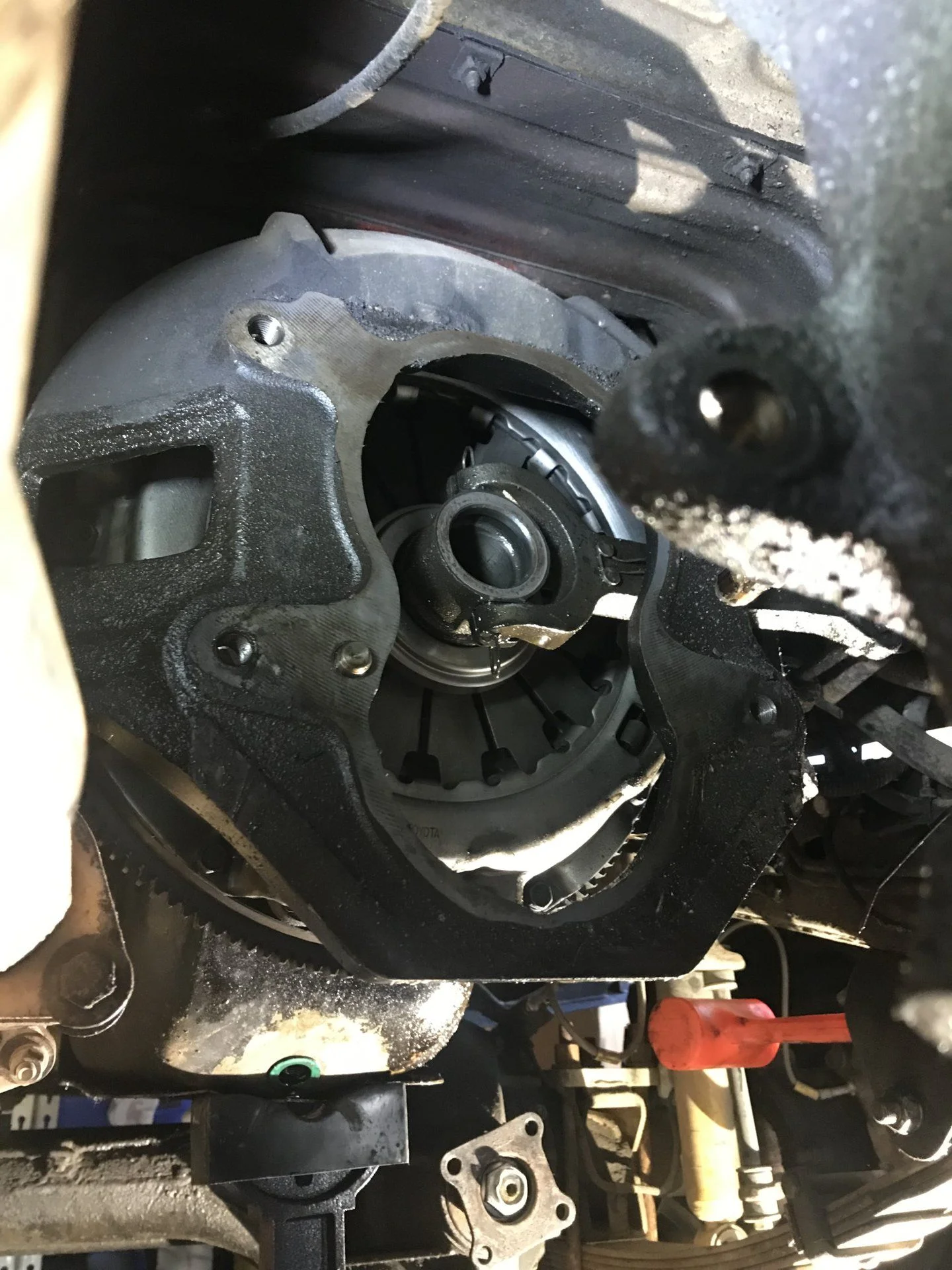

Moving forward on the split case.

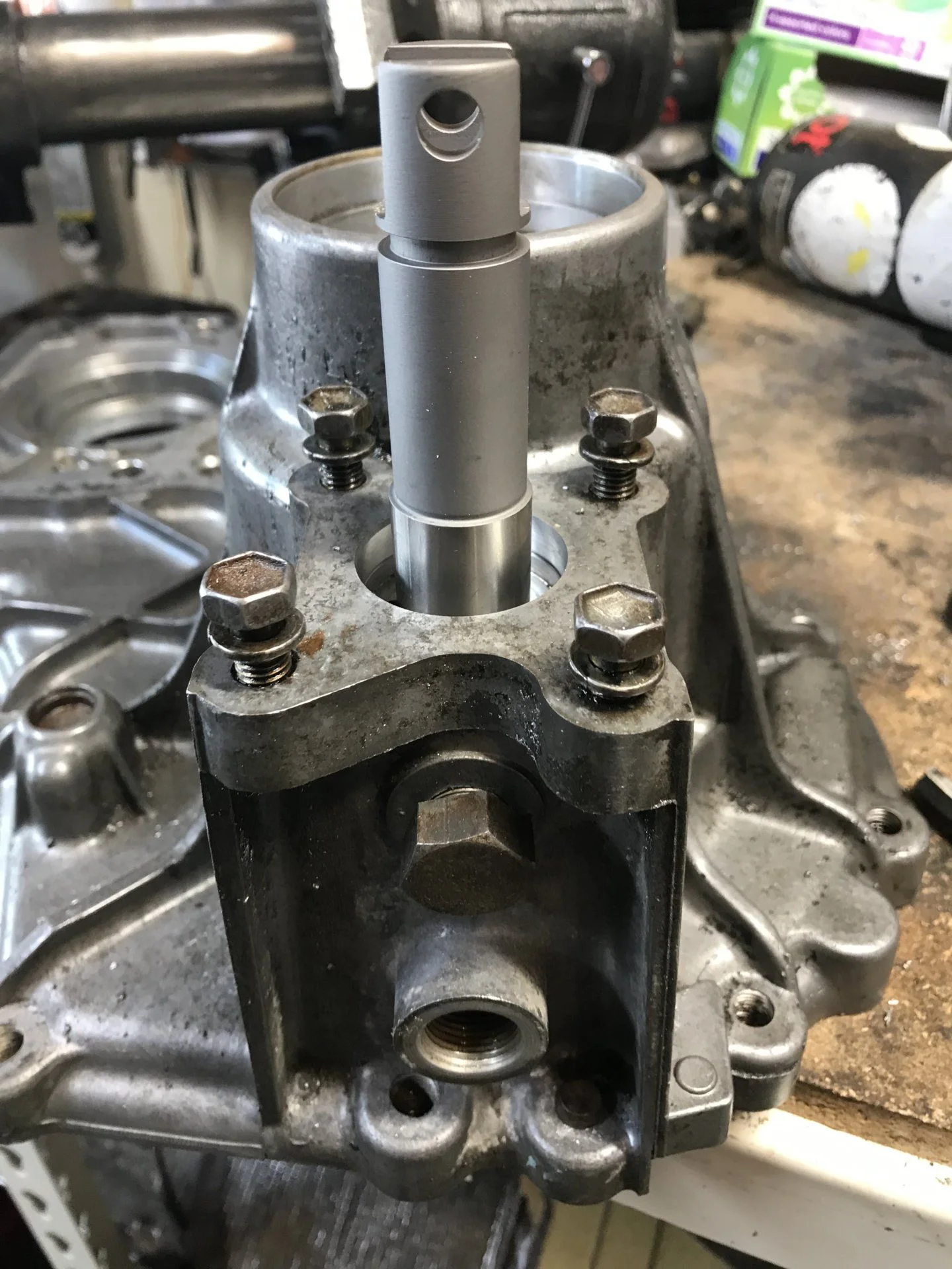

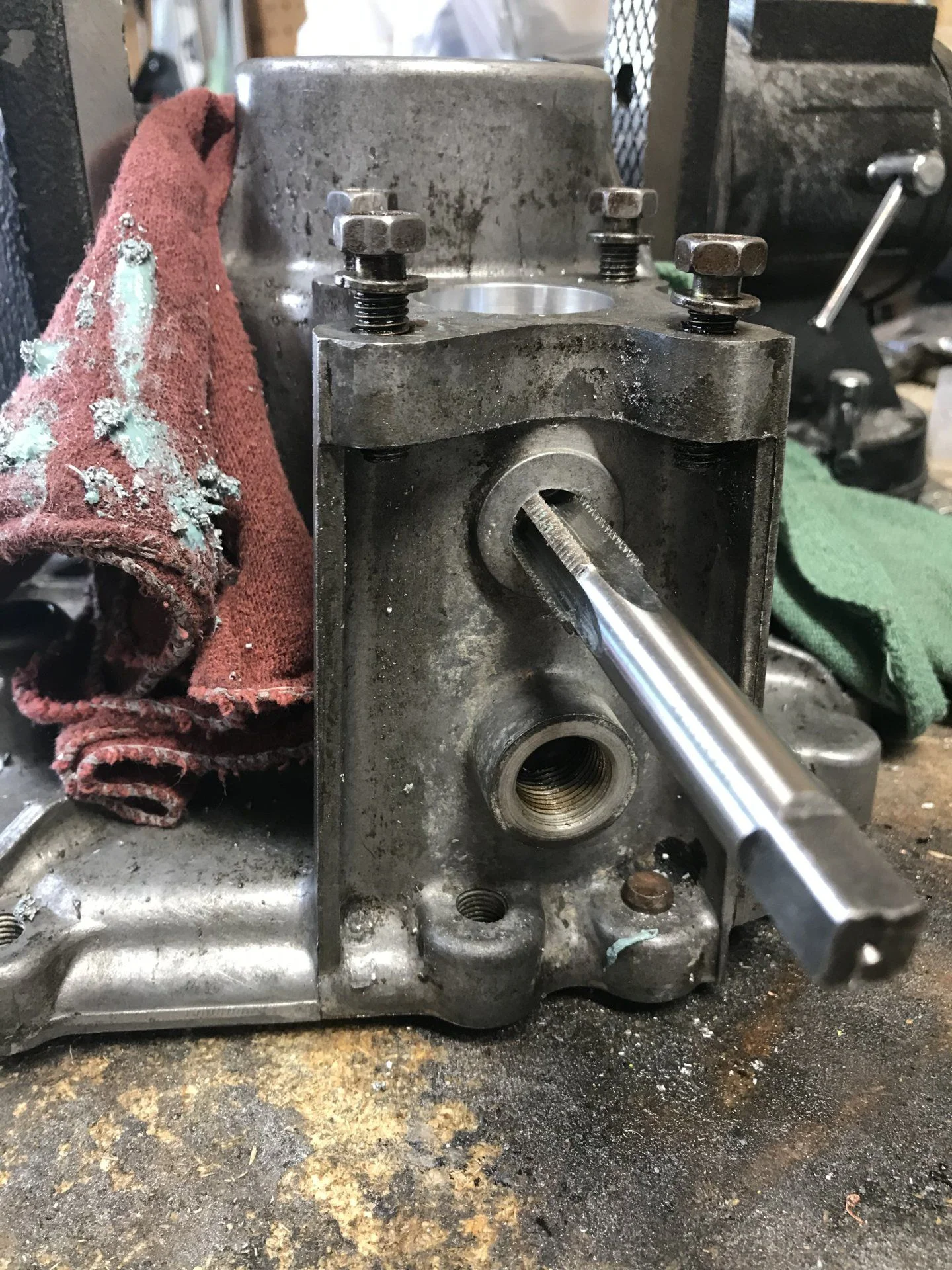

Vaccum actuated case was off a HJ61 needed to drill out the blank boss up to 1/2 bit then tap with a M15 x 1.5 in order to hold the ball dent on the AA shift rod.
Don’t drive the split pin in to hold the shift fork on backwards. They aren’t much fun to back out and re-use.
Is that just a core that you’re rebuilding and installing? Looks like twin sticks?

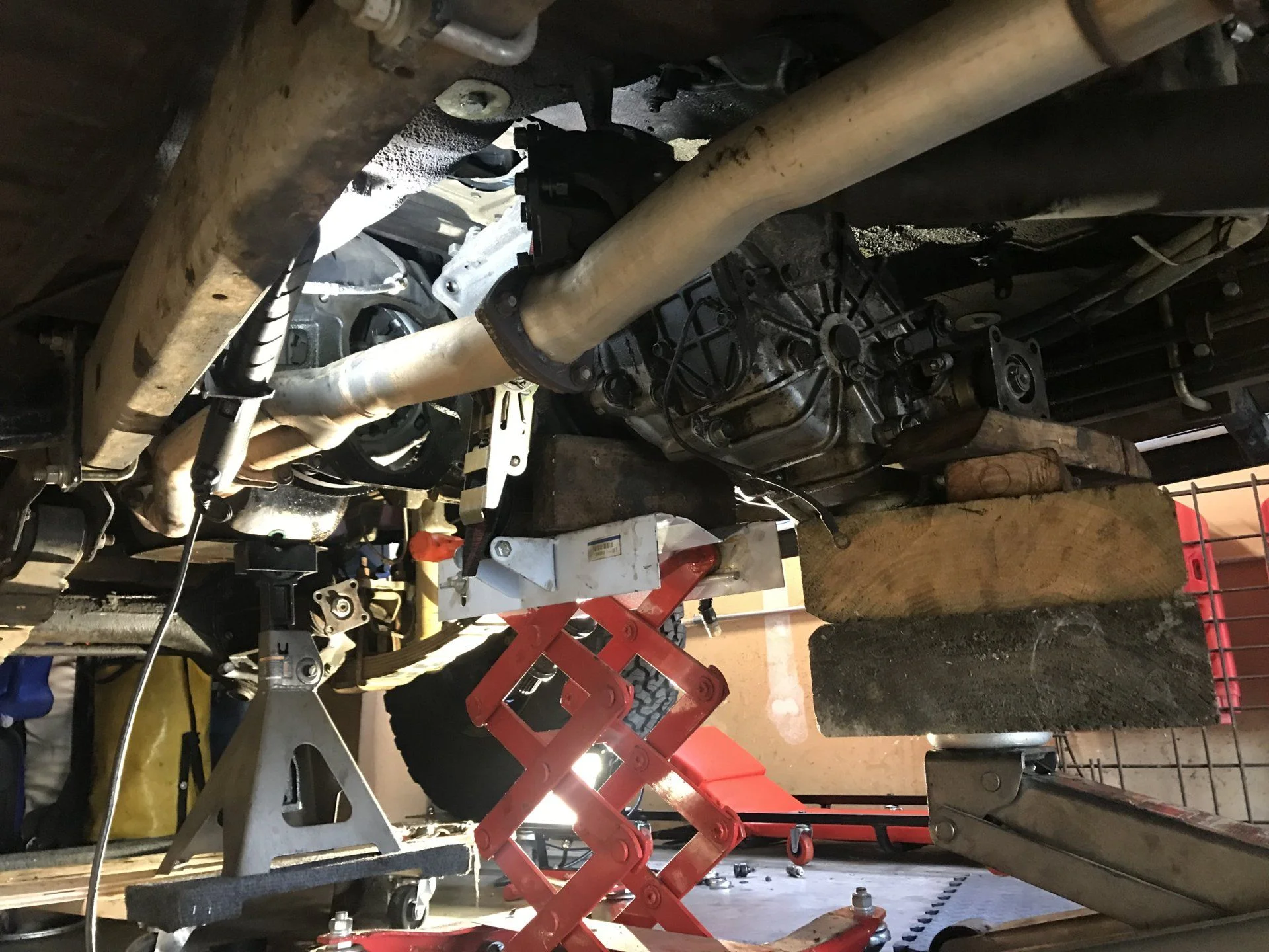

Yah, hope to have this 38mm converted to twin sticks and mates to the h55.
Drop and swap. 🍻
Plus new RMS, all clutch parts, & oil pan gasket.
The plan is to get this finished in June.
