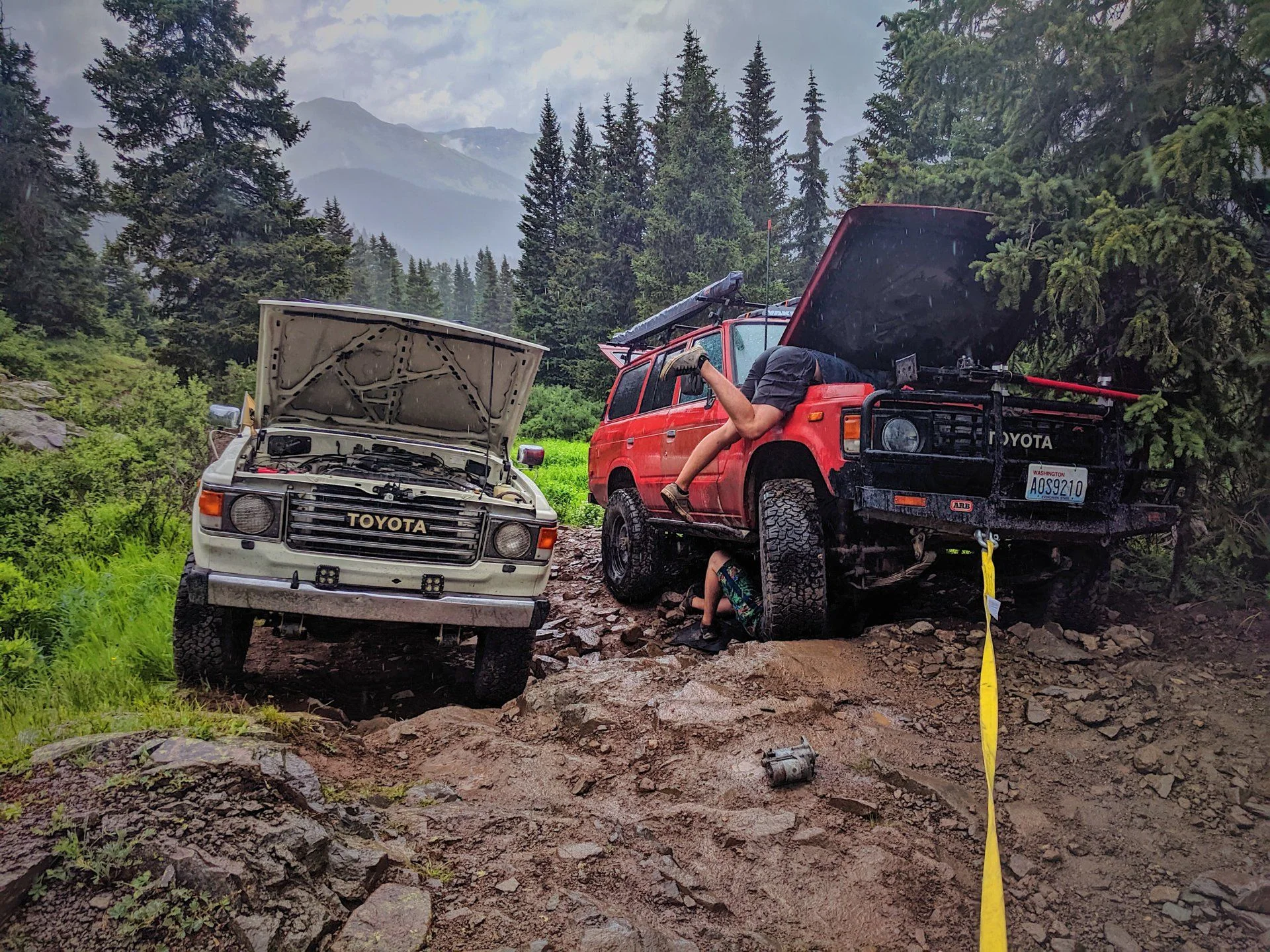

Thanks to @Well Sorted, @abtx4x4, @gt7058a and @shastariver in the photo here (uptop) for helping with getting out of this spot.
Tried to climb up this step, went to far outside and drivers rear tire dropped off the trail.
Ended up stalling due to the nose-tail angle (fuel pump couldn’t push fuel up to the carb.
Starter died, so we pulled a good know one from @gt7058a rig and started to install in my rig while it poured rain at 11,000 feet.
Poured gas down the carb and primed the fuel pump but couldn’t get it to catch.
Created a mini gas tank bungeed into the engine bay with a one gallon arrowhead bottle. Yanked the flatline hose off the hard line and fed it into there.
And was able to get it started.

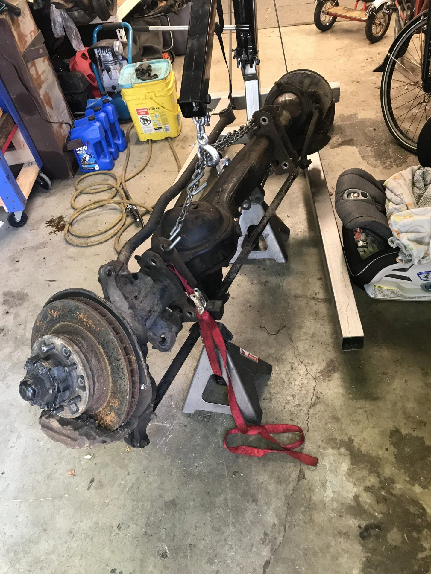

Don't you already have IFS hubs/tundra brakes? Why swap to weaker differential and a more difficult steering setup?
Thinking about the plush ride on/off road.
Current 70 series use a 8” front diff and coils and rear leaf set-up.
In retrospect I would have rather skipped the Tundra/IFS set/up because I’m going to change it all again. I figure a buddy might have be interested in the current axle.
I have a set of locked 80 series diffs that need new actuators or cable set-ups.
Coils up front and an engine swap and this gets much closer to the end result I’d like to see for this rig.
Ok, but why not just convert to a type of coil spring with the 60 axle? The extra axle housing width on the 80 axle is nice but that's about it. Are you wanting to use the 80 radius arms and stuff?

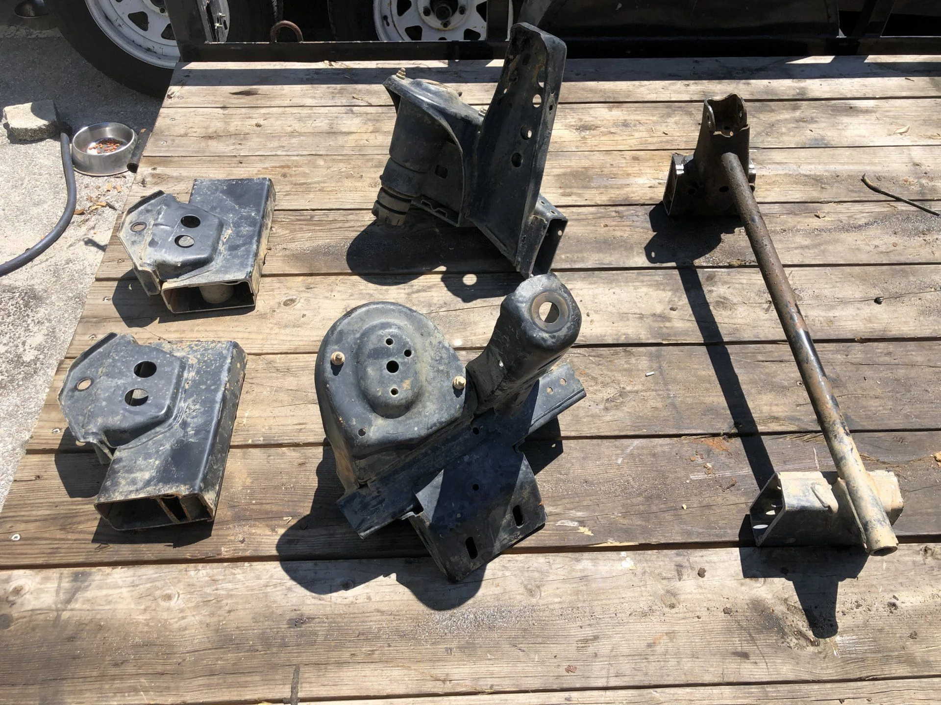

Realize that while an LC enthusiast, I lack the engineering and fabrication side that makes 3 Linking or 4 linking the front end realistic.
If I have eluded that I’m that rad l, then that is social media/forum distortion. (Sorry.. not sorry!)
I’m less than 10 miles from Torfab and follow what they do pretty closely. I typically order parts or stop in 1-2x per month.
You commented on the kit they shared this week about the approach they took on adapting 80’series suspension to a 60 frame. Also how 80 series axles will be in short supply if it takes off.
All things considered, if they are offering an “every man” coil spring set up on a 60
then i’ll Be the first to give it a go. I’m not looking to get crazy and add a bunch of engineering (on my end) or complexity. But fall in my lap suspension benefits I’m not sure I can pass on.

I'm not crazy about 80 suspension (especially when lifted high) but that being said it does work well for 99% of users out there. I'm sure it will be a great fit for your rig. I just like to make sure people have really thought everything through before a big round of mods. :)
I actually think youll be ok with the 8" front diff. People break them yes, but I doubt you'll beat it hard enough with wife/kids as passengers to do this. (it seems that family hauler/wheeler is your goal)
