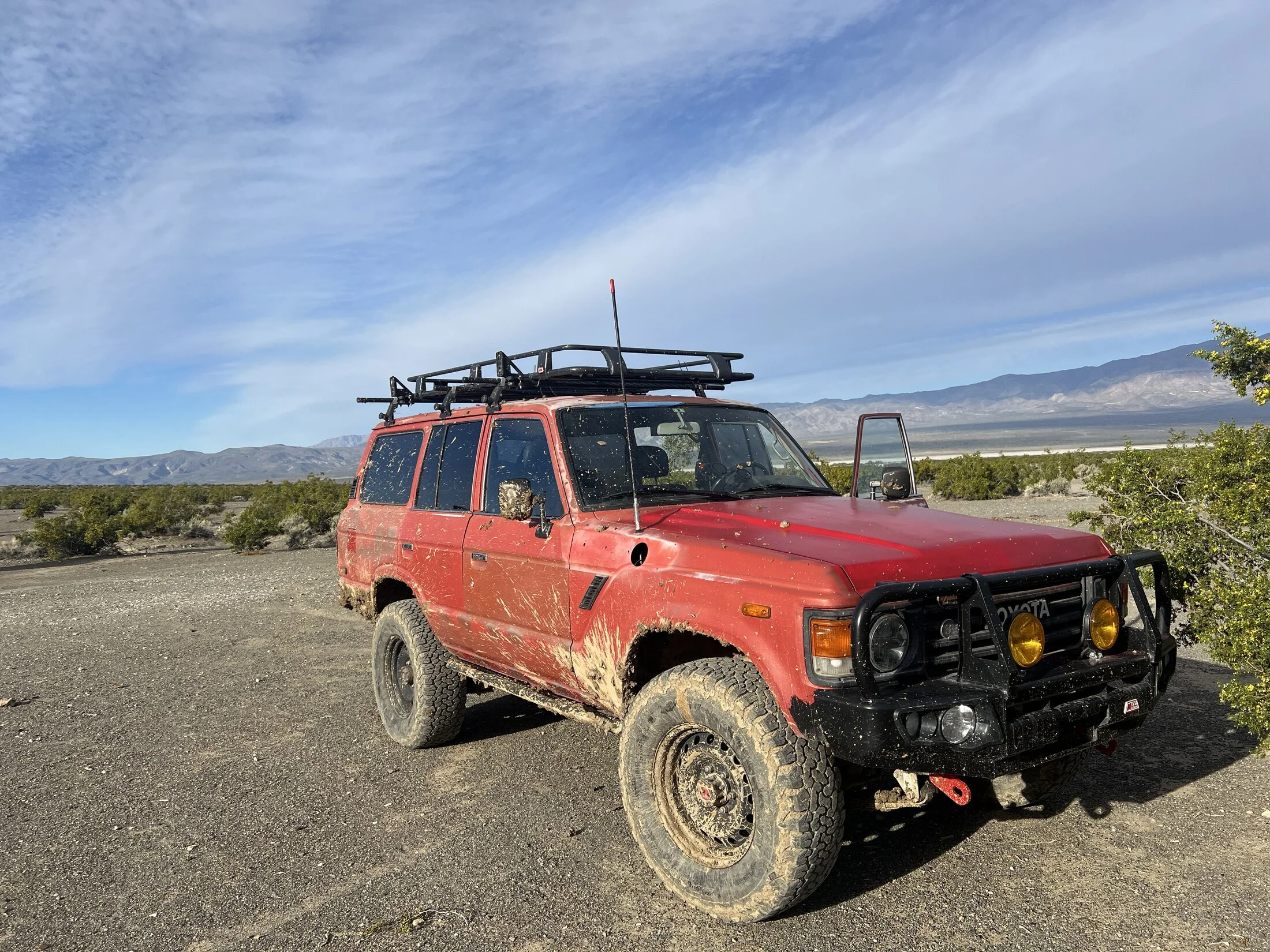

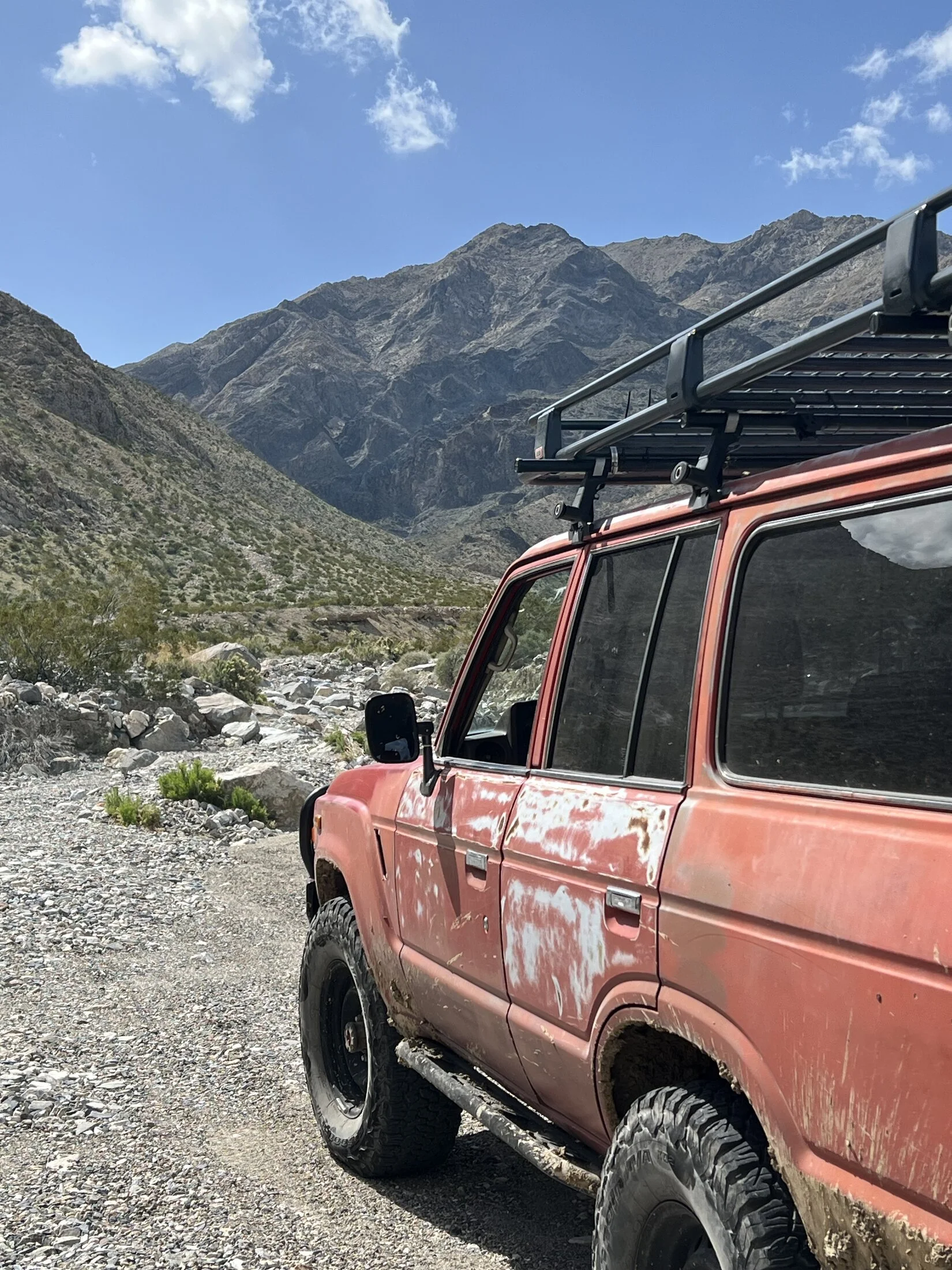

California hasn’t been the kindest to him the one trip he has been on while here was out to Death Valley and I drove into a salt flat thinking it was a road in the middle of the night trying to meet up with someone.
I should have immediately washed it off, but didn’t and it really did a number on the truck. Even after a wash with Salt Off.

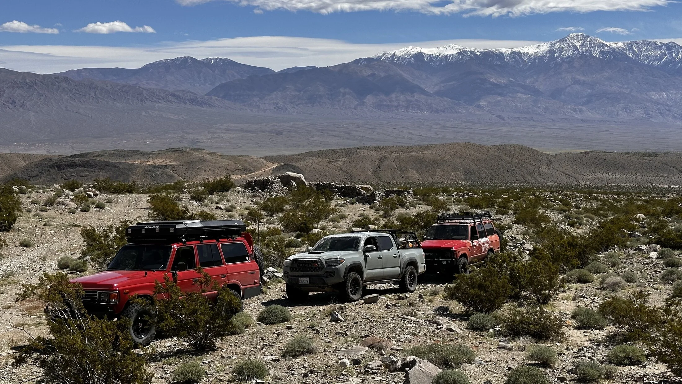

Death Valley was very cool. I went out and had a 24hr blitz with @Bullzi and his Dad.
I’ve gone out one other time but took the 100 since it is set up for camping a little more.

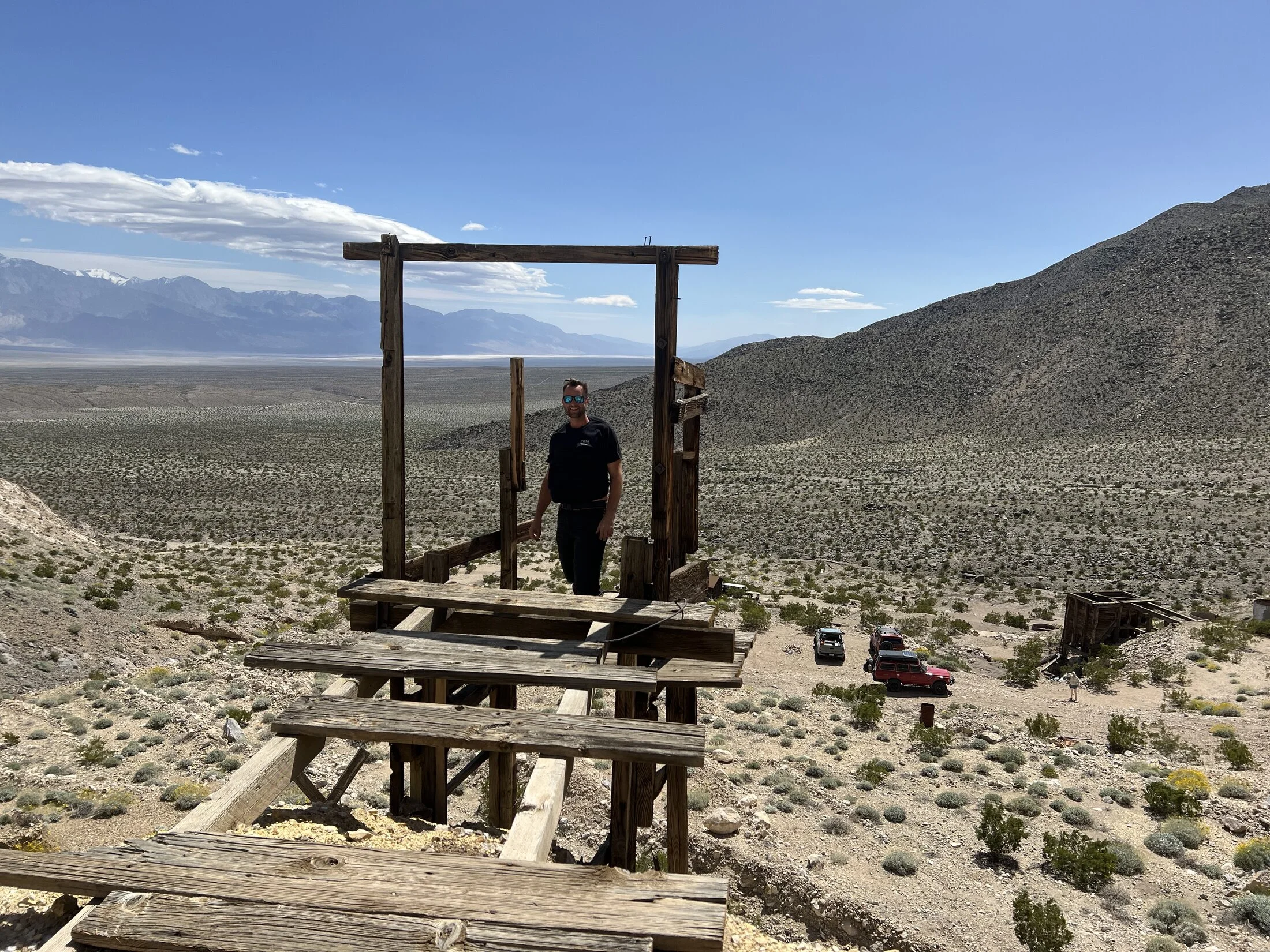

I’d have to look at a map to figure out what mine this was but it was pretty impressive.
On the last trip I checked out defense mine and that was pretty amazing. Largest mine I have explored.

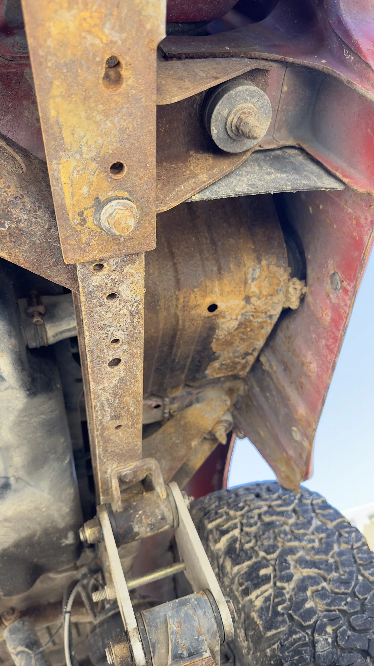

Needs more cure time and probably another coat.
Using Corroseal and other than it drying in my hair it has been amazing.
You can tell what areas have been coated if you zoom in on the background photos.
Muffler and diff hasn’t. Leafs and frame where I could reach.
Kinda wish I had sprayed it vs brushed to get into some really tight spots.

On the corroseal did you paint it or run it as is? Looks great. One of my favorite threads
Currently running it as is. As in no prep, just paint it on.
Supposed to scuff/wire brush it. Then degrease.
Skipped thet due to time constraints and anything is better than nothing.
Will go over the whole thing properly in the future. Just wished I had done this 2 years ago.
Plan is to corroseal then top coat with rustoleum implement paint.
Frame shot.
Can kinda compare left to right on the front leaf packs here to see treated vs not.
Rust will come back through this. But with the proper prep it is supposed to be a perfect convert and prime in the same application. Then paint over to sealed protection.
