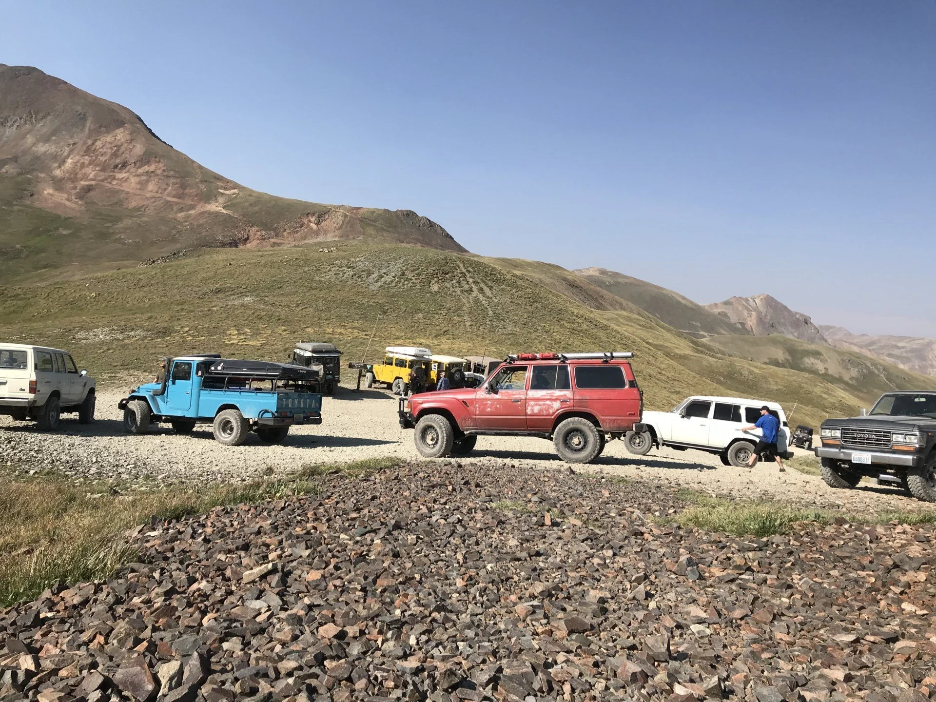

SAS was a blast. There are many really great cruiser people out there in the universe and for one week they come together and hang out. If your reading this, you should consider it for 2019.

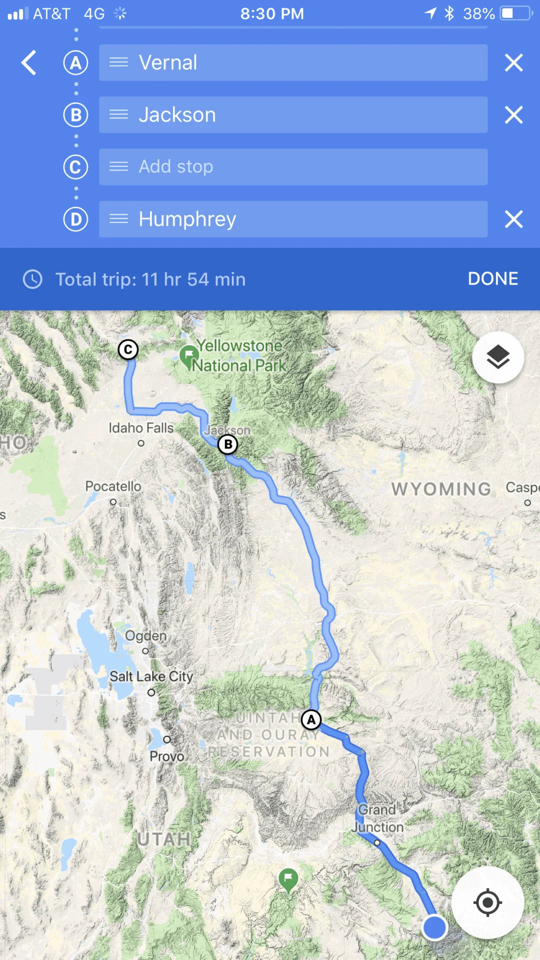

The drive out was a bit hectic, drive back was amazing. Solo parenting is hard, but it was all part of the adventure. I had a great support group on the road. Both @Kleatus for the ride there and @gt7058a for the whole damn ride.

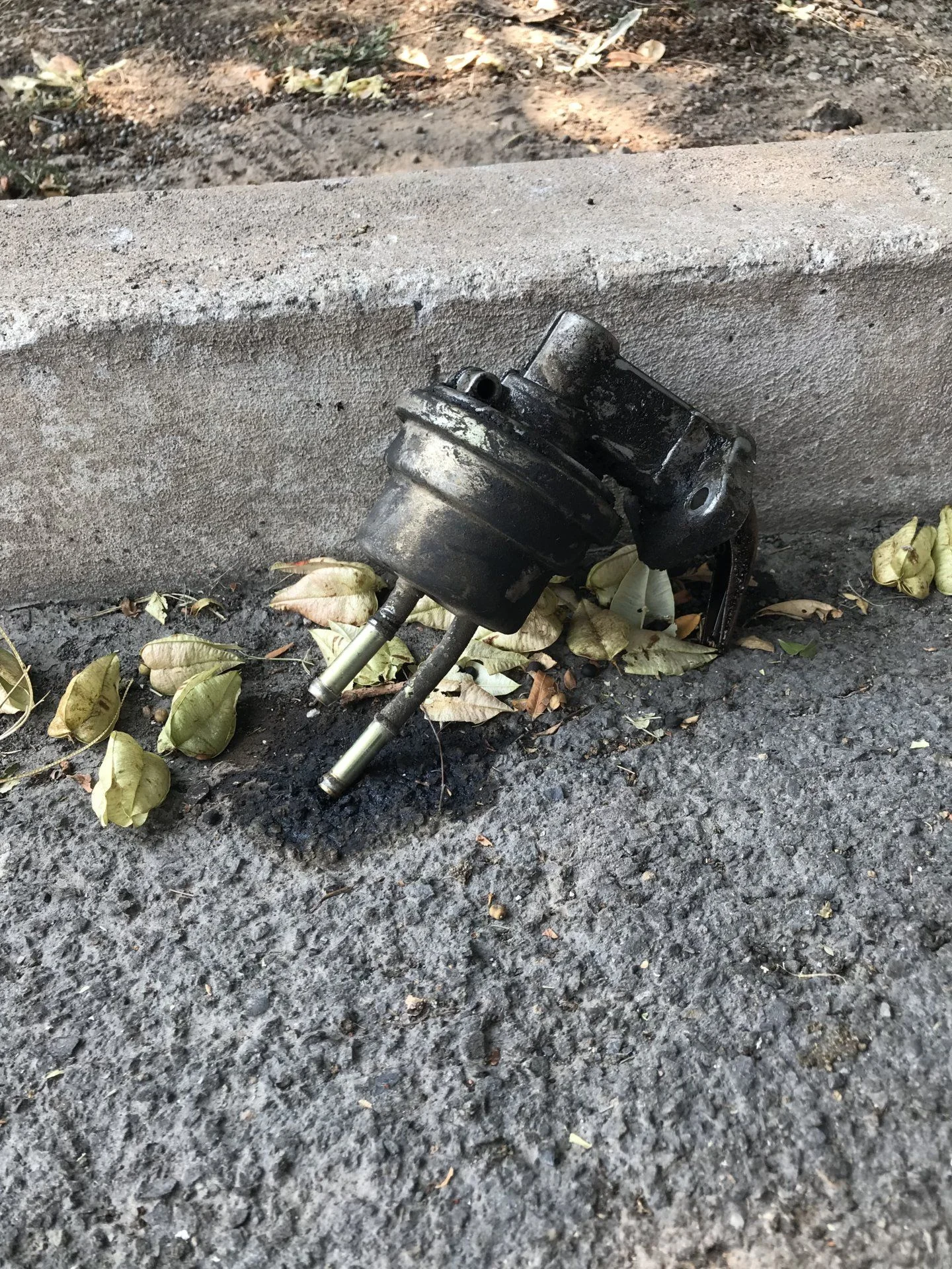

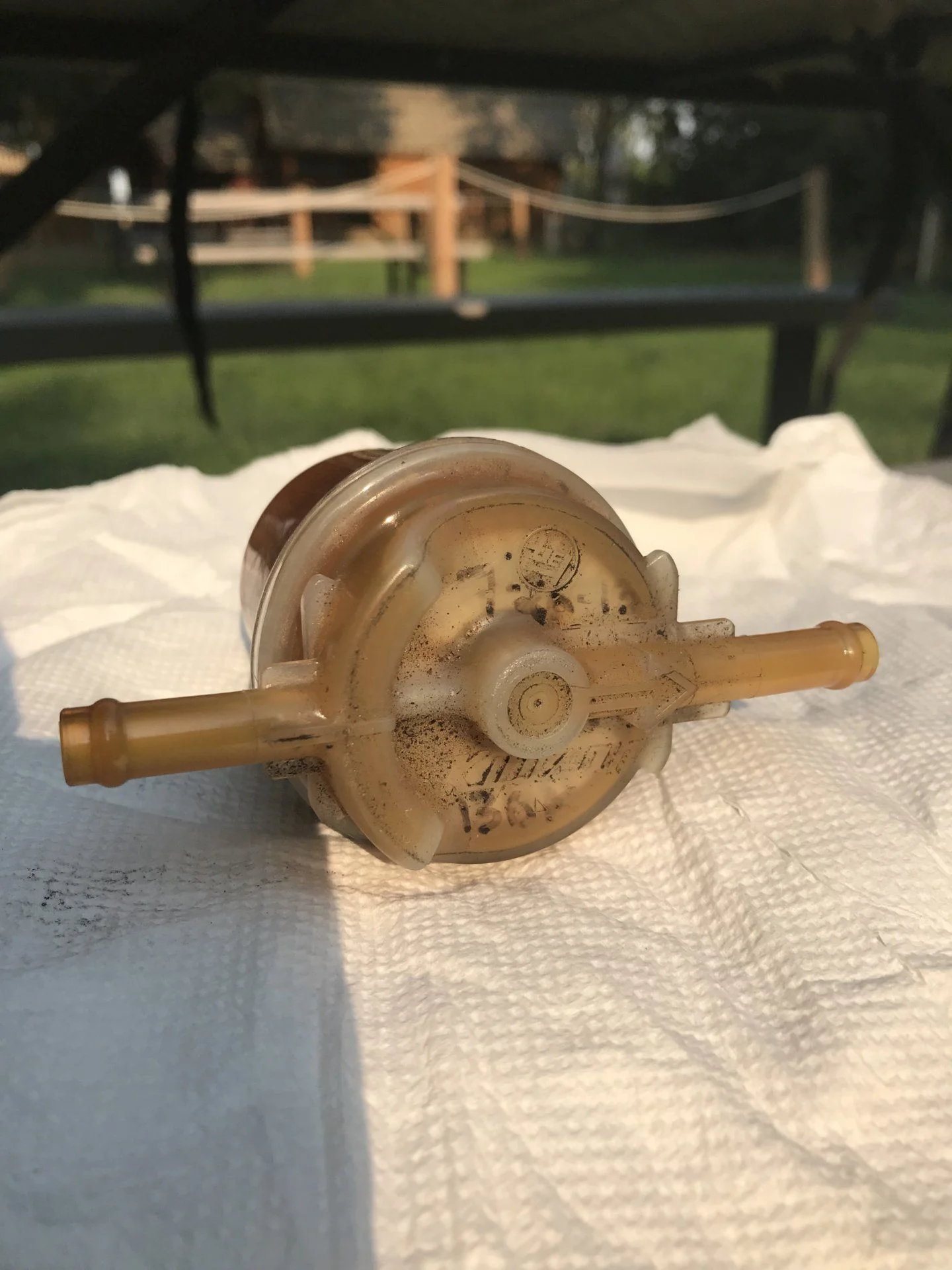

Replaced a fuel filter. Thought it was the issue on the road to CO.
Fuel sender stopped working in Twin Falls, ID.

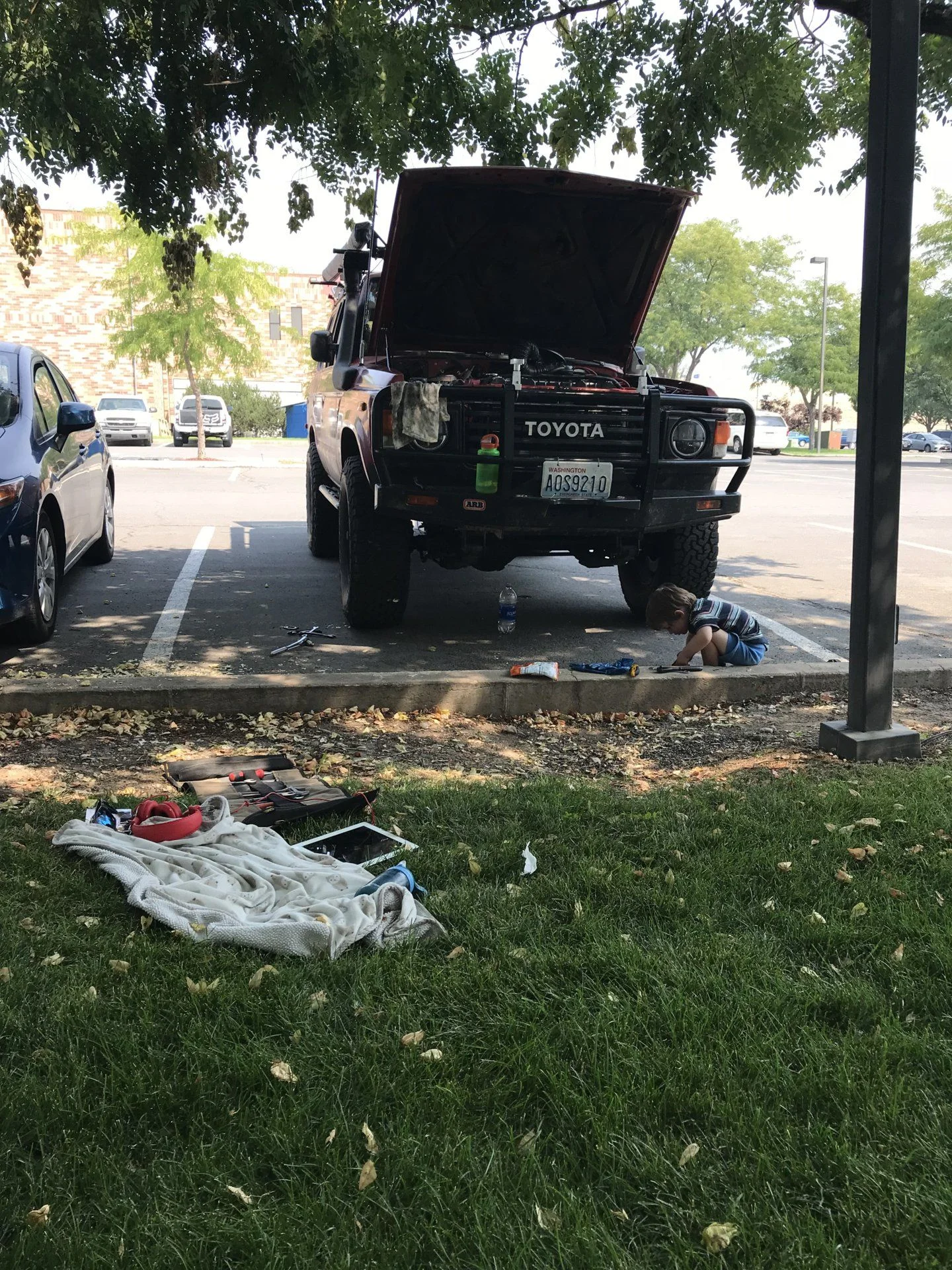

Replaced the Fuel Pump in SLC. Thanks @cruiseroutfit for the amazing drop in customer service.

We brought a little toilet but he didn’t want to use it since it was for babies. During our parking lot fuel pump change out.

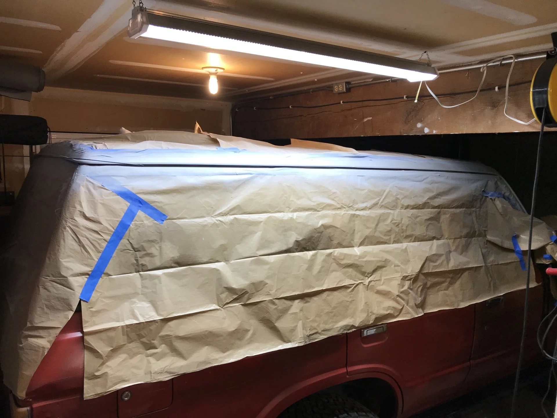

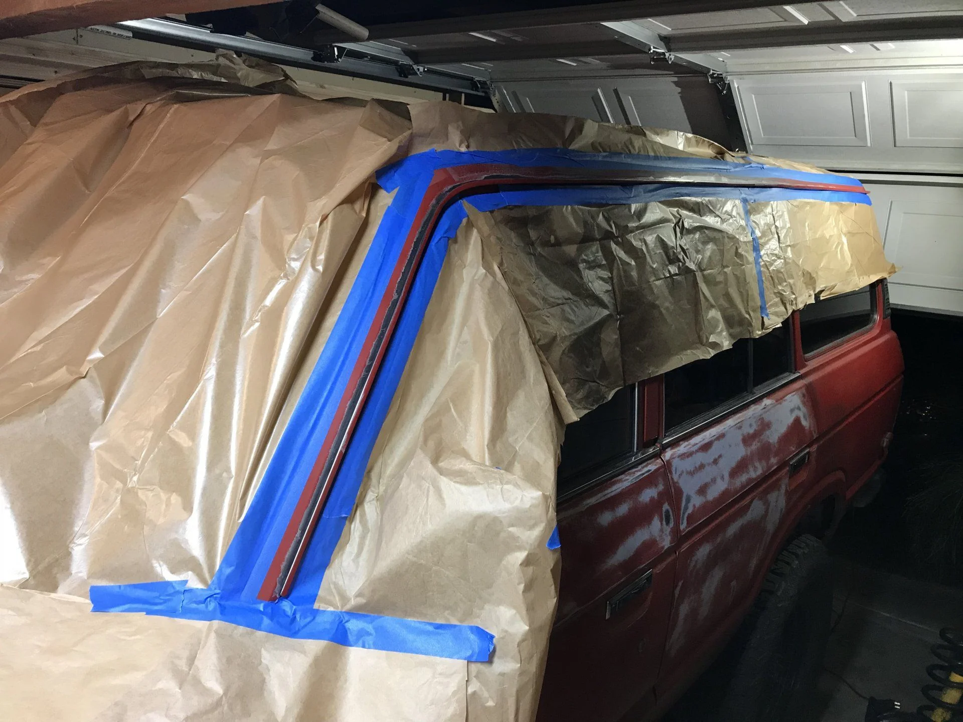

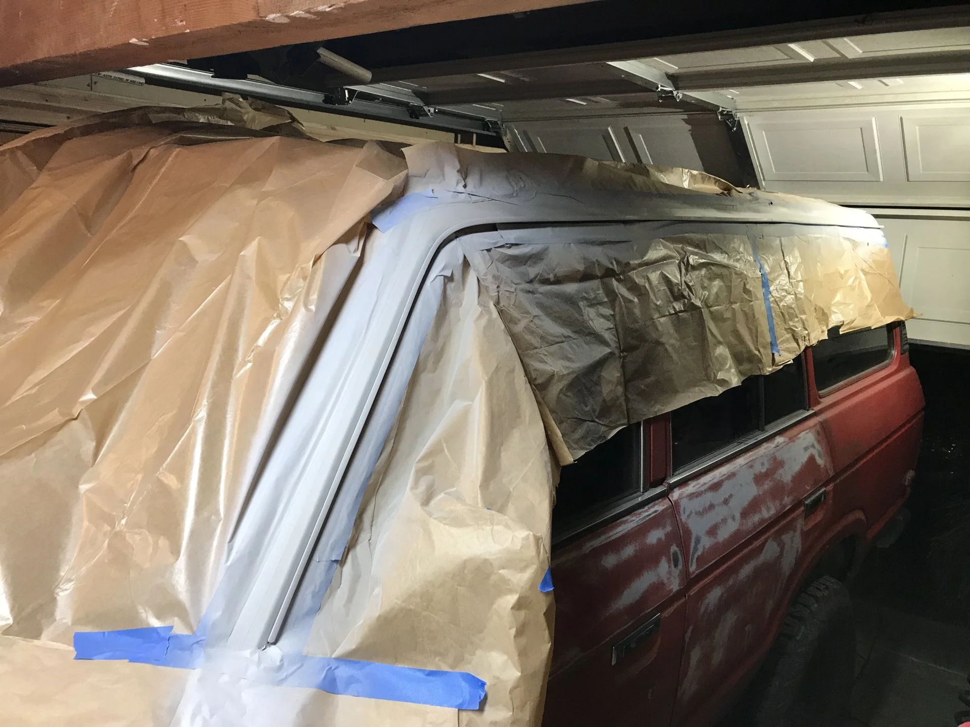

Removed old sealant with a heat gun little hooks and flat head screwdriver.
Wire wheeled to clean metal
180 grit sanded
Rust converted where I couldn’t reach eight he wirewheel. Then washed with water and dried with heat gun.
Cleaned/degreased
Tack cloth
2k epoxy
Will post up more photos of our process tomorrow. Maybe make a thread on the process.
