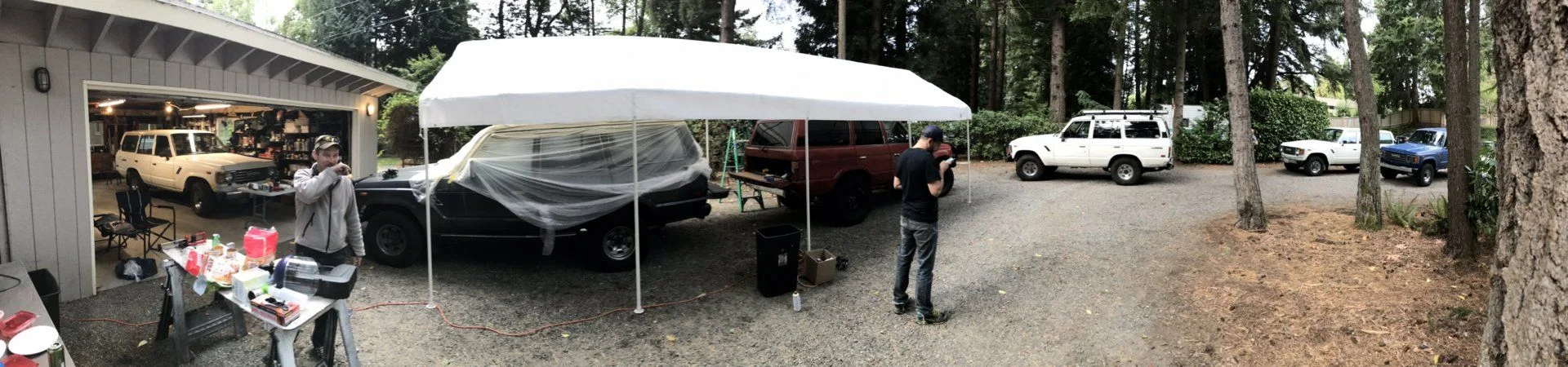

Cleaned up and re-sealed the Raingutter s on a few rigs last weekend. Pretty fun crew: the photos tell the tale.
Pre Party Prep
I need a taller garage.

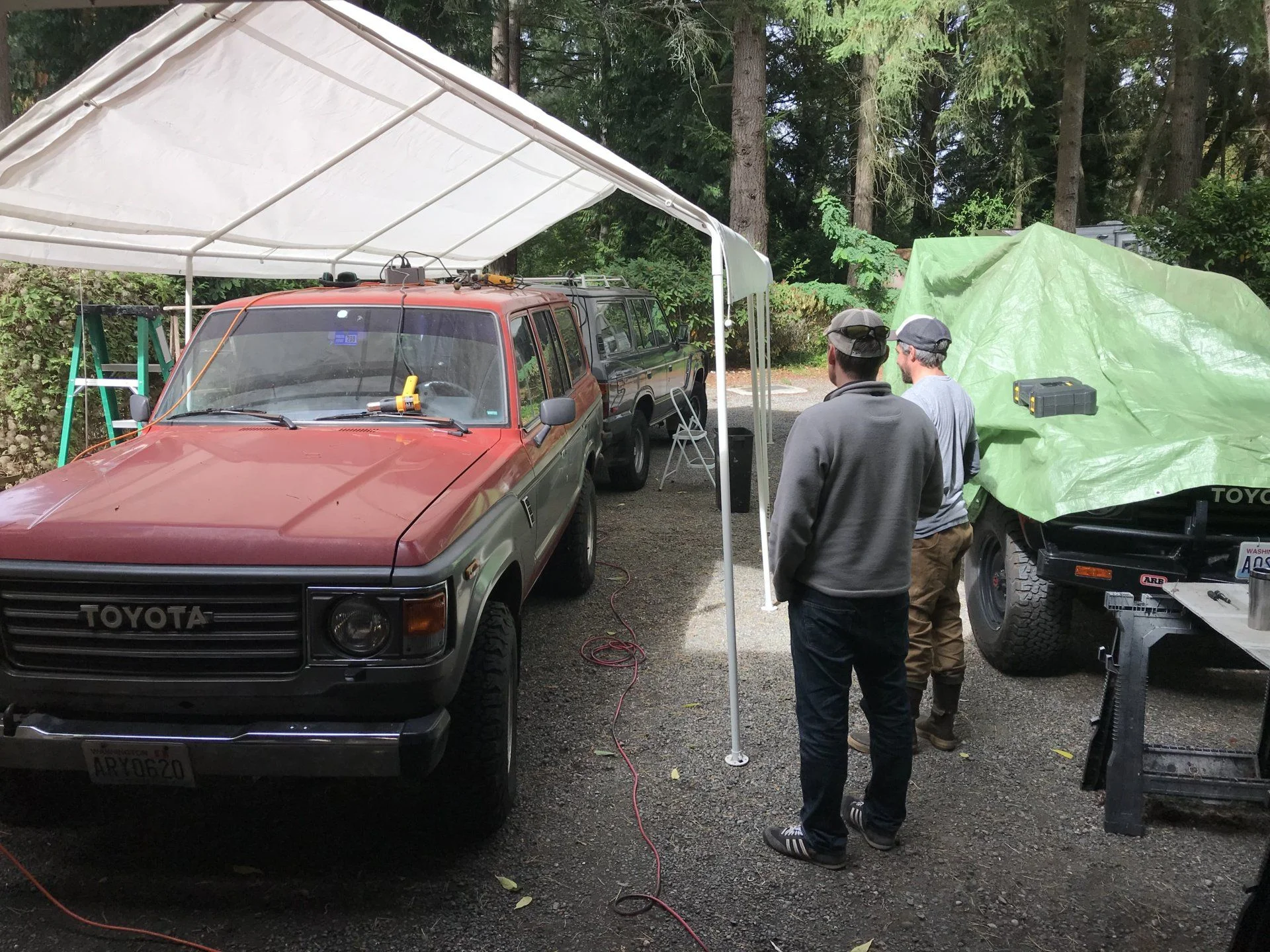

1. Heat gun to remove old sealant w/picks & flat screwdriver.
2. Wirewheel
3. Rust convert
4. Wash and clean rust converter w/soap and water.
5. Sand with 180 grit. Wipe clean.
6. Clean with degreaser
7. Wipe down with Tack Cloth
8. Spray 2k epoxy primer.
9. Use 3M control flow sealant. One tube is enough for whole rig. (it comes with a mixing tip, they have different colors so Amazon shop accordingly, bring a friend with a few steps stools/ ladders and a couple acid brushes to spread evenly)
Real deal Gutter Party!
Thanks to @KeilOver for being a gracious host for the event. Tacos and a super tent? Who does that?
In total we had 7 rigs show up with 4 getting resealed that day.
