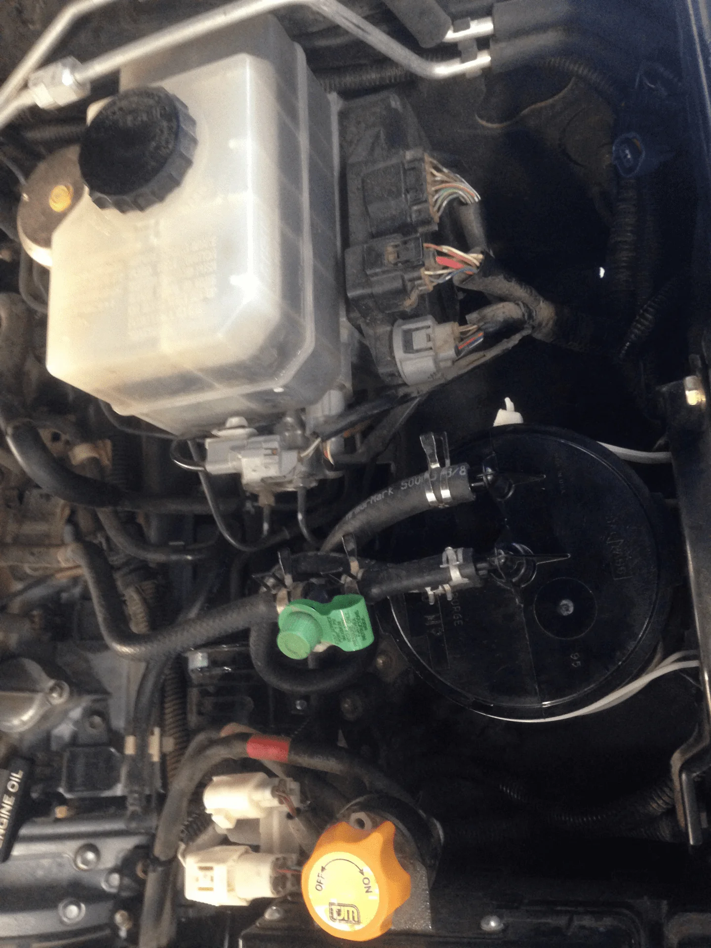

Here's the AC Delco installed.
Now, the plumbing....

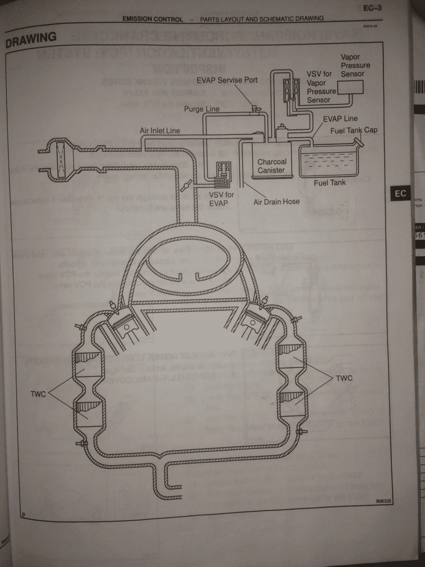

This pic from the 2001 FSM is helpful to know how the OEM system works and which lines to connect to the AC Delco.
The Air Inlet line is the one we delete with the 3 terminal AC Delco Canister. Everything else is the same...
OEM Purge Line goes to the AC Delco Purge Tube
OEM EVAP Line goes to the AC Delco Tank Tube (I moved this line to the top of the filler tube vent line on my setup with the aux tank)
OEM Air Drain Hose goes to the AC Delco Air Tube (Fresh Air Inlet). Remember the OEM has a separate in and an out here. The in comes from the intake plenum (filtered) and the out goes down into the drivers side frame rail under the battery. Don't connect the AC Delco Air Tube to your Intake Plenum...you don't want gas and fumes mixing in with the intake air, uncontrolled.

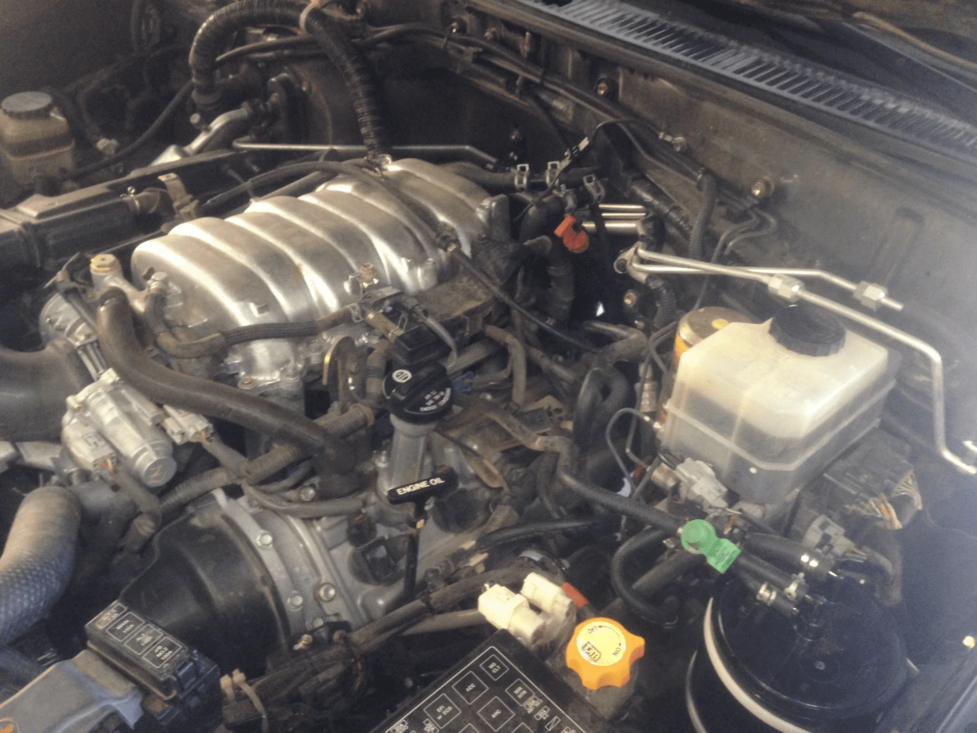

I plugged the hole in the intake plenum with a rubber brake bleeder zerk cover:
Here is the intakel line removed that ran across the top of the air manifold at the back:

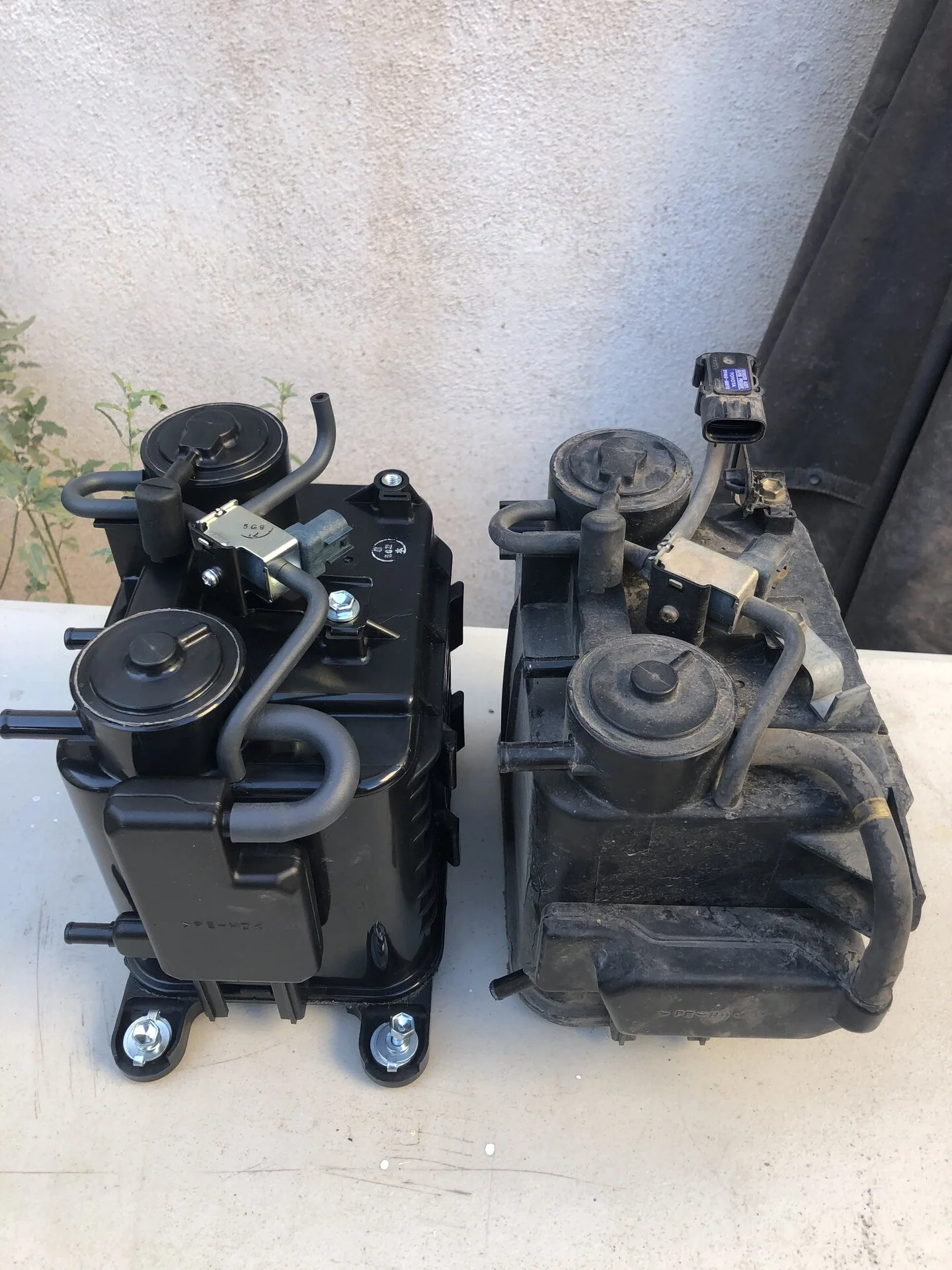

Installed a new Tundra unit (77740-34080) to replace my 2000LC unit (77740-60390). Original was still seemed to be working correctly on my last trip where I did have some fuel boil, and I just wanted to get a new unit in there. I did find that one vacuum hose on the new unit was not long enough to connect to the VSV I swapped over so I reused the old one.
I also was able to weigh the new vs old units with the old one weighing about a pound more.
New Unit:
Old Unit:
Old unit is free to anyone that wants it, otherwise it will end up in the trash.

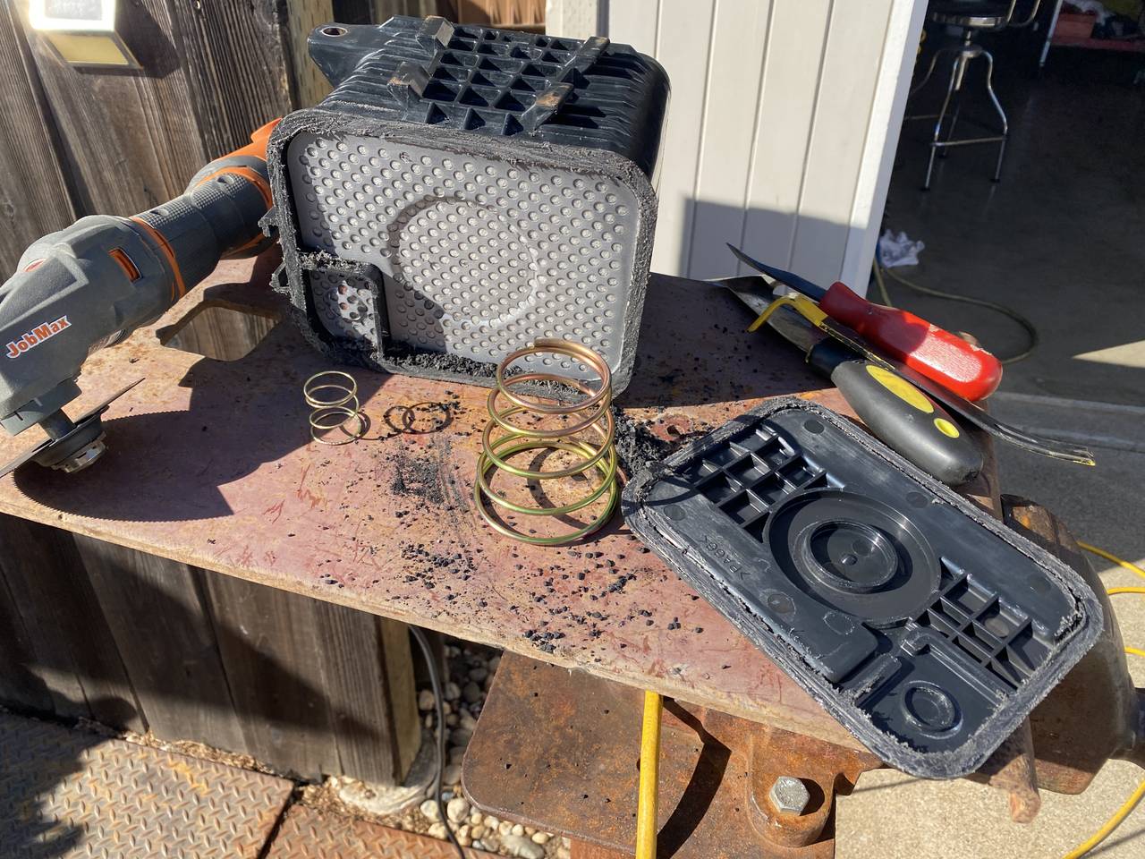

I finally dug into the canister project after having a donor canister gifted to me by #awesomeissquid. Thanks for the incentive!
The road trip last year put me on the path of finding out why with an ambient temp greater than 94 degrees (F), the fuel tank would pressurize and the fuel vapor would fill the engine compartment.

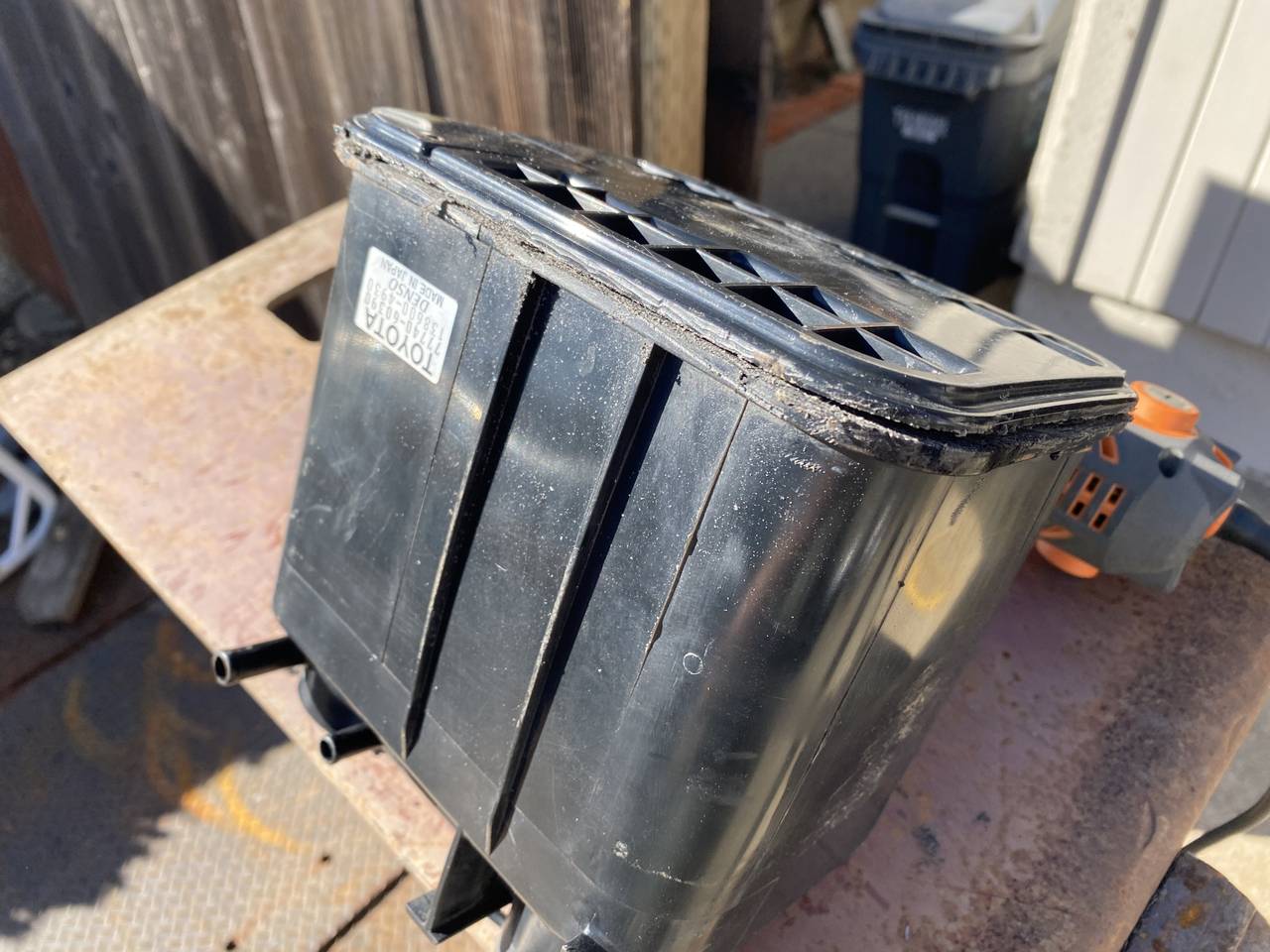

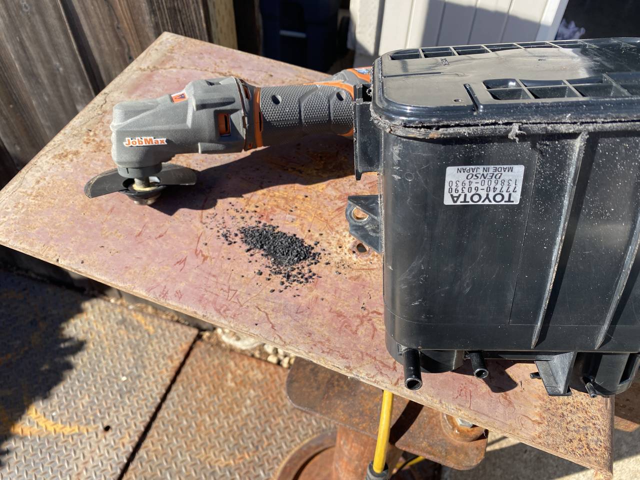

So with awesomeissquid's canister on the bench, the cutting began. First with a hacksaw blade, then a razor knife, and after no real success I went with a power sander/cutter with a half round blade.
Cut right along the bottom seam and found success. And when it's time for it to come off, look out with the spring pressure.

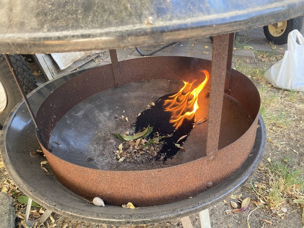

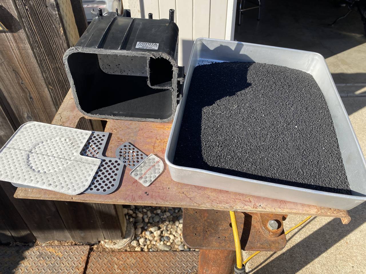

Carefully emptied out the charcoal and weighed it separately...... BUT, forgot to calculate in the added weight of all the fuel vapors, and how much charcoal can actually hold.

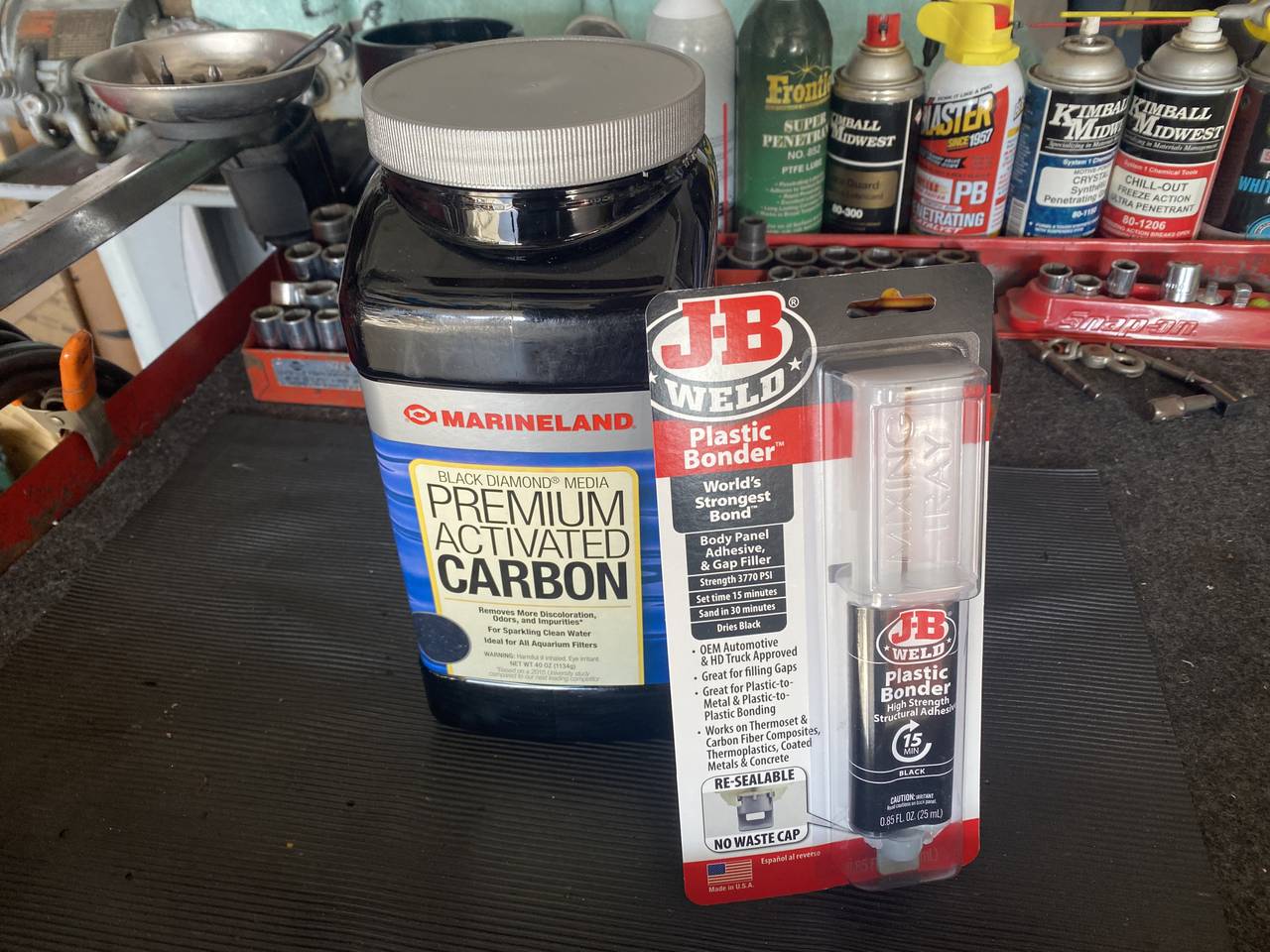

Thinking I needed that much weight of charcoal, I ordered two containers from Amazon along with the JB Weld plastic bonder.
The one 40 ounce container was more than enough to refill the cannister.
I also soaked and cleaned the filter pads of the cannister in Simple Green and rinsed them with water, then dried them for two days while waiting on the charcoal.

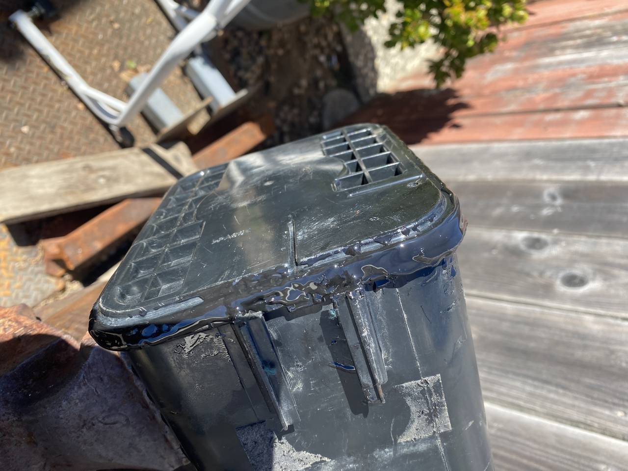

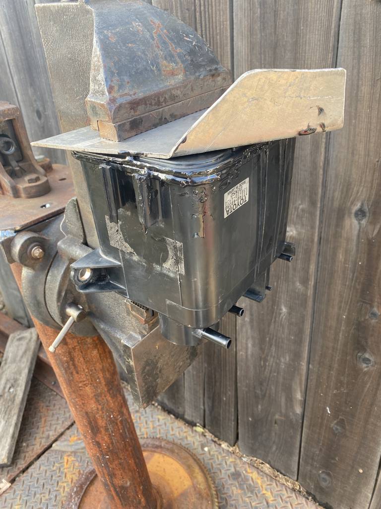

Came up with an idea of holding the cannister upright, so I made a vertical vise option on my vise stand for the epoxy to set and cure for 24 hours.

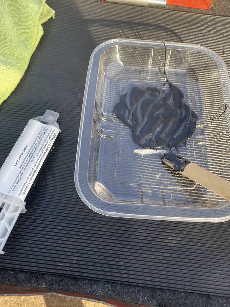

Laid a bead of epoxy around the body, then place the bottom on it with fitting the springs in there, squeezed it togather and let it set.
A day later, I went back and put another coating of epoxy around the seam to fill in any gaps.

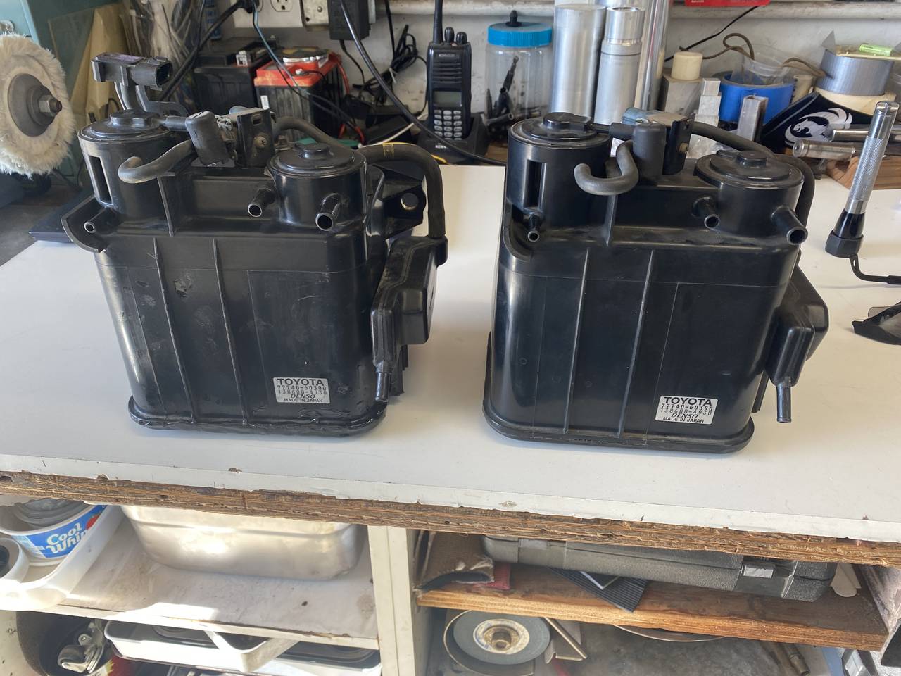

With the donor cannister done, I replaced the original and weighed them while they were both out on the bench. Fresh charcoal is about a pound lighter.
Installed, one drive cycle down and no CEL or codes so far. Going to start really checking the mileage now and hope it improves with this "upgrade".

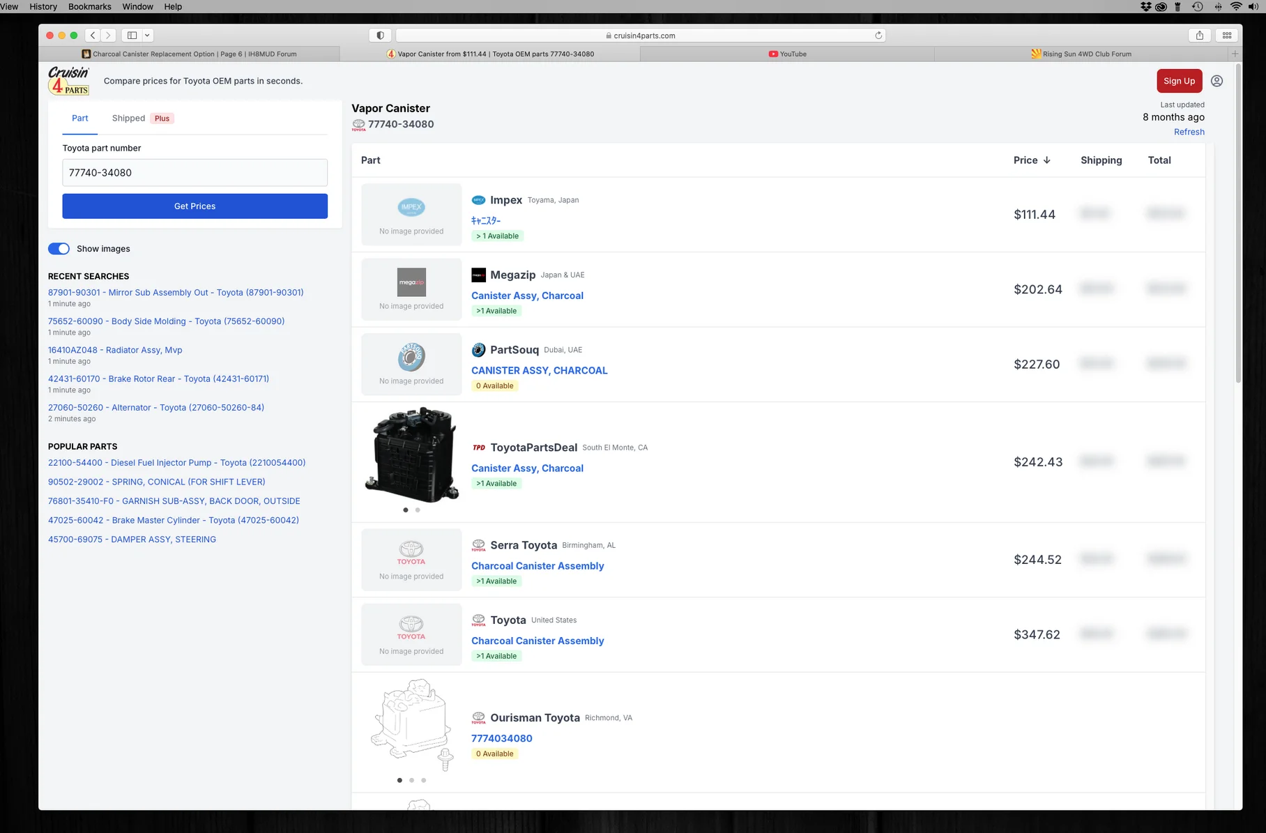

Damn! The 00-02 tundra canister is no longer on sale 77740-34080 does anyone know of any alternatives? Not on amayama, partsouq, dealers around here and impex! Plz halp
Alright everyone Amazon still has them, very strange and it’s shipped and sold by Amazon so it seems legit. I ordered 358$ it pains me but I feel like it’s worth it. Will update. If anyone has Jerry rigged any other canisters or found one that’s close from other vehicles it would give new life to these old cars.
