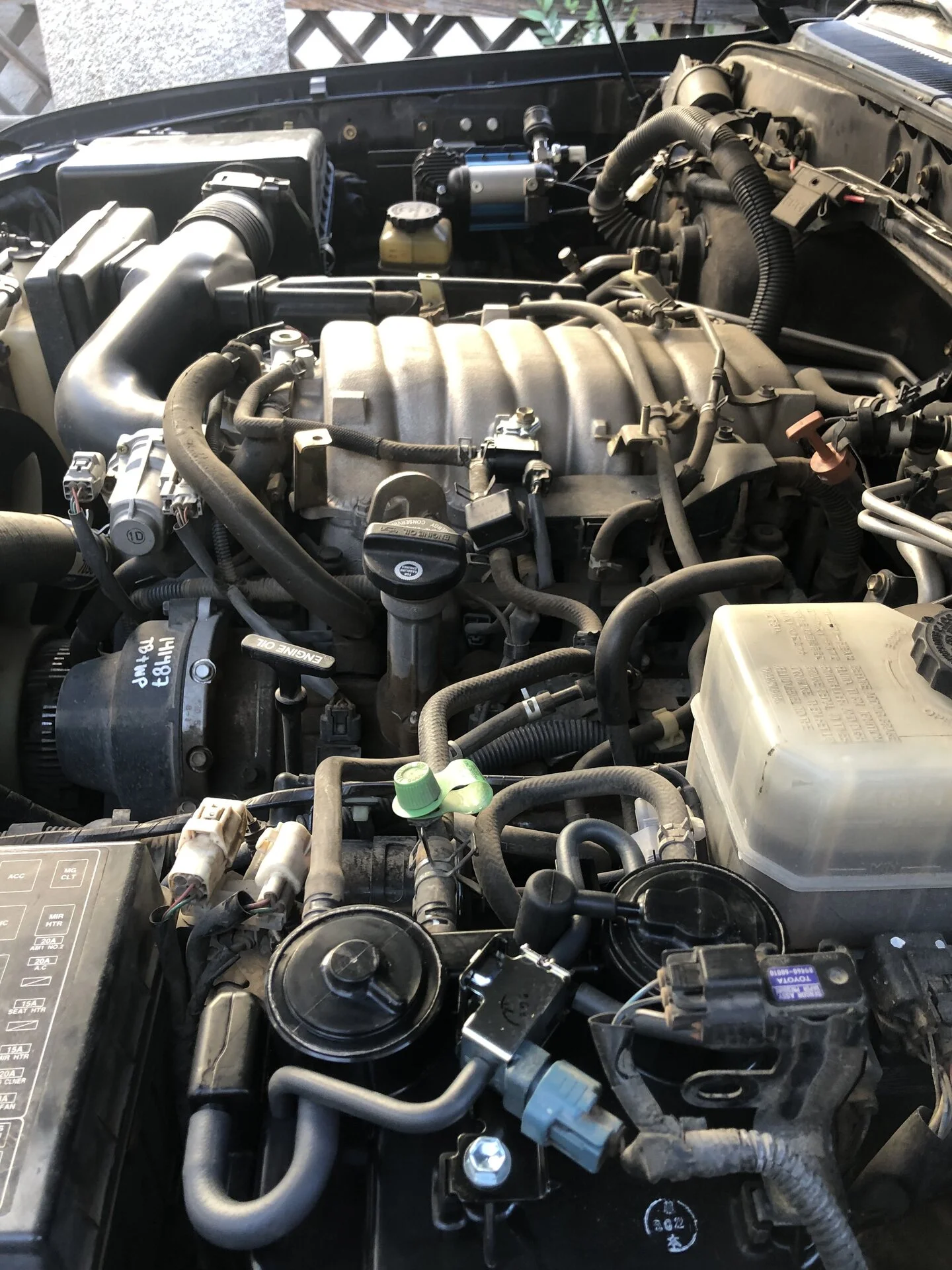

@89BIGBLUE so the electrical connectors are the same on the top? Also, did you cut off the ears or leave them on?
Electrical connection is the same for the 1 VSV that comes new with the CC.
The other VSV (tall one) is the one I moved to the new Tundra can from the old LC can, so those parts remain the same.
I had originally thought to cut off the lower mounting ears, but it is not necessary to fit the Tundra CC.
They do not touch the wheel well in my rig, but float just above.
(Seems the fender mount “slide bracket” bears the weight of the can just as it did with the LC unit).
