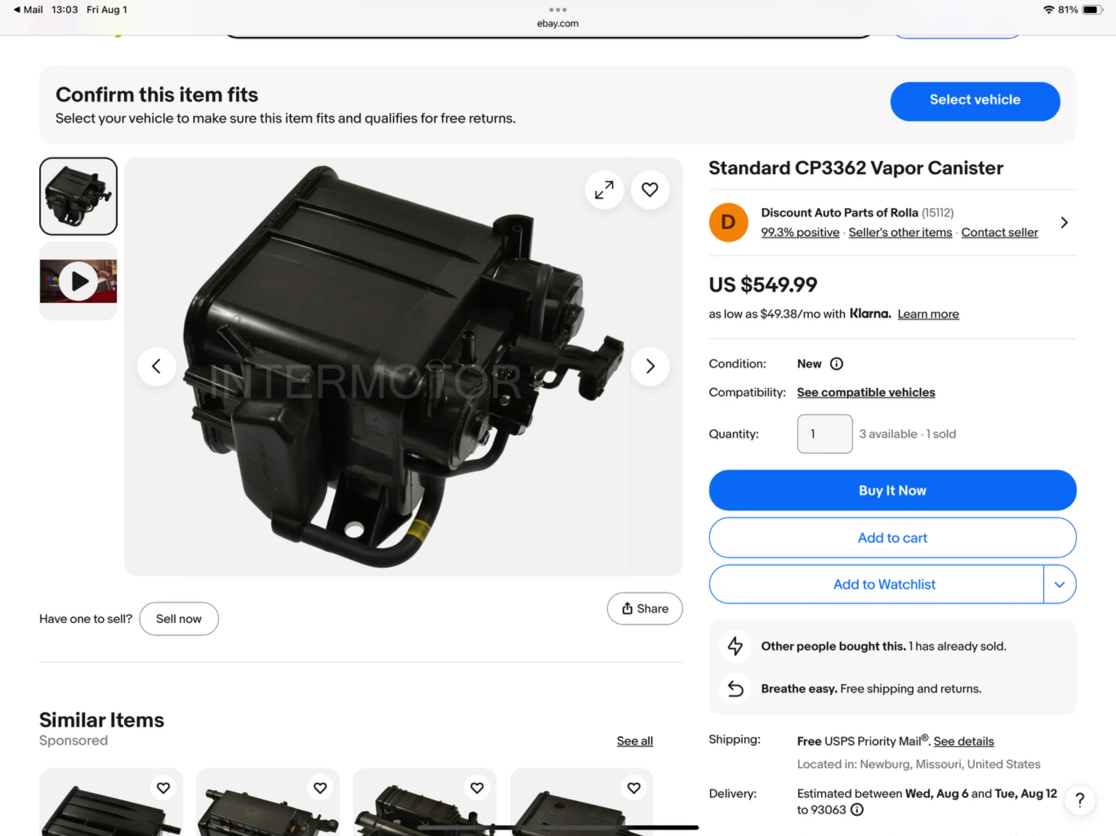

Did you pay $700 for the Wells unit?
I bought the tundra version. It was 400 after shipping and tax. Couldn't bring myself to pay 700 for a part that wasn't even oem

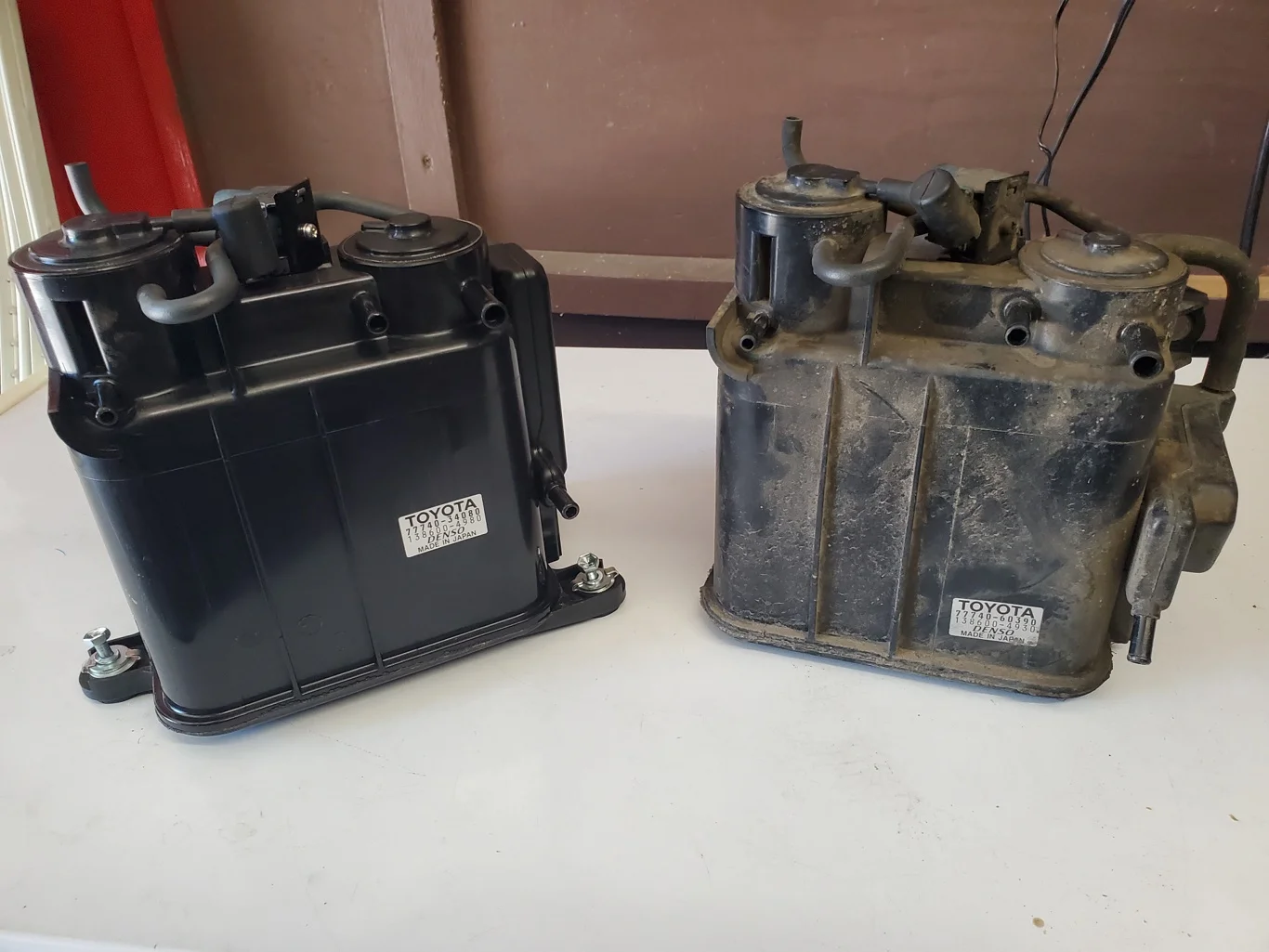

Well I got my charcoal canister. Opened it up to a fun surprise!
It's actually the Toyota/ denso CC!
This was the tundra canister which i bought because it will fit and its cheaper than the LC one. The only real difference is the mounting hole locations. I thought I'd need to cut off the tundra mounts but it wasn't even necessary. The whole thing took 5 minutes. Literally the easiest maintenence I've ever done in the LC.

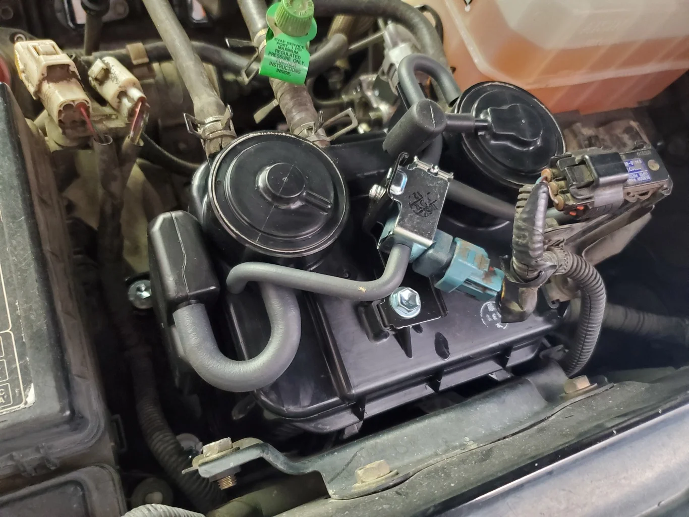

Installed:
So if you buy the wells unit, i think you'll be getting a denso 😁

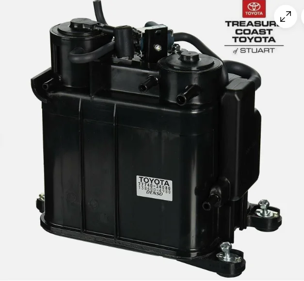

what’s the year of the Tundra and the part number you confirmed fit the Land Cruiser? When I search the part number on the unit in your pic, it shows as NLA and out of stock at rock

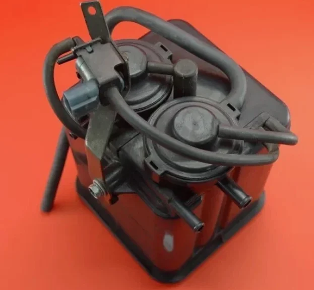

Comparing canisters. Tundra.
2000 Tacoma canister for comparison.
2000 Camry and ES 300 canister.
@Brandon Ryder How is the Tundra canister doing? I just wanted to double check that it is still good for you? I realize they are 99% identical but my OCD just has to ask.
