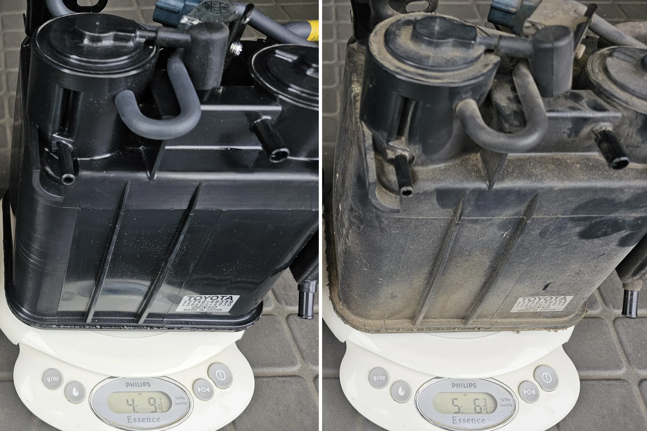

Old CC weight compared to new. Indicates, how badly saturated old was. The added weight, is due to saturation of charcoal.@2001LC I already installed it, but there was a difference. The new one was a lot lighter than the old one. Does the weight matter?
What is the weight of a new or healthy CC? What all is attached when you weigh it?Old CC weight compared to new. Indicates, how badly saturated old was. The added weight, is due to saturation of charcoal.
I keep a log of these weights. Which helps me "know" when R&R of CC was correct/justified.

I'm I reading your scale correctly. New 73.25 OZ, Old 86.75 OZ.. So old was 13.5 OZ over?Well, I just replaced the LX470 vapor canister after already replacing the vacuum valve as my 2001 LX470 would occasionally turn but not start after a fresh full tank fill. Any other ideas why are more than welcome!
Here is a pic of the weighed NEW-old-stock (2076g) and OLD-original (2460g) vapor canisters for those who care:
Yup, 384g = 13.55ozI'm I reading your scale correctly. New 73.25 OZ, Old 86.75 OZ.. So old was 13.5 OZ over?

Yup, 384g = 13.55oz

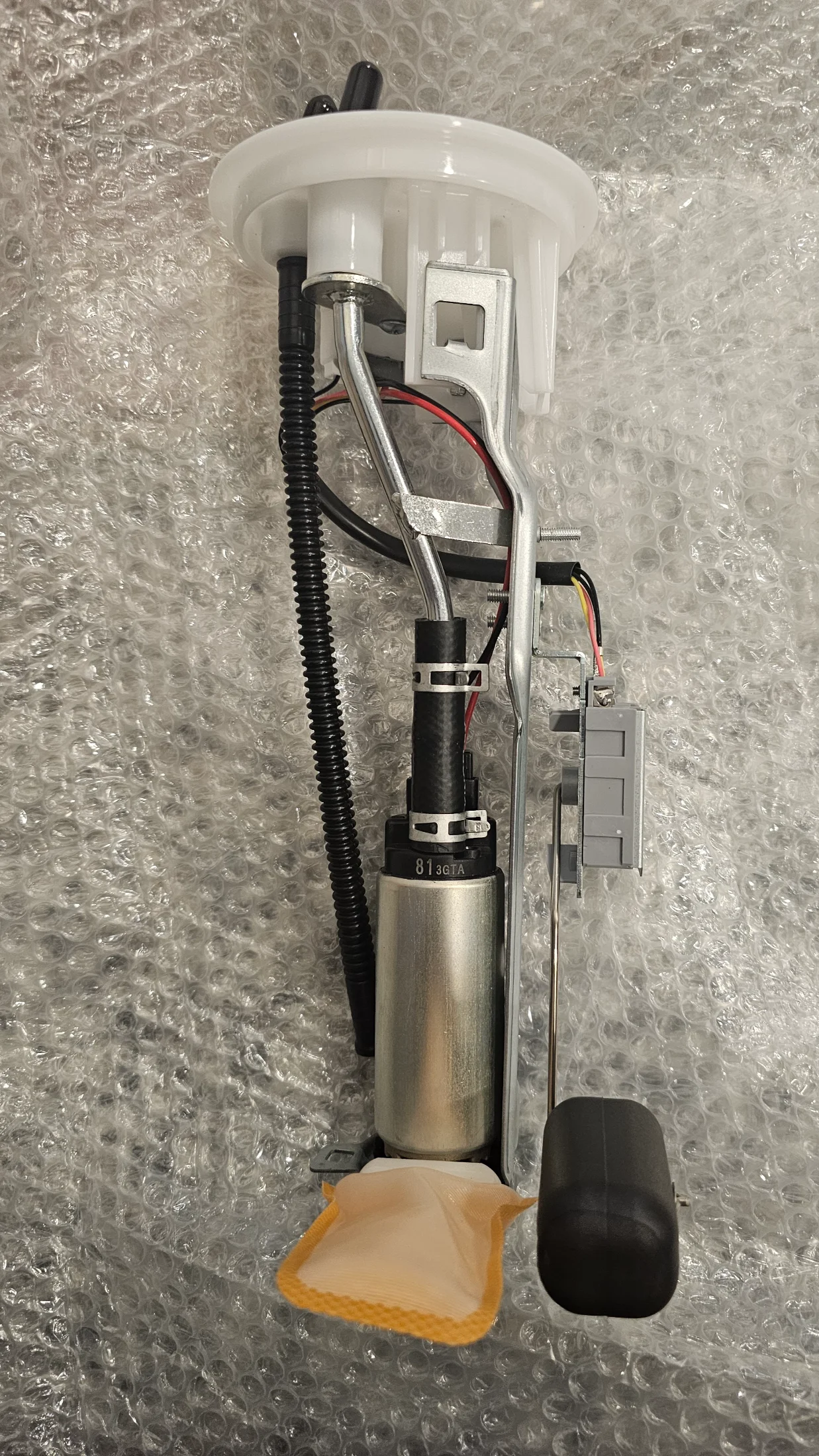

Well, I replaced the fuel filter (with OEM Toyota 23300-50090) last week and soon after the empty tank indicator went nuts, reporting empty when certainly not, moving slowly up/down back and forth. Eventually the fuel pump started acting up by shutting the engine off (as if no gas) after approx 100 yards of driving or even when just idling. Long story short, I ordered a "noname" for $165.- on Amazon and this showed up today (OEM Toyota 77020-60160).Could be coincidence. Could be, you were building tank pressure, which aided fuel pressure. Removing gas cap, released the pressure, reducing fuel pressure.
Crank no start, is either spark or fuel.
Sweet. Please, a link to Amaron fuel pump you ordered?Well, I replaced the fuel filter (with OEM Toyota 23300-50090) last week and soon after the empty tank indicator went nuts, reporting empty when certainly not, moving slowly up/down back and forth. Eventually the fuel pump started acting up by shutting the engine off (as if no gas) after approx 100 yards of driving or even when just idling. Long story short, I ordered a "noname" for $165.- on Amazon and this showed up today (OEM Toyota 77020-60160).
Sweet. Please, a link to Amazon fuel pump you ordered?
Thanks!Amazon.com: YFANTPA Fuel Pump Assembly 77024-60160 77024-60100 77024-60101 | for Toyota Land Cruiser Lexus LX470 1998-2002 : Automotive

Yeah, exactly.Sweet. Please, a link to Amaron fuel pump you ordered?

Where did you find a new Vapor Canister 77740-60390? I have looked everywhere.Well, I just replaced the LX470 vapor canister after already replacing the vacuum valve as my 2001 LX470 would occasionally turn but not start after a fresh full tank fill. Any other ideas why are more than welcome!

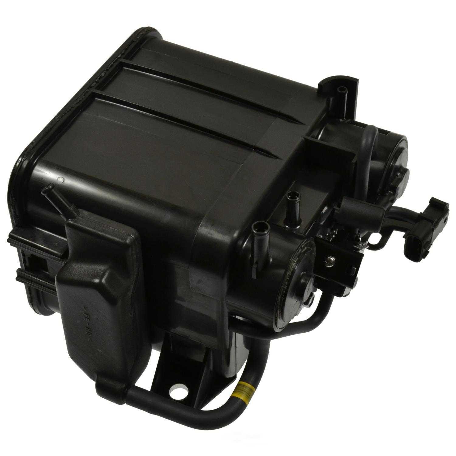

I ordered one from Discount Auto Parts of Rolla on eBay back in July and guess what was in the box?![]()
Vapor Canister Standard CP3362 for sale online | eBay
Find many great new & used options and get the best deals for Vapor Canister Standard CP3362 at the best online prices at eBay! Free shipping for many products!www.ebay.com
The TOYOTA 77740-60390 - DENSO - Made in Japan including the OEM Fuel Tank Pressure Sensor!
Well, at least I feel a lil' better about spending that kind of $$$. I should be good for another 25 years...
>>> There is no guarantee yours will be the same, just sharing what I got. <<<
