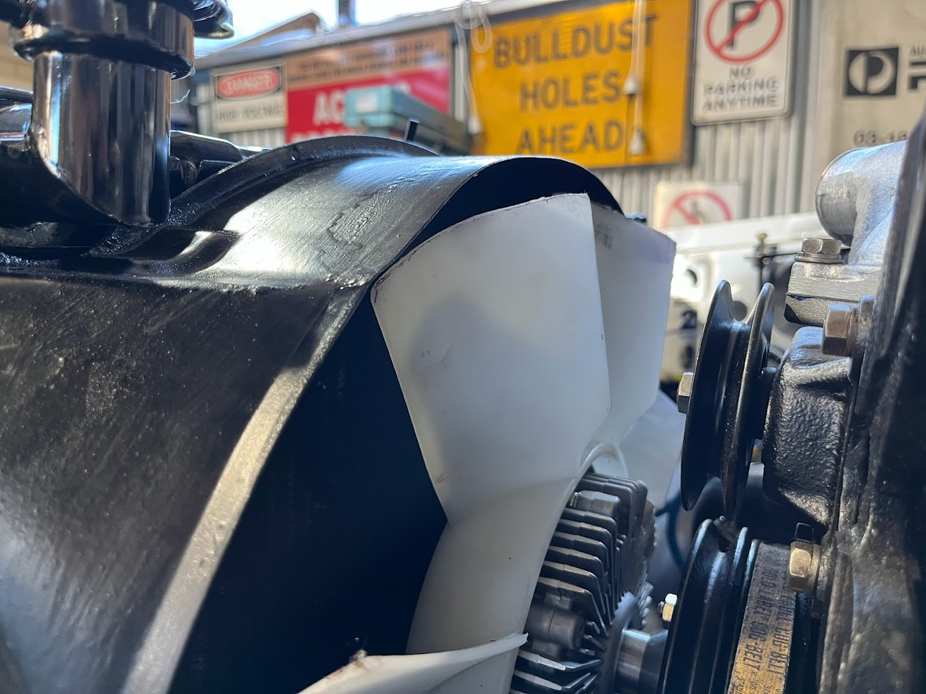

The fan doesnt look so good now, I had to trim the blades, I'm unconvinced the shroud or the fan I have are both the correct ones, I've taken 10mm off the blades and the clearance is perfect now.

The trimmed blades..

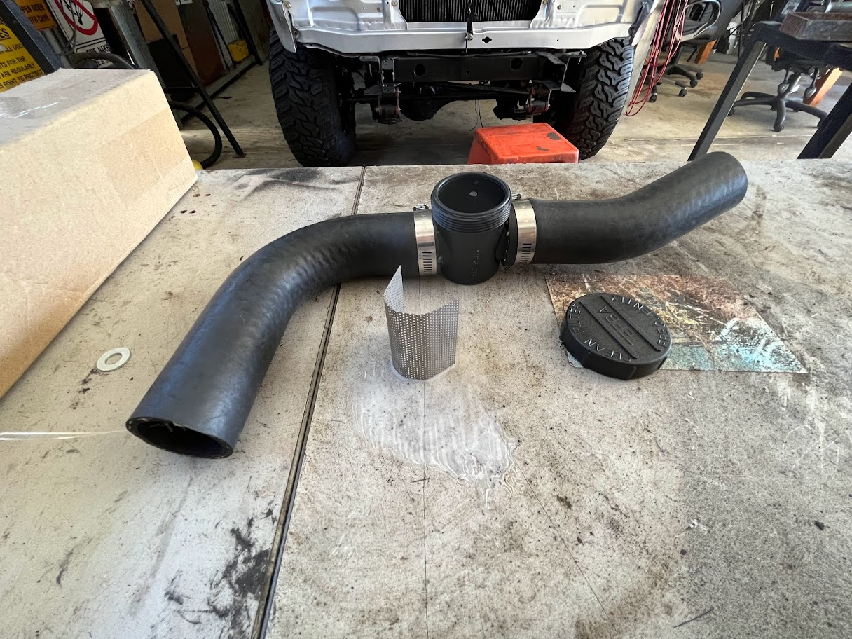

I think we're ready to add some Elixir of Cooling, both hoses on and the system should now be ready for use. Coolant filter added to the top hose with a fine mesh.

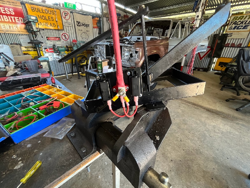

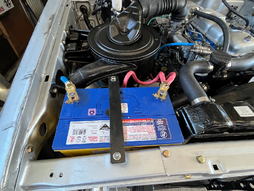

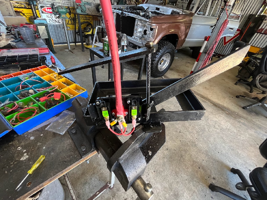

The previous owners fusible link deletion has been rectified. Two new fuses mounted on the battery tray (60A each, may upsize) and a positive post to distribute permanent unfused 12V+ for starter relay and glow plugs. Its not entirely clear to me if Starter Relay and Glow power were fused from the factory - may still redesign this. But for now, a good clean pair of battery terminals, a single earth connection distributed on a bolt under the battery tray and two positive connections for starter and to supply the fusible links/glow/starter relay.

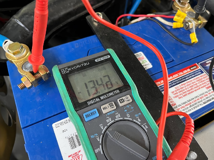

Also prior to the fusible link work yesterday I confirmed the dirty old alternator and regulator I found at the back of the shed are charging - was good to see they were. A new alternator at some point and an internal regulator conversion but after its back on the road.

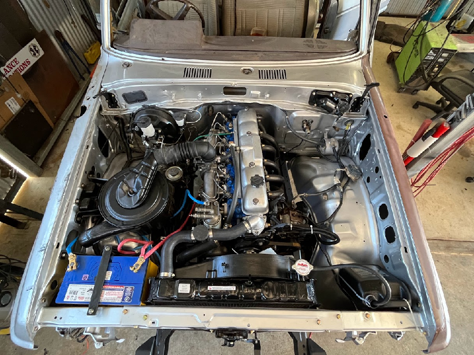

Engine bay is beginning to look complete(ish).

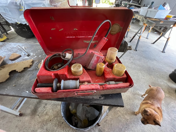

This afternoon a mate is dropping over one of those spot welding dent pullers for me to have a play with on a small dent that needs a repair. Looks like a fun tool!
Amazing tool!
