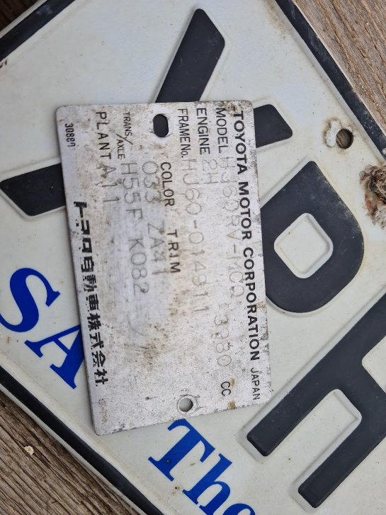

Of great importance was that it was "registerable" in my state (South Australia). The seller had the number plates, identity plate from the cab and the original engine number - this GREATLY eases the re-registration of the vehicle to put it on the road - it can all be done online.

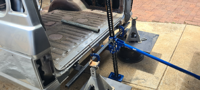

I dont have a hoist.. and I spent a LOT of time trying to work out how to get the cab onto the chassis.. I sort of wanted to do it alone just as technical challenge.. I bolted some brackets to the side, and back and tried to use my highlift jack to slowly raise up each corner in turn.. it was nearly a disaster, it got very unstable very quickly and I nearly dropped the cab onto myself. I abandoned the attempt and slowly brought the cab back down onto the dolly and started to reconsider how to get the cab onto the chassis.

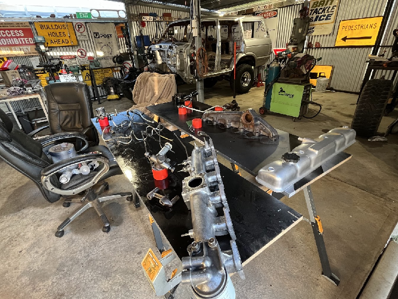

This is the engine thats going into the Princess.. Diesel, 2H. It looks tired but its got great compression, and pretty much zero blowby. A full cosmetic refresh happening, fresh injectors, a few polishments of alloy pieces, a new clutch, new water pump, new thermostat, new thermostat housing, new alternator and new hoses/belts.
Full spend details so far (Australian Dollars)..
Quick freshen up of this 2H.. Not quite the right colour for a 2H but pretty close!
Side covers coming off for wirewheel and clearcoat/black (not sure which yet). Then new clutch, new spigot bearing and new rear main seal before its nearly ready to go in.
Cleaned injector lines, inlet manifold, exhaust manifold, lift pump, throttle body, A/C idler mount, rigid fuel lines and water pump housing.

Engine getting closer to going in.. Inlet manifold and fuel plumbing reinstalled. New clutch and spigot bearing still to go on.
