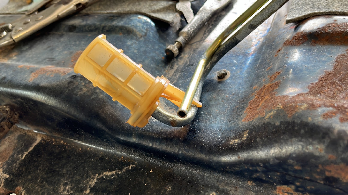

So yesterday I was determined to get the new fuel tank in and after giving the new one a good clean up and a lick of paint I dropped the old one out and managed to get the new one in - no easy task alone! A length of rope between the chassis rails and under the tank and straps did the trick and the new one was in. 20L of diesel was added and it was time to prime the system. Absolute fail - zero fuel coming out of tank.. wtf! It was an FJ60 tank so some minor differences but nothing major, I blocked off the unneeded return line for example. After trying compressed air in both directions I found the pickup was completely blocked! Yes, I was cursing myself not checking it whilst it was out on the bench.
So 20L of diesel had to come back out, the tank had to come back out of the vehicle and indeed the picked up was completely blocked in the fuel pipe - bizarre! a length of stainless steel cable and some compressed air managed to clear it but I have no idea what it was, the filter was spotless!

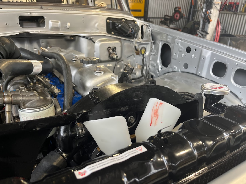

Right thats done it... the "two part radiator fan shroud mod" is going to be done I think.. 53years of sun damage to my skin and it tears so easily :( Especially the back of my hands.
The Mod Details..
The Mod Details..
The Mod Details..
Is the fan shroud mod to have easier access to the cooling system and front of engine?
It would also help when changing engine mounts if need be, not that you would be doing that for awhile, everything being so shiny.
I thought the blood was paint, even the blade looks shiny!
Yeah essentially.. much easier to get access to fan/belts, its always fiddly getting the fan and shroud in place. I've already bent fins on the new radiator, I'll straighten them up but they'll never look perfect :(
The fan doesnt look so good now, I had to trim the blades, I'm unconvinced the shroud or the fan I have are both the correct ones, I've taken 10mm off the blades and the clearance is perfect now.
