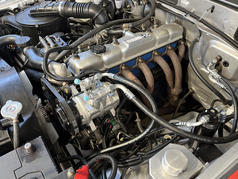

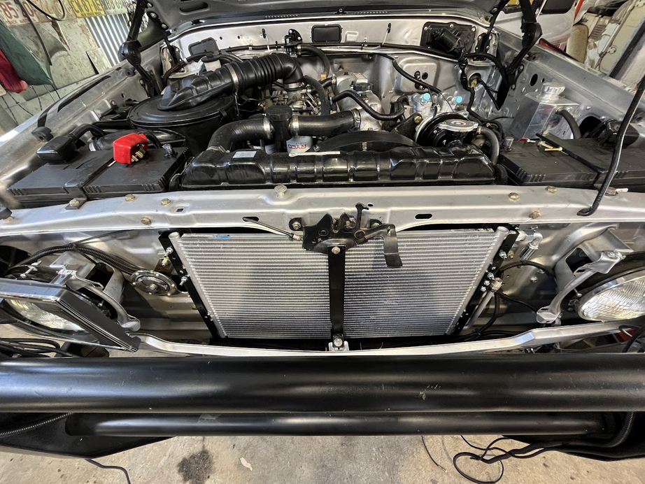

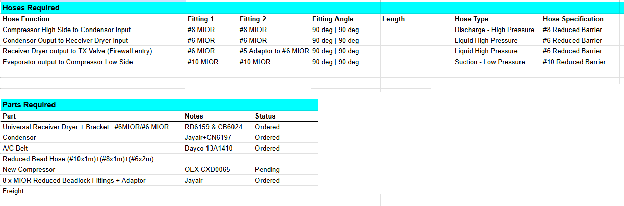

Time to get the A/C working.. cant go to Woolworths to get groceries without A/C.. Parts list and notes so far..
I think this is going to work.. #diagramporn. My supplier is a legend.. I'll do an appreciation post when its all done. Hoping he'll freight it all to me this coming week.

Gas soon.. fingers crossed.

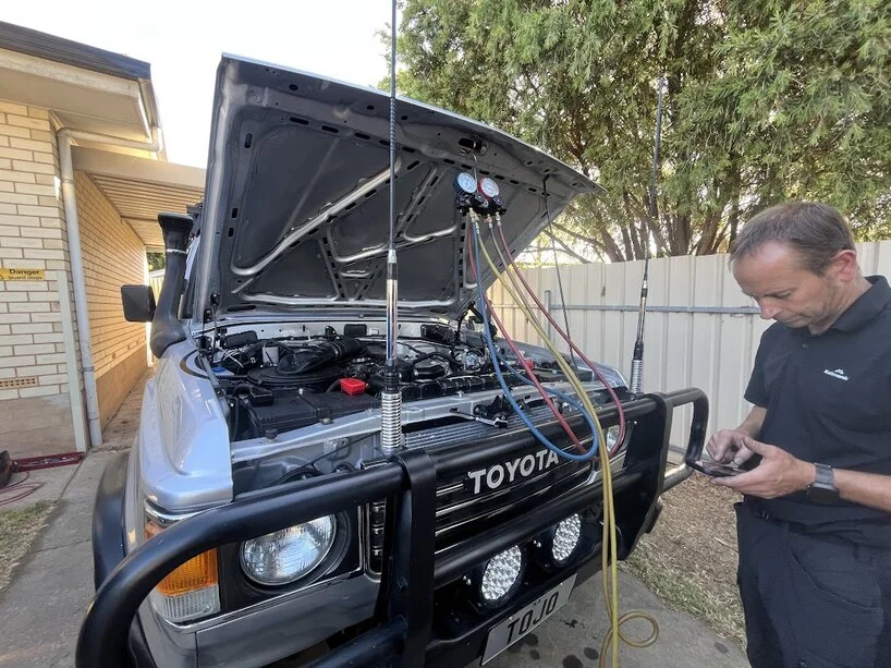

Yeah baby... cold air! 23 deg below ambient at the vents!
Here's my German A/C guy, Sascha, checking and charging the system. Teutonic attention to detail, a very thorough leak check and long vacuum period.. Road test on the way home from work today, it wont be terribly hot today (32°C today) but it'll be a good test!

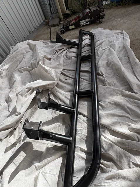

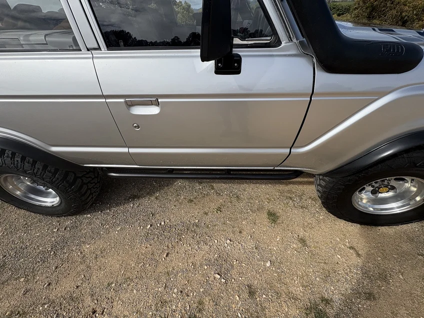

Rock Sliders! Fabbed up by a local guy, young and enthusiastic.. so good. Cant be too careful, some of the speedbumps at my local shopping centre are gnarly a.f
Electrical fitout continues, both battery trays now in and mounted, I am determined that only a single cable will ever be on any of the battery terminals. Each battery has two 60A distribution fuses behind them to distribute power as needed.
Loving this commitment to clean and neat electrics. At some point I really need to go in and tidy up the 4 wires the PO of my rig has coming off the + terminal on both batteries…
