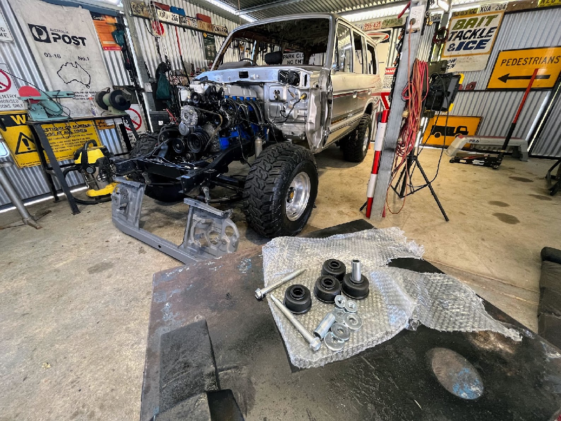

Some body mounts I didnt realise I was missing turned up today.. so the assembly of the front clip can now (almost) proceed. Just got to get some colour on the radiator mount and inside of the front guards. A quick test run of the engine to make sure something hasnt gone terribly wrong with the spigot bearing, thrust bearing, or clutch and then onwards to a radiator install.

soo shiny!! bubble wrap too

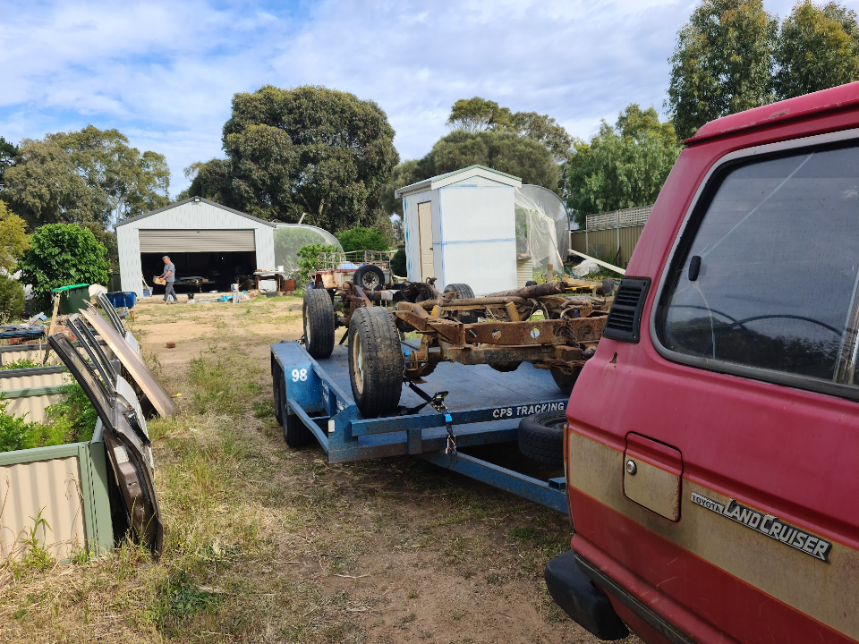

A year passed, and I finally located an HJ60 chassis that was quite close to where I lived.

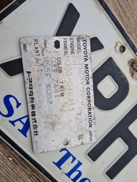

Of great importance was that it was "registerable" in my state (South Australia). The seller had the number plates, identity plate from the cab and the original engine number - this GREATLY eases the re-registration of the vehicle to put it on the road - it can all be done online.

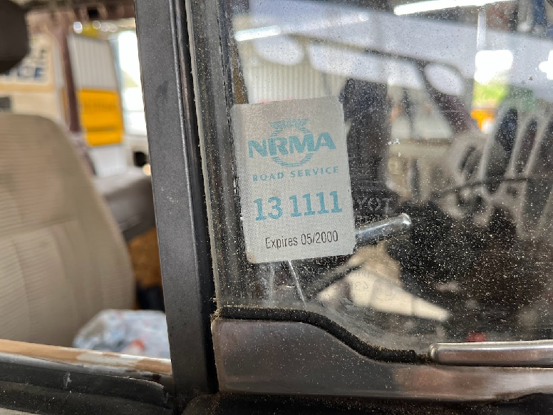

Looks like the cab was in New South Wales at some point in its life. .
I am beginning to conclude that SA ends up getting a few cars from NSW and Vic. It becomes too expensive and difficult to re-register them.
