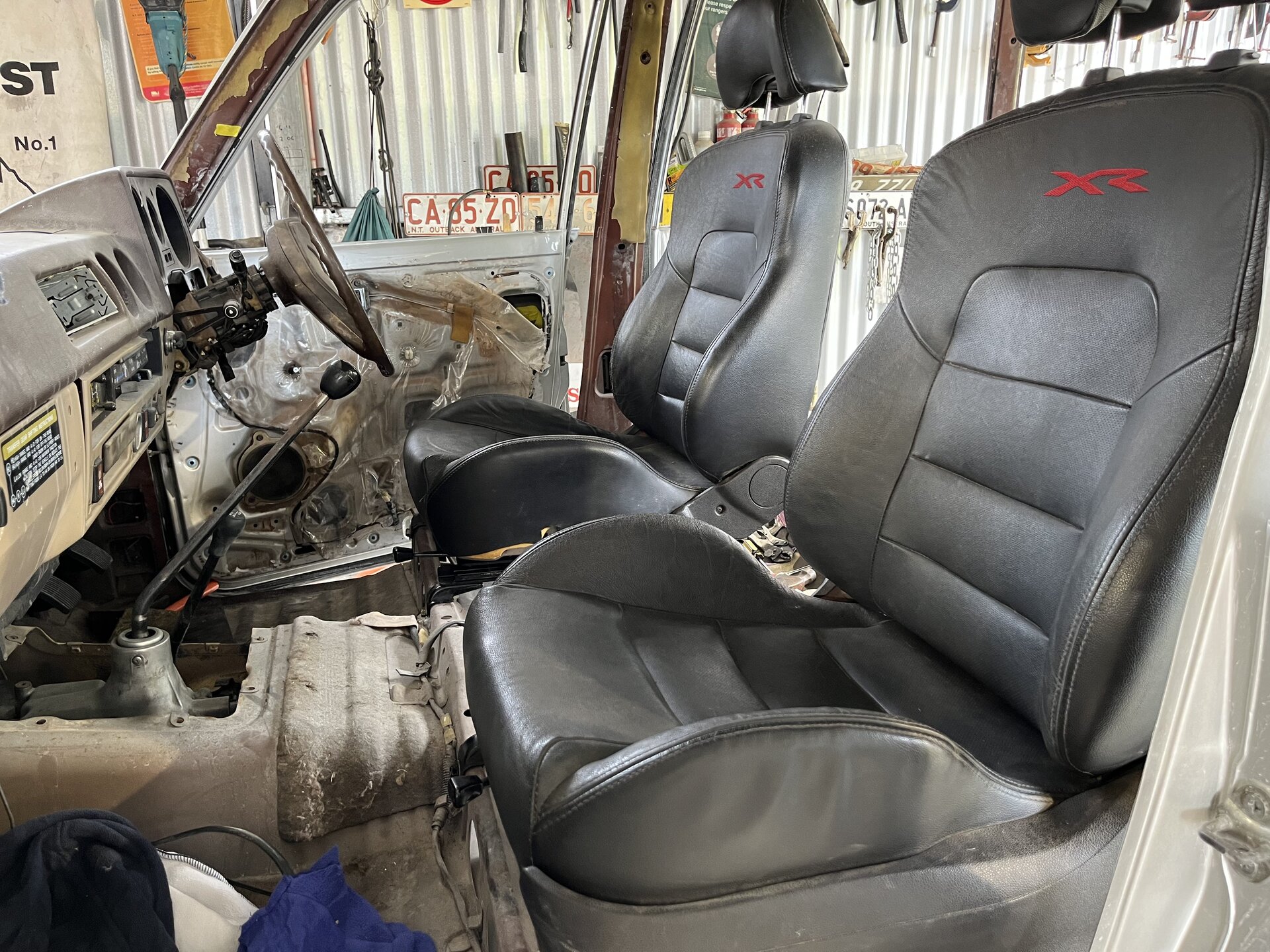

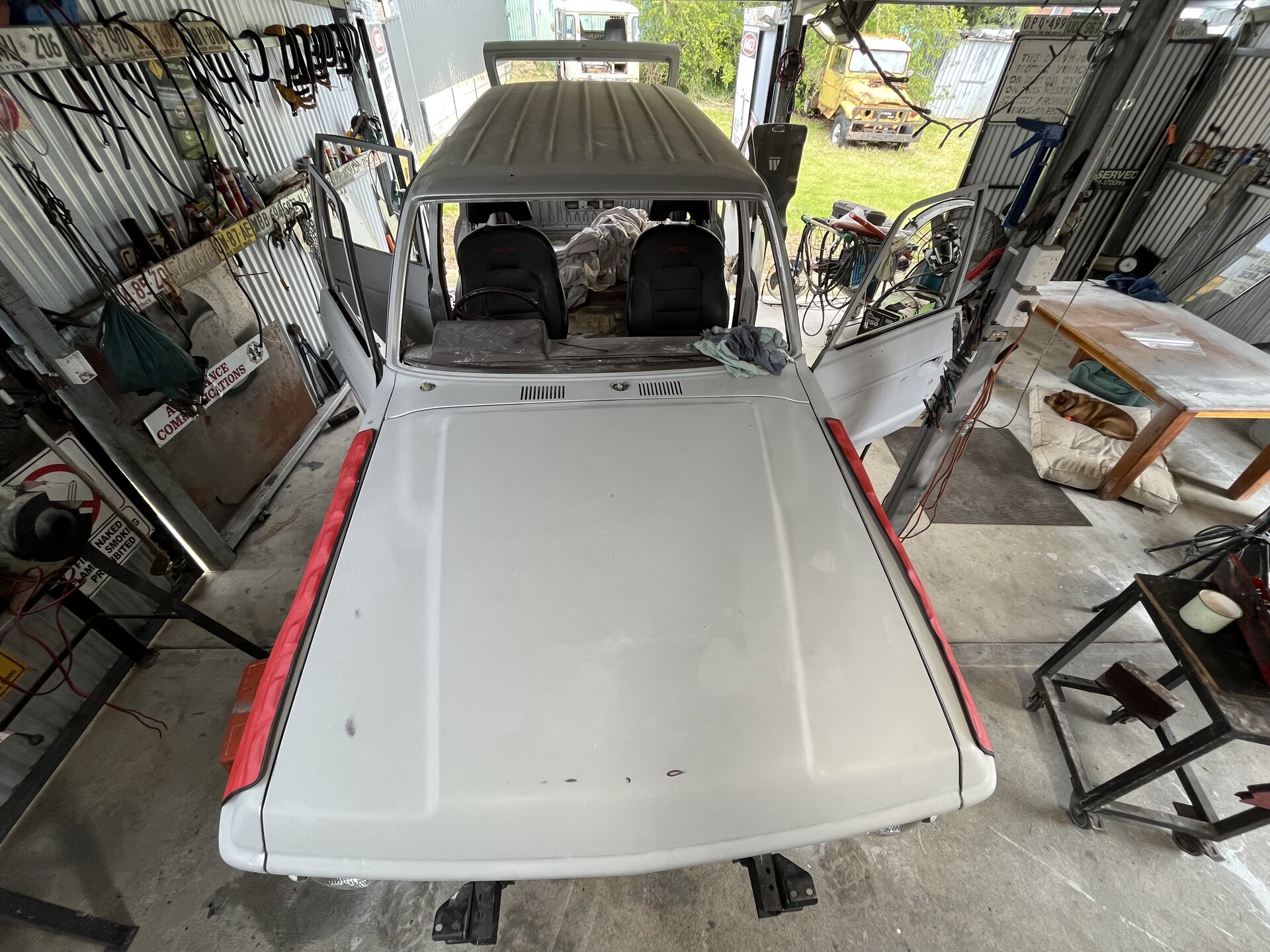

Two jobs completed today..
  • New seats trial fitted.. all bolted up nicely.
  • Bonnet reinstalled - gaps all perfect which suprised me as the bonnet, hinges, and guards are all from different vehicles.
I was a little concerned about my battery clearances, the two trays I fabricated sit about 15mm higher than the factory ones.. but it all cleared nicely. I am going to run two different batteries so that the positive post of each battery is on the inboard side of the batteries on each side - this will move the positive post even further away from the bonnet in case something moves (cant imagine it will).

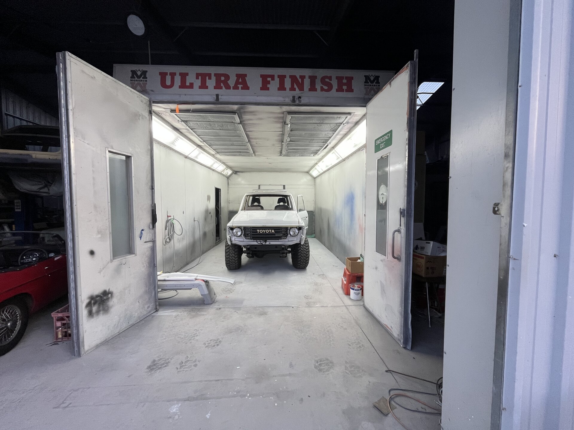

Time for paint!!!
I am very pleased with the outcome of the respray... its really good. Not perfect, but very very good. I missed a small dent on the rear tailgate (I have no idea how), but it wont be seen after the rear bar and tyre carriers are on, its so minor I cant even get a photo of it that shows it.
There is a scratch on the rear left quarter panel that I missed - but you have to really search for it to find it. There are two runs in the clear that the spray painter is confident he can resolve next Saturday (he's fixed similar runs on another project he did for me successfully).
I was a little nervous on the drive over to the spray booth, about 600M on public roads but the thing the drives awesomely! Nailed the wheel alignment with a tape measure, the brakes are perfect, the transmission and clutch feel great! The 2H in this thing feels just fantastic - I suspect its the complete lack of accessories (and thus weight) but it drives like its got a turbo slapped on the side of it (and it doesnt).
