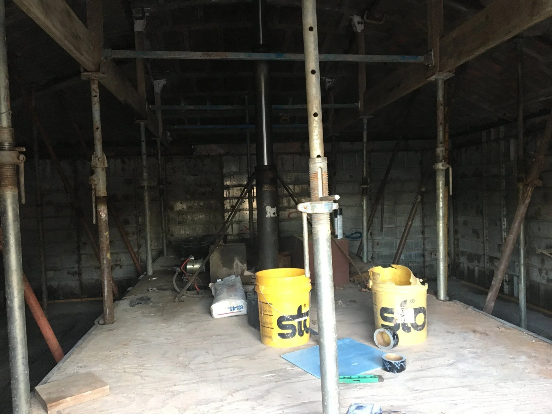

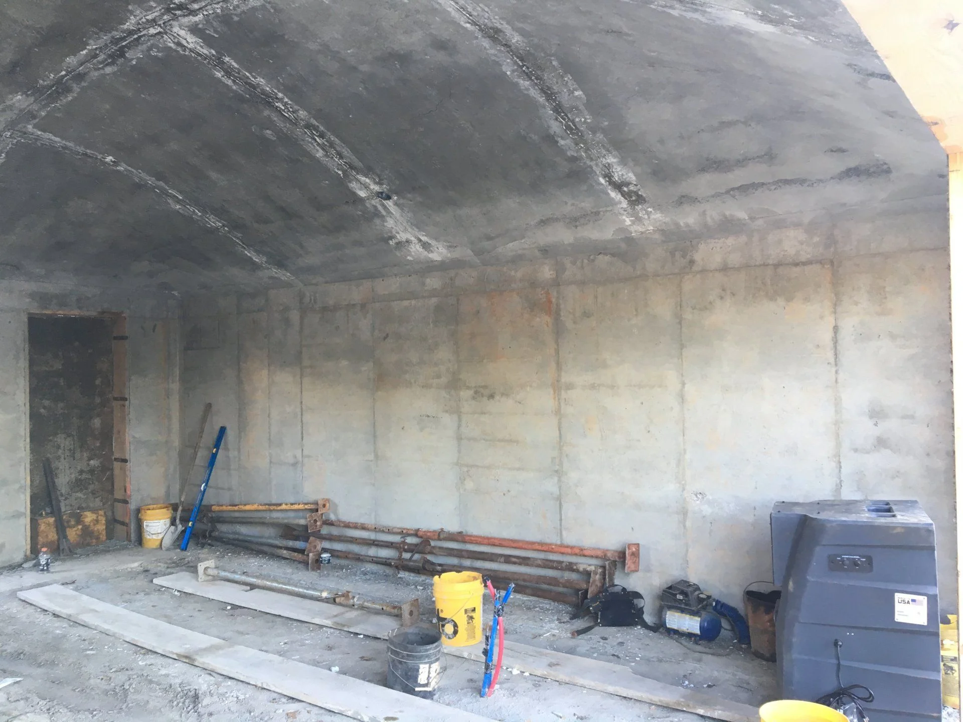

For @PAToyota , here is a photo inside the dome forms:
You can see the big hydraulic jack and some of the screw jacks that will hold up the weight of the poured cement on top of the form, until it sets.

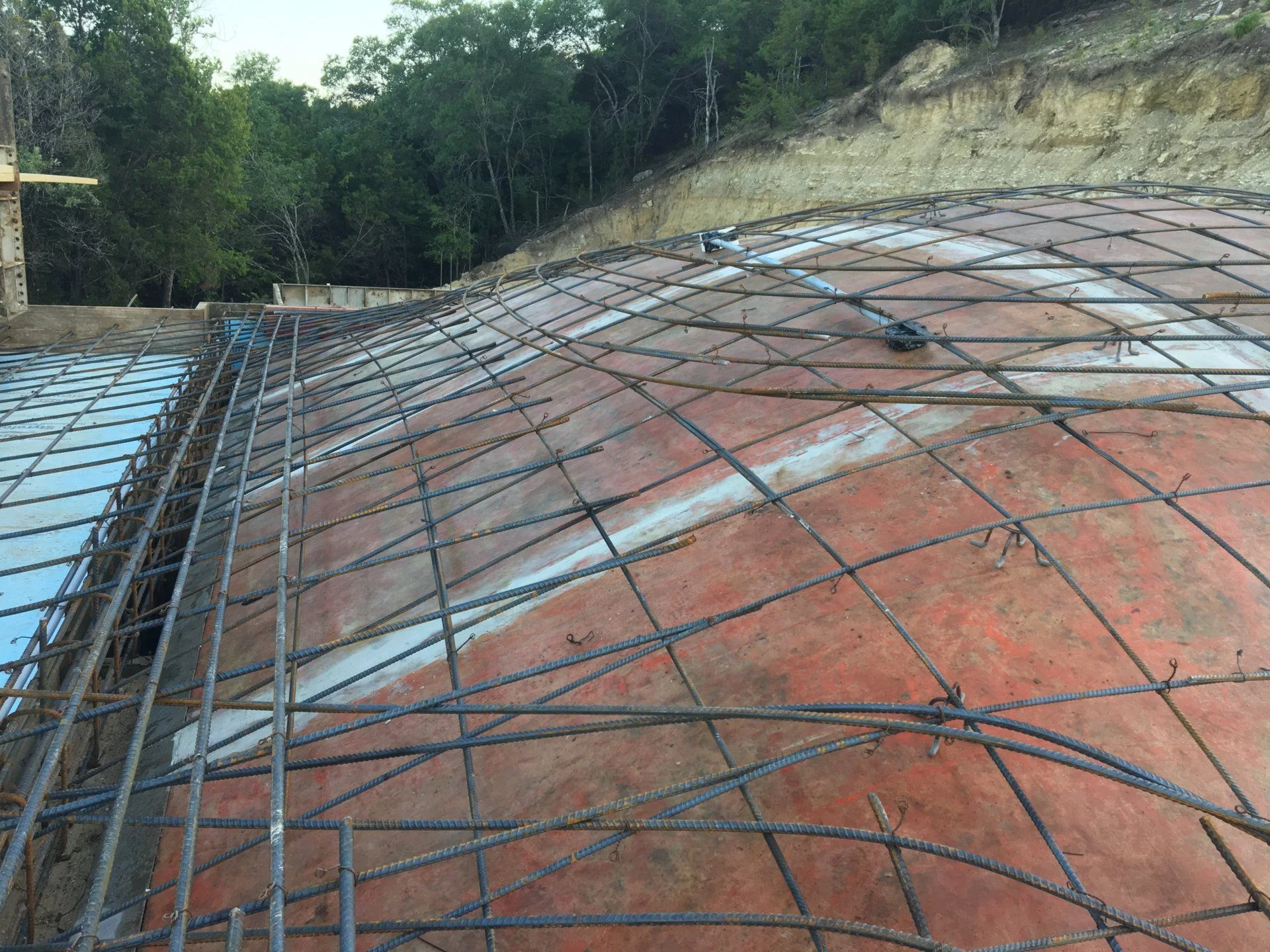

Here is a detail of the top side of the dome form; you can see the tons of rebar used and also the electrical conduit and boxes for ceiling fans and lights:
Concrete will be poured for this module first thing tomorrow morning.

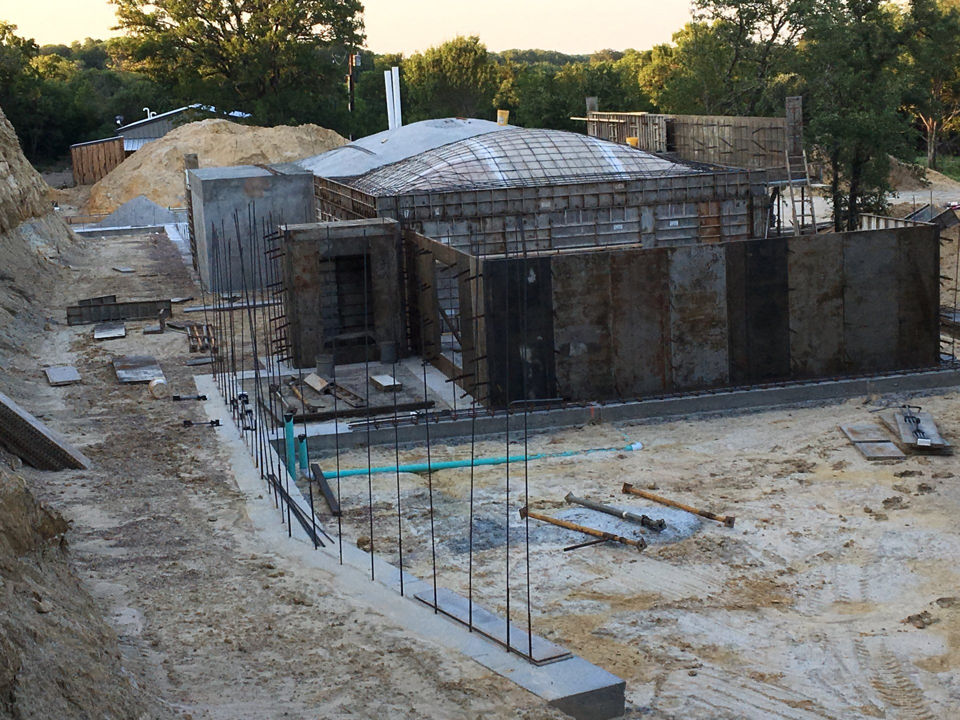

The builder has already started setting up the vertical wall forms for the next module, adjoing this one, to the south.
How thick is the dome ?
Good question; I don't know yet - about to start pouring concrete in 15 minutes, so I'll find out. The walls are 12" thick, so I assume the dome will be at least that. It has to hold up a lot of weight.

To answer your previous question, the very top of the dome is only about 5" thick of reinforced concrete, but it thickens gradually in a wedge down to the base of the dome (where it meets the vertical walls) to about 10". Engineer says that as long as there is 2" of concrete over the (double layers of) rebar, full strength will be achieved, and the domes will easily support 70,000 lbs. of soil and earth-moving equipment driving on top.

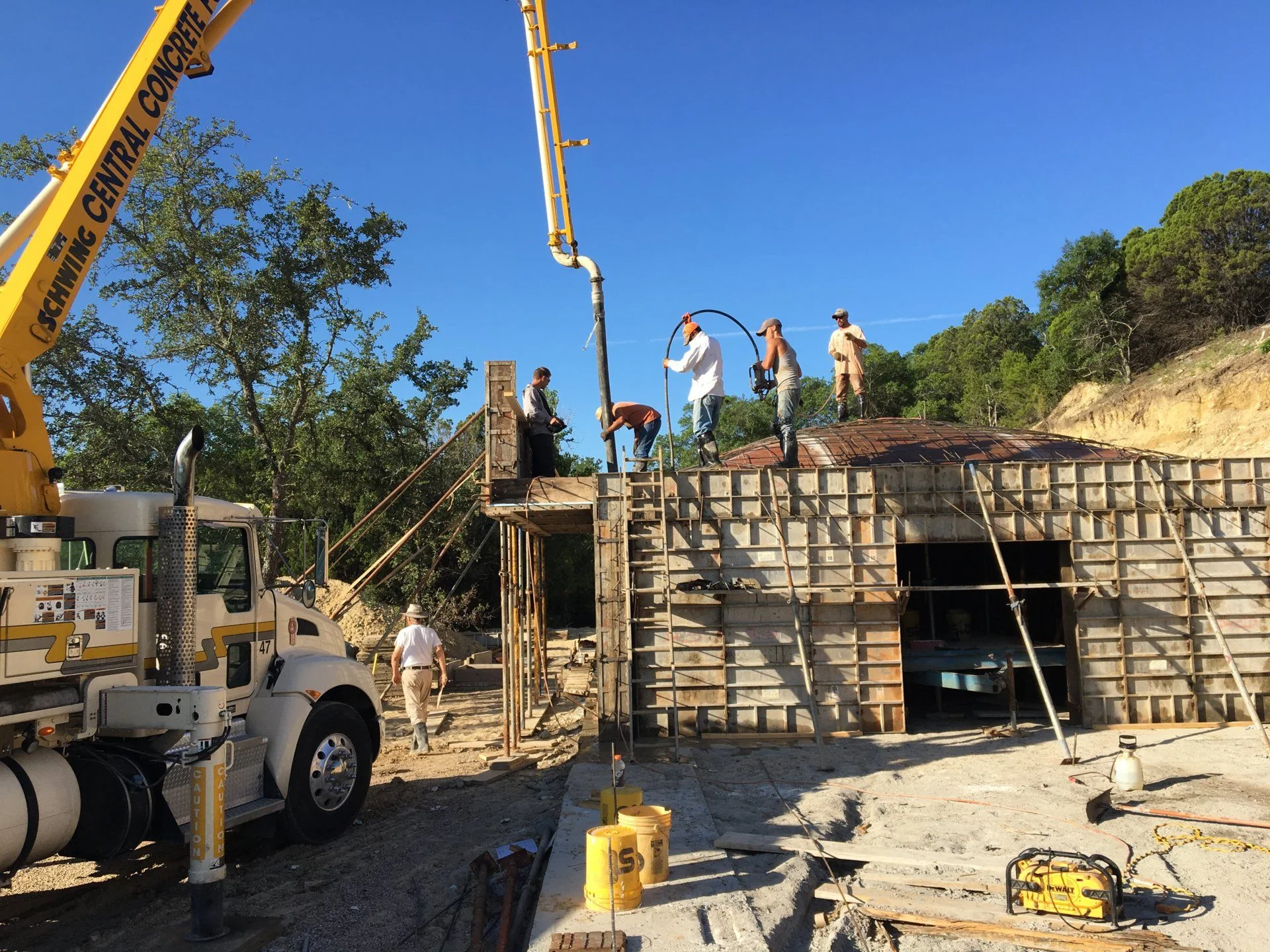

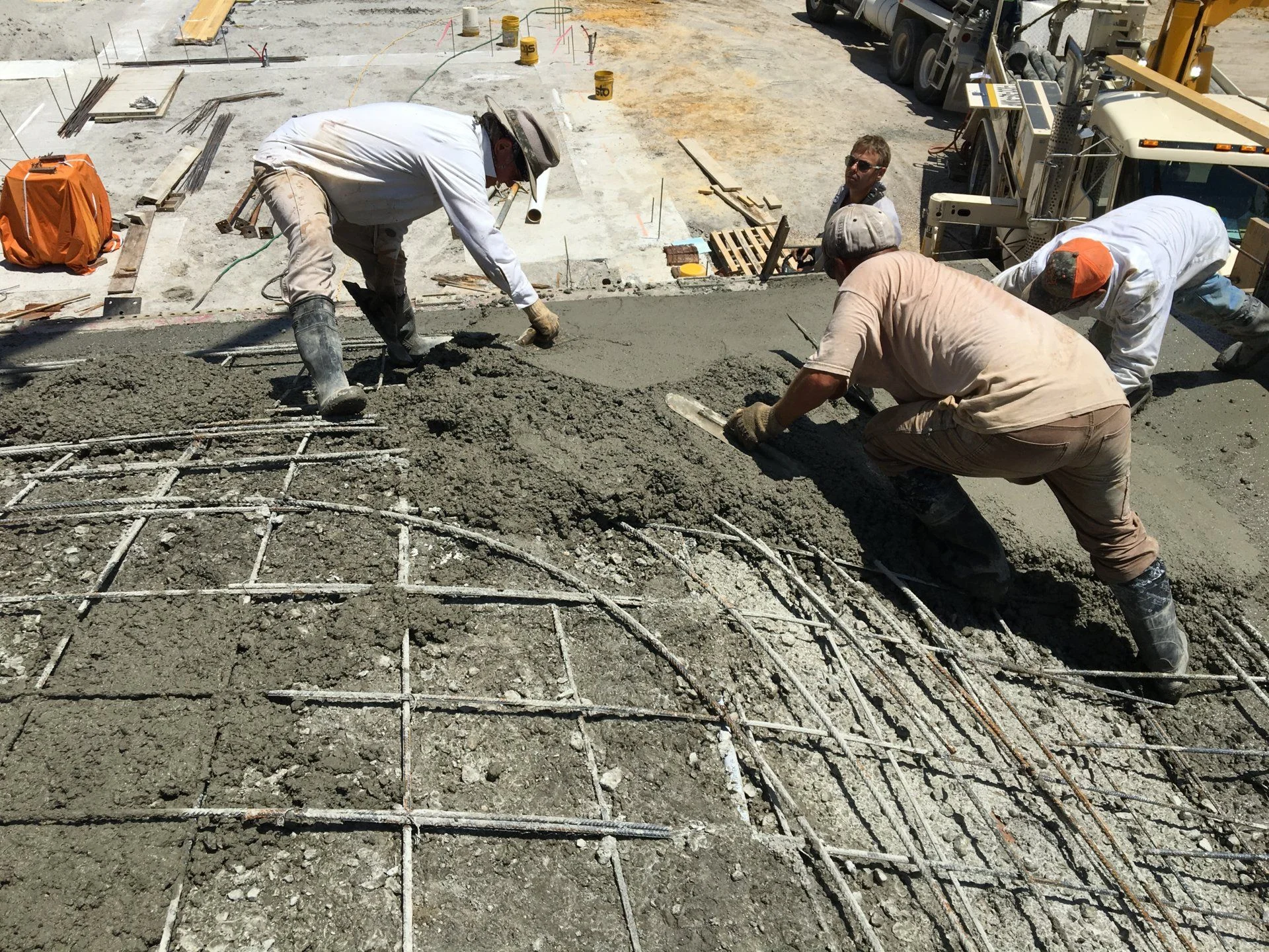

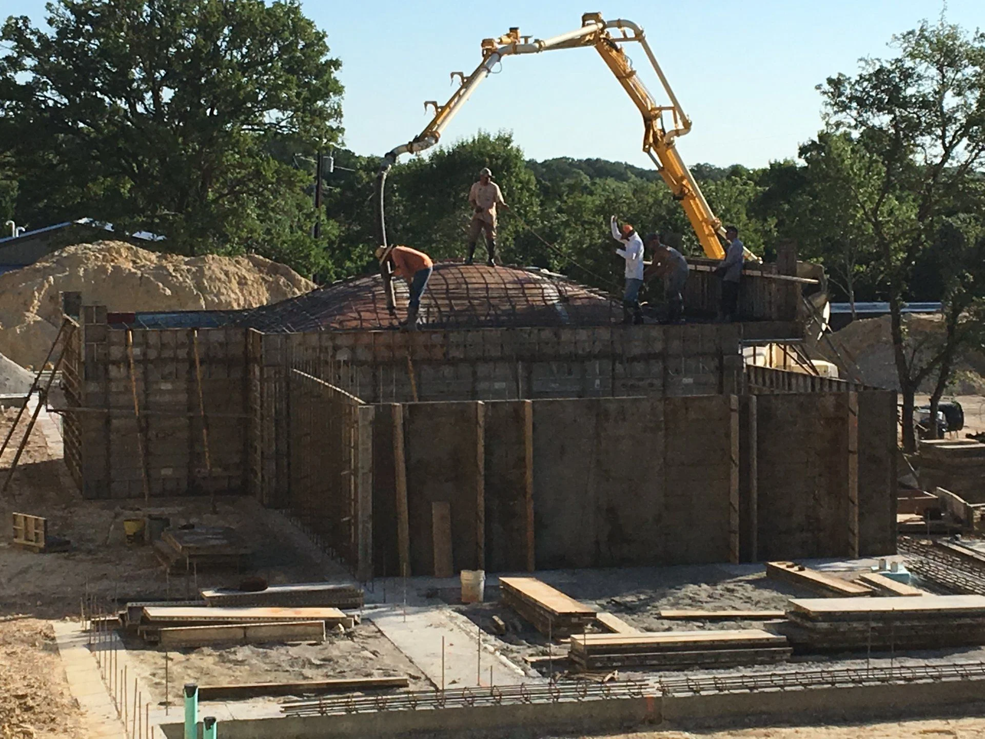

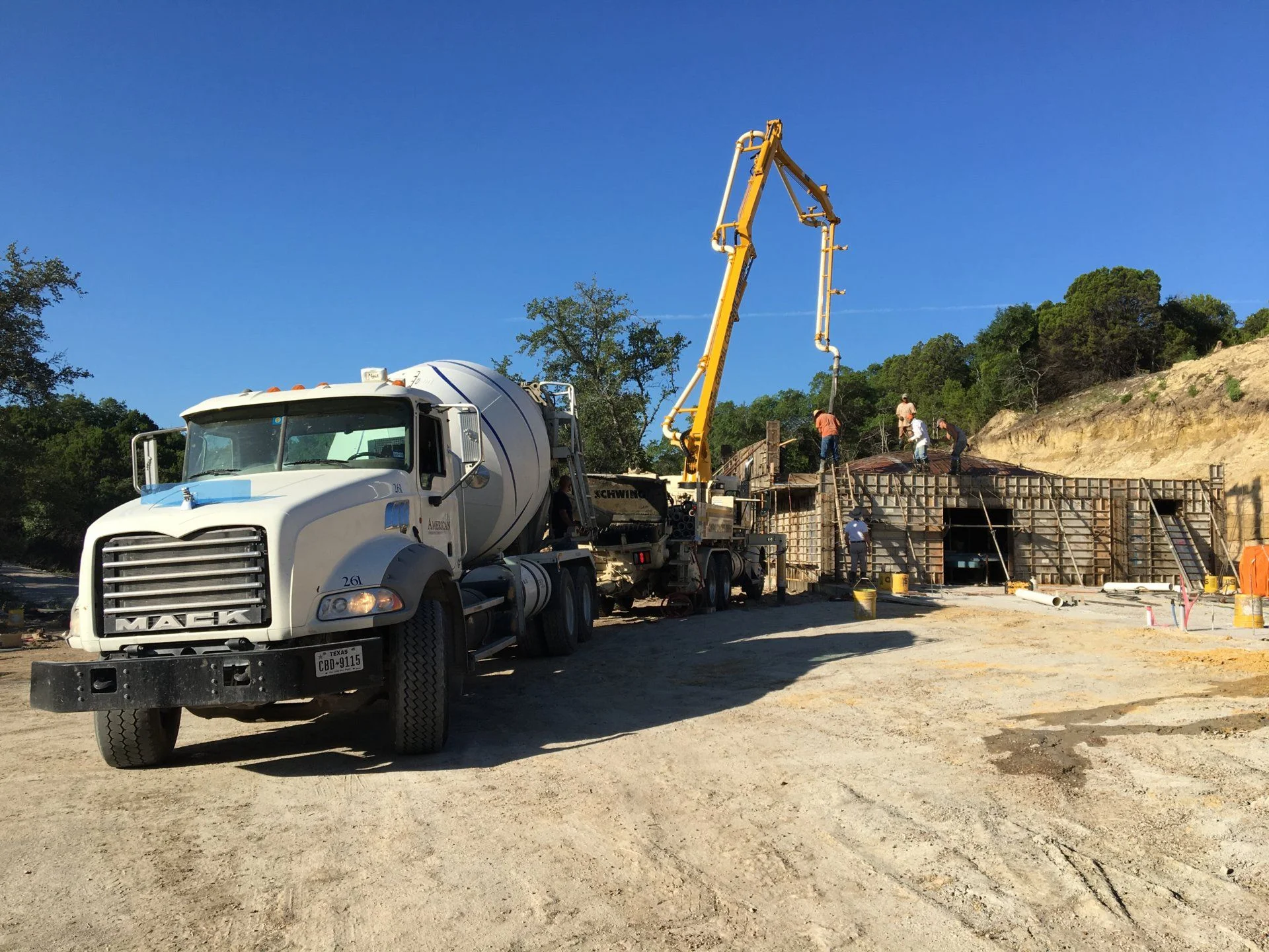

Here are some photos from today's pour of the first dome module, including the water cistern:
