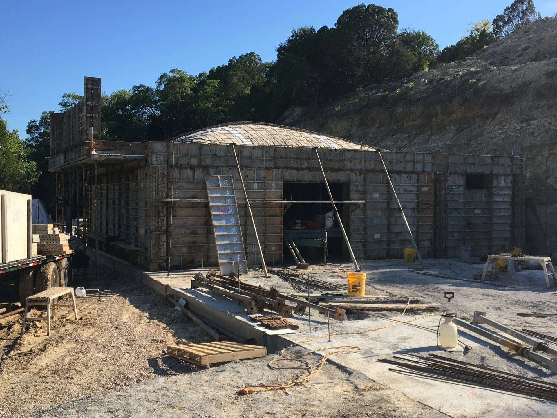

Wall forms are up for the first (of seven) dome modules to be poured. They're starting in the middle of the house, because once you get this one in the middle completely square and plumb, the others are easier to add on to it. I'm impressed with the level of detail and devotion to perfection that the contractor is putting into this.
Photo of the mostly completed wall forms. This first module also includes the cast-in 10,000 gallon water cistern behind it (to the left in this photo):

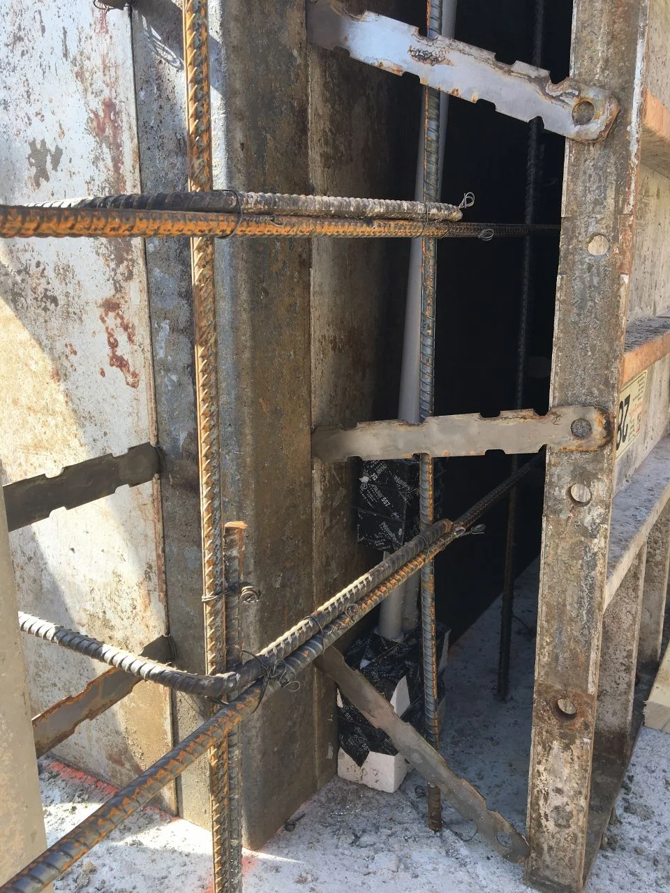

Detail of the wall forms, with rebar, steel plates, and electrical conduit and switch/outlet/junction boxes pre-installed. Walls will be 12" thick of reinforced concrete.
