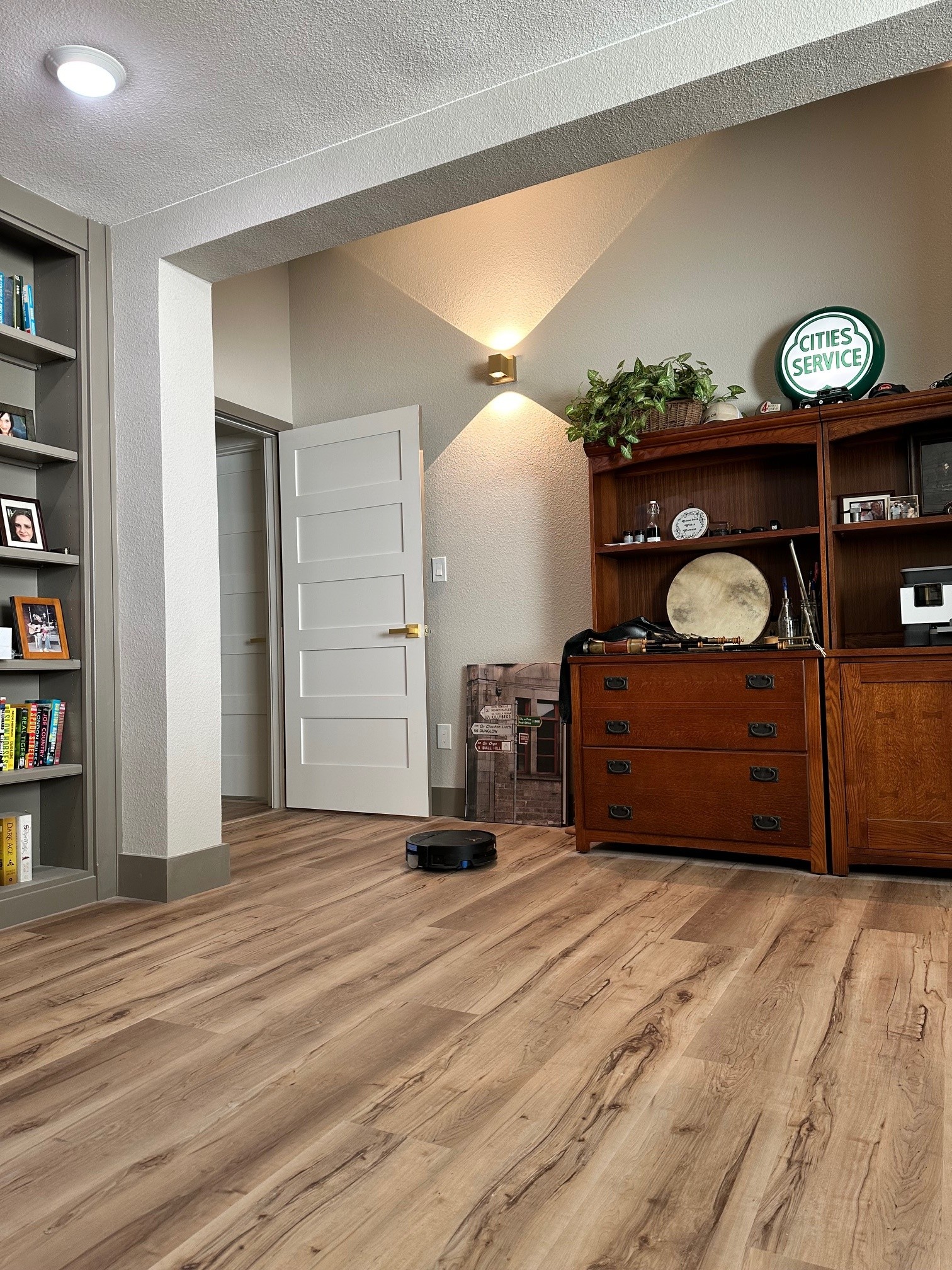

SkyNet attempting to map my office.
The Mrs. bought a robot vacuum cleaner on the Amazon Prime Day sale. I was surprised; it actually did a half-decent job getting the peanut crumbs off of the floor under/around my drafting table.
