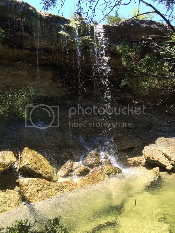

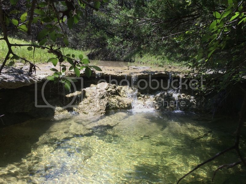

Until we bought the land and built a road, it was only accessible by 4WD. The trees are so thick, it took a while and lot of brush cutting just to see what we really had. The land was part of a family's large homestead from 1853. We bought it from one of the direct descendants, but most of the original homestead acreage has not been ranched, worked, or managed in at least two generations, so it is pretty overgrown with trees and wild. It has two creeks; one of them has several waterfalls:

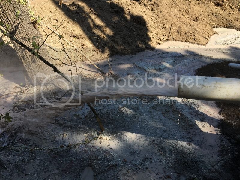

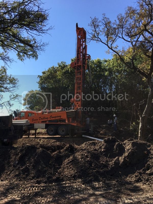

Got the water well drilled on Wednesday:
Gauged at 75 gallons per minute! The state water board will only allow 20 gal/min. so the pump is sized to make 18-20. Ten is plenty to run a house on, and we will have a 10,000 gallon cistern cast into the back wall of the house so it really won't matter at all.

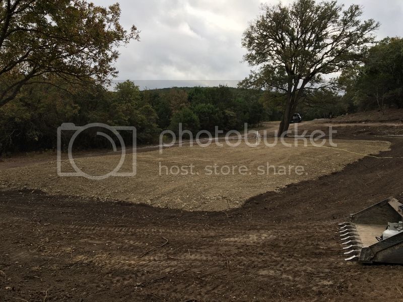

Pad for the shop building is cleared of trees, leveled and finished:
