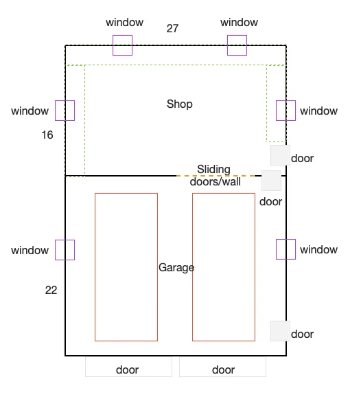

Thinking of building a garage
Sep 2, 2003
1,818
14,108
Metro NY
Need to stay under 1200sf total and under 300sf per car for the garage area with a 2 car limit.
Thoughts/ideas etc welcome.
Looking good, that looks like it will be a nice size, what are some of the details, what all are you using it for, storing other cars, working on the cruiser, other home owner projects (wood working etc?).
Why partition off the shop space? saw dust, other work shop needs?
looks like overall dimensions are 38 x 27? nice thats a decent size, what height are you going with? any overhead storage or anything?
The reason why I ask all of that, is I love an open floor plan in a shop! I know I pauy for it from time to time when I want to paint, or rip down some boards on the saw, but I also enjoy being able to put extra vehicles in the shop when I need, or roll in a few boards or home supplies when I need the space.

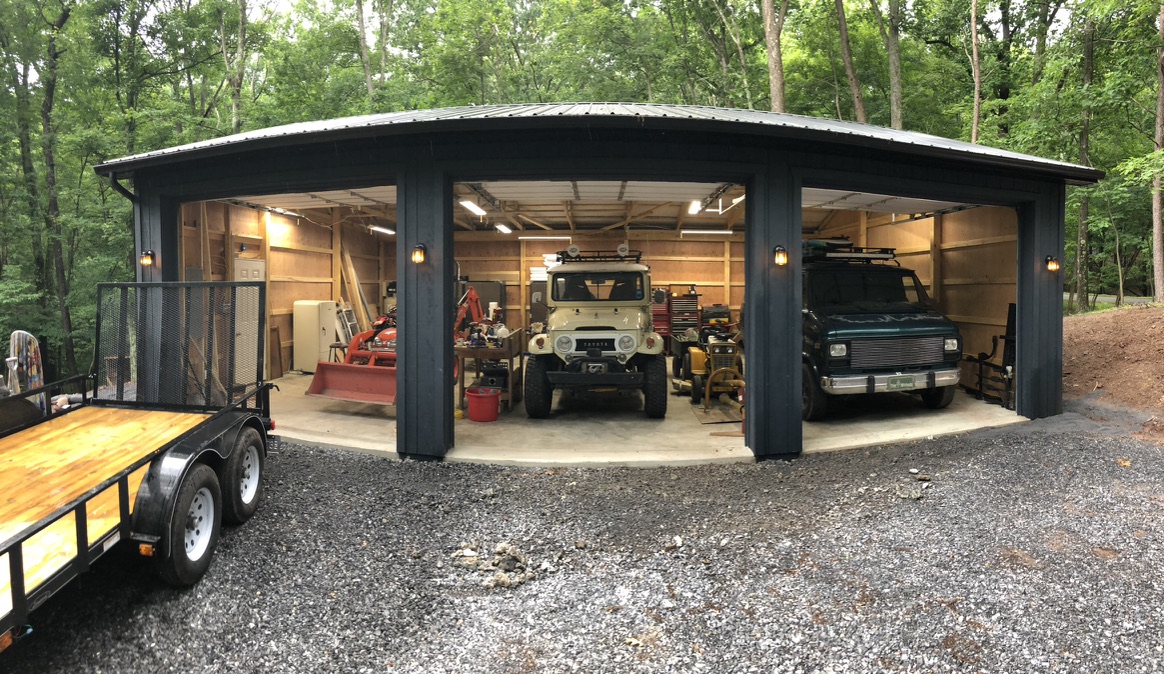

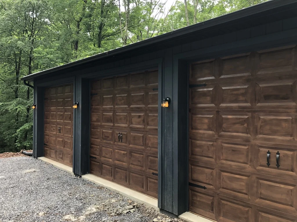

I built a 28 x 36 shop, 3 10 x 9 doors and loved it for everything, tractor, lumber storage, motorcycles, landcruiser on the lift...
28 on the gable end, 36 on the face... basically all doors with the 10 x 9's and a 10' wall
but depending on what and where you are building, I was trying to make this shop as big as I could and look as small and residential as possible, I put the lift in the end bay and put scissor trusts on that end to accommodate the height but also not make the building look excessive....

Well, the reason for building the garage now is the unlikelihood of being able to move in the next 10 years. Family issues, wife's work location etc. The plan was to be some place where there already was a garage or it would be easy enough to build one but since the move is not in the cards my long delayed desire for a garage May finally happen.
Yes, I will be adjusting the dimensions a little bit to facilitate ease of building. I'm limited to 300 ft per car in the garage area so that's why the dividing wall. My plan though, once final inspections are done would be to open up that wall with sliding or folding doors so I can close off the shop area both to control dirt etc and also to make it easier to heat in the winter. I will go with higher walls and taller doors if I can.
Center the sliding doors so the shop can be driven into or, at least you can use that as an extension of the garage so it is easier to work on the front of the vehicles. Use 8' tall doors, at a minimum, for this so you can move an engine hoist in and out of the space with the engine on it. Do not provide a threshold so you can easily move equipment back and forth.
Now, for the tricky part. Not familiar with the residential codes of NY but, you need to determine if they will consider that shop area an occupiable space. Where I am going with this: A garage attached to a dwelling needs a self closing solid core door. Many jurisdictions require 5/8" type X drywall between the garage and the dwelling or occupiable space. If this is the case, they may not allow the sliding doors.
AZCA has a lot of good points, I think I would push for the insurance adjuster to come out on site after the building is complete and walk them through the building. Depending on how the inspectors and eveyone goes through the building, changing the wall might not be up to local code, but might not be against any specific ANSI/NFPA code. It might be a reach here, but I think the Insurance doesn't care if you don't meet local codes as far as paint color, or design style, just that it meets all safety, fire, electrical code and is not a risk or liability... it would be worth contacting the insurance company and negotiating them have a claims adjuster come out to your property and walk them through your changes prior to starting to see what they say.
WV is a lot more tame with an Outbuilding and basically has very few restrictions, so I am not as familiar with all the issues.

No, as I said in my initial post, maybe it wasn't clear the way I wrote it, but I am limited to 300 sq ft per car so 600 square ft for the garage/car parking area. I need the dividing wall to section off that space. The entire structure can be no more than 1200 square feet. One of my restrictions is I need to be 10 ft off my property line which makes positioning the building difficult. Attaching it to the house brings other complications such as a 20-ft off of the property line restriction. I live in a suburban neighborhood.

"In any residence district, a detached garage shall be one (1) story and have only one (1) floor level, shall provide not more than three hundred (300) square feet for each motor vehicle accommodated" The overall external height limit is 20 feet.
I misspoke earlier: I am allowed space for THREE vehicles at 300sf each! With a max overall size of the building at 1200sf. I'm not yet sure if I NEED to partition off the parking space from the shop space.
would they count attic space with a drop down set of stairs as a second floor or are they looking at the second floor as more of an additional level
Good question.... my experience with them is that they would err on the side of a restriction. That said I would build as high as possible and add in some overhead storage where possible...
