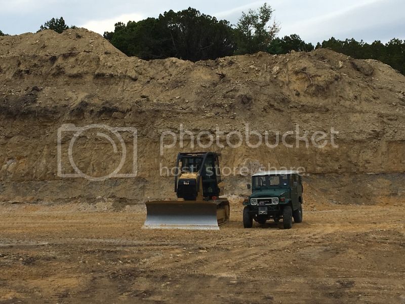

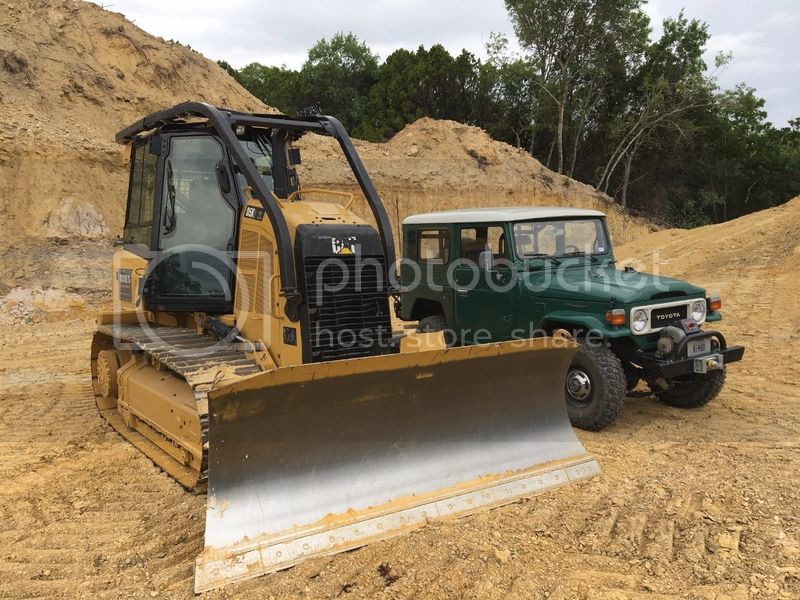

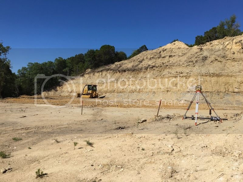

Bringing the house site down to final level grade with a Caterpillar and a laser level.

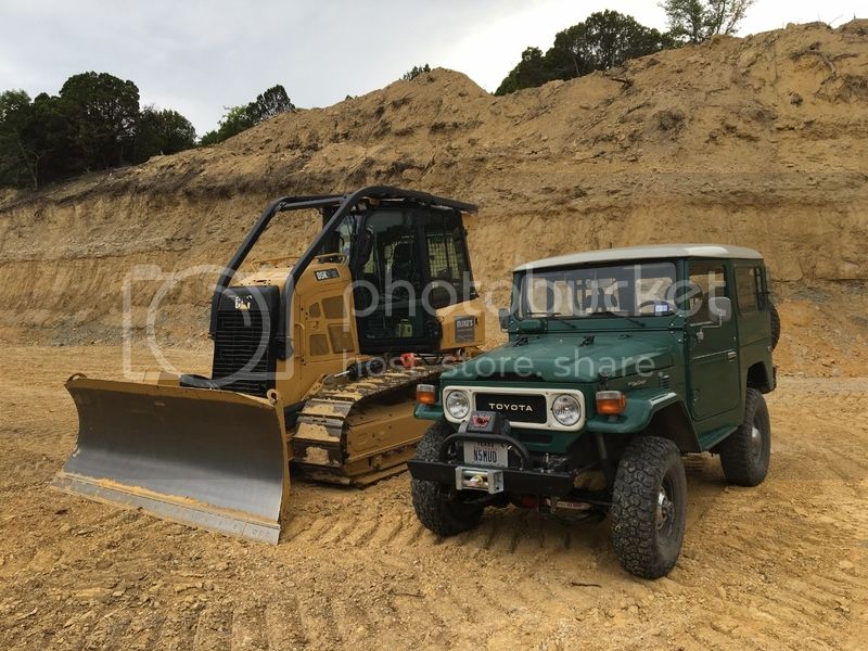

Two pieces of off-road equipment, a D5 Caterpillar and an FJ40. Surprisingly (to me anyway), they are about the same length. The D5 is only rented; I wish I could afford to buy a smaller one though. Maybe a second-hand one some day.
Perfect size for fun.

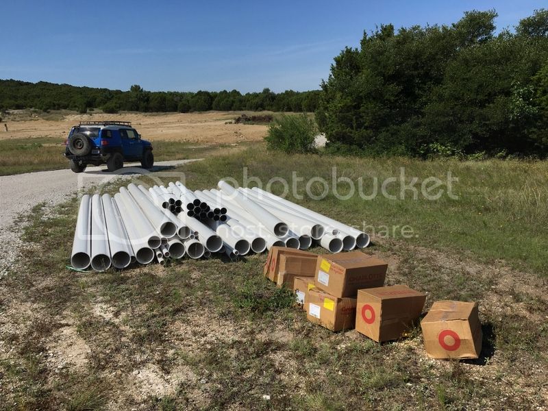

$3,400 worth of schedule 40 PVC for the french drains, air supply/exhaust ducting, conduits for power and water under the foundation. Delivery truck could not take it down to the house site, too muddy down there that day, so he left it up by my shooting range and I have to haul it down myself on a 10' trailer. Those 20' lengths of 4" heavy wall are HEAVY. Can only pick up one end at a time, and that is almost like work.

Well is it heavy wall or is it sch40!?!? Can't be both!
Nitpicking is what you get for posting so few updates! We never even got to see the finished apartment!
LOL, sorry, I'm not a plumber, I just gave the supply co. a list and paid for it.

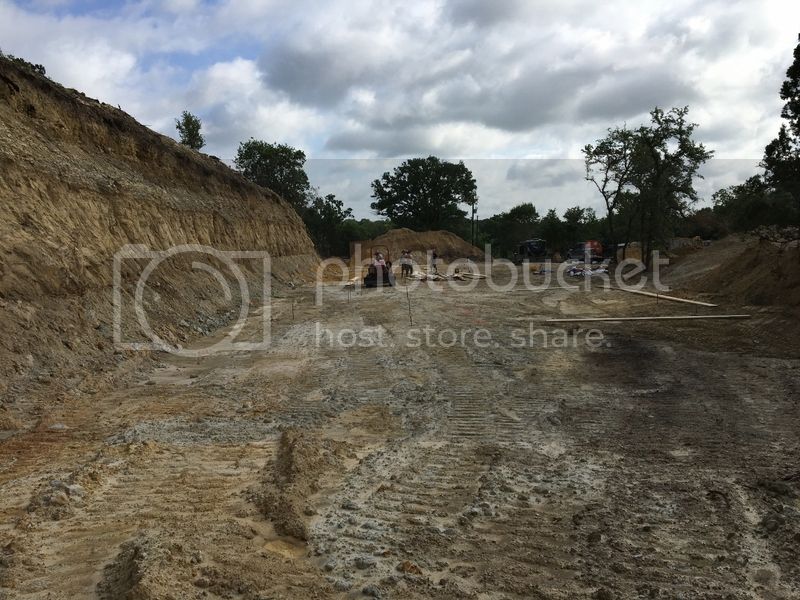

Construction has started in earnest this week. The earth-sheltered specialty contractor is here from Bastrop (Texas); they laid out the lines of the house with rebar and string. We ended up moving it north about 10' and rotating the north end slightly west, to hug the excavated wall closer. Also had to move a little more dirt.

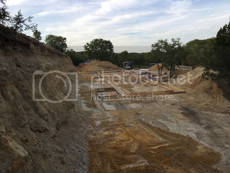

Here is a photo from the hill above the home site yesterday:

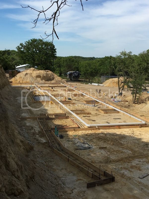

As of this morning, they are laying out forms for the concrete footers that will be the foundation:

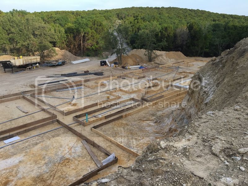

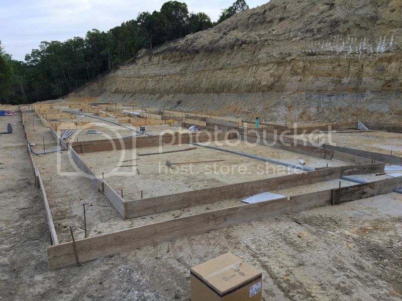

The air supply ducts, plumbing/septic drains and main conduit pipes for water and electric distribution are roughed in, and the forms for the footers (foundation) are mostly in place now but a few left to go. Shooting for Tuesday to pour all the footers at once.

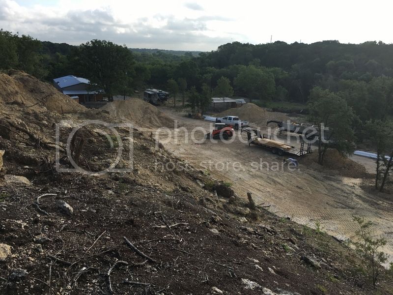

Bonus points if you can find the FJ40 in the second photo:
What's the deal with the plywood and sandbags? Covering a cistern, root cellar, bottomless pit?
Dungeon. Nobody expects the Spanish Inquisition! :)
Seriously, the builder called that a "pillow" for the bottom of the 10,000-gallon water cistern that will be cast into the back of the house. I think it has to do with forming a drain in the bottom, and making it the lowest point in the house, so that it would all drain out if required / if there was ever a leak, but I'm not 100% certain what the true purpose is.

Bonus point, I spy a 40 just a bit up and to the left of the white pickup in the second photo.
Bingo; you can barely see the white roof behind and to one side of the big fifth-wheel RV behind the white pickup.

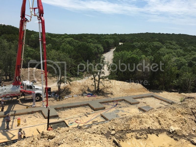

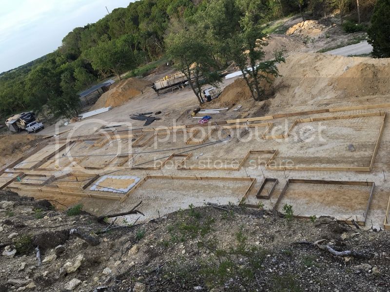

Rebar for the footers is mostly in, and a lot of the plumbing and electrical lines are roughed in. The HVAC ductwork is all in the footers also, that is the large-diameter PVC. A learning process for me; I didn't realize how much had to go in or under the footers before you start pouring any cement. I'm happy so far; the rebar is all heavy thick stuff cut to length, raised on chairs and wired together. Also, the cement volume has been re-calculated based on actual measurement of the forms (and the lengthening of the two retaining walls on either end) to 90 cubic yards instead of the previously-reported 75, just for the footers. One more day of banding the forms with metal strapping, and a little more plumbing rough-in and the footers are scheduled to be poured on Friday.

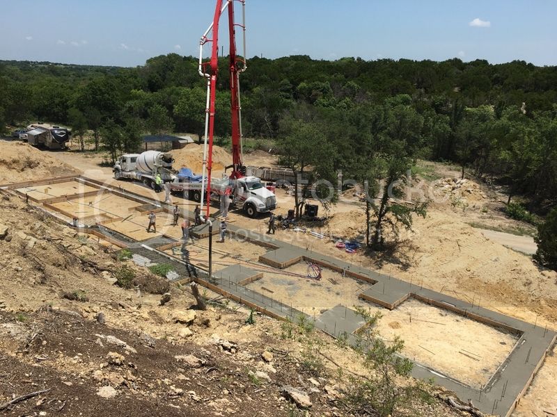

More photos to come; tired tonight after pouring in 100-degree heat. The crew was one guy short, so I helped scree the tops of the forms all day, and hauled water. Almost like work - the young guys doing it get $20/hour for it; would not be enough for me to do it for a living! But at least the old guy in his 60's could keep up with them.
