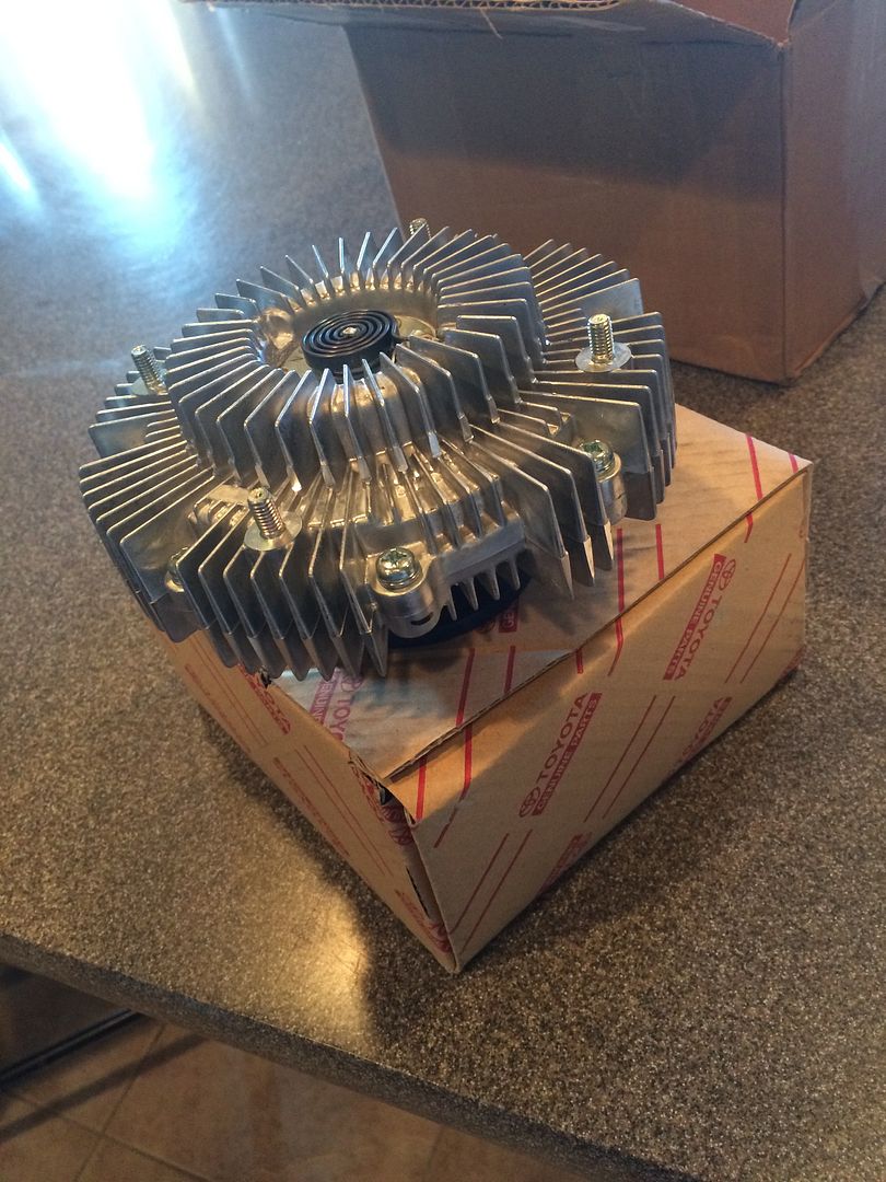

Ordered a blue fan clutch from CDan today. (Thanks again Dan!). My truck has been getting a bit warm on steep climbs so I check the stock fan clutch and it spins with almost no resistance so it was a good time to upgrade. Hope to have it installed this weekend. I still need to find time to dig into my front axle and get it rebuilt. If anyone has a spare birf (or 2) or spare inner axles they'd be willing to part with, let me know. I'm trying to round up all my spare parts before CM.

Oh man. it's tough since I'm already working an 80 hour week. Usually just get a couple hours late at night or early in the morning once or maybe twice a week if I'm lucky. Fortunately the fan clutch and belts were pretty simple and didn't take long.
Ok guys I need a little advice. I've been going through a million threads on the topic but I'm chasing some minor overheating. Most of the time the coolant temps seems normal, between 185-195*. But climbing long steep grades the coolant temps are rising to close to 215*. Little history. I purchased the truck in December so I don't have a clear picture of is past, but the radiator was replaced not long before I bought the truck. It's a Koyo Radiator that was installed by Safari LTD. Just a few weeks ago a good friend of mine who happens to be a Toyota Master Technician and a Toyota Regional Trainer took care of the PHH for me. While he was there he did a complete coolant flush/swap using Toyota Red (since there was Green in the truck when I bought it). He also replaced the thermostat upper and lower radiator hoses with OEM parts. I have also replaced the fan clutch with a new Blue fan clutch (didn't change the fluid in the new clutch and I'm using it as is), and I put new drive belts on while I was there.
I have no visible coolant leaks and have not noticed any coolant loss. But even with those changes the truck is still heating up on climbs. Today I went to try it again and it reached 212*. If I turn on the heater controls and the heater fan it will cool down to around 200*
I am thinking it is possibly a head gasket on its way out but could use some additional thoughts if anyone has any. Thanks!
