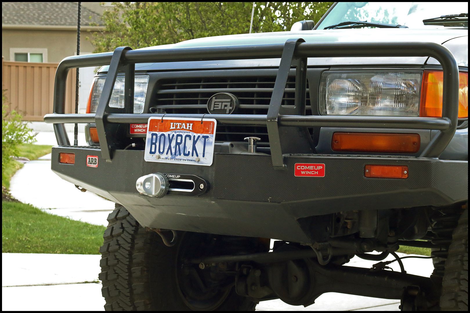

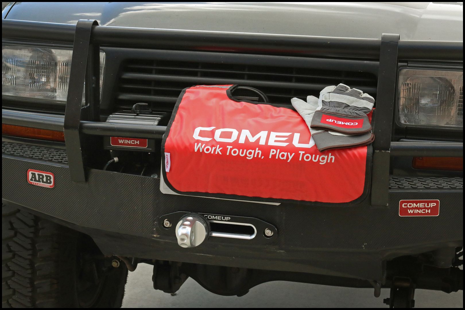

Finished up my winch install with the COMEUP Seal 9.5s
Really impressed with the quality of the winch so far. Looking forward to trying it out. Line speed is pretty good. Not the fastest but definitely not slow. The synthetic rope looks like excellent quality, as does the included fairlead.
As part of my order I also got a winch dampner and a pair of gloves. Not a big deal but will be nice to have.
Since my ARB bumper has been modified (was originally a winch bumper, but the PO cut all the winch brackets off as well as the lower skirt) I needed to add in some way to mount the winch. I like the higher clearance lower part of the bumper and it was pretty simple to solve the mounting. I used a universal winch cradle that I was able to weld across the frame mounting brackets of the bumper.
How do you keep the synthetic rope from getting trashed on rocks and stuff?

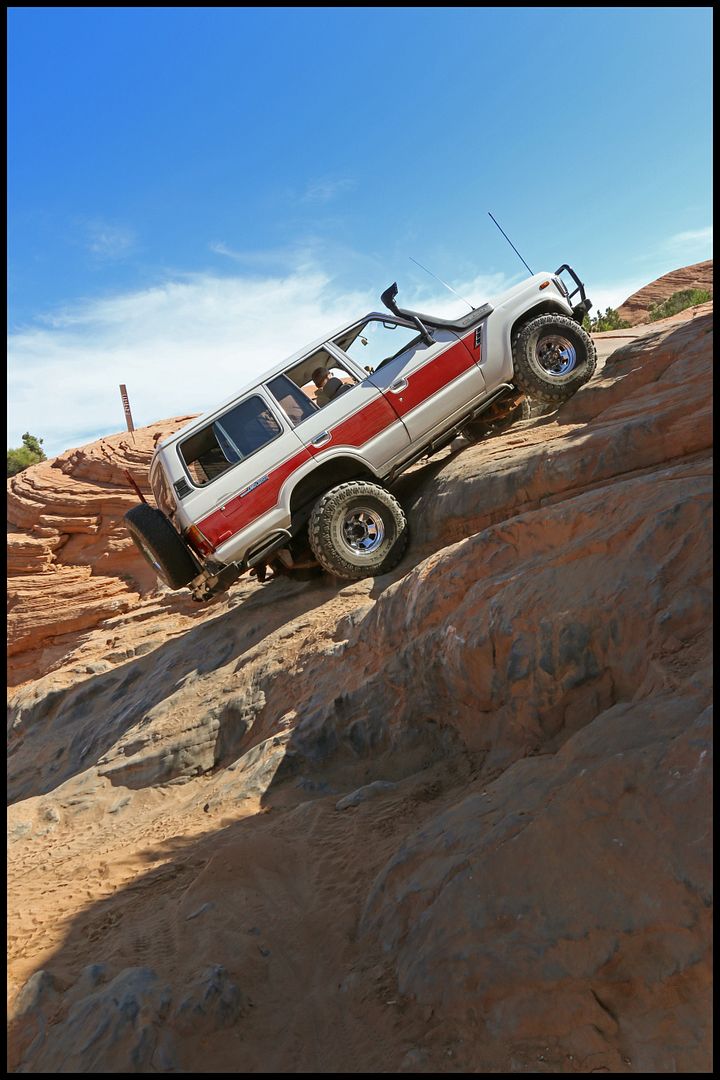

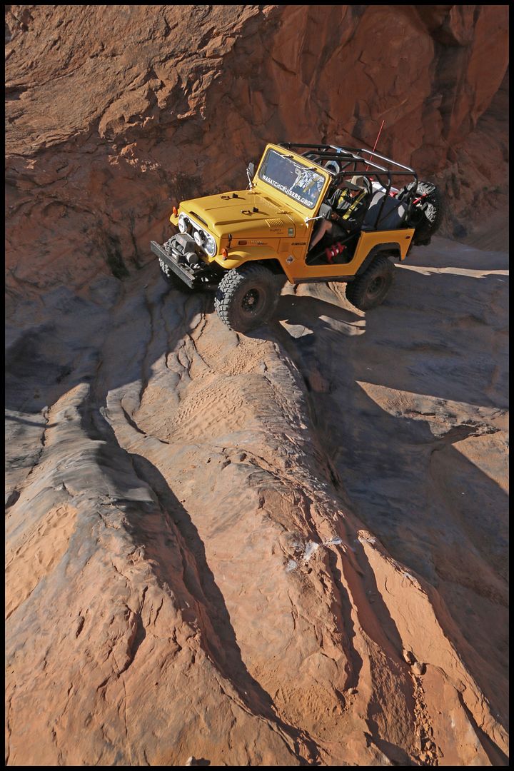

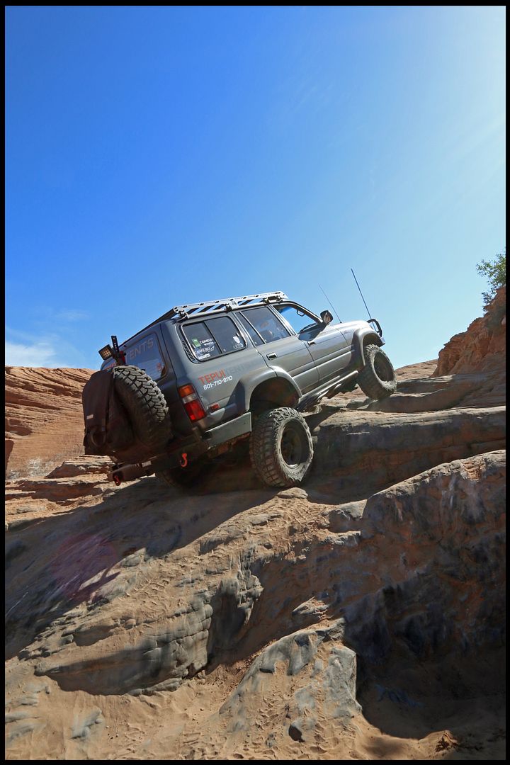

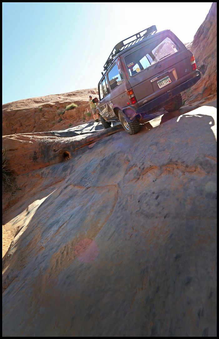

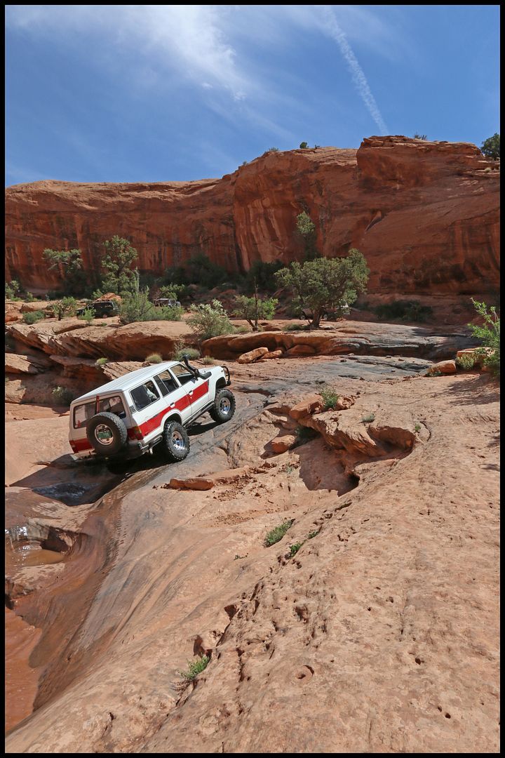

had a great time at Cruise Moab over the past few days. I led Poison Spider Mesa on Thursday and had a blast with an awesome group. Lots of experience and knowledge that made for a great day. We had Marlin and his son Mike from Marlin Crawler, Jon Bundrant from AllPro, Joe Calleja from CTS, Bryce (former GM from NitroGear). The rest of the group was just as great and we had a good time.
Friday we ran Fins and Things. It was uneventful and a fun mellow run. Saturday we ran Golden Spike. Had some fun guys in that group too and it made for a great day.
The vendor night was quite a bit quieter than in years past and it was evident in many ways that attendance was down this year. Still a great event.
The 80 worked great all 3 days. I needed to tighten up a wheel bearing but other than that there were no issues. The 80 went everywhere I pointed it including a few of the optional challenges like Double Whammy. I'm still working out a few minor quirks since it's a "new to me" truck but overall I'm really happy with it now that it's got some trail time.
