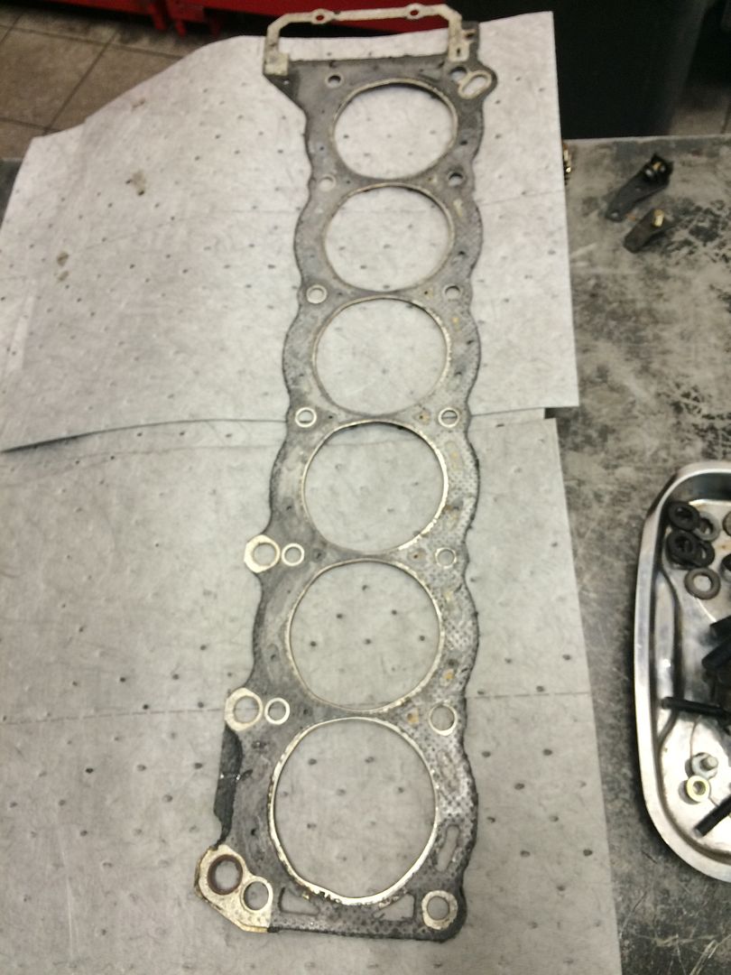

Well, a bit of an update. Had the motor pressure tested and it started pumping coolant out of the back of the motor. So it's looking like HG or coolant hoses at the back of the motor or a combination of the two. But there was also residue on the plugs that points HG failure so looking like I'm moving forward with a HG swap.
Well that sucks. That's how mine went. External HG leak at #6 even though the truck ran fine and never got hot.
Well unfortunately all signs point to yes. Sorry about that.

Motor is back together and the Cruiser should be back on the road this afternoon. Initial startup was smooth and it sounds nice. The head was is pretty good shape and only needed a small amount of machine work to get it squared up. Valve seals were replaced, along with the valve cover gasket (which was leaking) and the Distributor o-ring that was also leaking.
