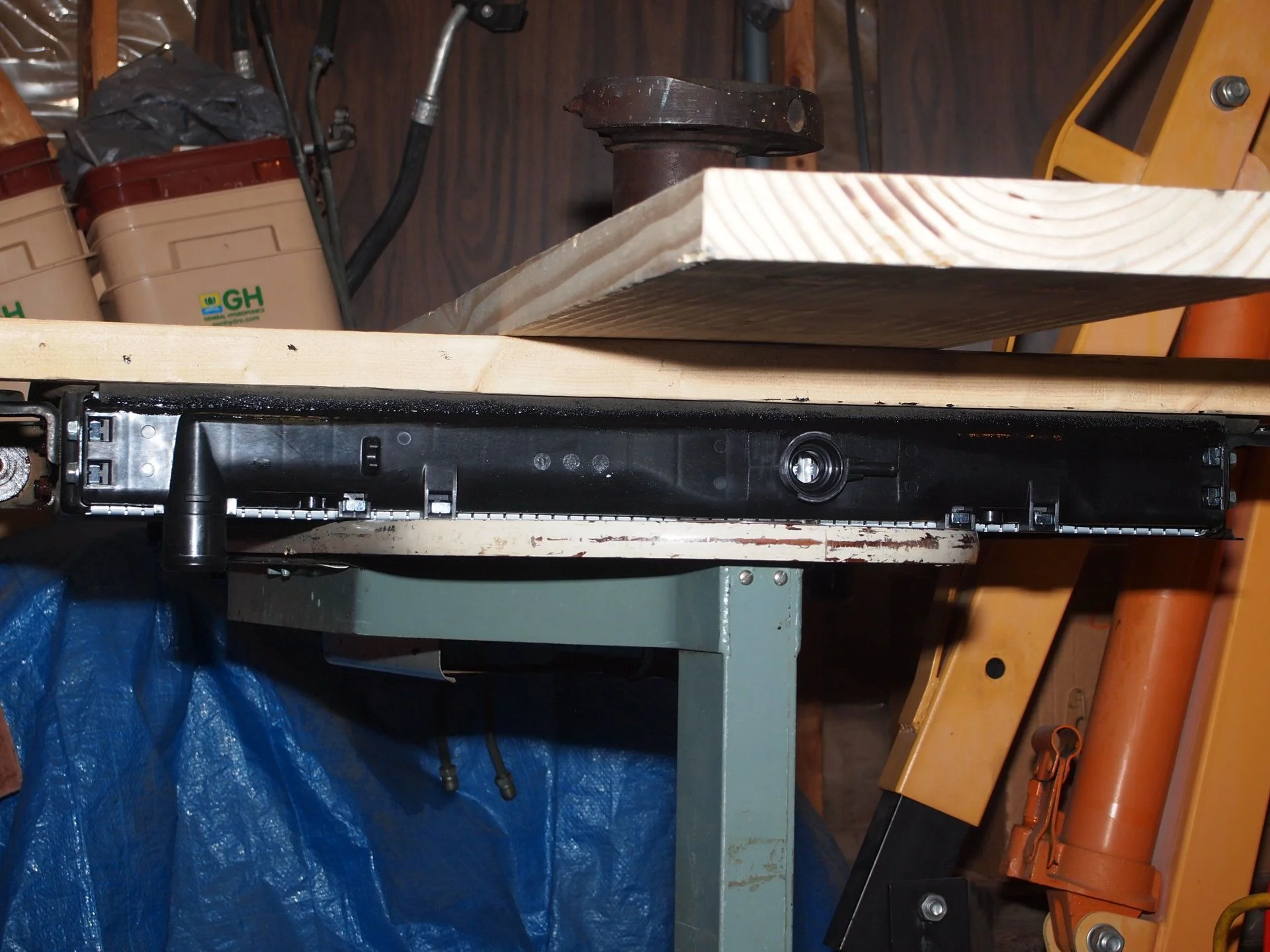

I take old radiator foam and swap to new. By remove the side supports which have foam, and bolt onto new radiator. Take a razor and cut top foam from old. Trick is to cut again the plastic radiator with razor, under double sided backing tape of foam.
I just toss the new side bracket in trash and keep my old one with foam.

I set glue and place weight on foam ASAP. To allow some drying time. While I work on thermostat, hoses, etc. while glue set up.
I've be use FIPG 102, 103, 1282B and now have some 3m adhesive. All seem to work fine.
