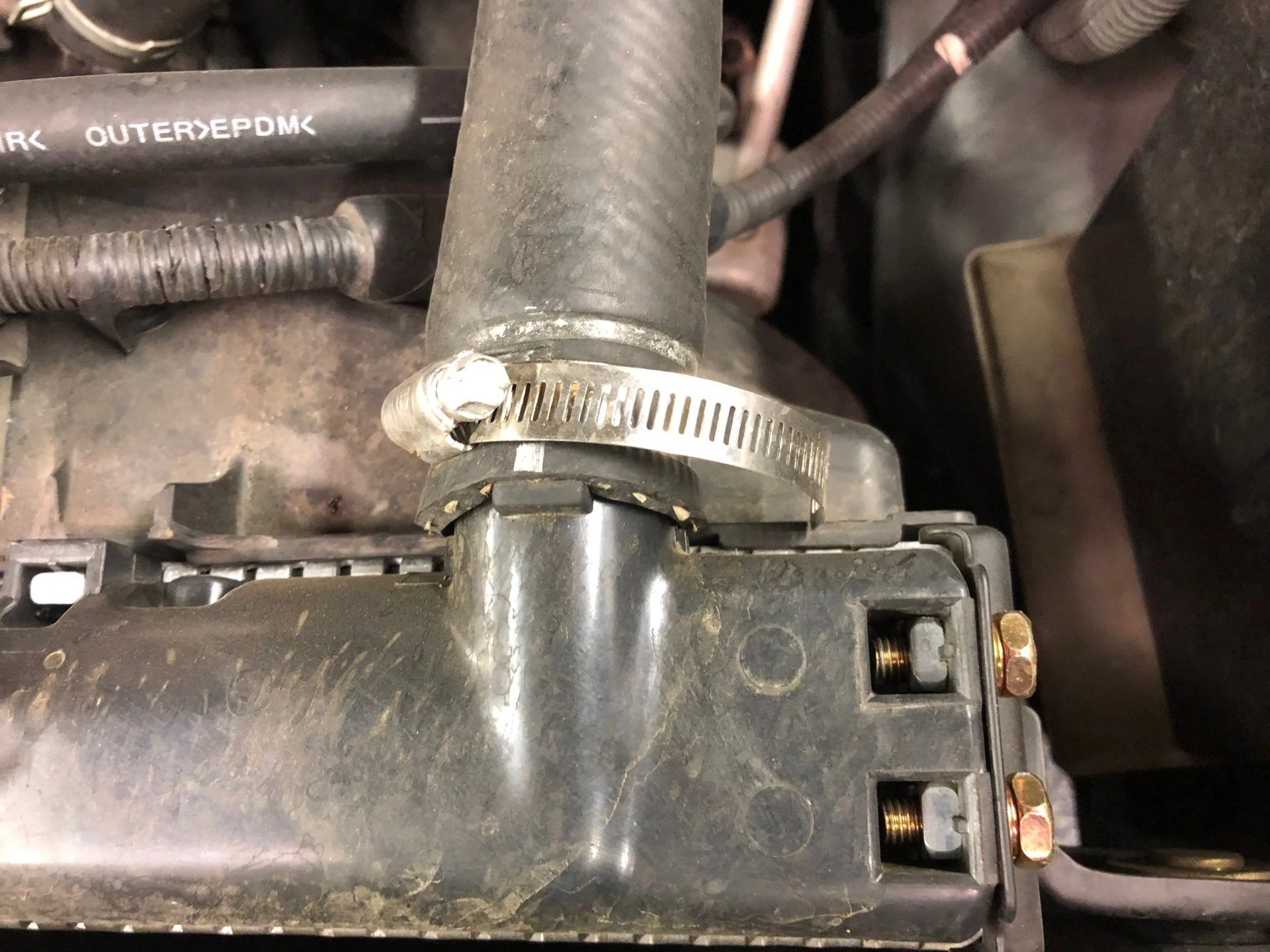

I installed the Spectra Premium CU2755 radiator and Gates 22491 lower hose on my 2003 last night and while the install was relatively painless, I had a hell of a time with the lower hose to radiator connection leaking. The factory squeeze-clamp was tight, and I used the Gates hose which fit snug without the clamp. I ended up using a screw down clamp which was able to stop the leak, but it was still concerning. I didn't measure the diameter vs the old radiator, but I've never had this much of an issue with a hose clamp lol..

The Spectra lower outlet is slightly smaller diameter(-1.5mm). The Continental Elite #62745 hose is thicker and helps make up the difference. But- the coolant seep is also propagated by the small casting seam on the outlet- it runs horizontal and allows coolant to travel past since even a new spring clamp wont stop it. You have to sand it down smooth on both sides- (pita). This is discussed earlier in the thread. post #178
Glad I found this topic. Truck I just got had radiator replaced 8k miles ago. All clamps were replaced with non-originals which I hate. Now I see why it was done. I was going to order OE hoses and clamps but will go with Continental hoses as most likely this is what I'm dealing with. Look at how OE hose swelled and it does look like it will be loose.
Since Continental hose thicker - I can use proper OE clamps, right?
Top inlet seems to fit ok with oem hose- I have oem on top- Continental lower. Factory clamps will work fine. B
