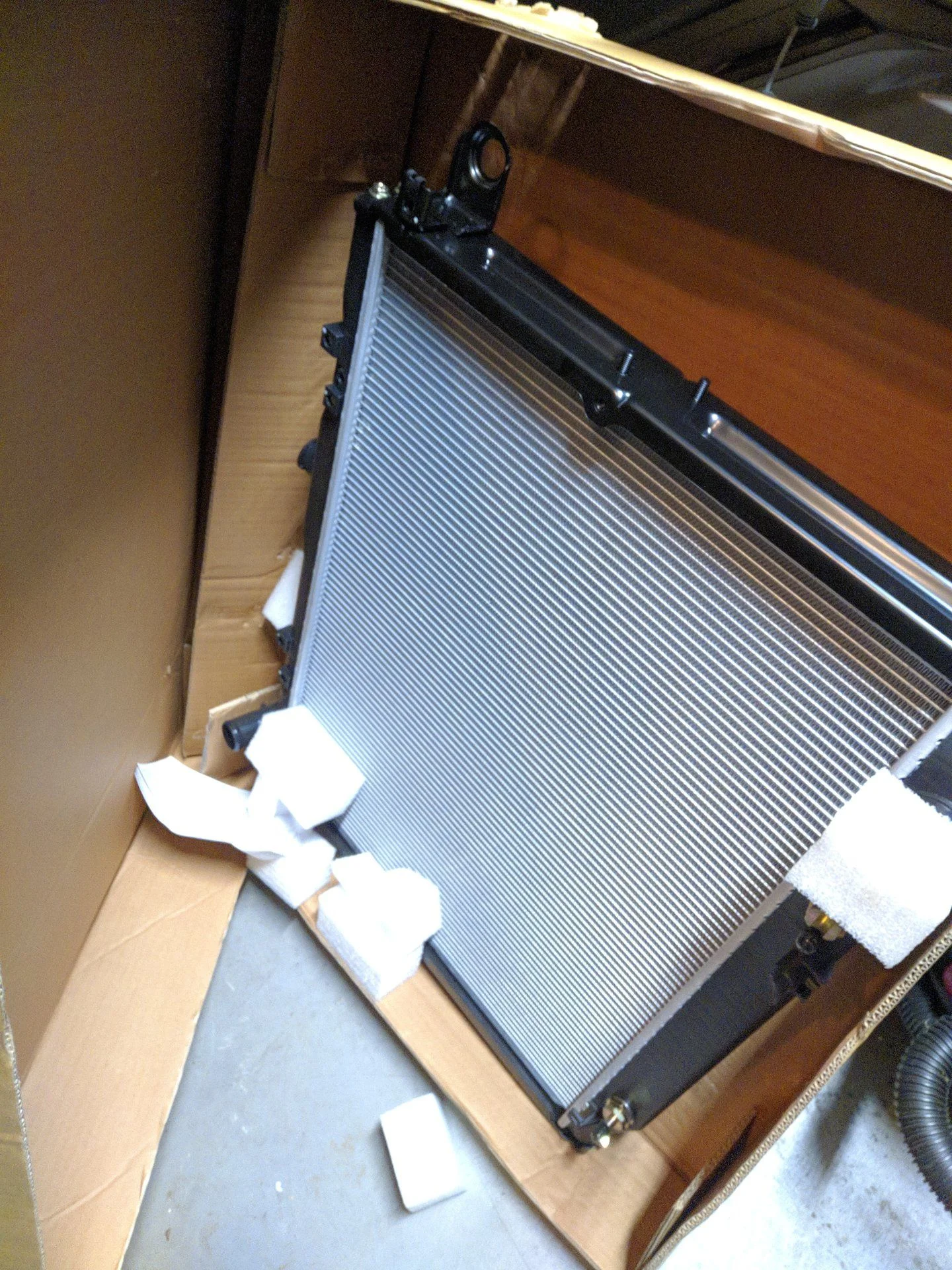

Replaced my factory radiator from my 01 LC for a Mishimoto Radiator. Over the past year I've noticed the operating temperatures slowly creep up. On a hot day, on the highway, I was around 195-198 F. When idling the temperature would sometimes hit 200-202 F. I figured the radiator wasn't cooling sufficiently anymore.
I'm happy to report the Mishimoto Radiator arrived with no issues (ordered directly from their website). I also replaced the radiator cap with an OEM Toyota one, OEM thermostat, and OEM thermostat gasket. The upper and lower hoses are also OEM Toyota and were replaced about a year ago (didn't replace those). I used the factory clamps for the upper and lower hoses and so far no leaks (after 1 week).
I used Pentofrost Red Coolant after flushing out the old coolant (which I believe was Toyota red).
My temperatures now are around 183-186 F. Overall I'm happy with the results.
Question: How important are the foam liners that come with the original Toyota radiator? The Mishimoto radiator didn't come with those foam liners so I installed it without them.

The foam strips help ensure that as much air as is possible flows 'through' the radiator and not around it. Since your current temps are excellent, it suggests you are fine without them (even if not getting optimal airflow).
That said, I would encourage anyone replacing their radiator to source some type of foam strips and install them at the same time they replace the radiator. Toyota considered them 'necessary', so best to follow that line of thinking.

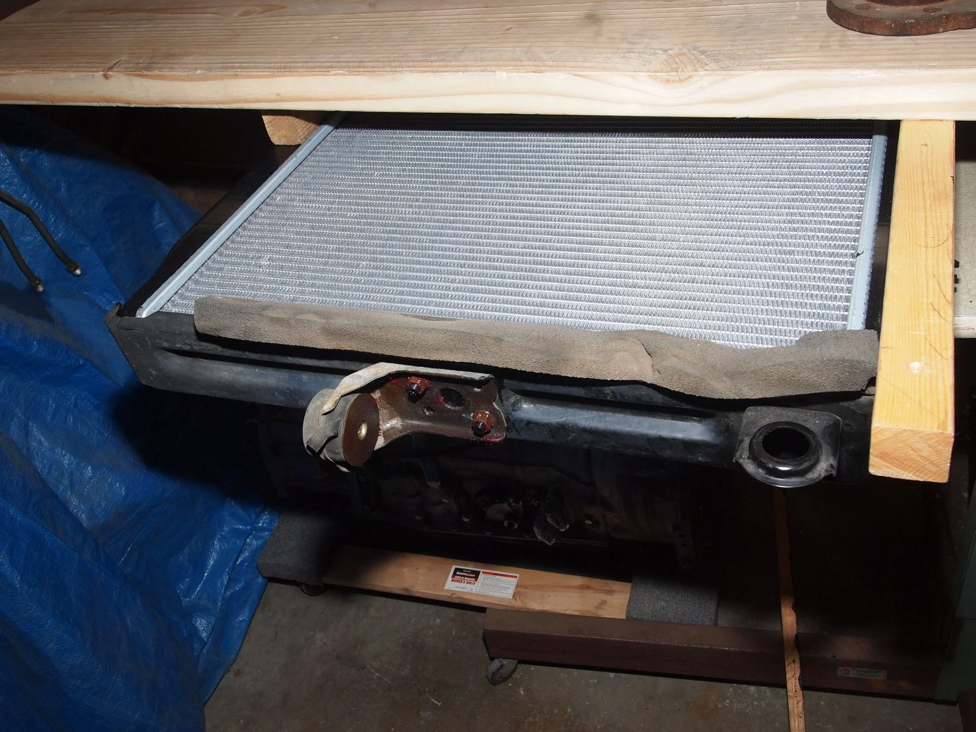

I always swap the foam from old radiator side. I also cut off top foam and glue to my new radiator.
2014367
A little weight while adhesive sets up.

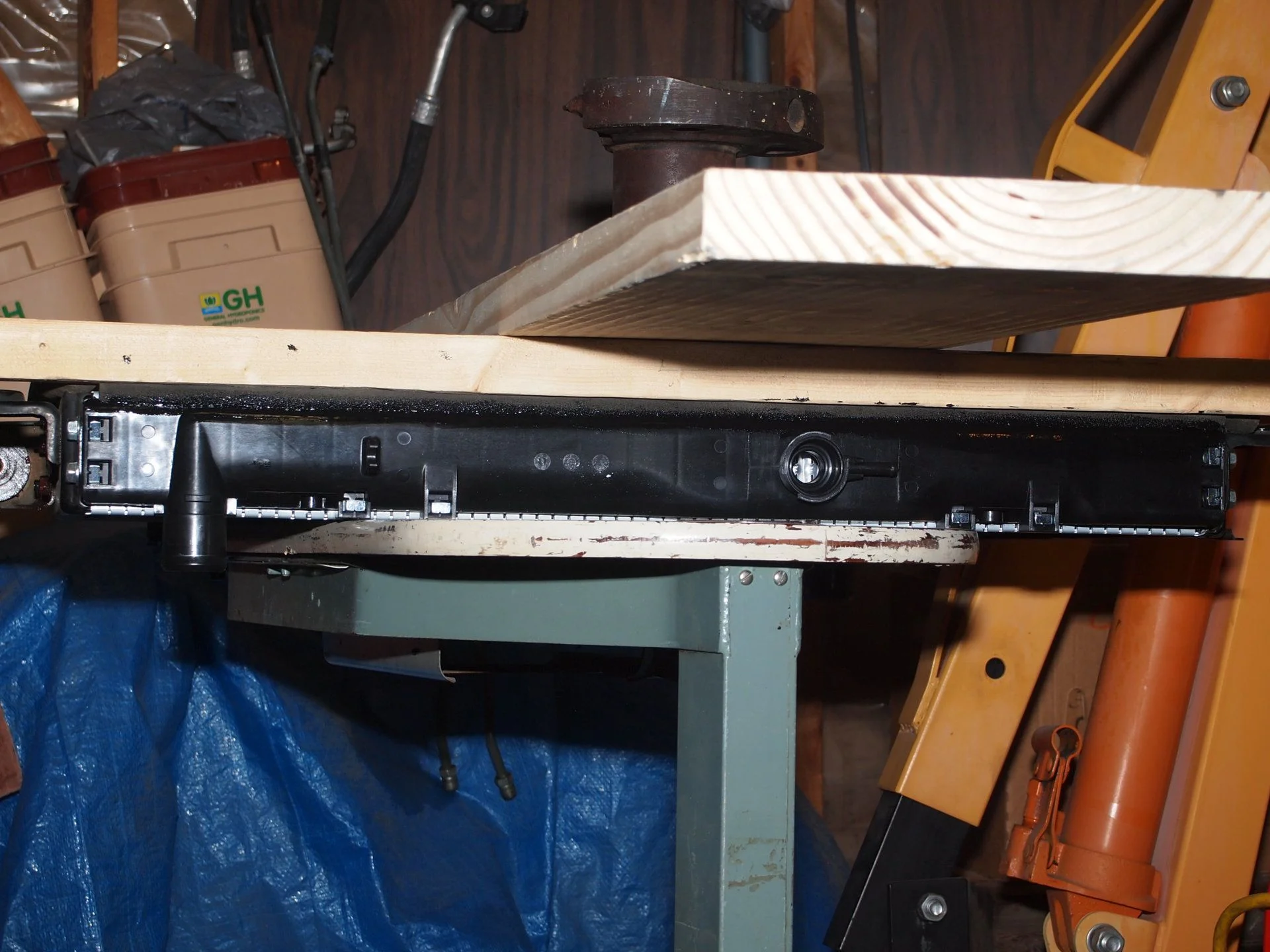

2014368
OEM come with foam and saves time, but at higher cost.
Additionally I R&R cap, thermostat and hoses. Tees if not done and flush once while old in first.

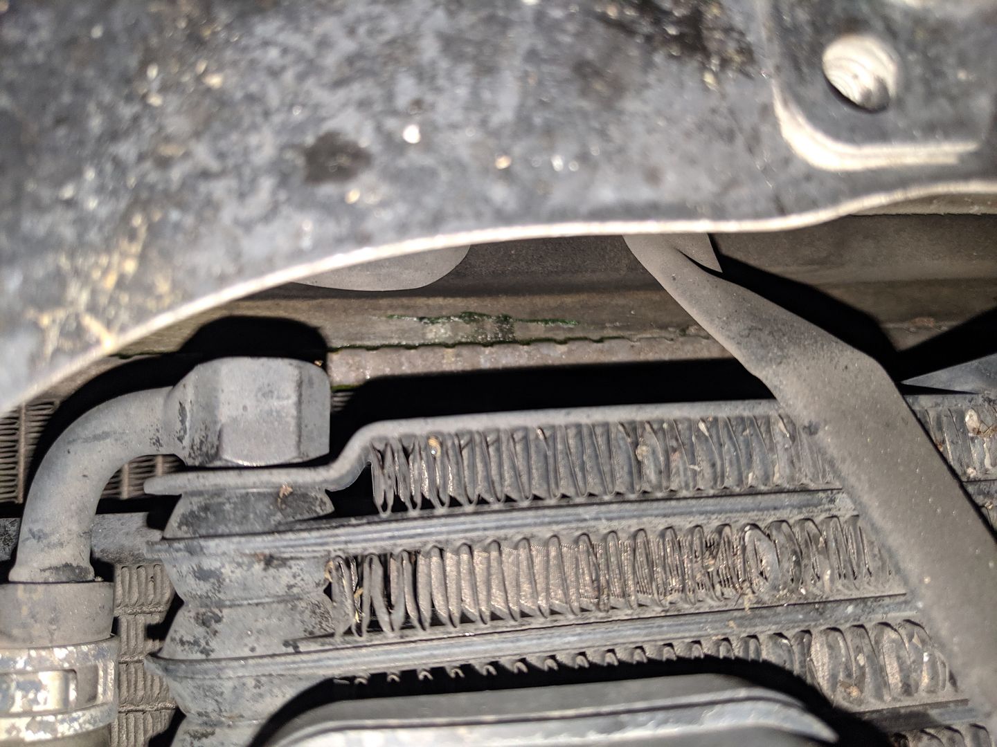

If radiator not cooling as well, it's dirty. The inside will be in great shape if Toyota recommended service guide-line followed.. But what I find in every inspect, once skid plate pulled. The radiator fins are clogged.
Cleaning the fins is a Toyota recommendation most never do!

Pull the skip plate to start with. Some cleaning tips:
1 graduation from center line on temp gauge is not much. Running at higher RPM does raise temp. So does: Dirty fins, Sticking thermostat, Engine running lean, Vacuum leaks, Clogged coolant system from improper flushing (never add tap water, not even to flush) or not topping radiator are the main reasons.

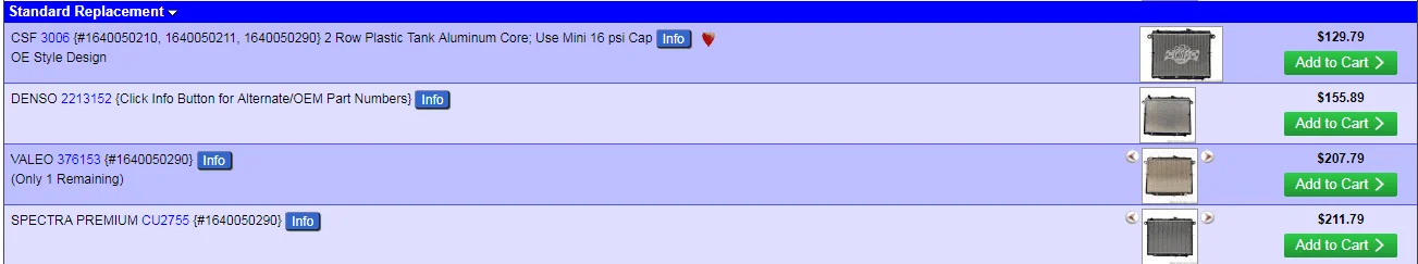

I only see a couple posts about it in here, but the CSF radiators seem to be received well.. Has anyone experienced issues with them? What about the hose diameter issue?
I see issues reported here with Denso and Spectra, but very little on the other 2 options that Rock Auto lists.

I would ignore that one since it says use mini 16 psi cap. Someone else on here said his radiator had a different cap because the stock cap didn't fit on it, maybe it was that brand.

Why would a radiator have a mini cap pressure? A max pressure I'd understand!
I've been using CFS (G1000130859CSF) Radiator from Advance Auto (Worldpac). The OEM Cap fits the CFS just fine. Perfect fit, no modes and no leaks every time. I've done about 6 in last two years.
He might be referring to me; the radiator in my truck is aftermarket and will not fit an OEM cap. It's a 'mini' cap, about 60-70% the physical size as OEM.
