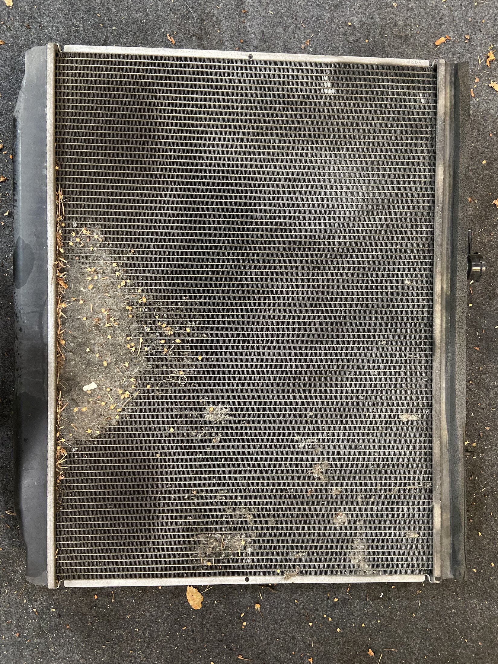

This is the old radiator, forward face. That debris is what was left over AFTER I attempted to clean it in place when I got the truck. 😬
Yep, that's Every. Single. Pulled. Radiator that I see pics of.
Kind of explains the "you should get a [insert Brand X radiator here], they run so much cooler!" posts.
My advice for anyone changing the rad is to flush the AC evap coil from behind while you have the opportunity. :D
