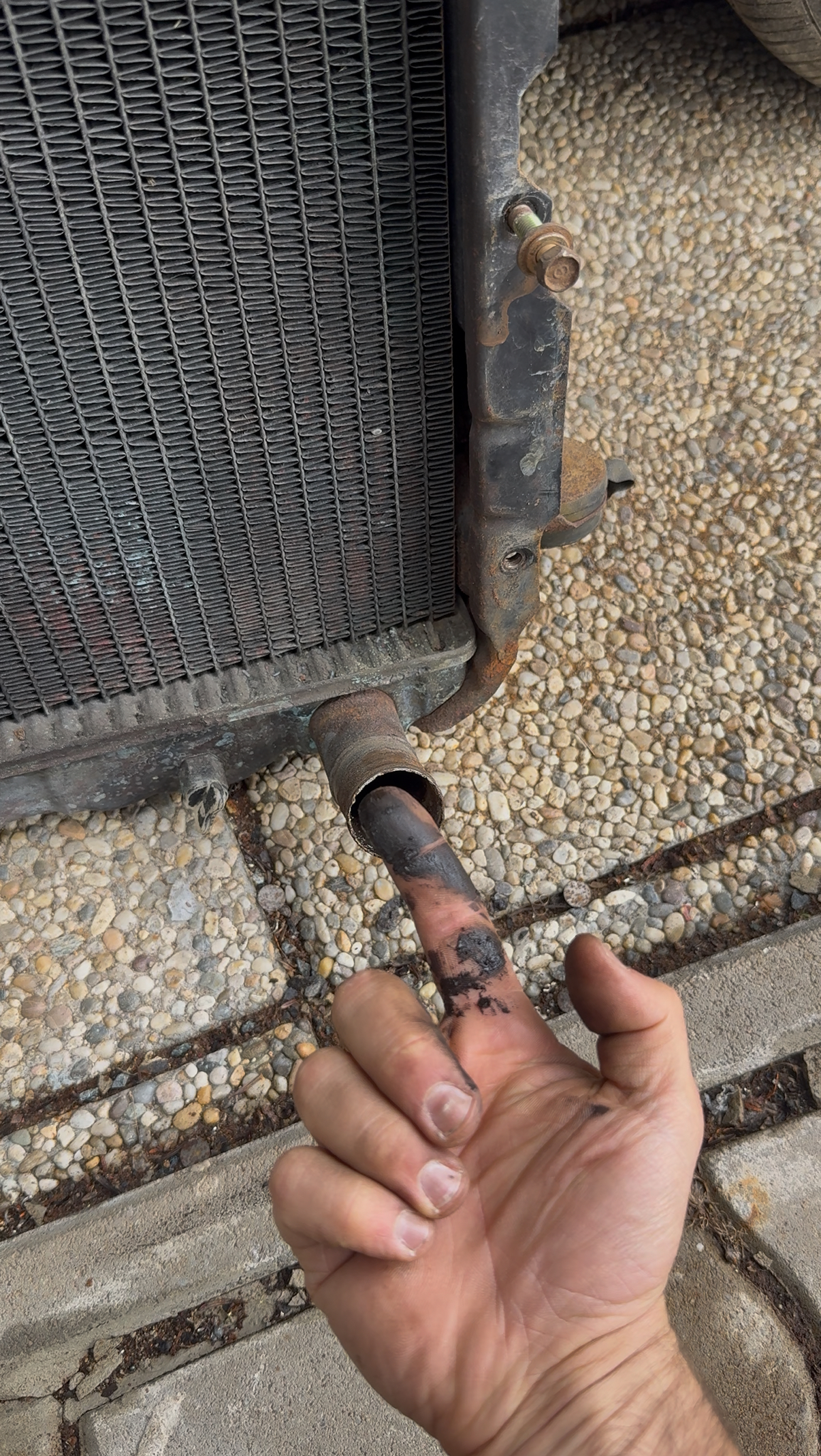

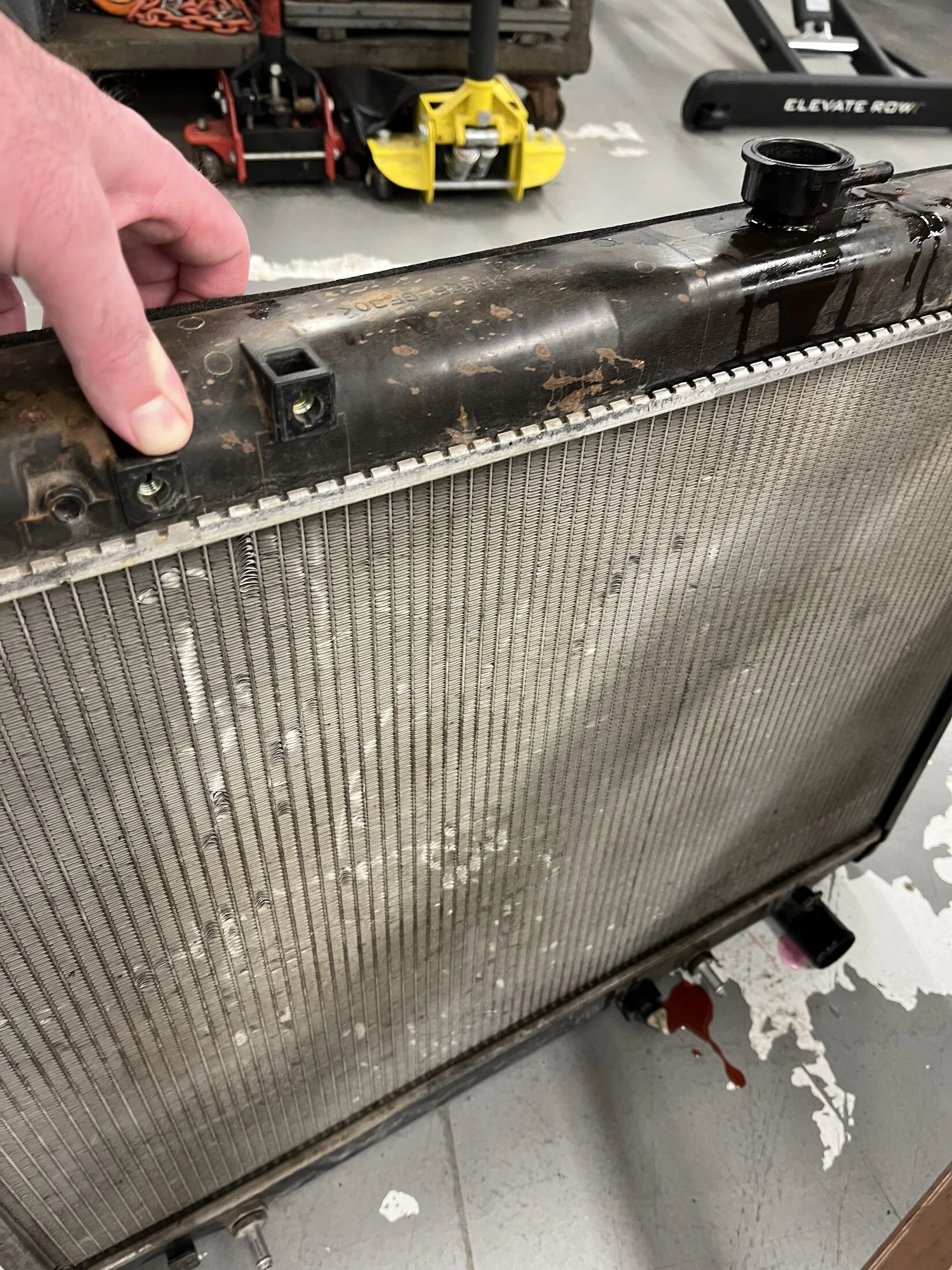

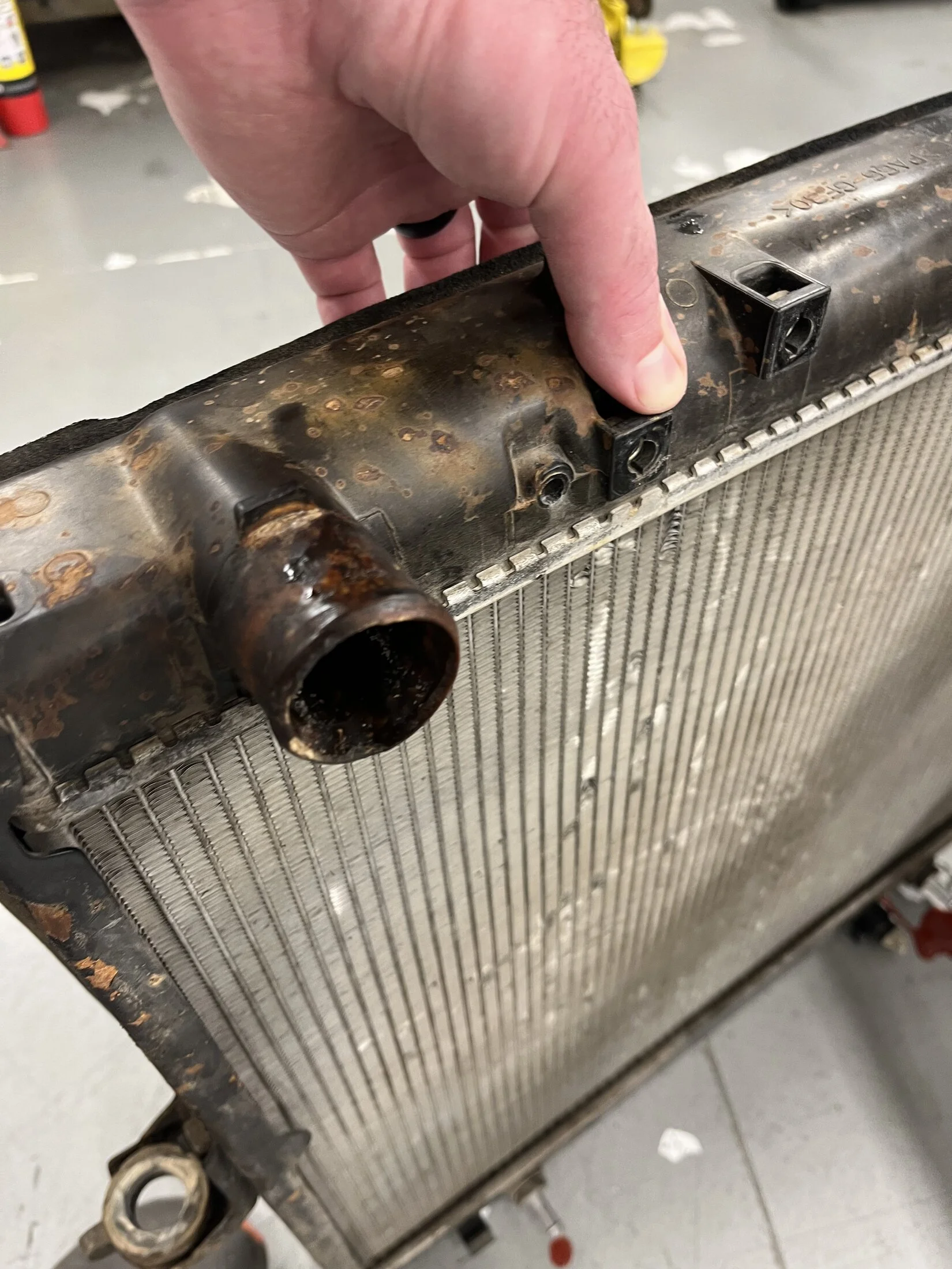

Took an hour to get the old one out- so far super easy job compared to other tasks on the 100. Looks like it was time-
The core looks clean just like mine was at almost 20 years. I wish somebody offered aluminum weld-on endtanks for the OE radiator. Bet you could get another 10-20 years out of it.
They show that process happening in places like India all over YouTube. Pretty ingenious continuance of industry.
