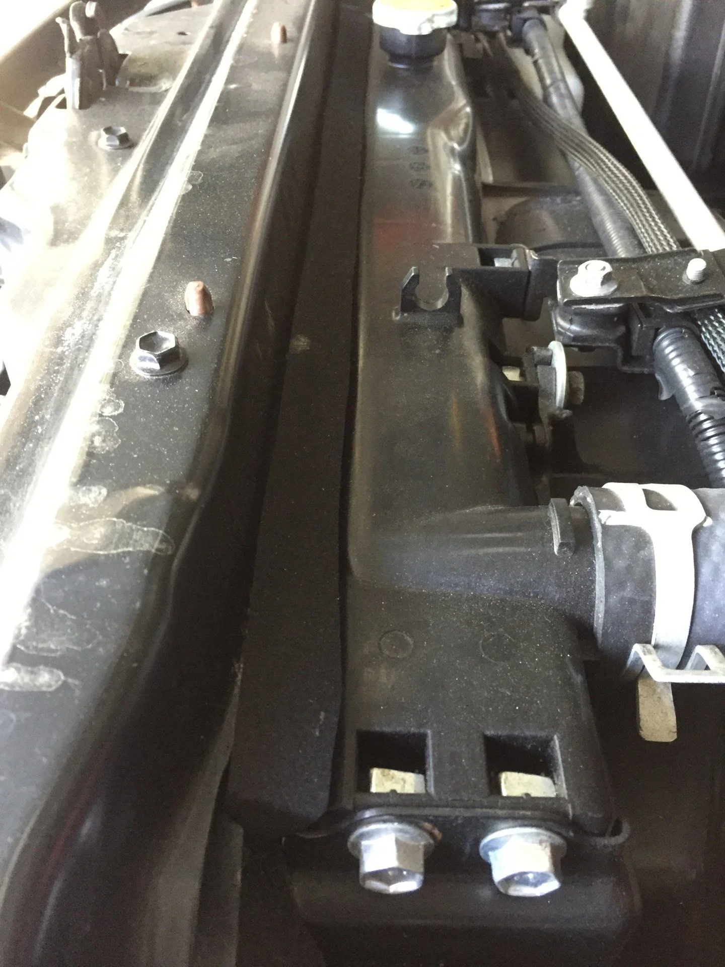

If you cant salvage factory foam, you can use non absorbent closed cell foam weather strip from HD, Amazon 1"x 3/4- works well in hot, cold, wet environments. If you cant find a HD or Lowes you can get it here:
Amazon product ASIN B06ZZ41VTP
I reused the side mounts with factory foam on them and bought some 1"x3/4 for the top strip.
Have you tried using any aftermarket available foam rather than re-using the old OEM foam?
I just installed one this weekend. I used the side brackets from OEM like 2001LC mentioned and then bought some foam from HD to add tot he top. It was one that would expand up to an inch when unrolled. It worked quite well. Even got some fluid on it when burping the system and it
+1 to this. I used it this weekend on my install for the top and moved the side brackets from the old radiator like @2001LC mentioned.

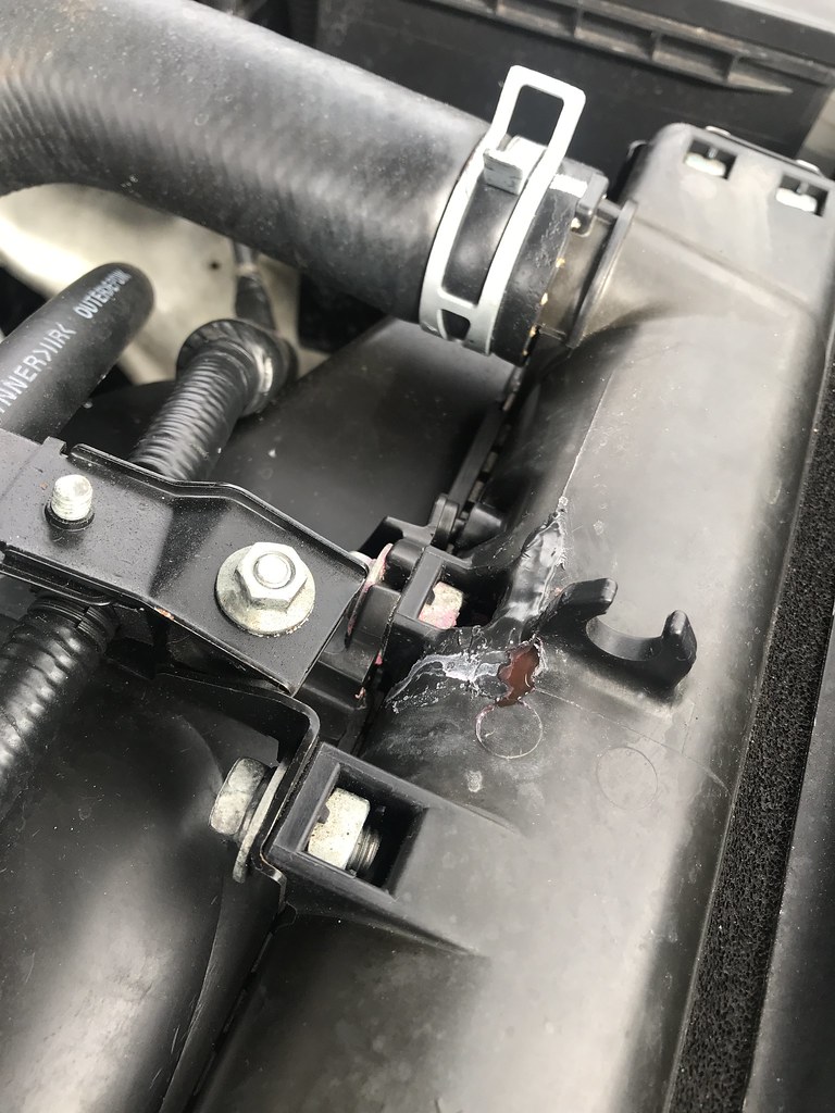

I developed a hairline crack on the top of it, found out at work doing my weekly check. I cleaned the area, drained some coolant and applied some JB weld temporarily, it actually held up and didn't leak at all for a few days. When i had this thought of this being too good to be true i stress tested it, pushing the truck at high RPM it started to seep out again. Not much, a few drops...
What radiator do you currently have in the truck? Looks fairly new otherwise?
OEM, 200K miles 2007 LX, it looks new minus that little hairline crack, which sucks.
Thats pretty much exactly what happened to me but mine was on other side would leak down above the fan and spray back at the engine, I put JB weld on but it still leaked.... I made 7 months lol I dont think I recommend that. But again, the CSF from rockauto came to VA in two days and was packaged very well.
