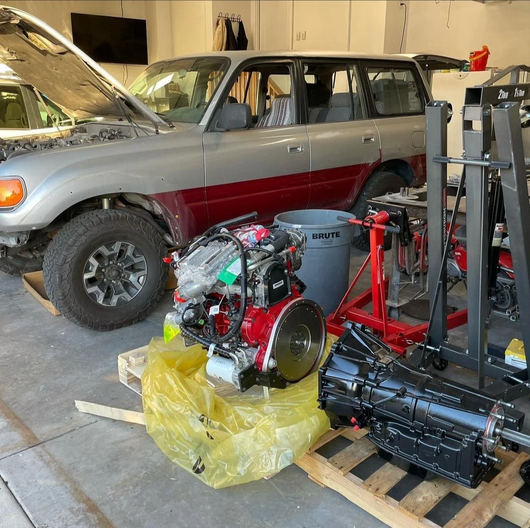

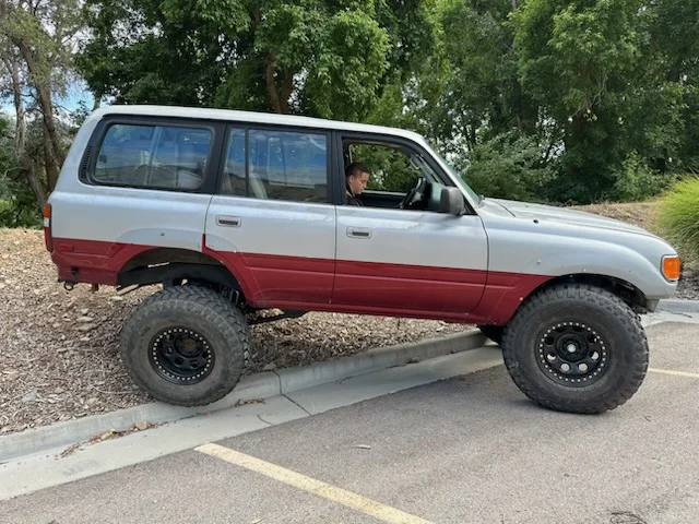

One of my buddies is doing this swap to his 91. The rig is running now with new suspension put in as well. super modern and lots of usable power.
