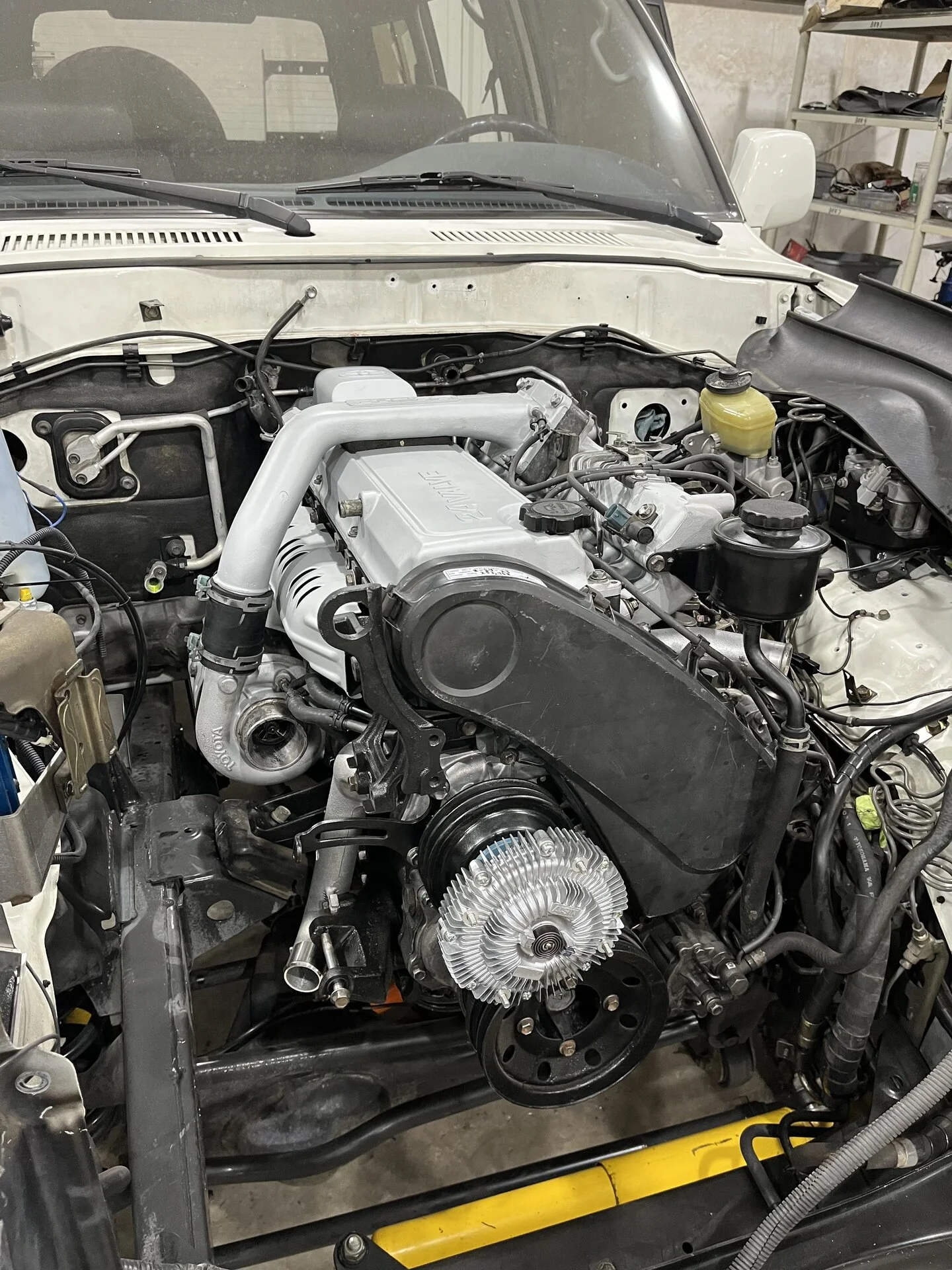

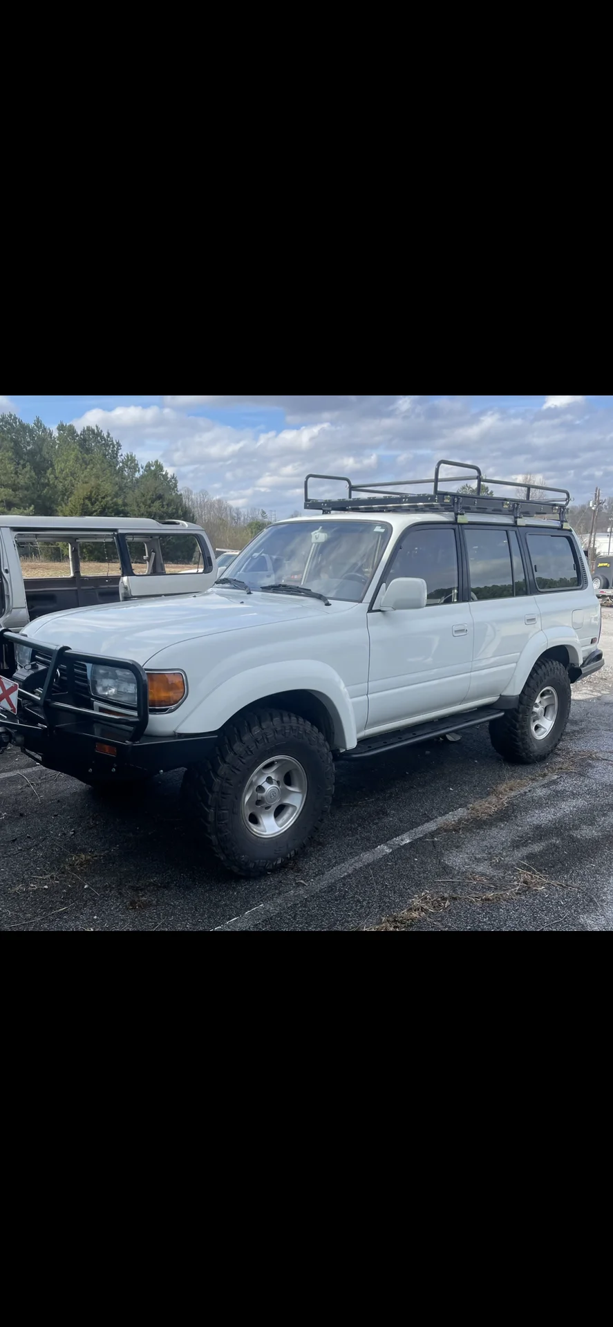

We are doing a diesel conversion for a customer’s ‘96 FZJ80. We decided on a 1HD-FT out of a ‘96 HDJ81 with a A442 and HF2A. We will document the build and progress here.
Sounds awesome. Doing all that and they wanted to keep it automatic?
Yes, he wanted his wife to be able to drive it and anyone in his family. Keeping it Auto was by far the most challenging part of this swap. We grafted the FT harness in with the factory FZ harness with a FT cluster (in MPH). It was countless hours of wiring, but everything works and performs factory. More pics to come later on...

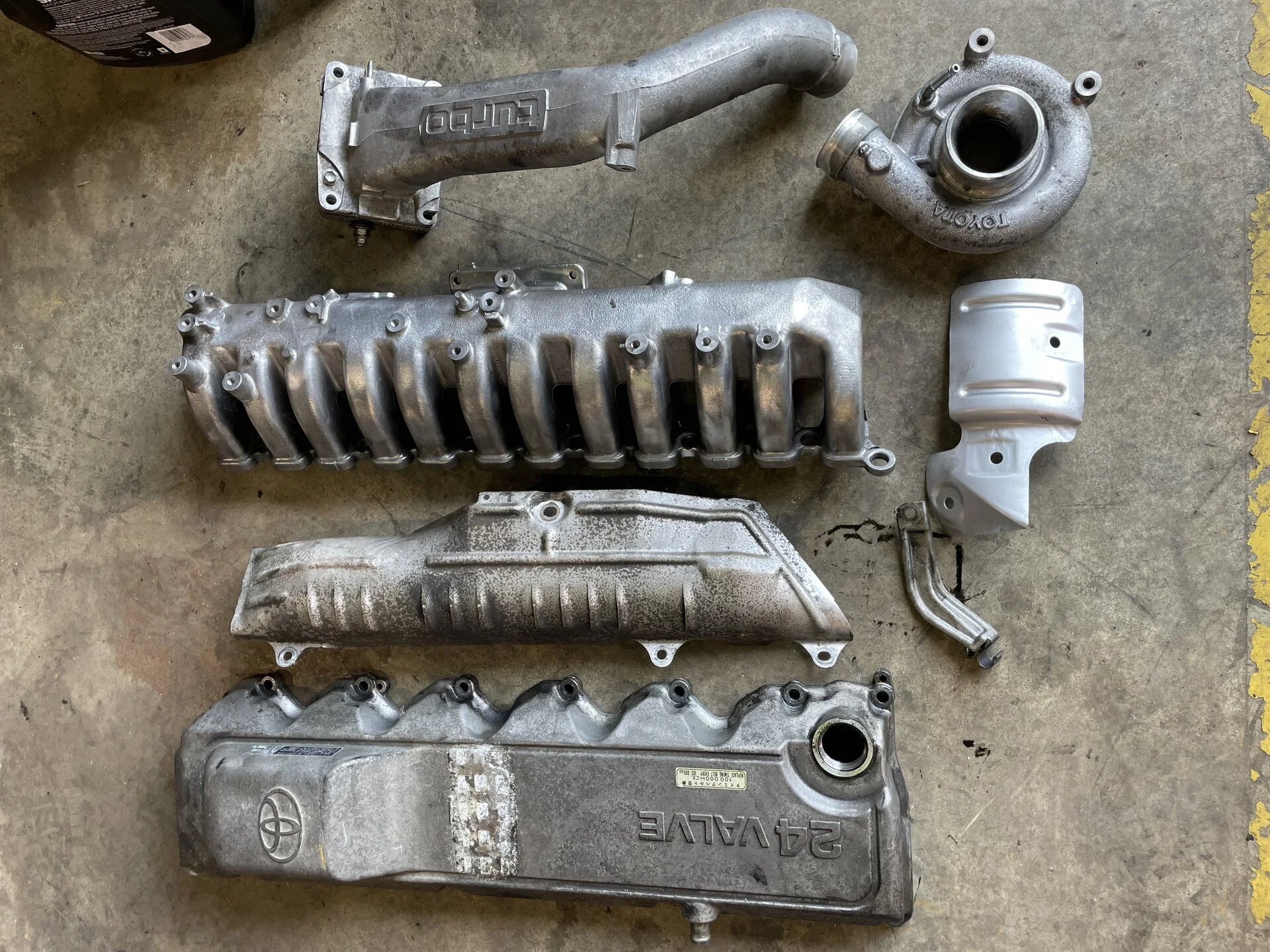

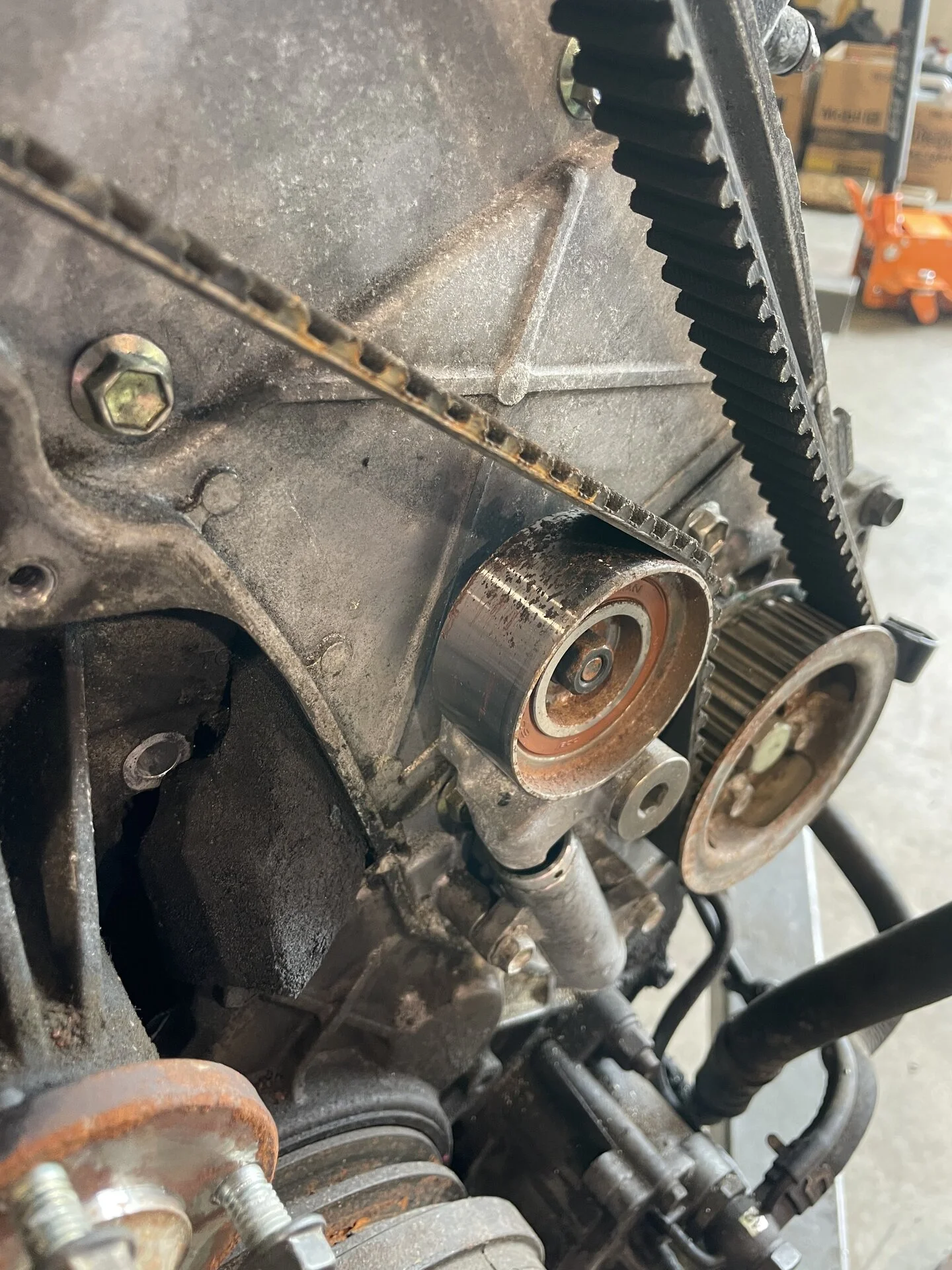

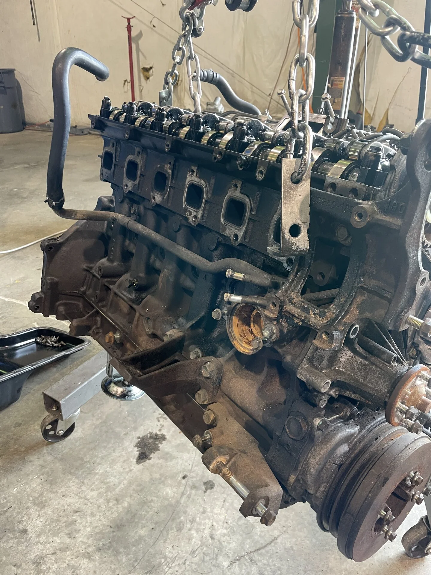

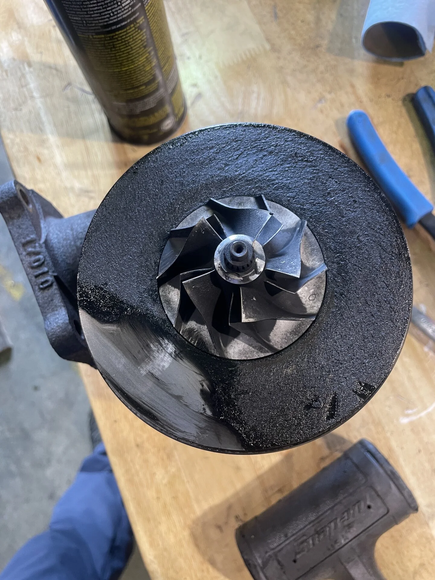

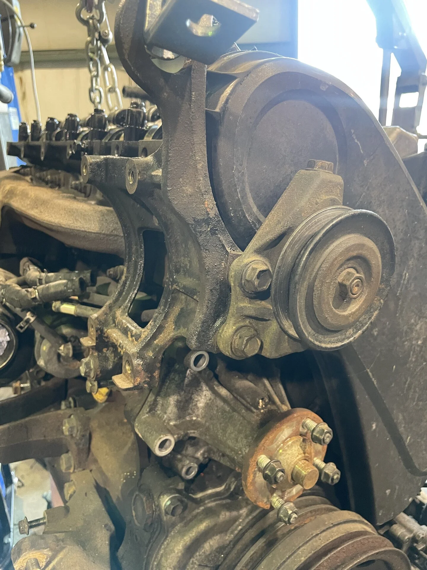

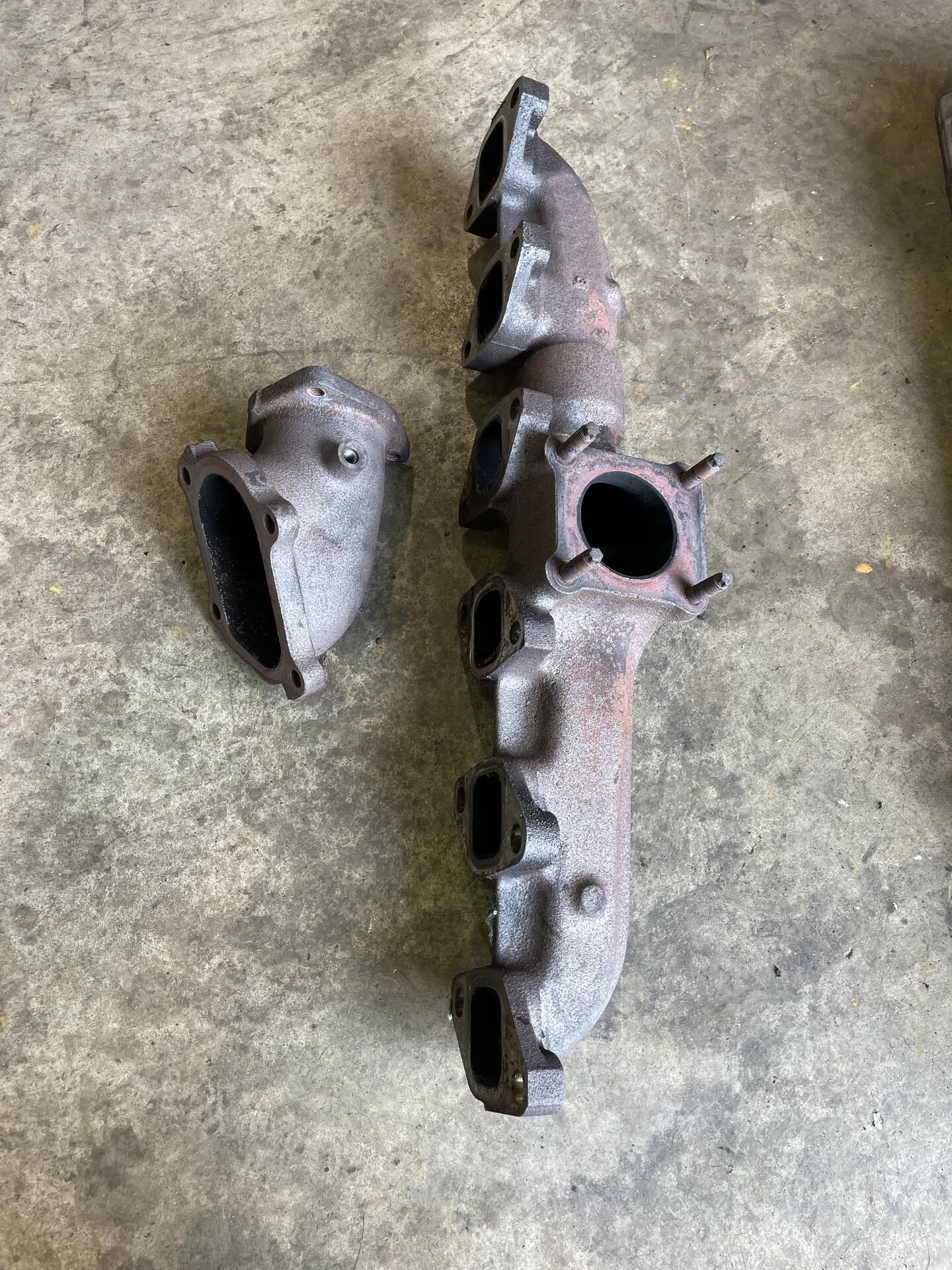

We sent off a bunch of parts to get powder-coated and Cerakoted while we worked on replacing timing belt/water pump, all hoses (fuel/coolant) and resealed the FT. We removed the head, sent it to machine shop to get checked over and then installed new valve stem seals, all new injector seals/washers, and replaced the head gasket and head bolts. Also checked BEB’s before we resealed the oil pan.

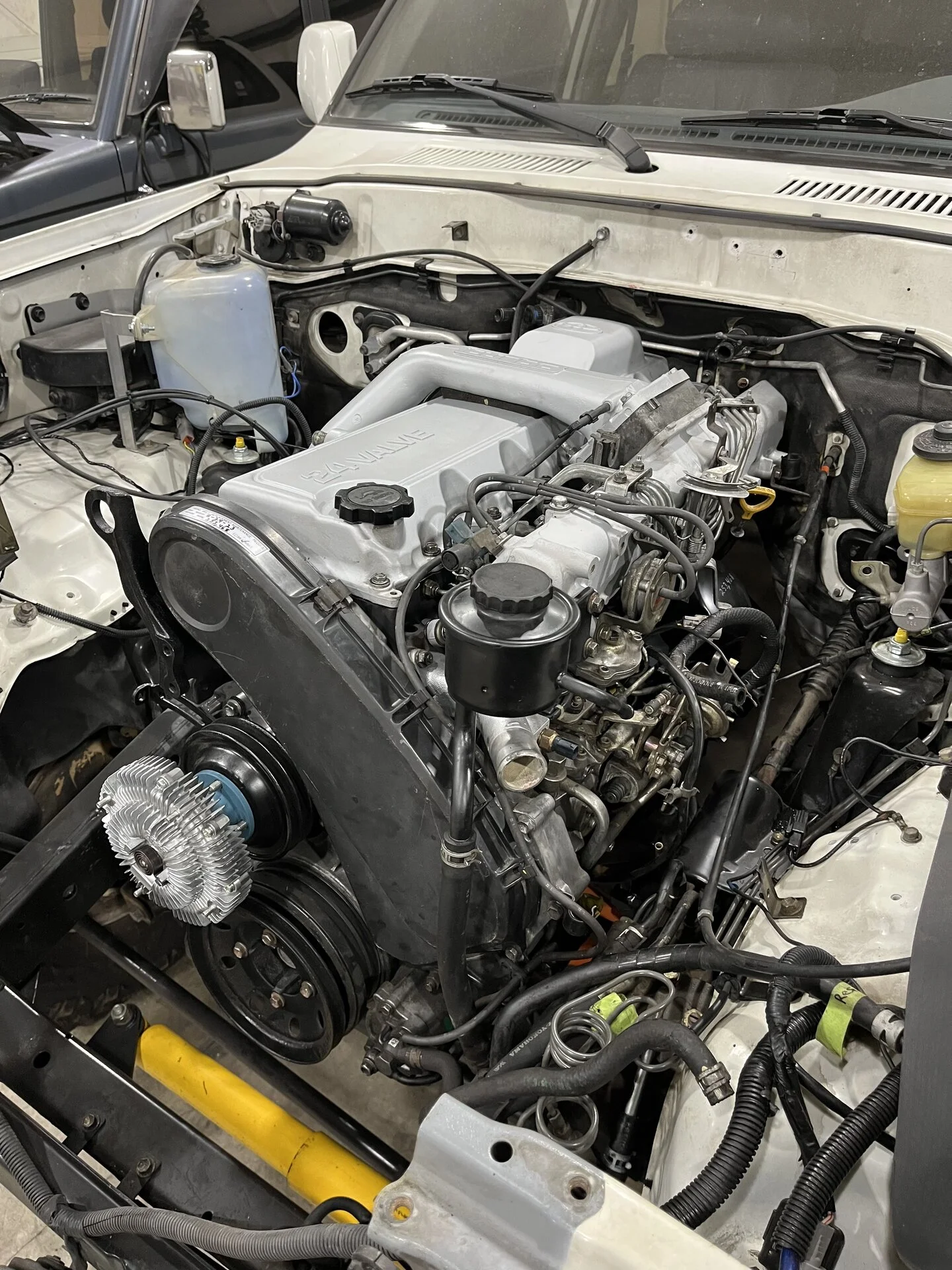

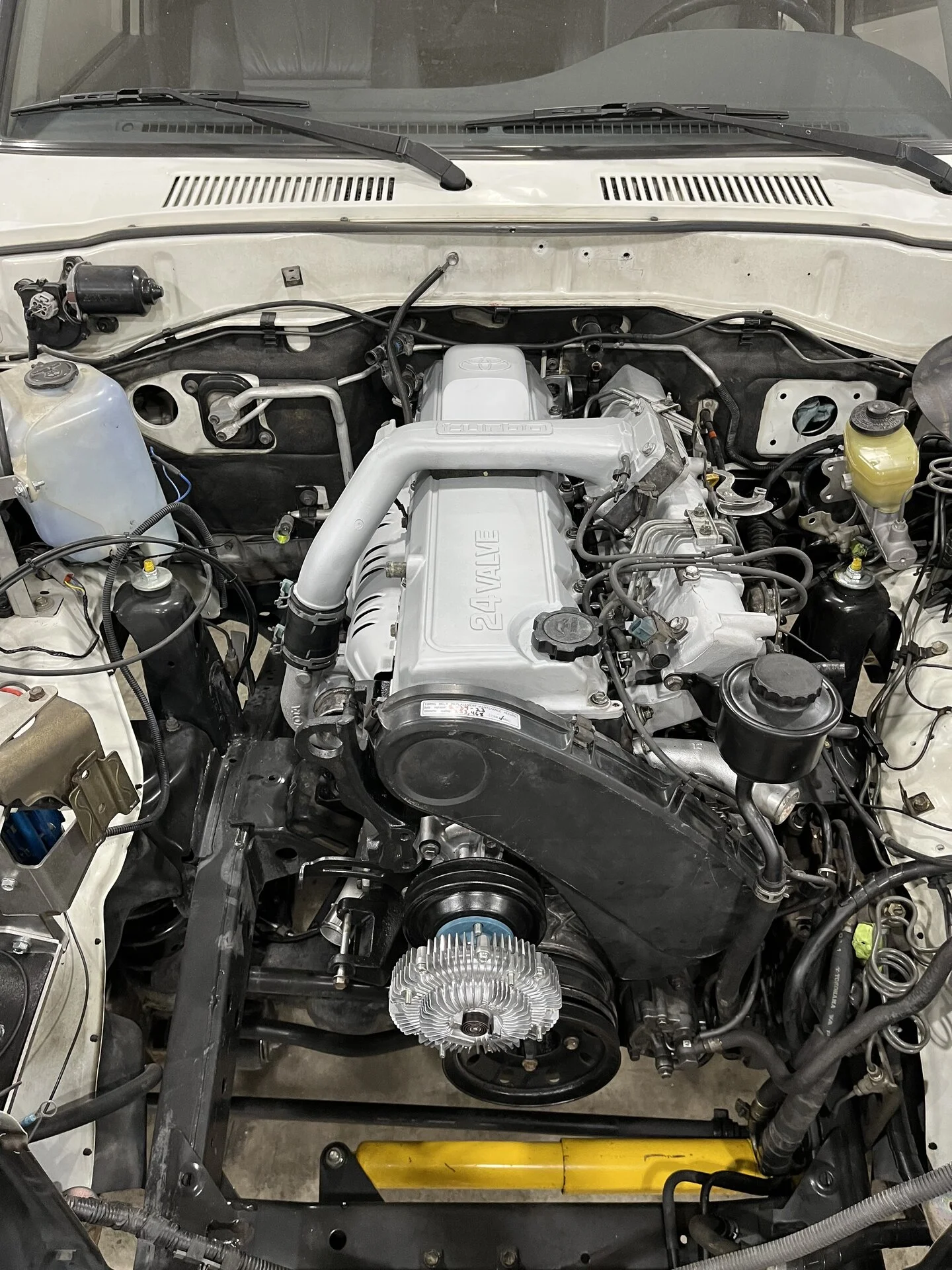

We got it all out back together and placed it in the truck. The factory 1FZ frame engine mounts bolt right up with the FT engine brackets and motor mounts.
