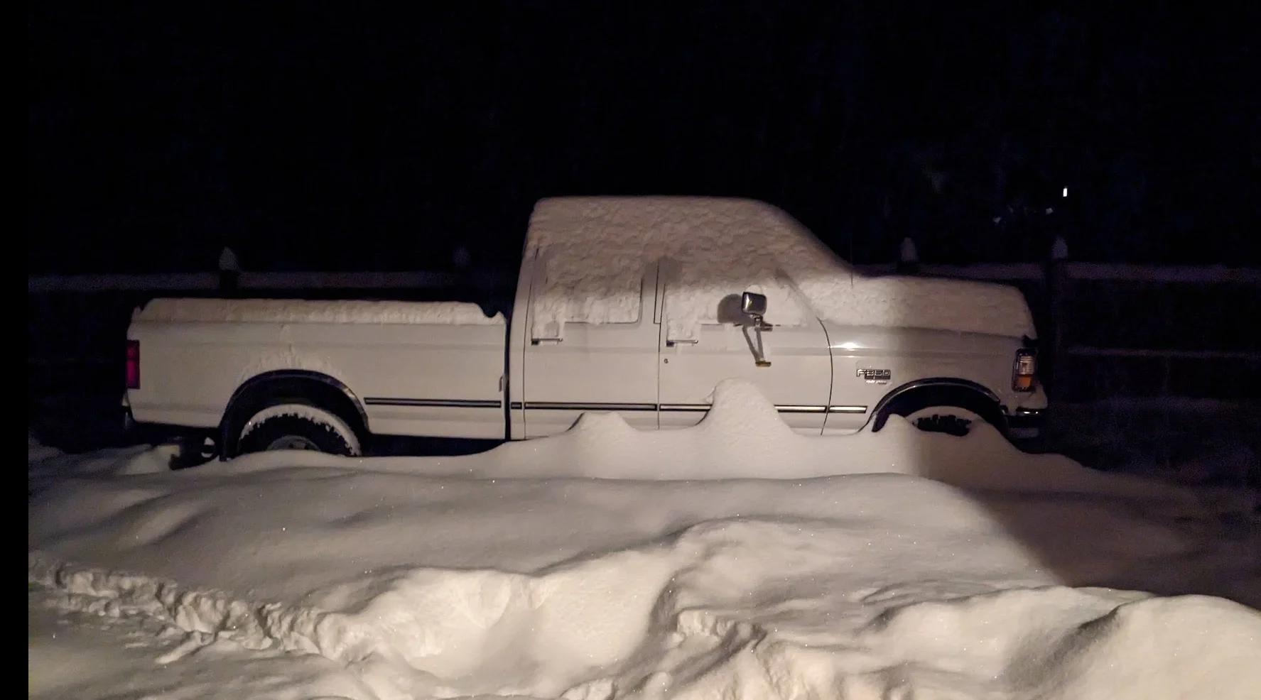

Personally I'd look into turbocharging the current engine if its a 95+ and in good condition. As much as I enjoy the sound and torque of a diesel I'm glad my cruiser is nice and quiet in comparison. Also when it's cold out (especially below 10F) the cruiser starts right up, a little more effort is required for my truck... (7.3 diesel). I'm not sure if 6BT's are hard to start when cold so this could be a bad example.
If your engine is toast and needs replacement then by all means swap it :)
Pretty much any turbocharged engine (diesel or otherwise) will perform better at your elevation ~(7200') than a naturally aspirated one.
Cummins needs the grid heater below single digits. The 12 valve in my superduty starts instantaneously down to freezing. At 10 degrees it takes a full crank rotation and heavy throttle to start without a grid heater, but it still starts pretty good considering.
