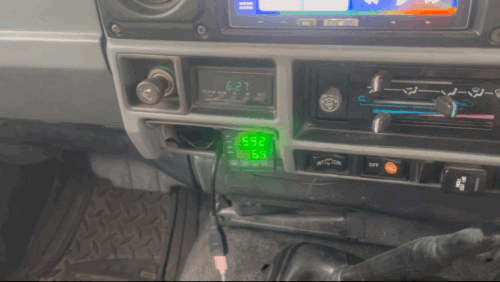

I run a Holset HE221 5.5cm on my 13BT (3.4L for those that don’t know) and it’s a fantastic fit for that engine size. Fast boost and plenty of available boost if I was to push that up to the 30psi range. Currently I’m basically stock
With just 1 turn on the wastegate adjuster and I’m hitting 18psi fast.
Now I’m not a “rev-er” so I rarely go above 2800-3000rpm
