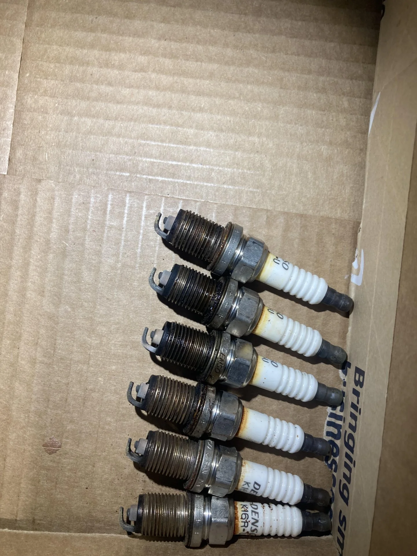

  • I pulled all the spark plugs and inspected them. They were definitely dirty. I don't think they are dirty enough to cause issues. I went ahead and ordered 6 new ones anyway. Cleaned these up and reinstalled them.

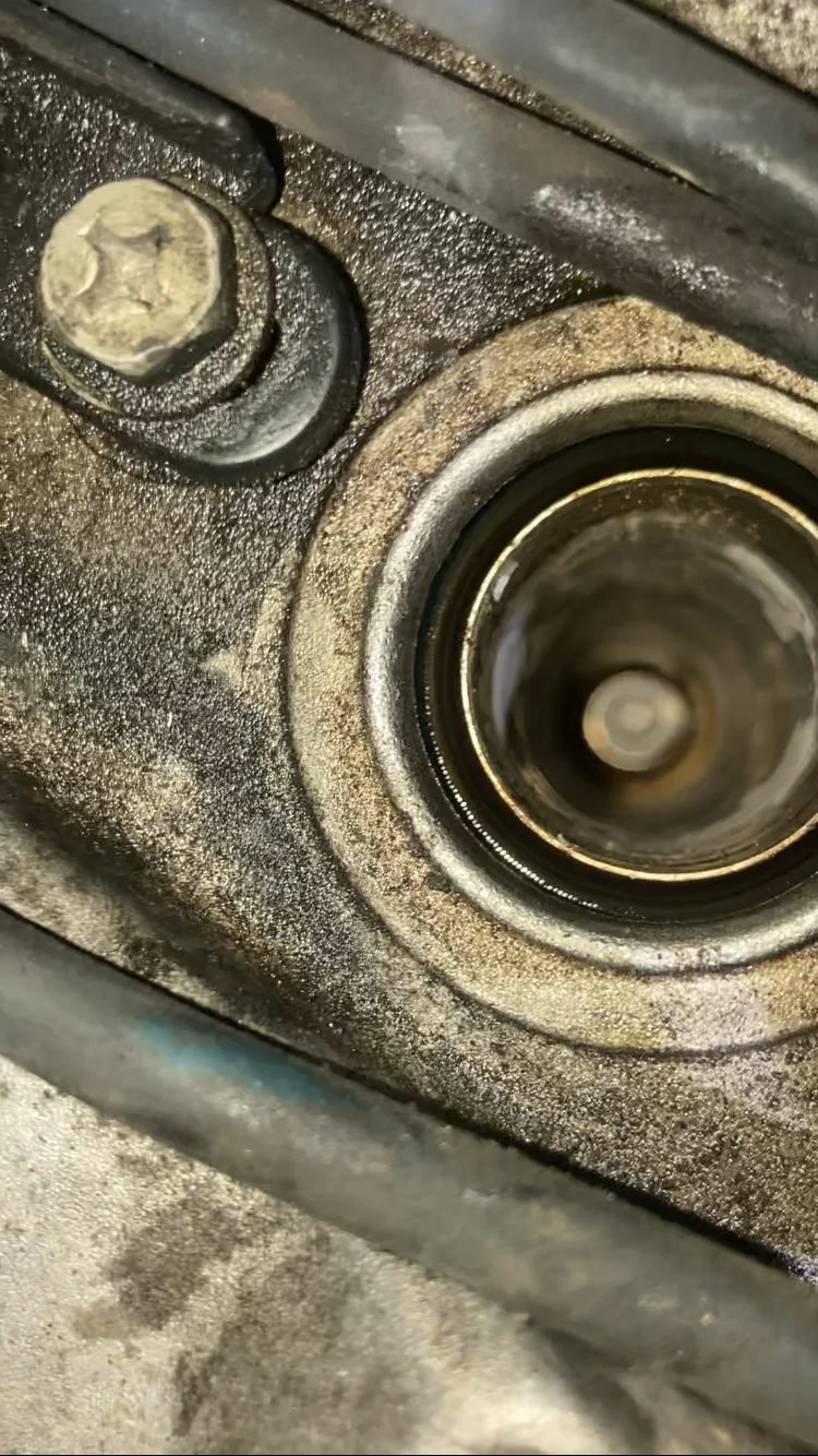

    • Some of the plug wires were loose. There's also some oil on top of cylinder 3, so I'm wondering what is causing that. See pics below.

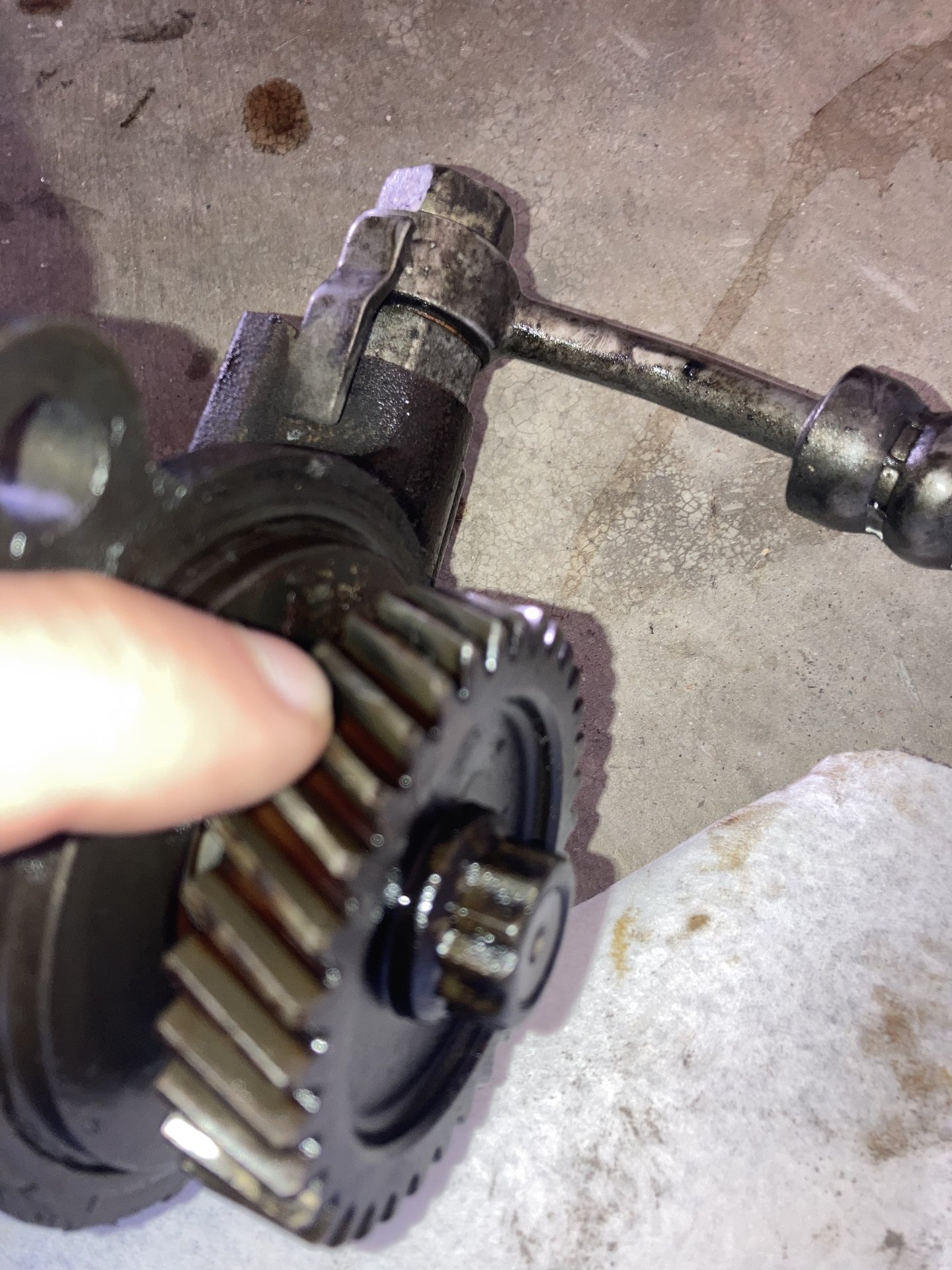

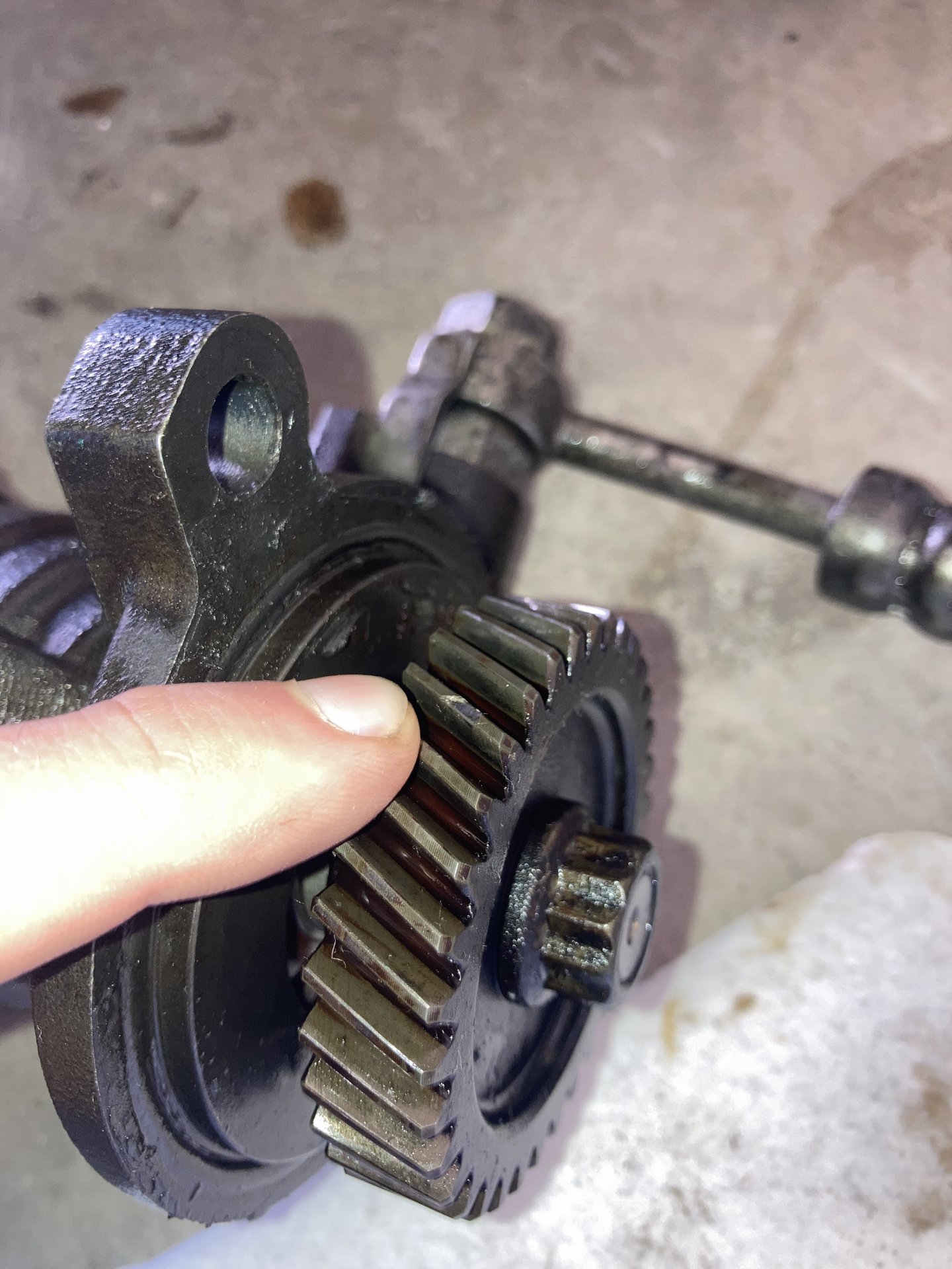

  • Last thing I did tonight was pull the hose for the power steering pump so it can drain. I'll pull the pump tomorrow. There's definitely evidence that the pump is leaking.
  • If it's not the power steering pump then I'm going to pull the valve cover and inspect the valves. I'll probably do that either way so that I can install a new gasket.

@COYS @beatle_bayly Thank you for the ideas. I'll update this thread as I run through the troubleshooting. The seller stated it didn't start making this sound until It’s the pump gear dude. It’s a very distinct noise. 💶💴💷💵
i would have just pulled the steering pump and gone from there. All that other stuff is not really necessary until you rule out the gear on the pump.
@OkieOverland Good work being systematic on this, in my opinion. From where we are sitting we don't have enough information to know that it's just x, y or z and since the 80 is new to you there may not be enough info to jump to those conclusions on your end either. Regardless, it's a good exercise to work through some of these areas like you've been doing as a way to get to know the state of things with your new rig.
Looking at the picture of the power steering pump it appears to have been in place for a fairly long time. You say that the previous owner reported that this noise started recently and you don't mention replacement of the PS pump recently. In all cases that I'm aware of the power steering pump gear noise issues have only been the result of mishandling of the gear and damage while the pump was unmounted. I'm hopeful that you'll be able to fix this without a deeper rebuild but given what we know think you have to just keep working the process like you are doing. The power steering pump is probably best case scenario at this point so I'll keep my fingers crossed also, like @COYS

It is making the same sound at the same RPMs with the power steering pump removed (and a catch can underneath!). This is leading me down @COYS train of though in believing that the shards from the gear worked its way deeper, and there are other damaged gears too. Here's where I'm at a crossroads.
