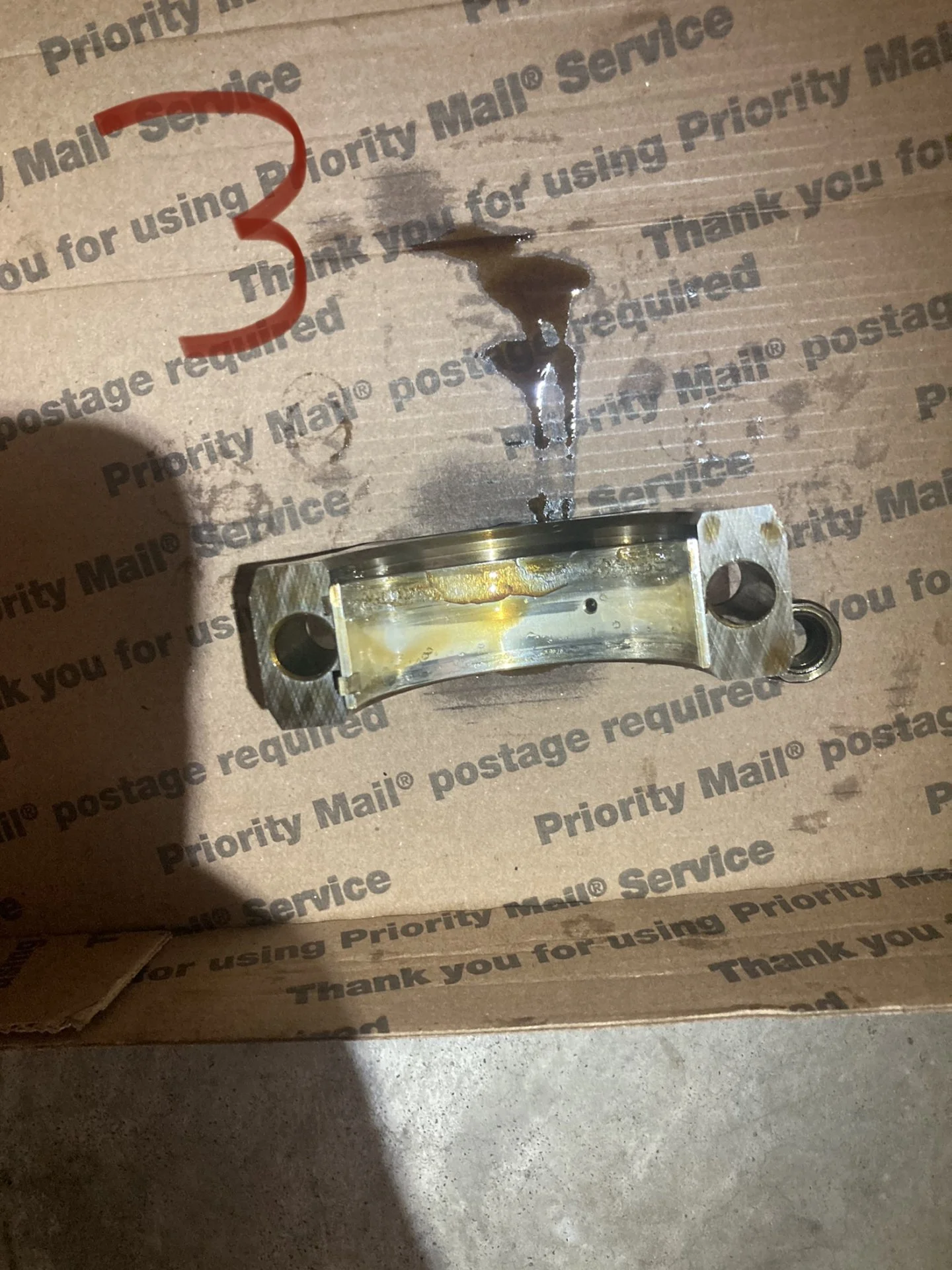

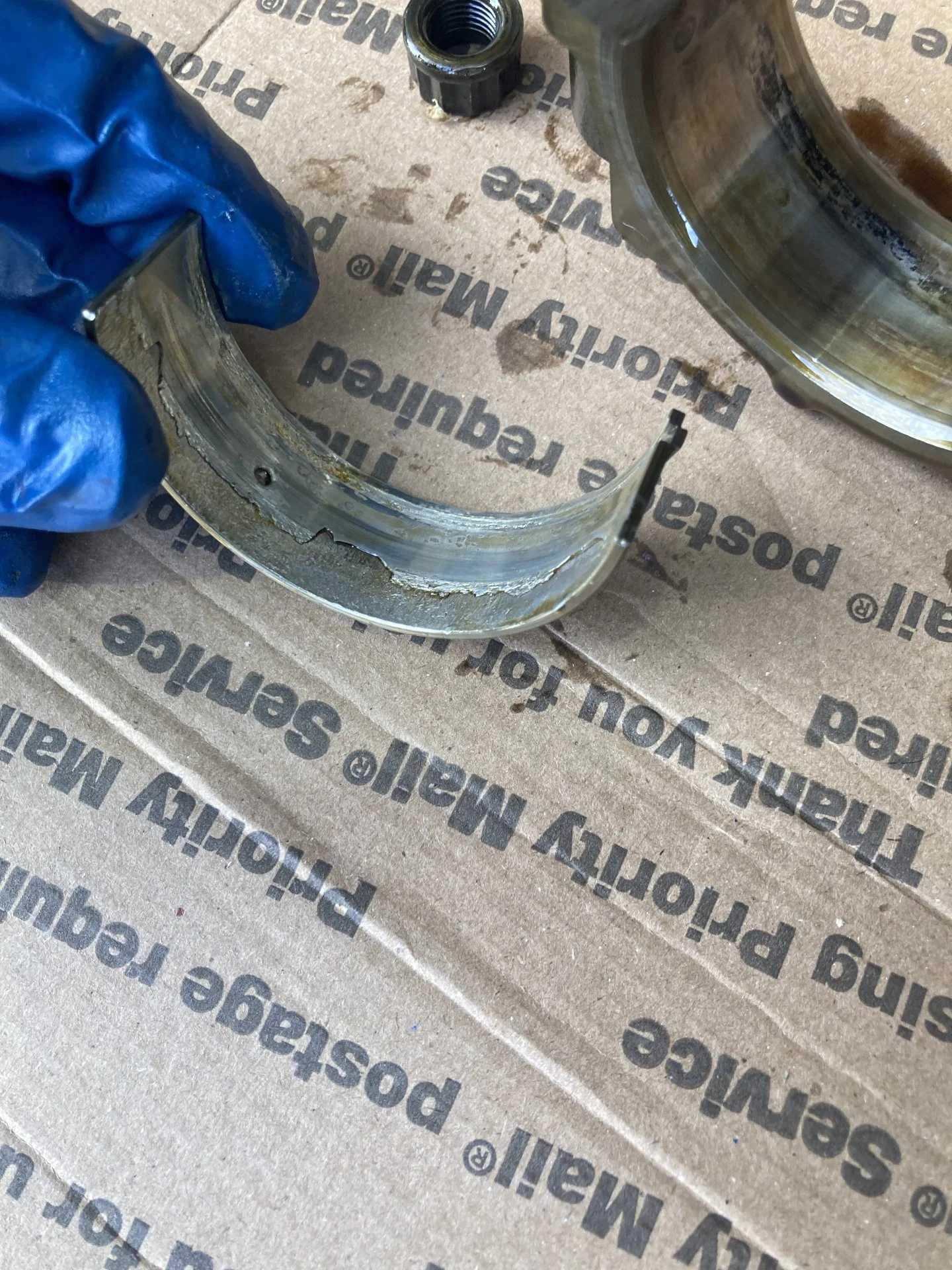

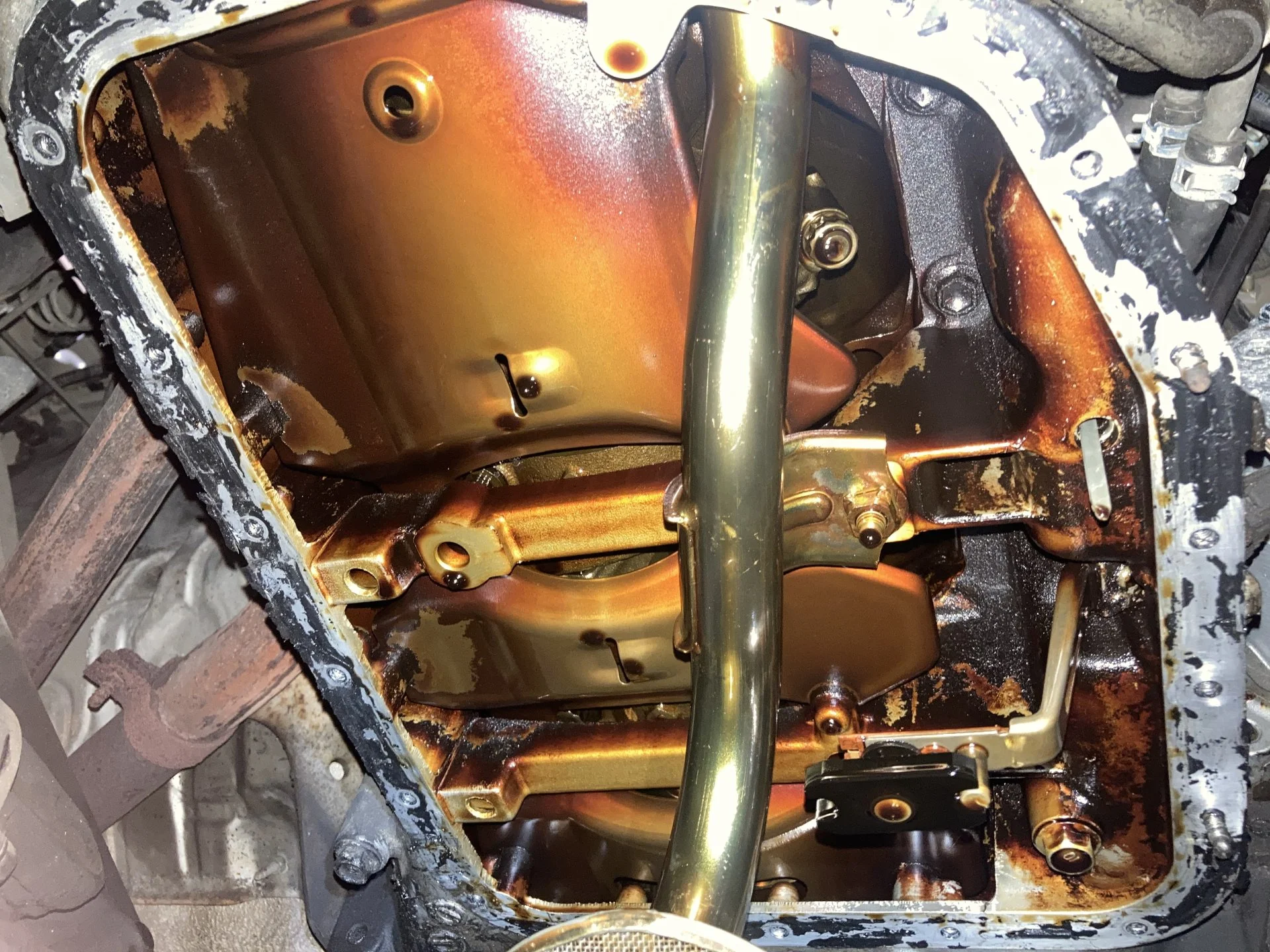

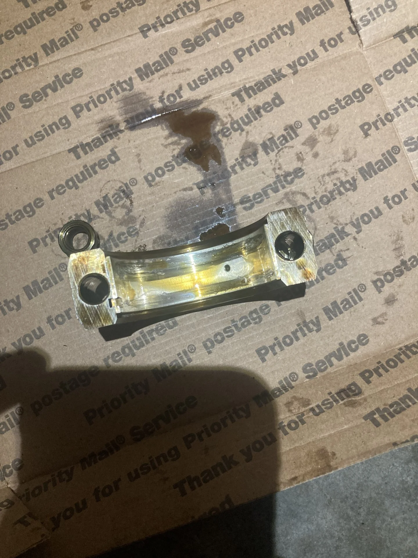

Thought I’d post an update. Checked the valves yesterday and the cam lobes. Didn’t notice anything out of the ordinary. So I pulled the oil pan today and this is what I found. I have of course watched mercedessource YouTube series on the land cruiser motor ticking sound and these shavings look awfully similar to the bearing material he found. It’s not magnetic so I’m assuming aluminum.
since you have the oil pan off, pull the rod bearings one by one and check the condition.

@GeoffBart It has been slow going for sure! Major learning experience for me, but I'm enjoying it. I took the head to a machine shop on Monday. I just got the block disassembled, but I haven't had a chance to measure everything out yet. Getting the motor out of the LX took me every bit of a week working in the evenings and on weekends. My garage is small and I had to borrow an engine lift from a friend, so that set me back a few days.
There were no other obvious signs of wear. The main bearings look great. 1/2 of the rod bearings look great. The cylinders look fine, and I'll be measuring them with a bore gauge. The crank looks fine, and I'll be measuring it with a dial indicator and micrometer.
I ordered all new gaskets, seals, gears, timing chain, oil pump cover, and a few other goodies. Figured while I was in there I would go ahead and refresh what I had access to.
I'm starting to think that new bearings will do the job, but I still have a few measurements to take to be certain.
