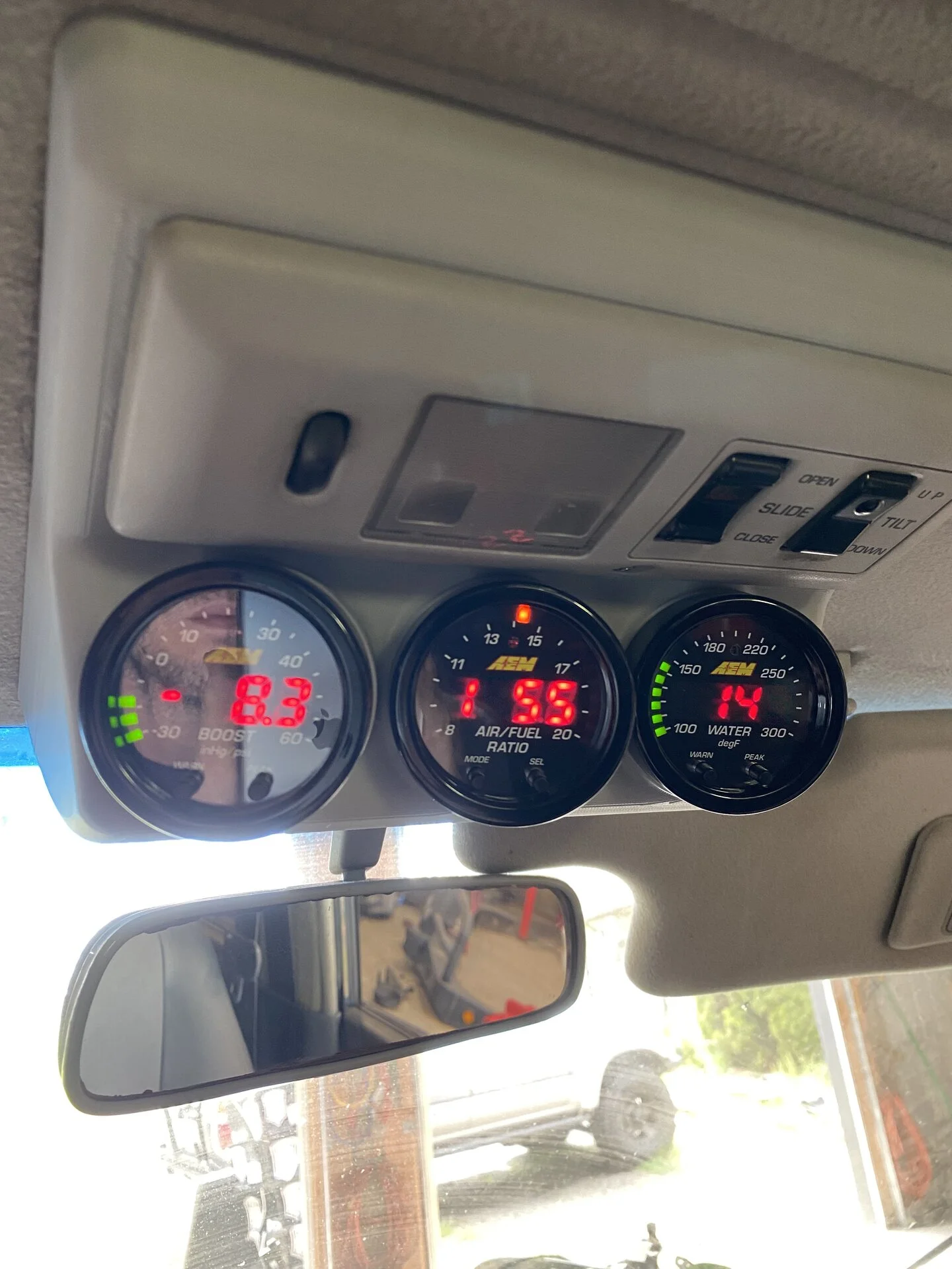

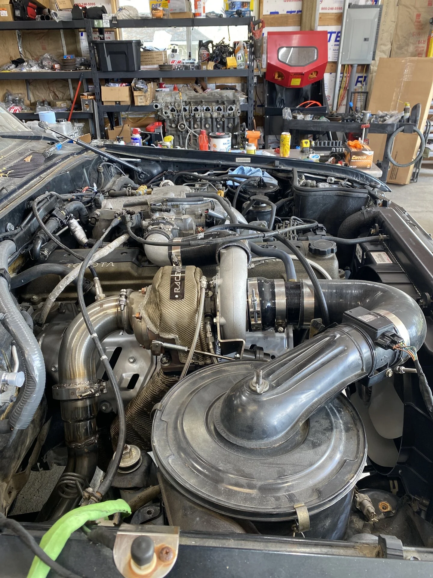

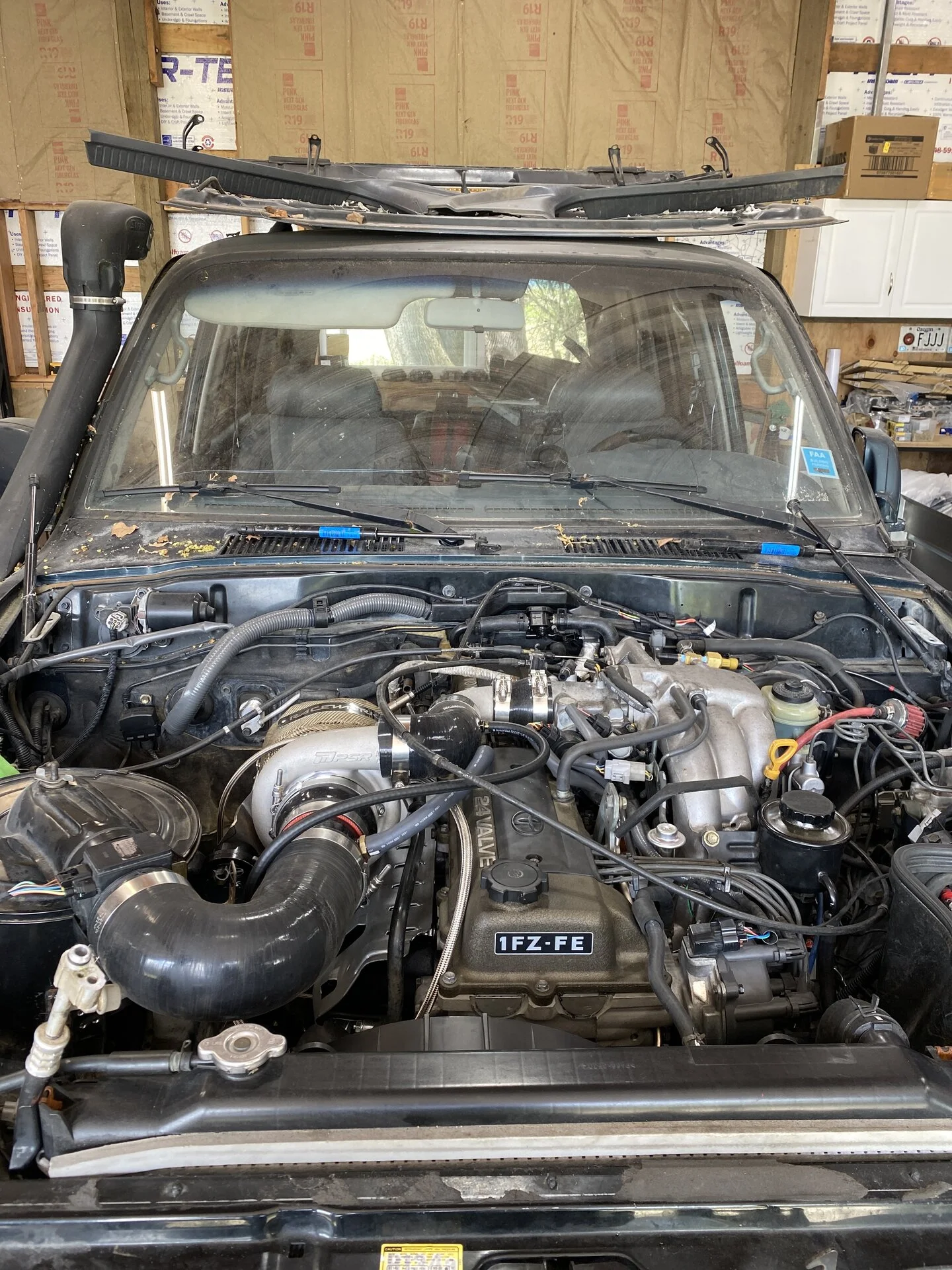

been working on getting my turbo buttoned up and finally got it fired up. I’m using a HD automotive j pipe and pulsar turbo. Have a AEM boost , water, and AFR gauge my question is what causes it to read lean. At idle I’m at 14.7ish but when I accelerate in drive(have not installed drivelines yet or driven) I get up in the 15/16s and shut it off. I have a new fuel pump installed with premium fuel I know that fuel grade doesn’t affect AFR. I have tested for vacuum leaks and everything is solid. This is a freshly rebuilt engine bored over .50mm and all new internals. Timing is set at 3. Looking for some input to bring the air fuel ratio down so I can go break this thing in. Thanks in advance.
That first picture is 14.55 on the AFR gauge.

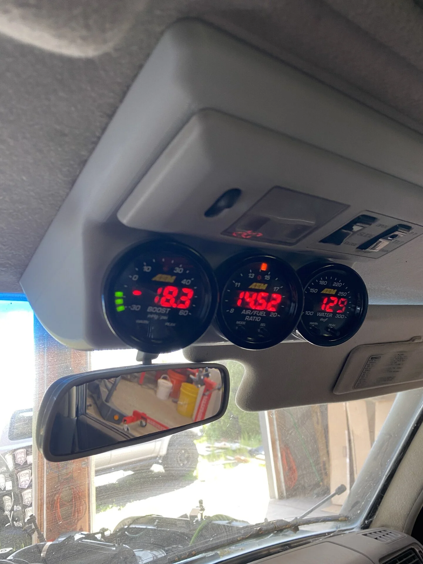

Better pictures at idle. I wonder if the ECM still needs to learn what the hell is going on with a new motor.
You might want to consider installing a fuel pressure riser that adjusts based off vacuum.
Go for a drive, without any load on the engine you will not get any useful information or allow the ecu to learn closed loop values. It will take a bunch bad noise and heat before you melt it down.

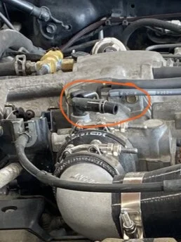

Also make sure this is plugged.
Sounds good that is plugged with a cap just shoved in there until the right size comes in the mail.
