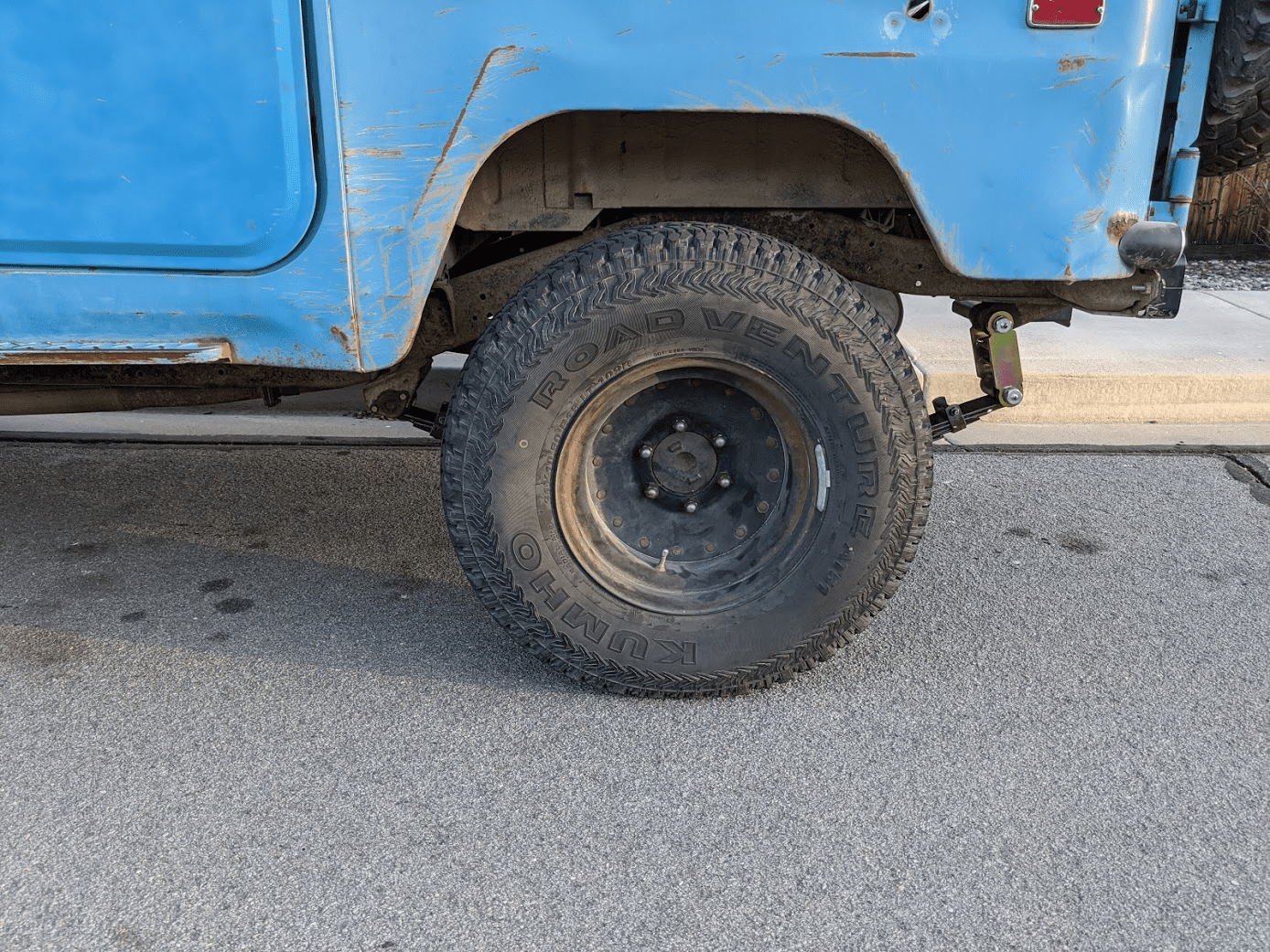

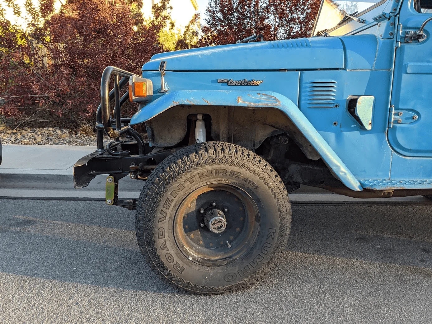

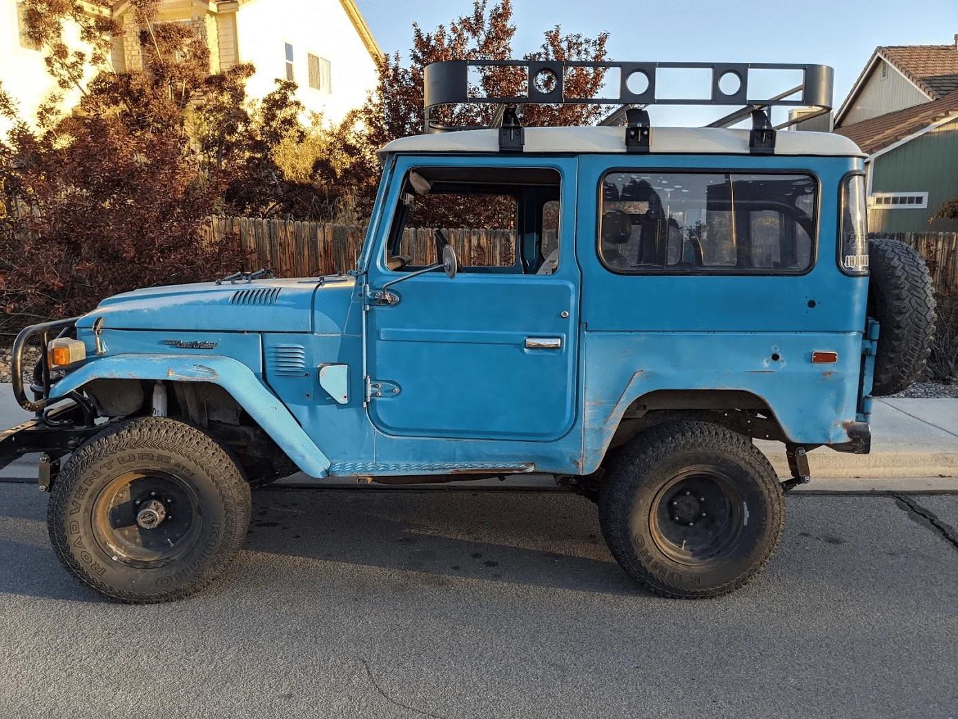

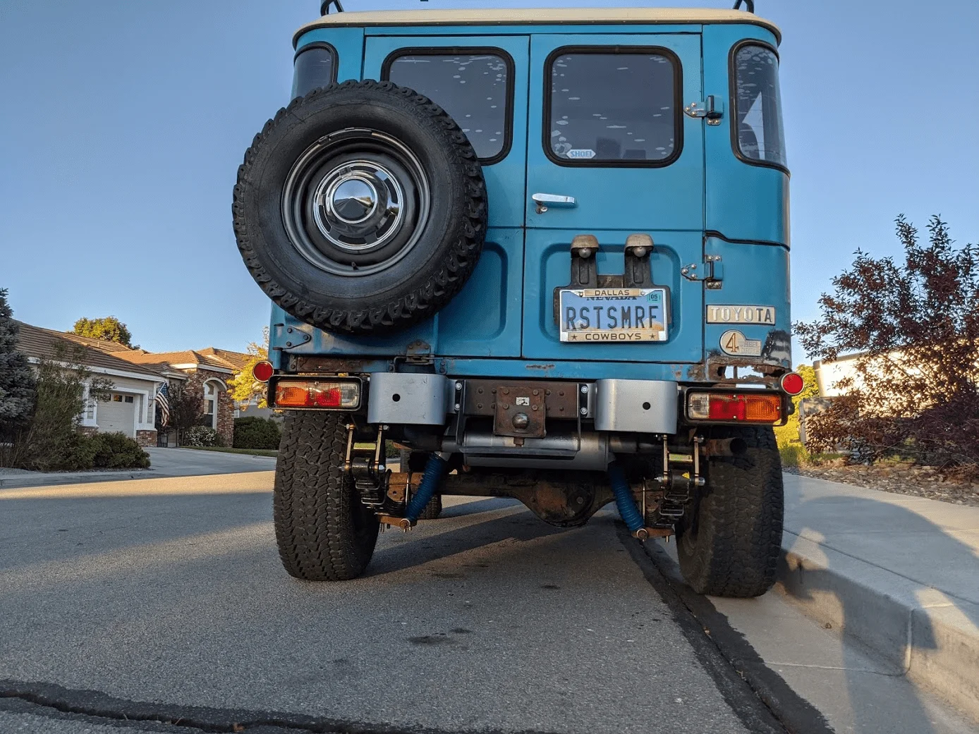

BTW , I’m considering the same lift for my truck. What size tires are you running? I’d love to see a straight on side shot.
Here are a few pics I snapped...

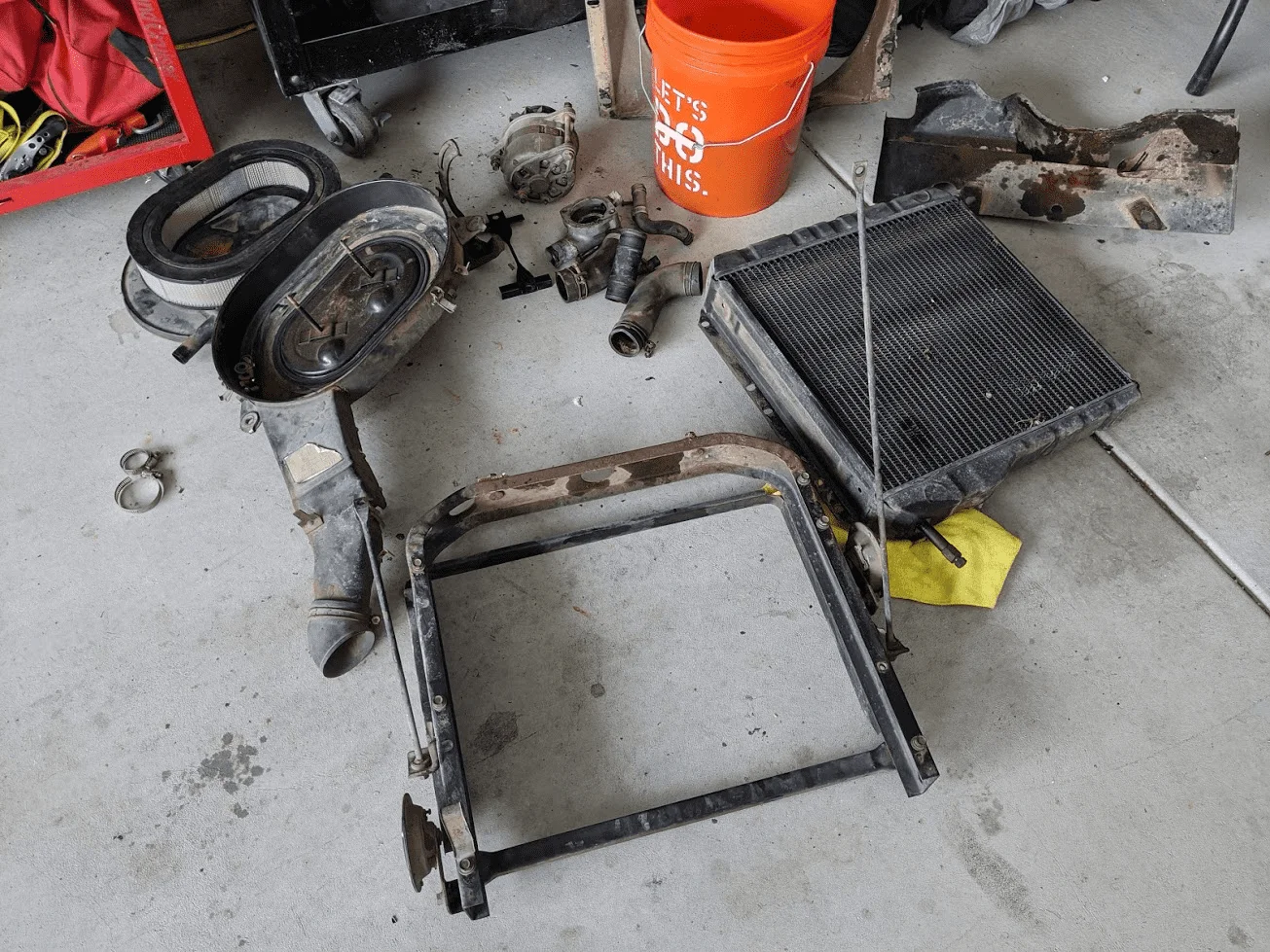

Ok I went ahead and started in on the disassembly to start the project of changing seals/gaskets on motor as well as changing clutch and rear main seal. I'm also hoping to clean and paint the motor with POR15 engine enamel a blue and white combo. Wish me luck.

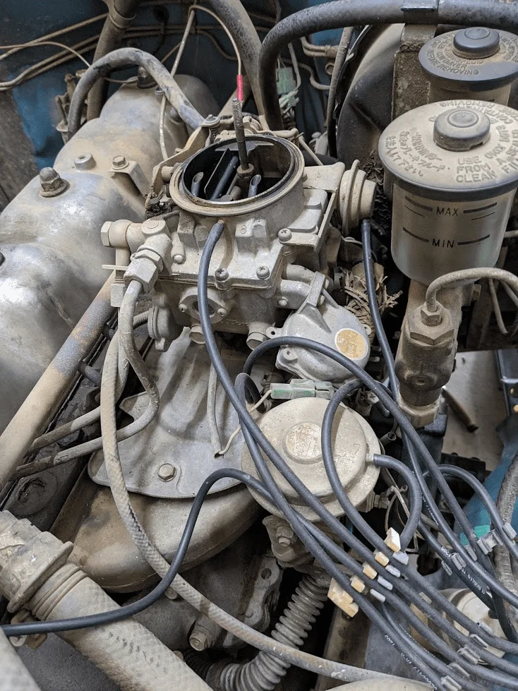

I got this far today and felt a little stuck so I'm hoping to get some help...
This is how it sits as of right now...

  • I see several things that are used for smog system, however the smog pump has no belt connected to it so I don't think it is working. So am I just better off removing all smog stuff? If so what all does that entail.
  • Do I need to keep everything on the way it is now so it will run right or will removing everything make it start running differently and I'll have issues?

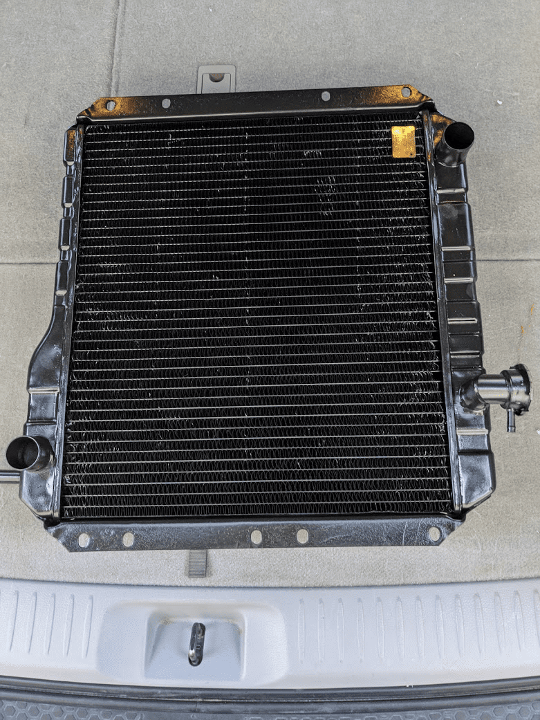

  • The radiator was plugged up at the drain point with a bunch of muck, I easily stuck something up there and it all came loose and drained just fine. Does this indicate a problem with the radiator, or is this common expected wear and tear from running so many years?
Depends on regulation in your state. I don't know Nevada rules. In WA where I live, anything over 25 years old doesn't need to be emissions tested. I believe in Cali, you would need to keep all of the smog stuff and getting it tuned well. I am building my engine desmogged, and learning as I go...it is a 3FE though. There is plenty of info on the forum on desmogging and even kits you can buy to help I think. I don't know enough about it (yet), but if there is no belt hooked up to the air pump, you certainly aren't running it properly.
I assume you are referring to the smog system. I would have said you can't partially desmog, but since your air pump isn't hooked up, maybe you can. But I would say generally speaking, your engine won't run nearly as well if you don't either have it fully desmogged or fully "smogged".
You can take your radiator to a radiator shop and have it cleaned and pressure tested. They will tell you if it is still usable or not. I would suggest doing that...getting the cooling system working at peak is essential. Especially in Nevada, I wouldn't mess with overheating.

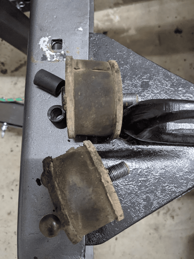

Here's as far as I've gotten so far...
It's been fun and I've learned a lot along the way so far. I'm not trying to take too long on this so I don't forget stuff or lose parts.
As you can see there is one thing at least, one concrete piece of evidence I've actually replaced something, the front motor mounts. The old ones were not terrible I suppose, but best to replace them while I'm at it.

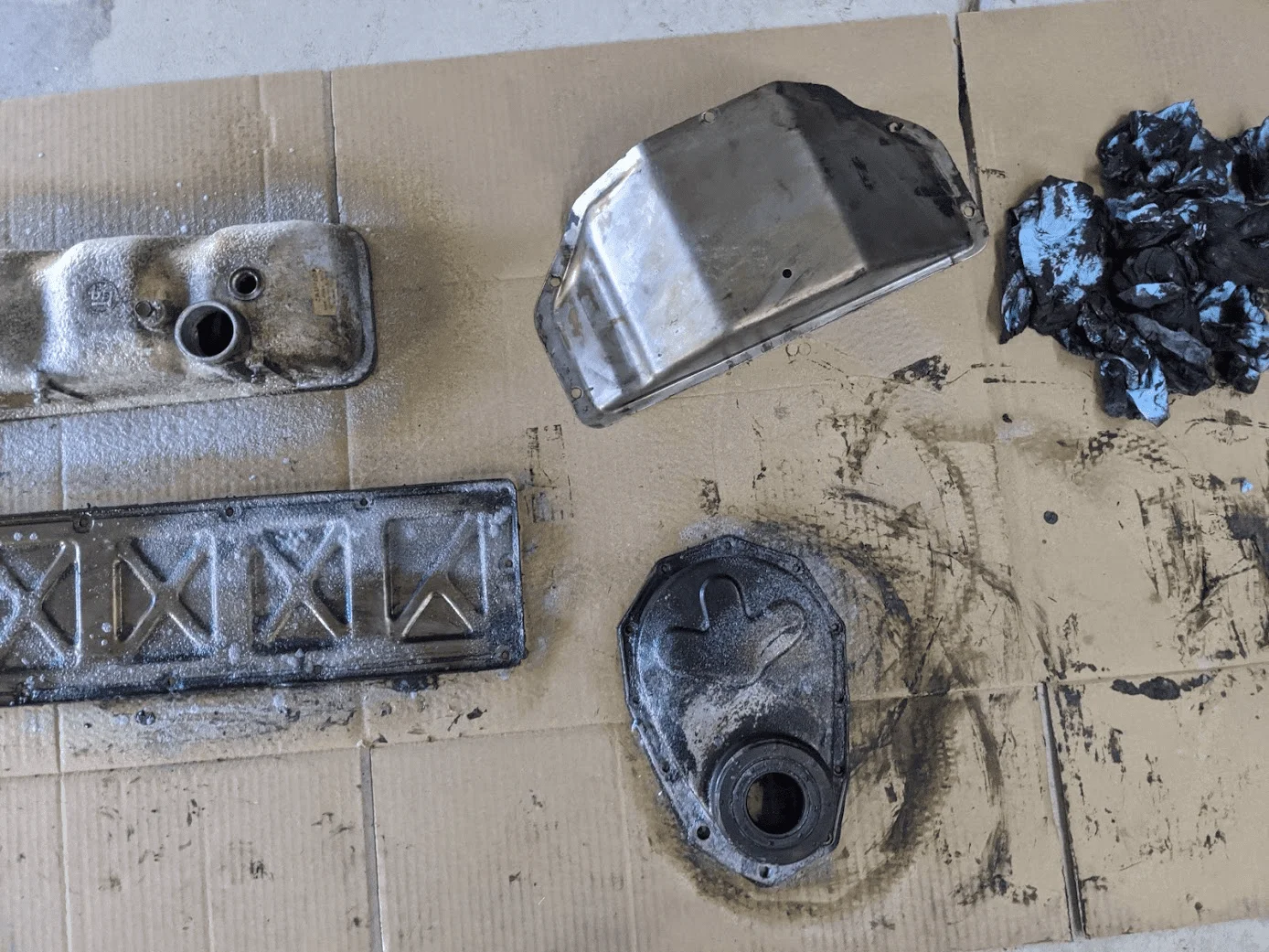

I continued cleaning up the motor to get it ready for all new seals.

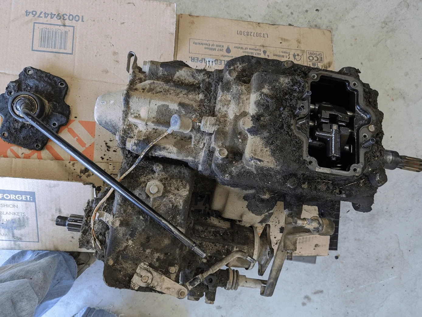

Yesterday we pulled the transmission out. Now to take it somewhere for rebuild/reseal. Not sure exactly what it needs but I'll let the experts handle it. I was wondering if I need to make a trip out to George at Valley Hybrids, but how long does something like that take? I was going to give him a call on Monday to inquire. Anyone with experience with them have any thoughts on if am I much worse off at a transmission shop here locally?
