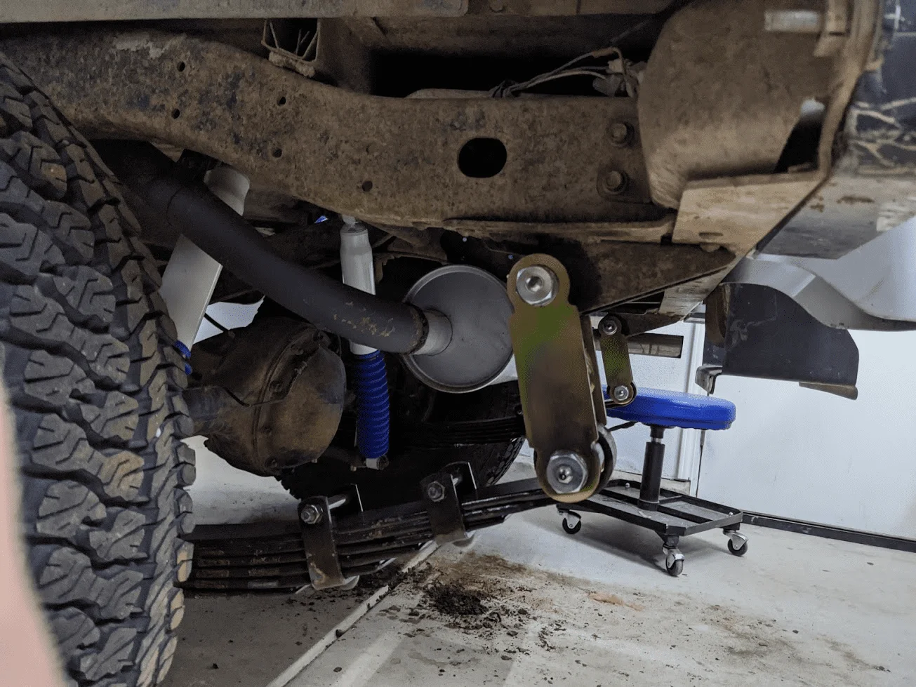

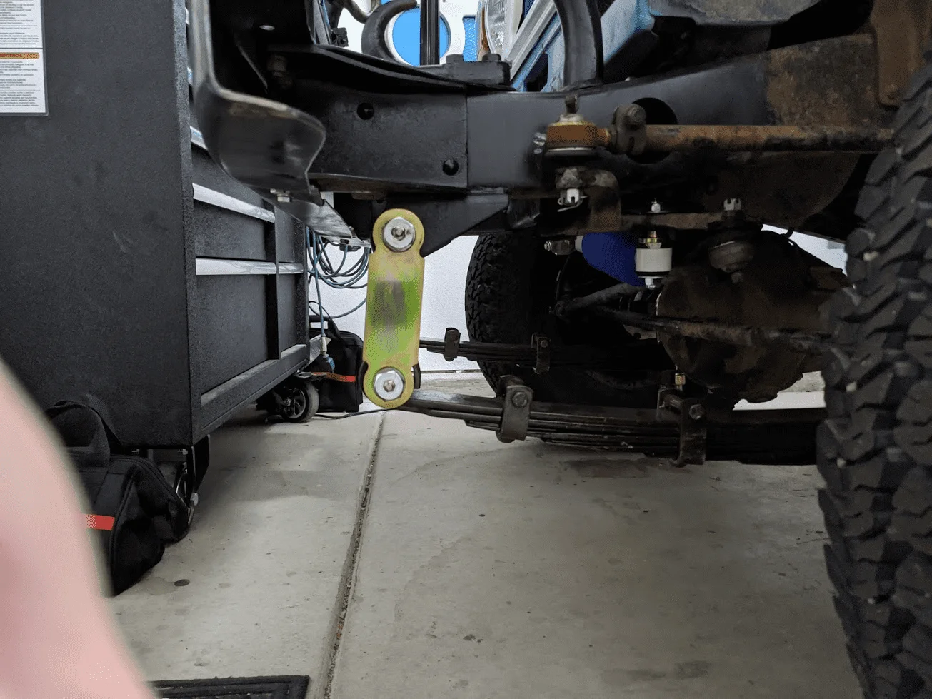

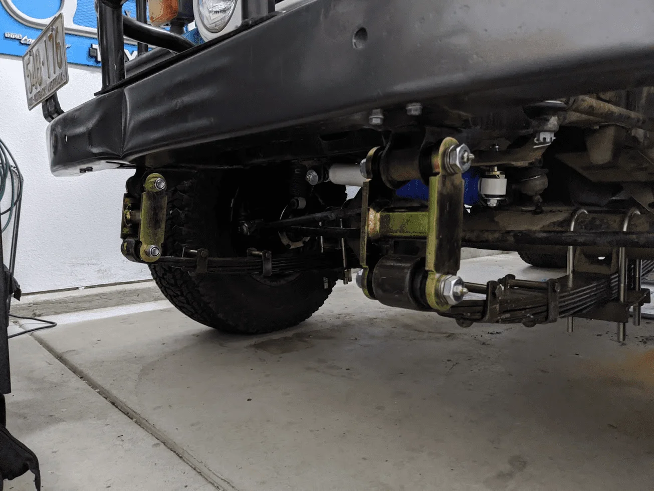

Be interested to see the shackle angles Aaron.
For sure. I took a couple pictures of how it sits now. I can say it rides really well and much better than my old stuff that was on there. Although that's not saying much from that really old man-a-fre lift that was on there.

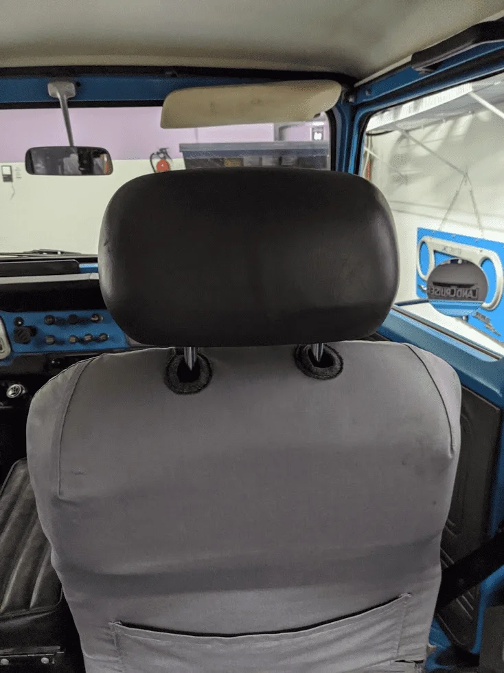

A couple new things I've done to the Rusty Smurf. I know these are not a necessity, but I've always wanted headrests for my seats. Maybe it's because of the rareness of them, or just the fact that they feel somehow incomplete to me without them. There are probably more comfortable seats out there, but I've always had a more purist mindset and love of these old trucks which leads me to want to have them closer to how they were back in the day. Seats still need to be reupholstered but that'll happen eventually.

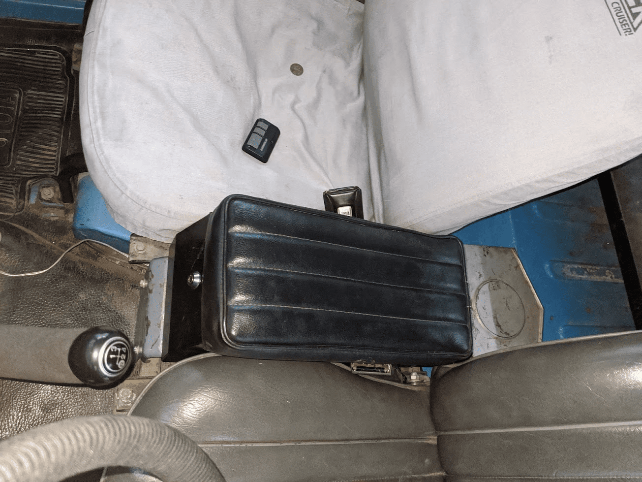

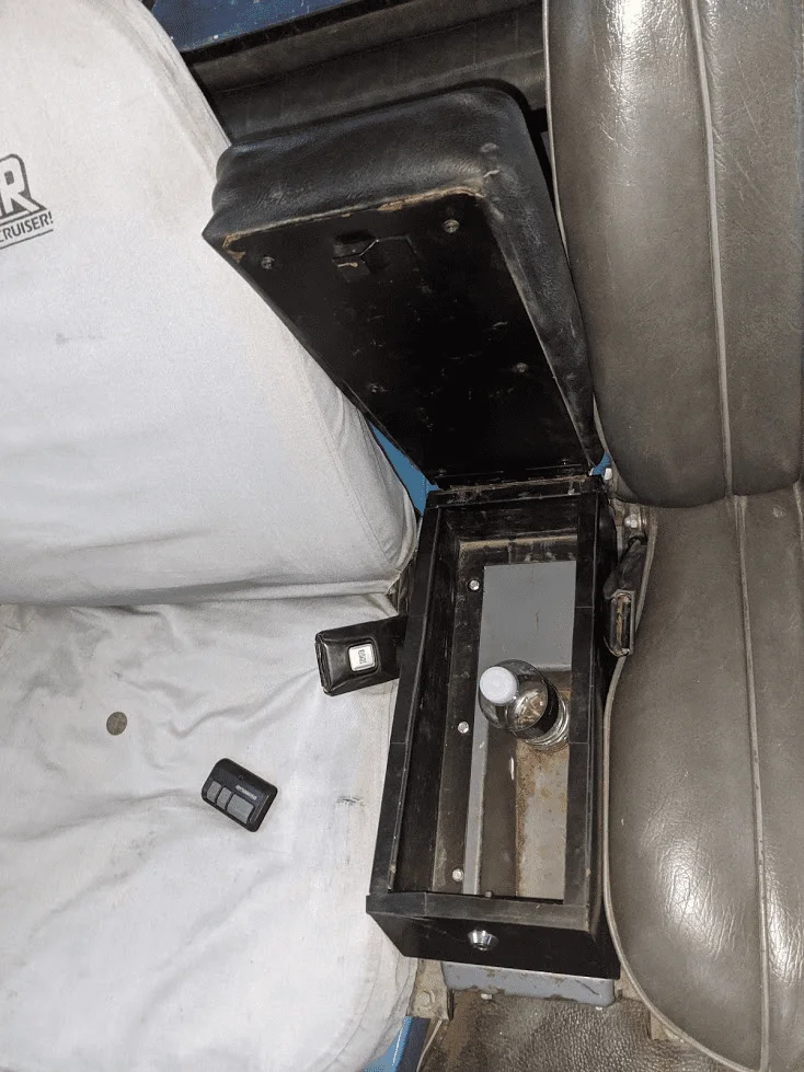

All that being said I also threw in this Conferr center console I bought a little while ago but never put in. I had also purchased a spare console from someone on here for cheap so I wouldn't have to use the original because it screws into the existing console. While it isn't stock, it is the type of thing that would have been thrown on as sort of upgrading some of the features back in the day.
